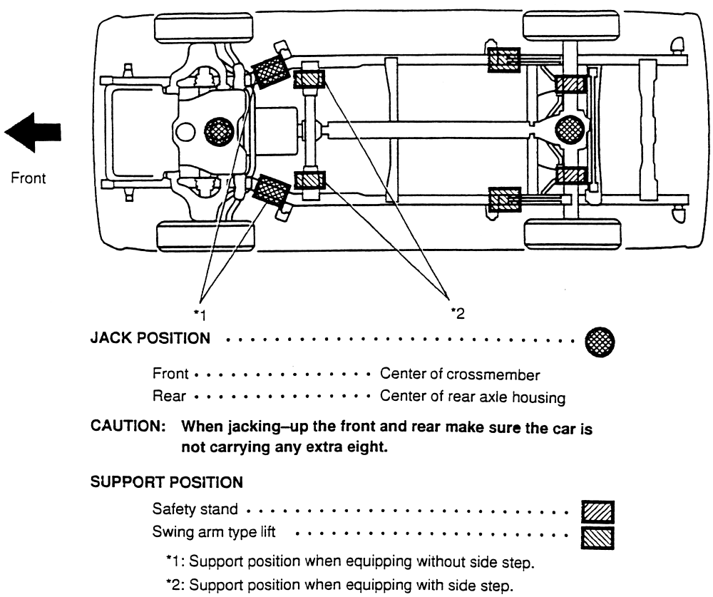

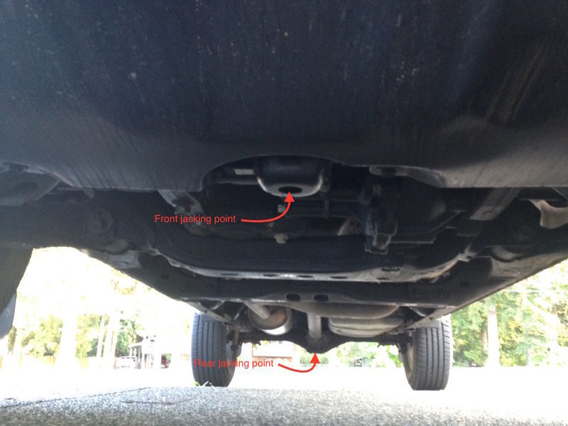

    Thanks, pic helps.
    Drove it all day yesterday………no less noise in turns…..
    Jacked it up, did 12/6 wiggle test……no movement…….and spun pretty free BUT a little rubbing sound from Rotor….
    been reading all the complaints of road noise and bad wear from Toyo Open Country A30,, OEM on Tacoma Sport and what I have…….
    what do you recommend for jack point

    Lower control arm if you're careful.. or frame rail if not sure
    Forget about the wiggle test. If the bearing was loose enough to wiggle it would be howling like a motherfkr
    Don't worry about rotor rubbing.. it's more of a "feel" through your hand that's holding the knuckle. Comparing side to side really helps

    I use the front center one. It gets both sides off the ground at once.
    And obviously, you should use jack stand.

    The front is easy from the pregnant spot. The rear on the differential pumpkin, I lift the jack until it’s barely not touching, shake to slide the jack against the drain plug protector, then a tiny shake so it isn’t touching the protector. Once up on jack stands I give it the shake test. Push and pull on the body simulating any force you might put on the chassis during your repair. So if it’s gonna fall, it’ll fall without you under it. If I can get away with blocks under the wheels instead of jack stands under the chassis, I’ll do that. Gravity is unspent energy that can kill you.
