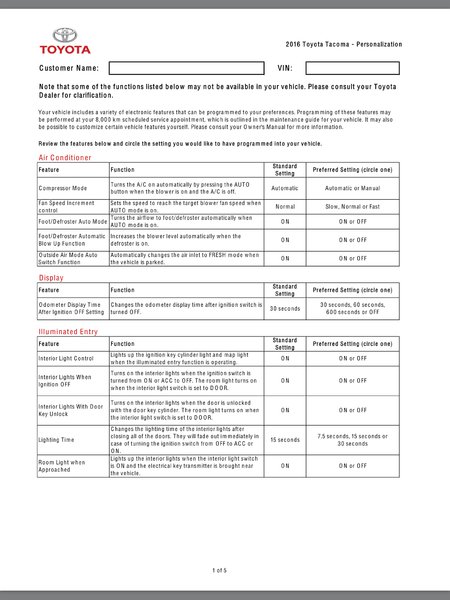

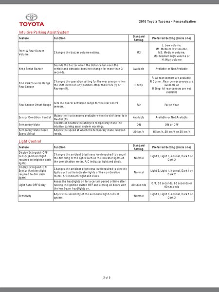

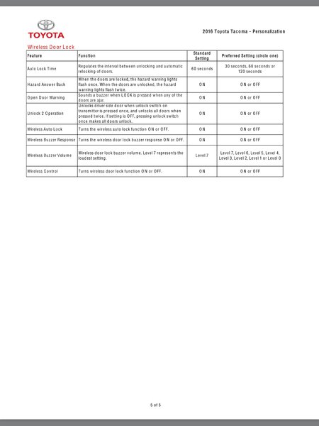

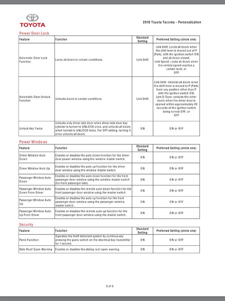

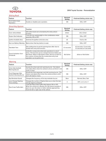

    It's on a Toyota form. And straight from the inserts manual that the dealer will do this. Bottom of page 4.
