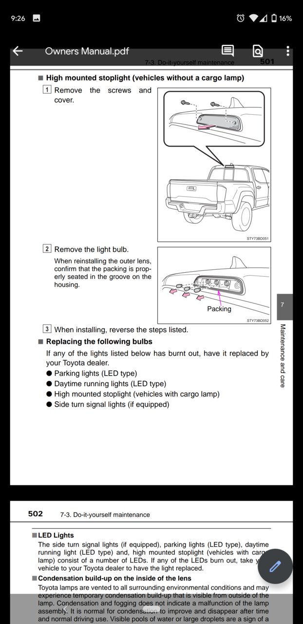

    Just pull the bulbs?
    Also, I can't see the light at all with my Softopper. You might try it as is?

    Wouldn’t he have to drop the headliner to remove bulbs?

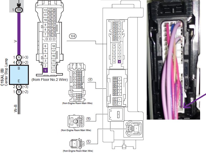

    Driver side on mine (led) 2016 trd sport you can get to in from the sill board cover (purple wire if i remember correctly ) Some one will post a wiring chart at some post I'm sure.

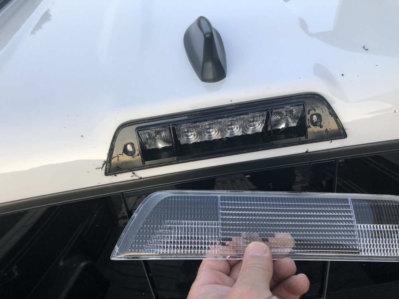

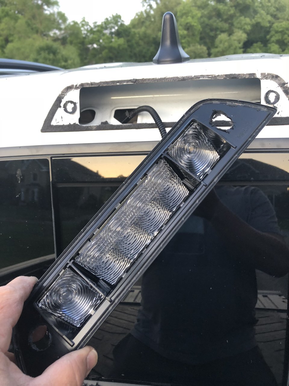

    It takes 15 minutes to remove from the outside with a small screwdriver and 1/2 inch drill bit.

    Found it..... But this is for the LED... just saw that yours may not be the same

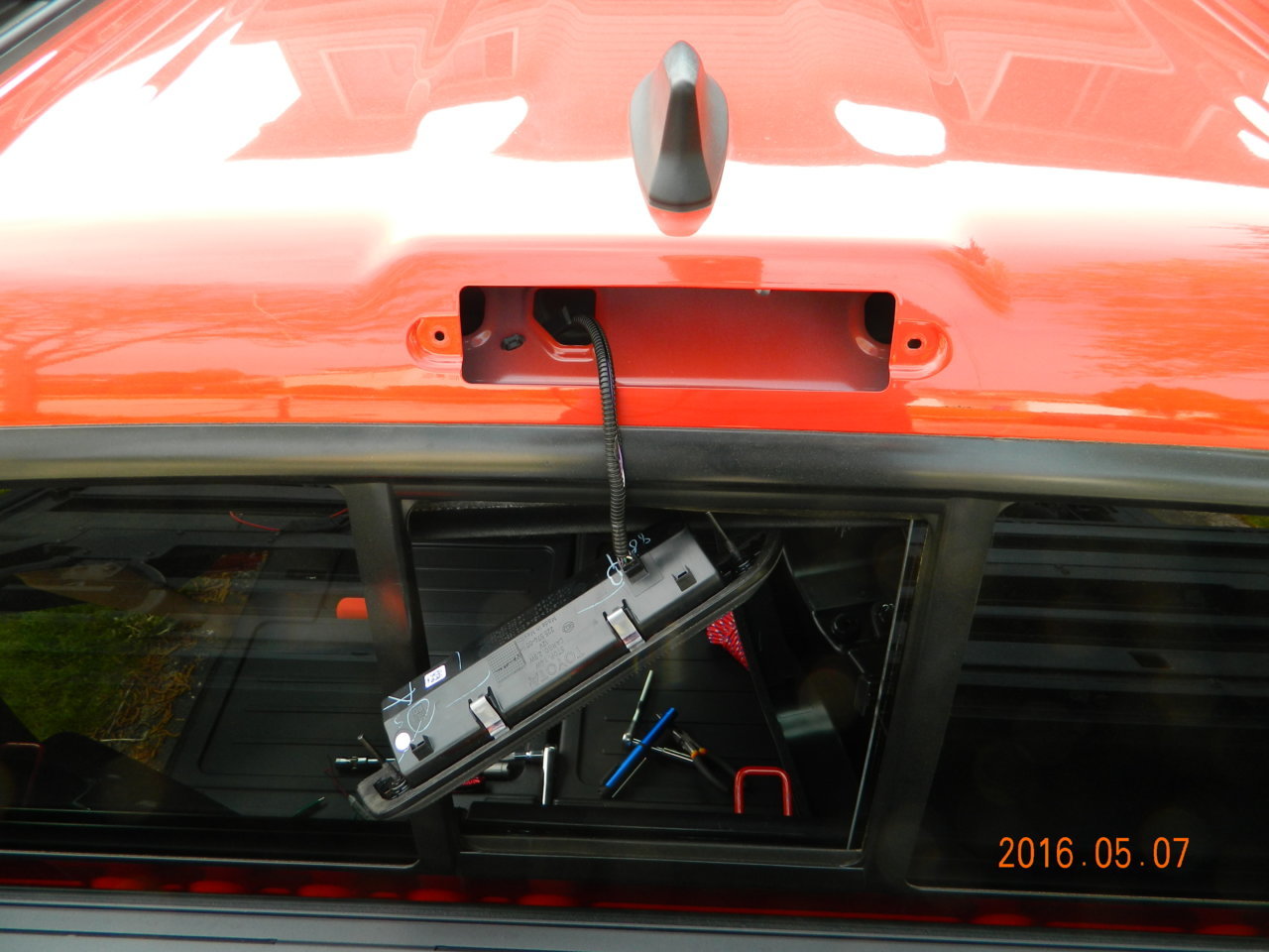

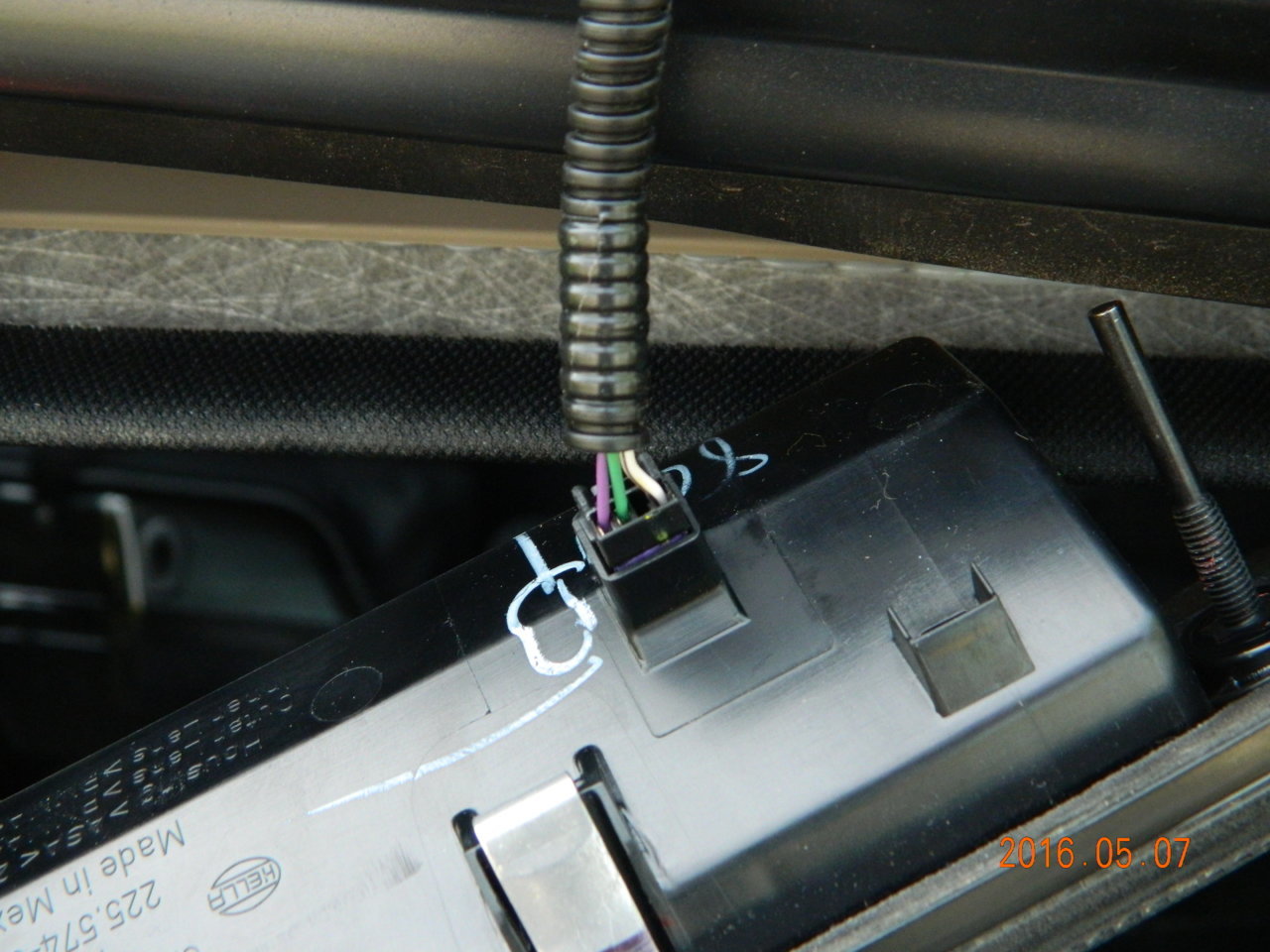

    That would leave him with a mangled light and a hole in his truck.
    It doesn’t take much longer to drop the rear of the headliner and do it properly.

    Nah lens pops off in one piece...JB weld the holes and or studs back on. Silicone light back in place or use aftermarket third brake light that bolts from the outside.

    No connector that i know of. use a volt probe to check BEFORE you cut. I was adding a pulse flash to mine.
