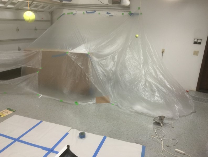

    Here some pics of my set up:

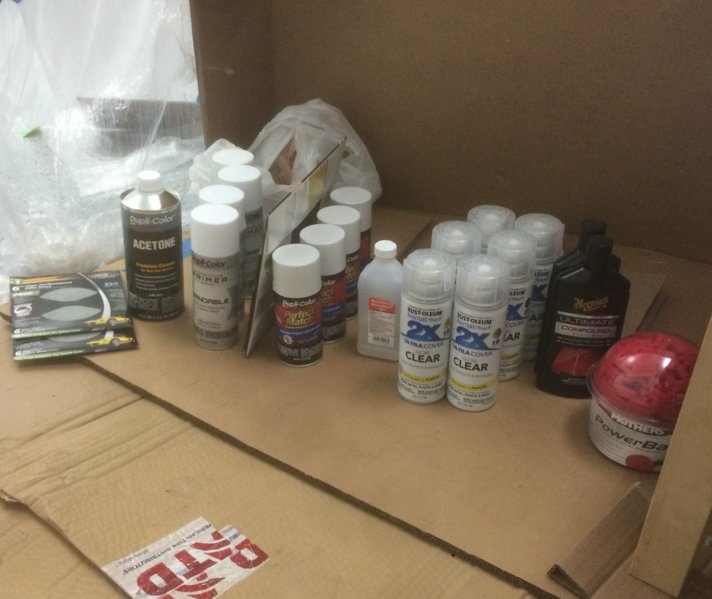

    Materials:
    Anti-Paint Booth:

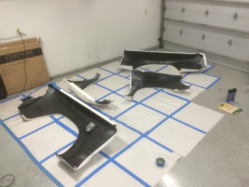

    Fiberglass:
