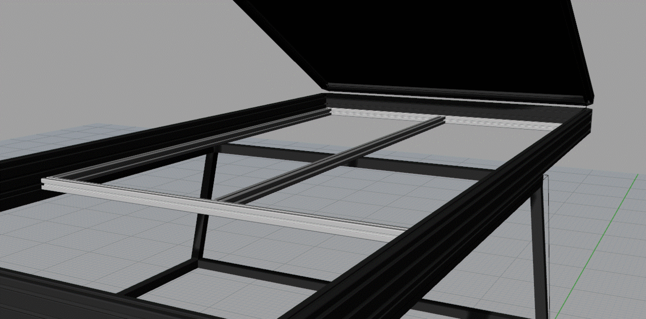

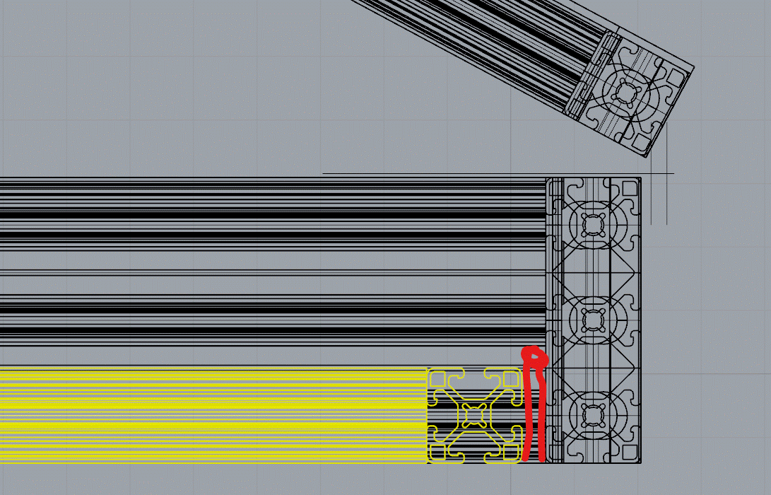

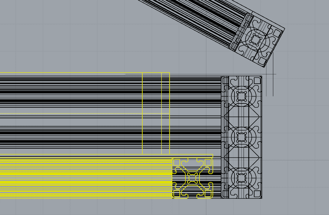

    No, still using the 1.5" on top. Even with a 3" mattress, I'll have 1.5" of space for the tent canvas and bedding (likely just have a fitted sheet on, and then keep the blanket folded up in the truck). I'm using the same hinges that are used on the outside, and attaching to the inside of the extrusion.
