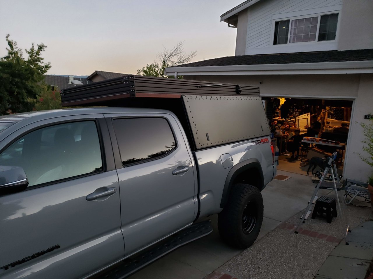

    Finally mounted the camper just in time for a camp trip this 4th ofJuly. Pretty stoked how it came out. Just need to tweak some stuff, but overall happy with the build. Exped megamat is sooo worth it lol. 20210624_204724.jpg IMG_20210705_172246_155.jpg IMG_20210705_172246_163.jpg

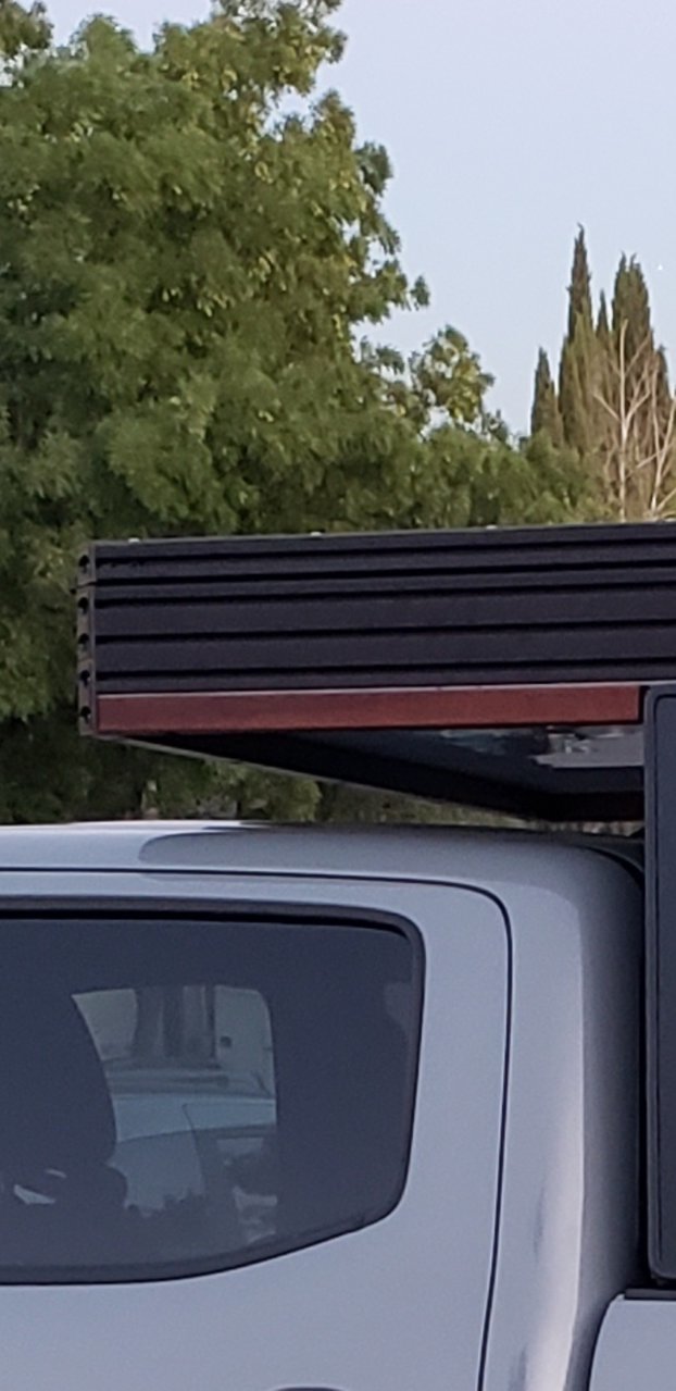

    Looks sweet! Love the all-black, including the corner brackets - that's the direction I've gone. Nice to see it.
    What did you use on the bottom edge of the cabover cantilevered portion? I can't tell what it is, but I'm referring to the dark red or brown component.

    @davzx thanks. Over the cab is ipe wood. I made my camper 1 1/2 inch taller for a shower pull-out in the future.

    What did you do with wood? We need more pictures

    @JMcFly I just used 1.5inch square wood as a trim piece over the cab. Brazilian Ipe wood is a pretty dense wood used for outdoor decks. Attached them with t bolts and nuts. Pretty simple. Still working on a plan for a pullout shower or table. Screenshot_20210706-213803_Gallery.jpg
