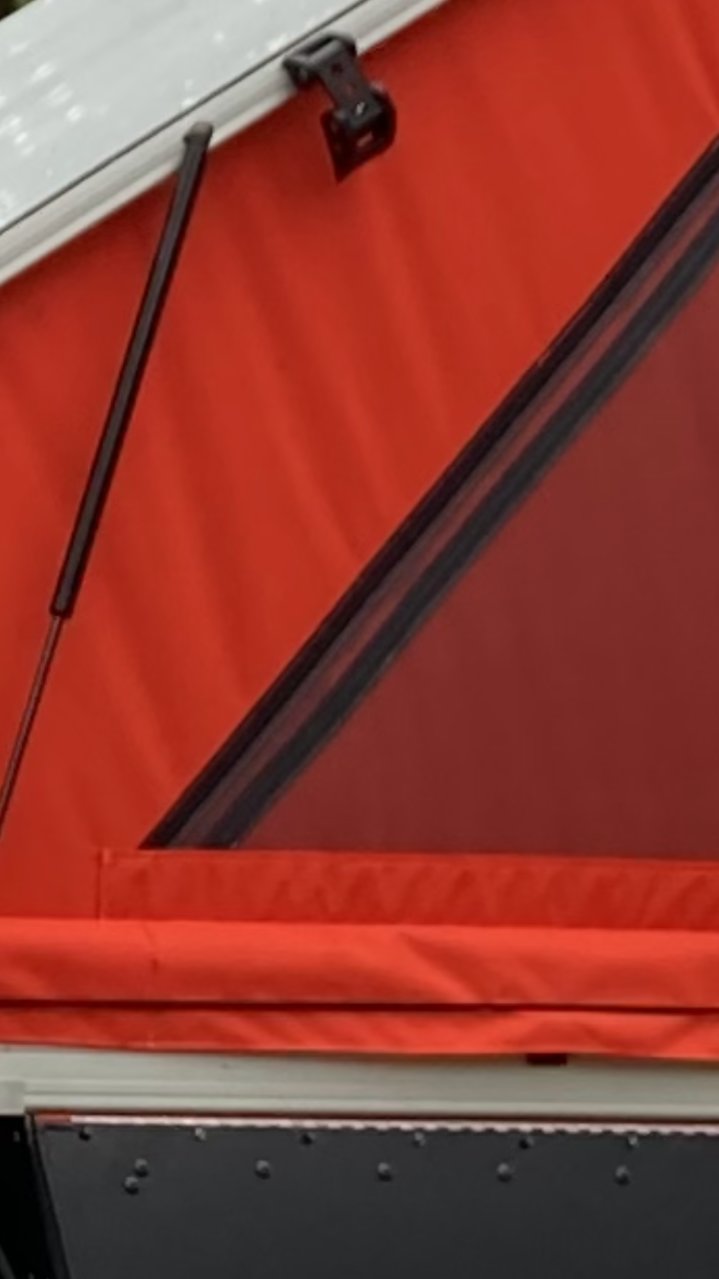

    I'm also about to be in the same spot. My side windows I have the mesh fixed (without a zipper) but the canvas has zippers off to close the windows. But When I do the back window I want the mesh to have a zipper as well as the canvas portion. I have been running it through my head how to set these zippers up and a picture would help.

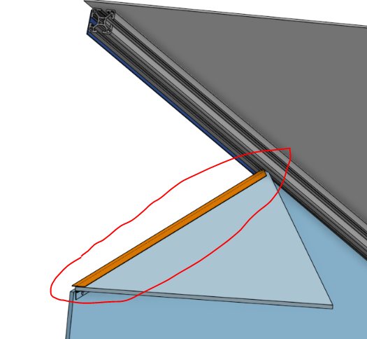

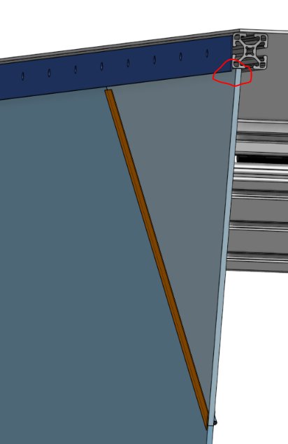

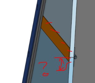

    I think that I also got weather proofing on the top little corner.
    Also by cutting it to less than 48 inches height it means that I don't need a larger 5'x10' panel, but can stick to the more common and cheaper 4'x8'
    Do you know how much over lap is necessary to ensure a good seal?
    any rules of thumbs?
    Thanks for the feedback

    does this picture helps with your question? just make the zipper of the mesh further out.
