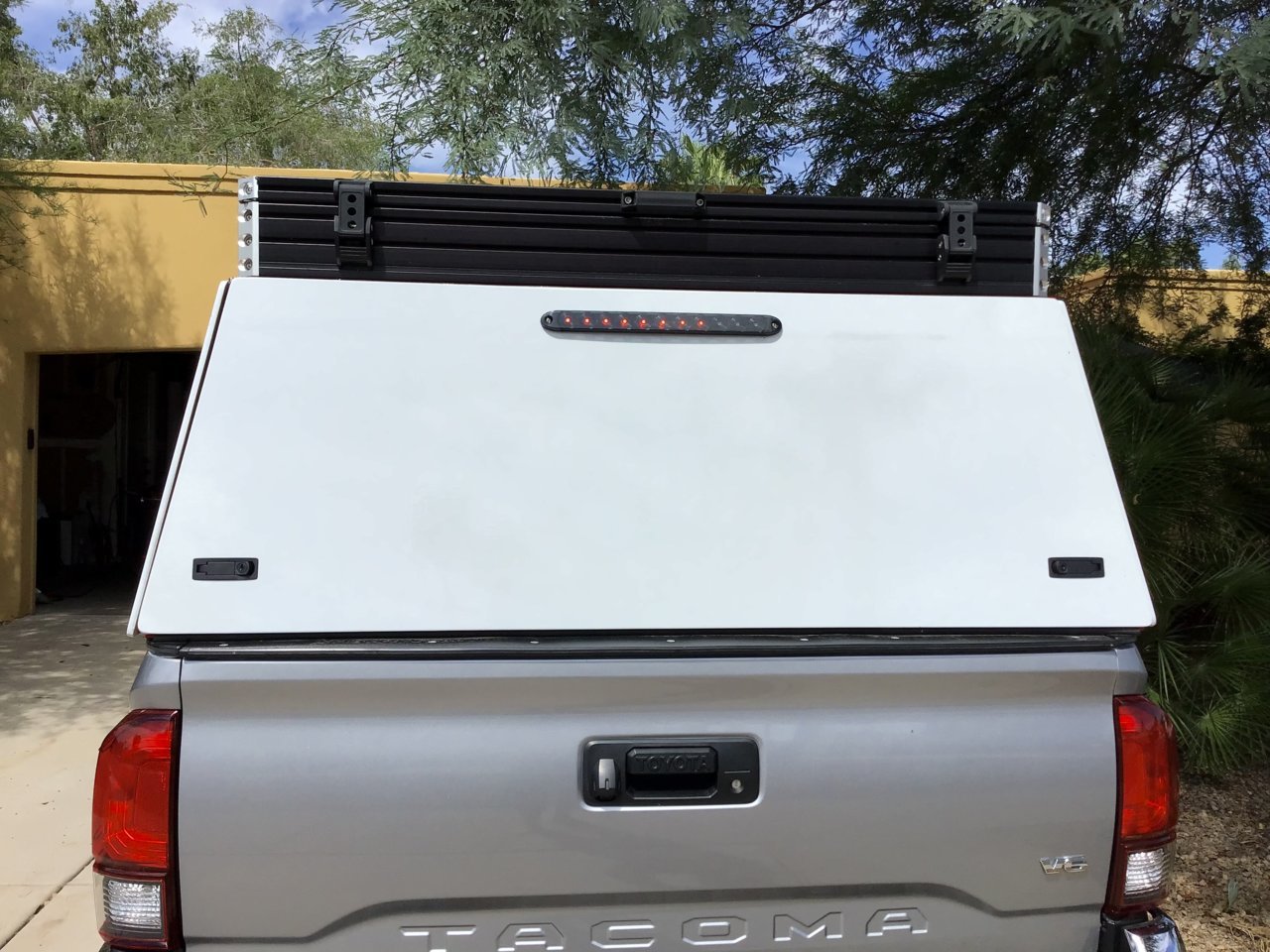

    If anybody has not gotten to this part of the project, I don’t recommend these 3rd brake lights. Dead after one year. My hole pattern is set up for these so I’ll buy another one but when I install the door wrap I think I am gonna try and find something a bit higher quality.

    Seattle WA
    17 DCLB 4x4 TRD Off Road Previously '12 DCLB 4x4 SR5
