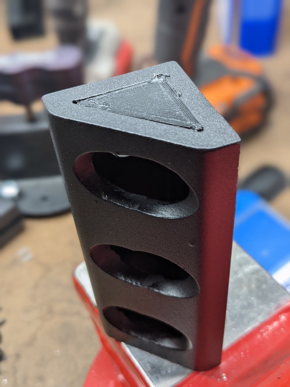

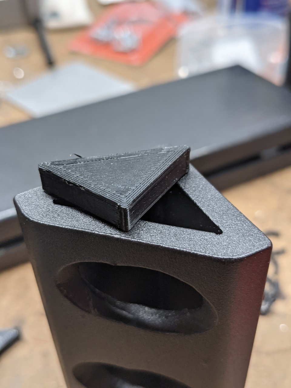

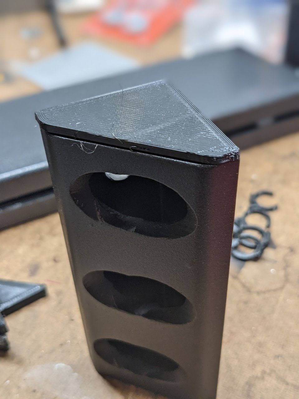

    I spent a few minutes drawing these up in CAD.
    PXL_20210916_053410449.PORTRAIT.jpg PXL_20210916_053423678.PORTRAIT.jpg PXL_20210916_053434894.PORTRAIT.jpg
    They take up the exact amount of space needed to become even with the extrusion, and can be siliconed in to make them water tight.
    I went with red for some flare too.
    Thingiverse files to come. I'm happy to print a set for the cost of shipping if anyone is interested (DM me).
    EricGinTX, Ayoung208, M61guru and 4 others like this.

    those are slick!

    look at you being fancy. I just put a piece of carefully trimmed cork there and to fill the gap between the 2x and 1x external gusset.

    That’s clever! I used silicone pieces I cut out of a .250 thick sheet and sandwiched then in with some silicone.

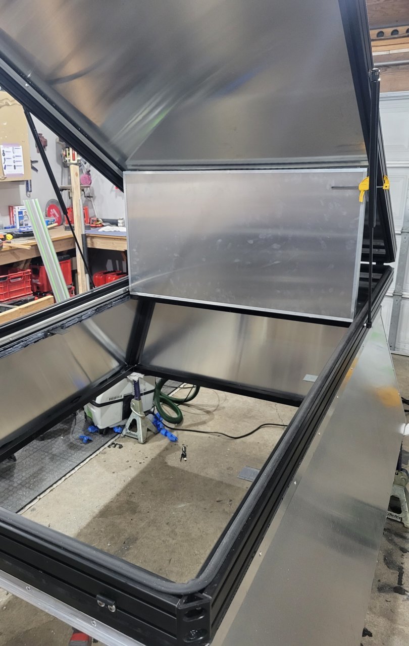

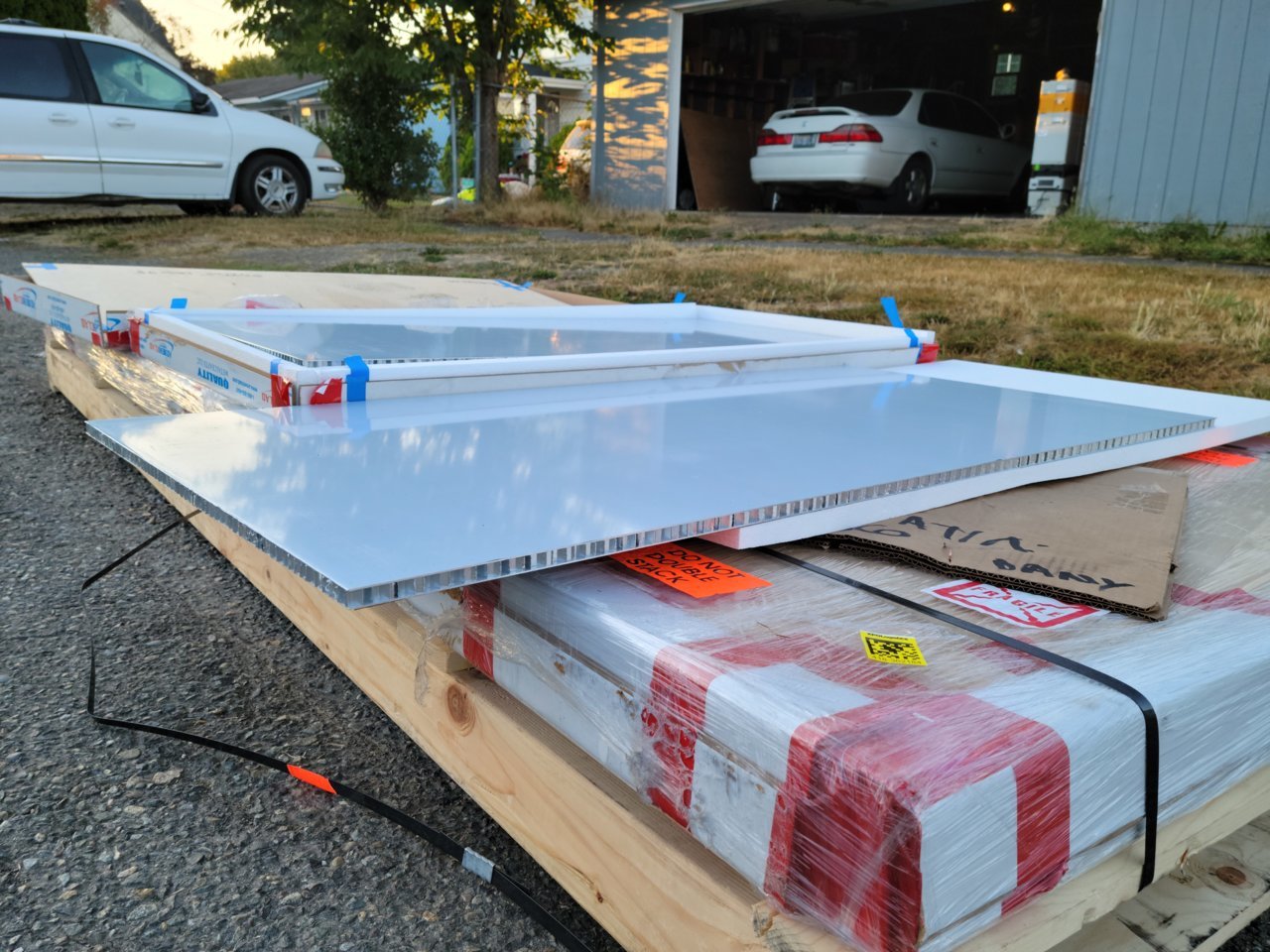

    Hey there, for my entire camper build I used aluminum honeycomb panel from flatiron panel products. Super light and super strong stuff. Very expensive however. I did a foldable floor in mine with their 1/2 inch material. Seems plenty strong for two people.

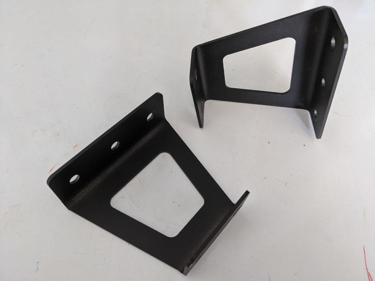

    I have an extra set of awning brackets if anyone needs them.
    Laser cut stainless steel and powder coated black texture.
    Mounted once and removed.
    $40 to your door. SOLD!

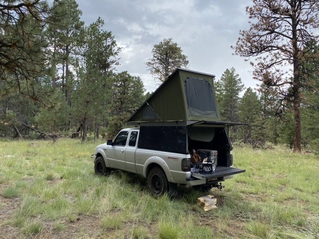

    If anyone is interested I am selling a 6ft wedge camper in Phoenix built to ripcords spec, it’s for a Tacoma 3rd gen 6ft but I also made brackets for it to fit an older ranger 6ft. Asking 4800 obo

    How would these line up? I've been looking to mount my awning back to the wedge, haven't really spent much time on it though
