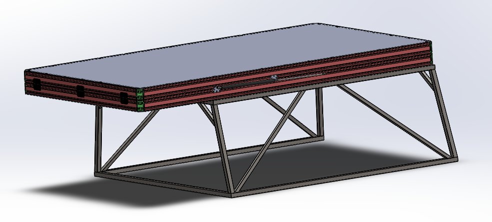

    This thread has a ridiculous amount of information and talent. I am about to start ordering materials for mine but have a few questions. I'm also planning on doing the space frame and finishing out the upper wedge before doing any of the lower doors in an attempt to get some desert trips in this fall.
    1 - 1" x 1" tubing for the floor supports to save weight - any issues? If Ripcords v1 was 1" everywhere I don't think this would be an issue.
    2 - 3" and 3" extrusions - any issues closing the tent with a 4" mattress? I would like to go this route to save some $$, gain some structure for a roof rack, not have to get full anodized extrusions, and I have less overhang.
    3 - In the @Ripcord spreadsheet, there is an alternate tent attachment method. Has anyone tried this? Or done a small test fit section? It looks like it would make installation more difficult, but cleaner.

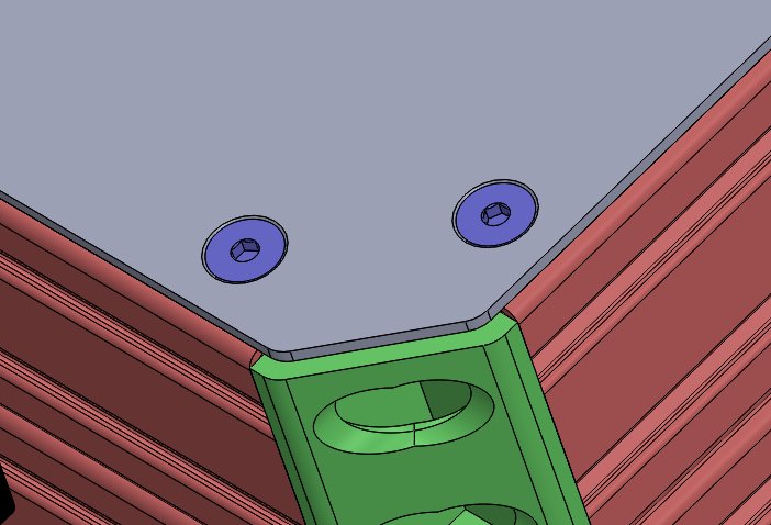

    EDIT: Question 4 - Has anyone countersunk the AluPanel for FHCS?

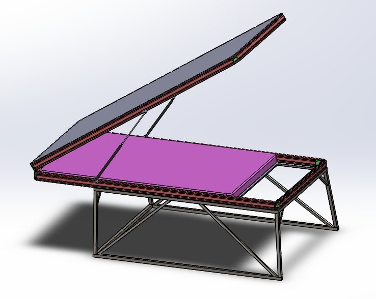

    Including SW screenshots for attention
    Thanks in advance for any and all help that you guys can provide.

    1. I used 1x1 for the floor, and it is fine. Mine is 0.125" aluminum, and there isn't much bowing with me sitting on it (200lb).
    2. No issues with the mattress to my knowledge, there are several folks on here that went with 3" for top and bottom to save time and money. Even with full overhangs.
    3. I haven't seen anyone actually attempt this yet. Honestly, it doesn't seem as worth it as just using the keder rail and cord. The reason I say this is because of the following:
    A. You'll never be able to remove the canvas for repairs/alterations without disassembling the entire extrusion portion (top and bottom). This means peeling and resealing the roof, floors, corners, etc versus just taking the keder rail bolts off.
    B. It is a sew-in plastic (PVC), which may be prone to fatigue over time as you open/close again and again.
    C. You still have to put it in the same location as the keder rail, so it doesn't save any space.
    D. It takes a special machine to sew.
    That all being said, you'd be the first to try it!
    4. No one has mentioned countersinking the heads like that. It could certainly work, but could allow for leaks.
    On a side note, your rear hatch braces won't work with gas struts (ask me how I know).

    Thanks for your response. Quick calculator says that the 16 ga steel should be stiffer, so I will stay with skinny tube.
    I hadn't thought about the need to repair/upgrade the tent later. It seems like it would be cleaner, but not worth it. Work does have a sewing machine that we use to go through 8 layers of structural nylon webbing, so I wasn't concerned about that part.
    Thanks for the heads up about the braces. I am still planning on putting all the doors and struts in SW to check everything, maybe I'll end up with a plate gusset.

    the ACM panel is rather thin, not much there to countersink a fastener.
