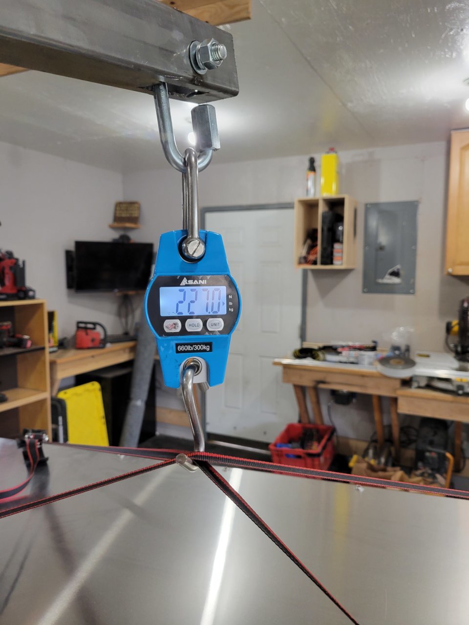

    108
    Washington

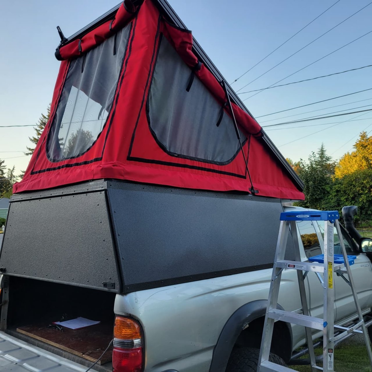

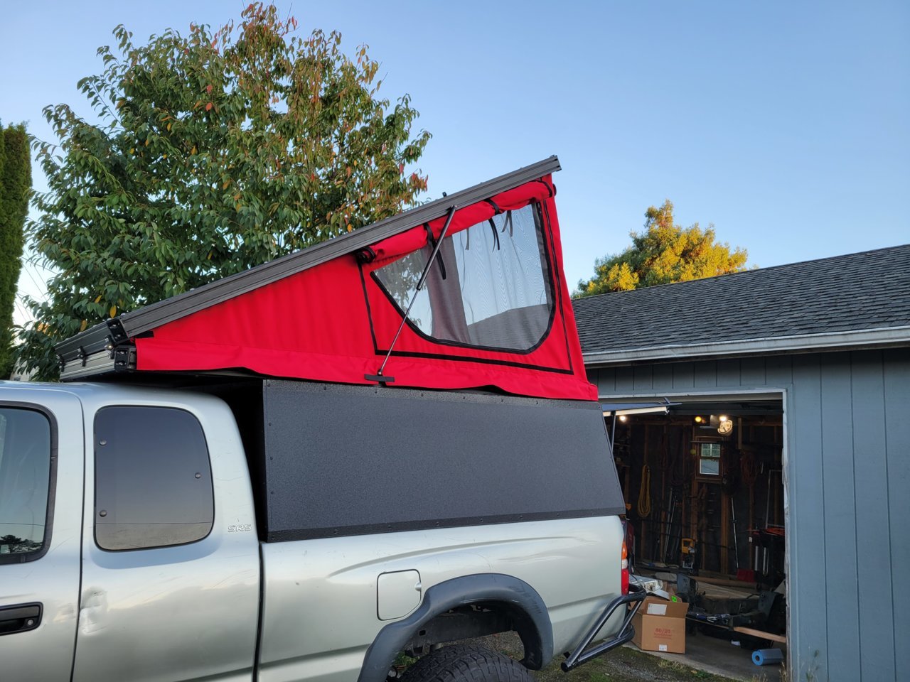

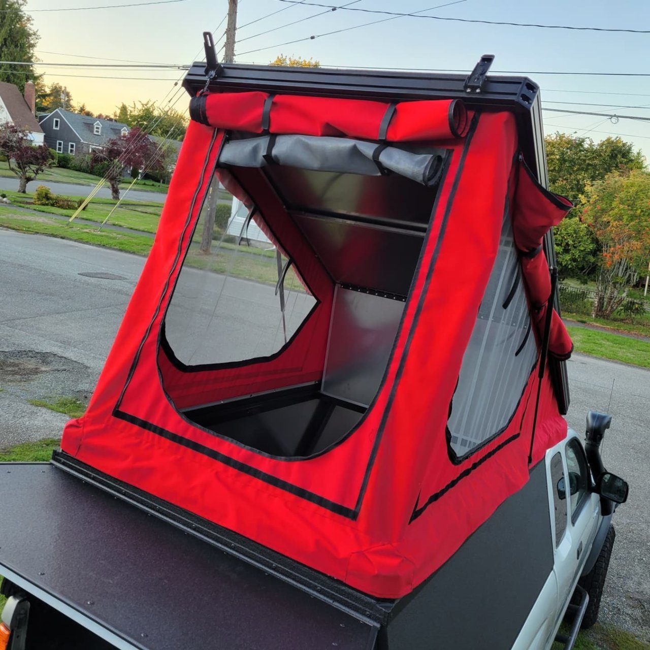

    Well guys I'm done with the tent and canopy portion of my build.
    Now I can start the interior build,solar,heater fans and a few cabinets to keep all the gear organized.
    I used 1/8 thick aluminum honeycomb panels for exterior paneling from flat iron panel products Inc. For my folding floor it's 1/2 aluminum honeycomb as well.
    Due to the fact that I don't have two side doors I didn't add the extra supports in the middle and am using the rigidity of the paneling being bonded and riveted as the extra support if it even makes a difference.
    Also for the pnw the single door made more sense to keep the rain and cold out.
    Total weight of canopy without fabric and line x coating was 227 lbs.
    Assuming that line x and primer probabaly added 5lbs and the tent adding another 10lbs I'm under 250lbs for the final weight and I couldn't be more stoked about it!
    Thank you @Ripcord for your write up. It gave me the drive to just build one myself and my goal was to make it look as professional as possible and I think its pretty close to passing as a company made product.
    Check out my Instagram for more @pjs_projects_
    BRFab, M61guru, franzgod and 9 others like this.

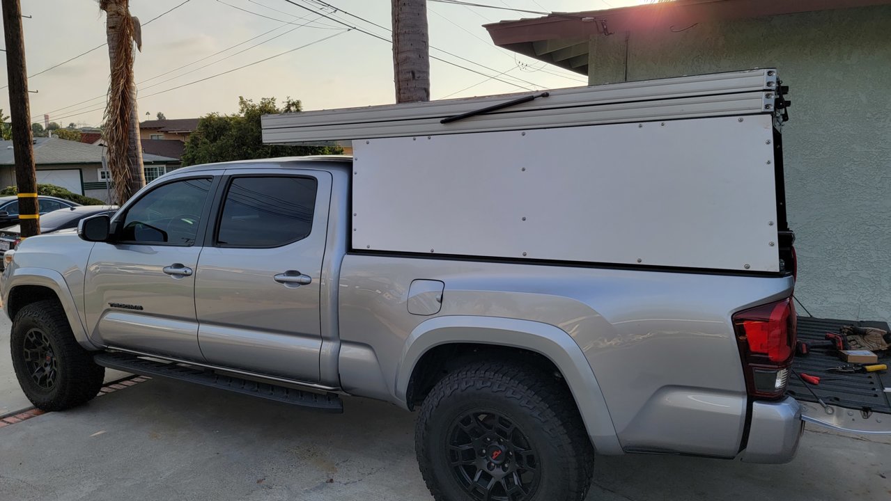

  20. Oct 13, 2021 at 11:45 AM
    #2320
    Bassshreddin
    Bassshreddin Well-Known Member
    Aug 11, 2020
    #337315
    96
    Wes
    2019 Tacoma trd off-road
    RLD canopy, icon stage 1 lift.
    Well,
    If anyone in the LA area is interested in a complete build camper based off ripcords design, I'm possibly selling mine. Only thing left is the tent portion. Sides are bolted on and can have windows if wanted. Used 6mm panels instead. Sits high enough to clear the shark antenna. Just don't have the time to finish the canvas, nor do I have the patien. Material is all cut out and ready for sewing. Along with netting and zippers, keder and see in keder. Will also throw in extra paneling and 1.5 extrusion to build what you want and the sewing machine. Asking $4k obo.
