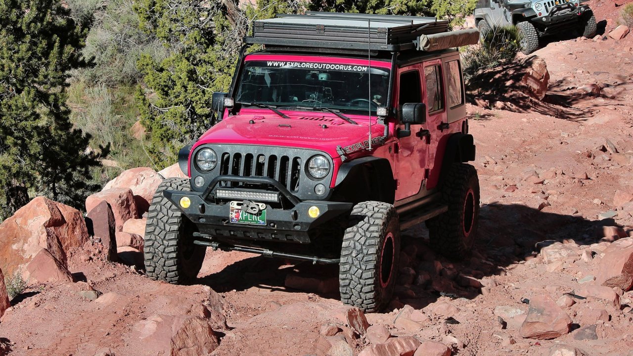

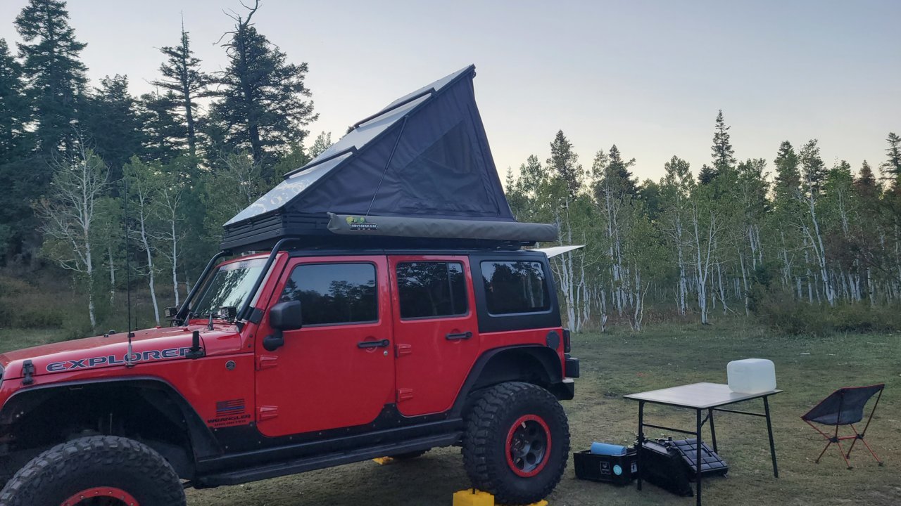

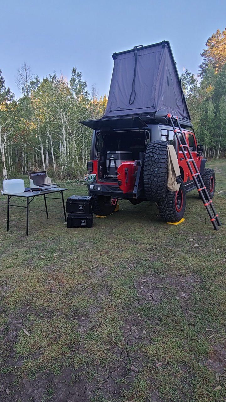

    Here's my RTT on my '15 Wrangler Rubicon. MUCH respect for y'all that built up the whole camper. Sewing the tent was the hardest part of this project.

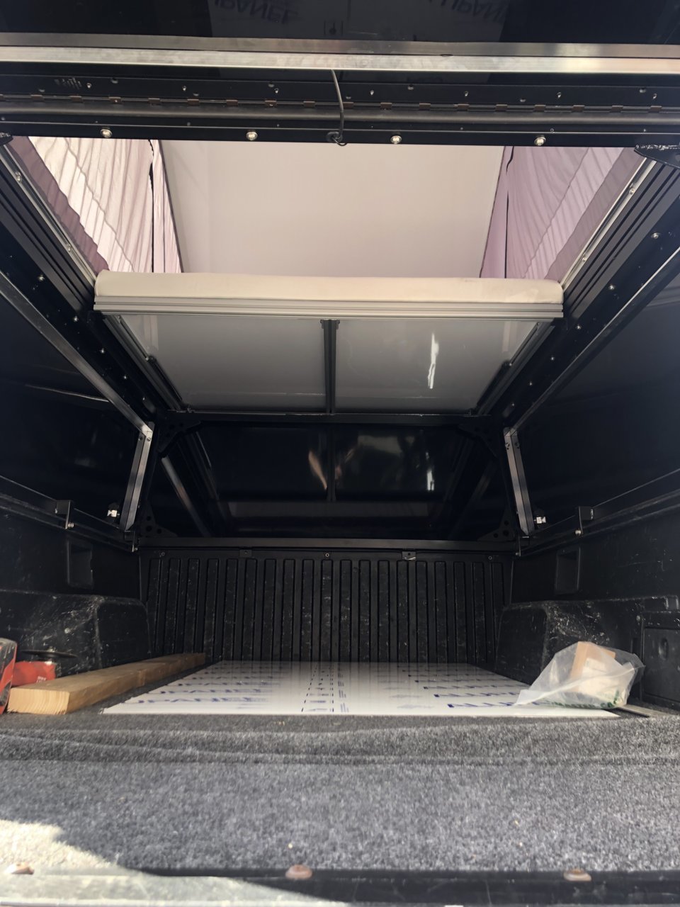

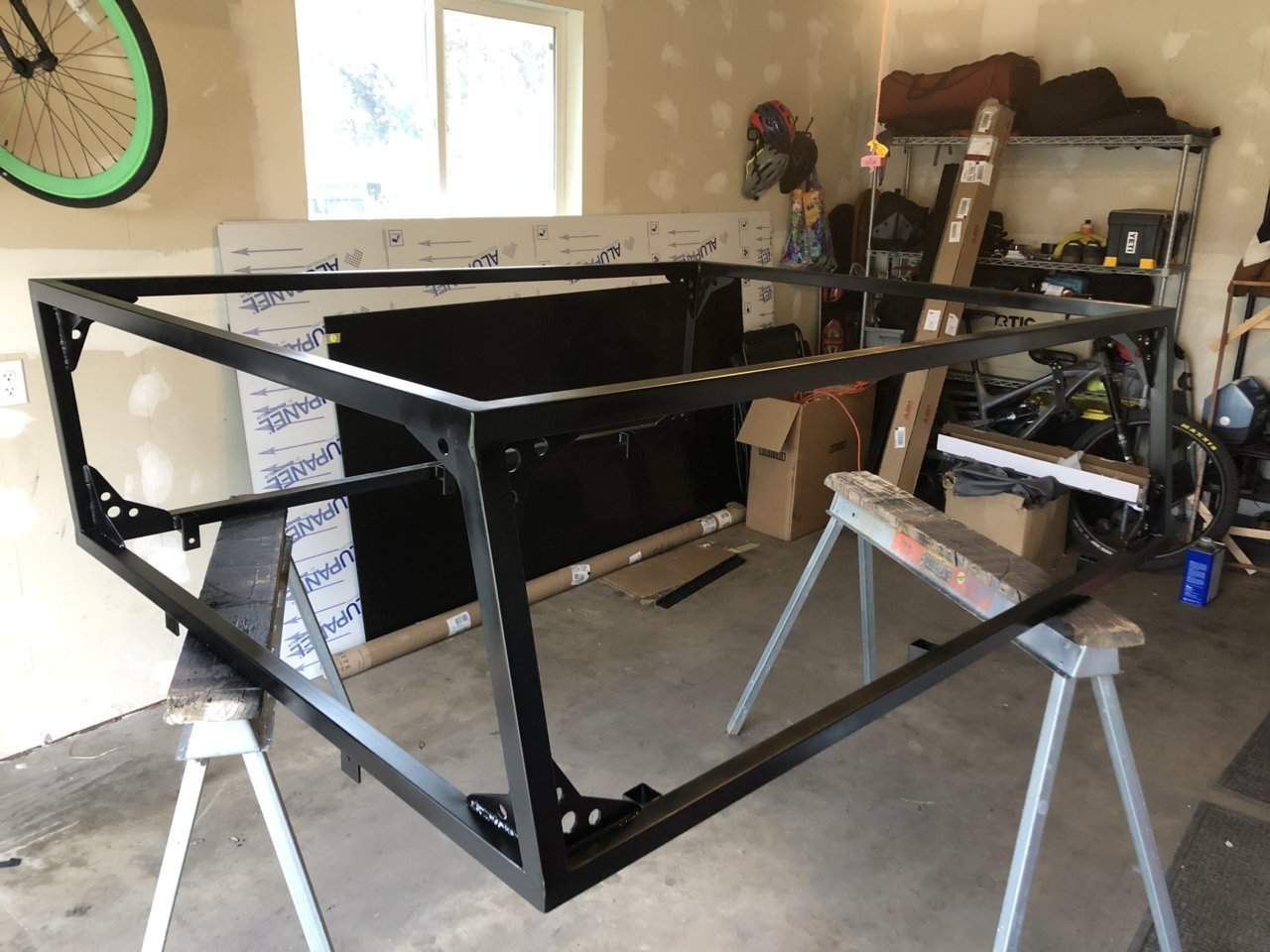

    Finished my build recently, and wanted to share some changes and experiences.
    I went with 1.5" 0.125" wall aluminum tubing. This was not only to save weight, but also to save money as currently where I live (WA) aluminum is a lot cheaper than steel. This was possible since I had an AC/DC TIG welder, but one could get a spool gun for their MIG welder with great results. A lot of places use spool guns building truck boxes and bumpers, and they come out very strong.
    I also elected to go with the flip up bed like @jjnicolas and others, but I took it a step further and made a second flip up platform that can be used as a standing desk inside the tent for cooking or anything else when weather is bad. It also sections off the top area of the tent from the bed of the truck.
    The piano hinge route is also a huge plus. The hinges are stainless 72" long pieces from Home Depot, and the fabric was excess strips I cut to 2" wide. This is how @Taco Camper did his, and while they ultimately will require the replacement of the fabric, it won't be for years to come. The fabric ends up getting silicone on both sides.
    I ended up having access to a mill and end mill bits, so instead of stacking the smaller corner pieces I have single pieces. When you order the raw stock from 80/20, get 19" instead of the 18" as listed in @Ripcord material list. This lets you use a chop saw with a metal cutting blade to cut it super straight, and the extra inch will mostly be absorbed by the kerf of the blade taking away material when you make your cut.
    I used the same 3mm paneling as most people did, getting it from @howied who is a local PNW member. It was also great to meet another guy who had completed his build and bounce an obsessive amount of questions off of. I do wish I went with 6mm for the floor, but the roof is fine with 3mm. I made a jig that holds my router along a straight piece of aluminum tubing, and clamped it to the ACM.
    I did the upside down method as well, and yes it is a pain. It's even more of a pain when you strip out a few of the economy T-nuts. Next time I would order something that is spring loaded for when you bolt the extrusions to the frame. Going this route would prevent them from moving out of alignment and would ensure that the bolts don't start crooked and get stripped.
    Once you get everything bolted together, it gets really exciting as the project finally takes shape and your hours of hard work seem like they are coming to an end.
    For the doors, I didn't do much differently outside of one big mistake. Since I don't have a Tacoma (gasp) I didn't purchase all the files and therefore didn't realize that the bottom alumimum piece is where the seal for the top of the tailgate goes. I ended up buying a roll of rubber trim seal with top bulb on it to seal off the tailgate.
    I mentioned a few weeks prior that I also 3D printed a cap and plug for the different corner pieces. The 1.5" corner pieces are 1.313" tall, so there is a gap that will appear between the roof and floors, and other places if you stack the corner pieces. I'm happy to say these have worked extremely well.

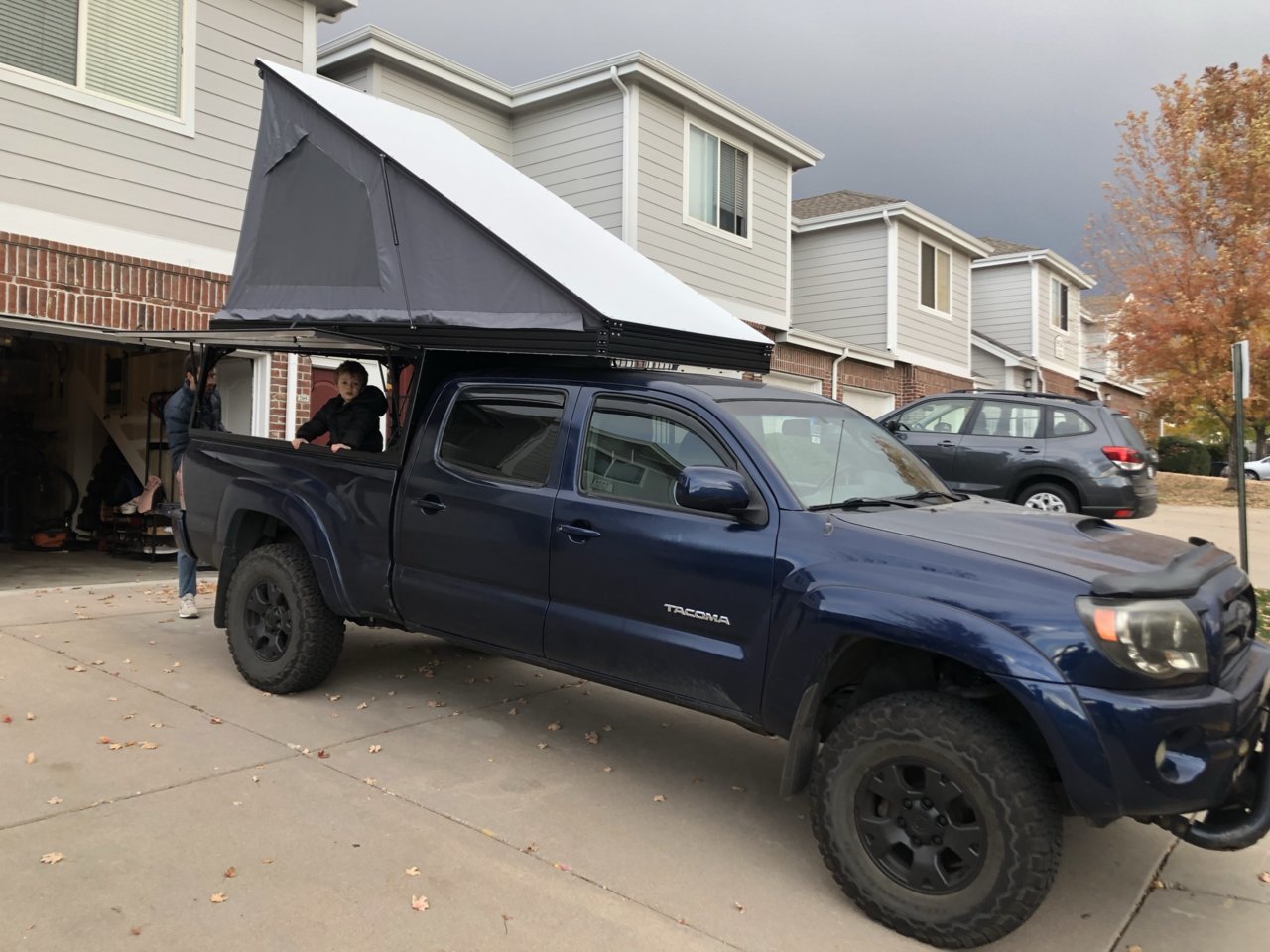

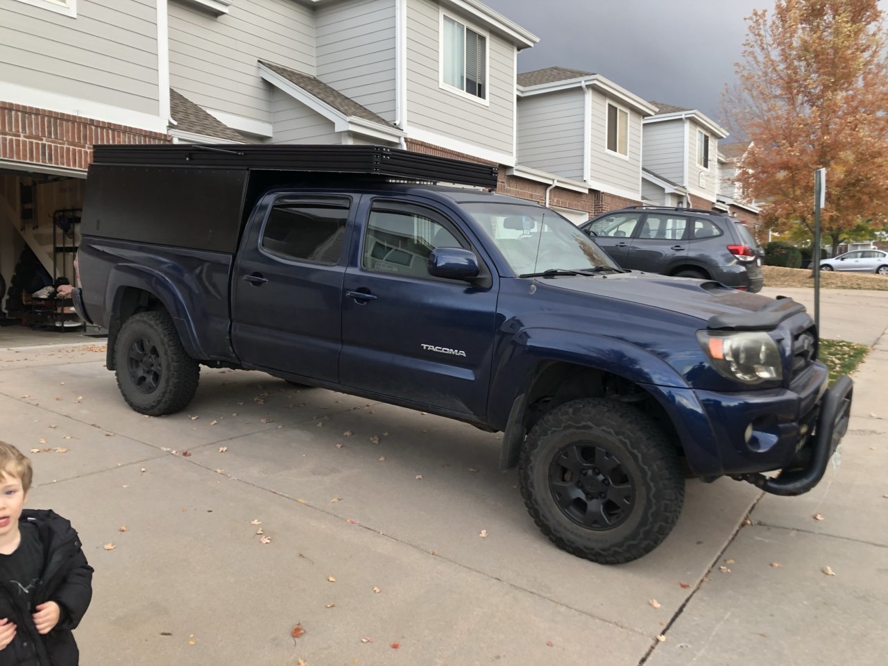

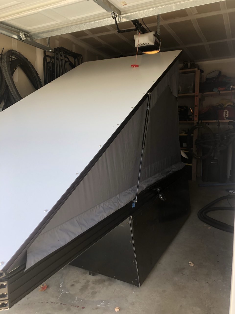

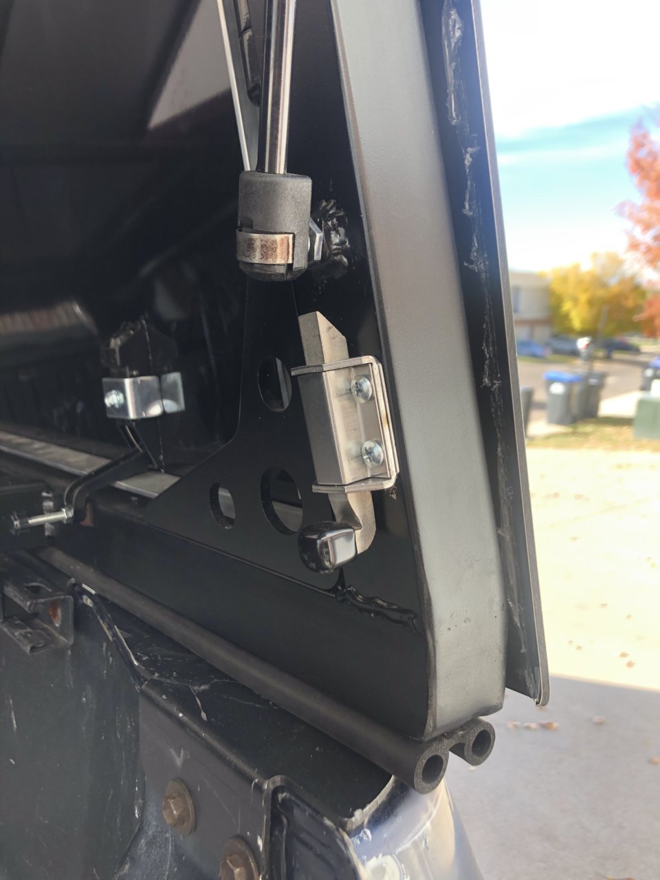

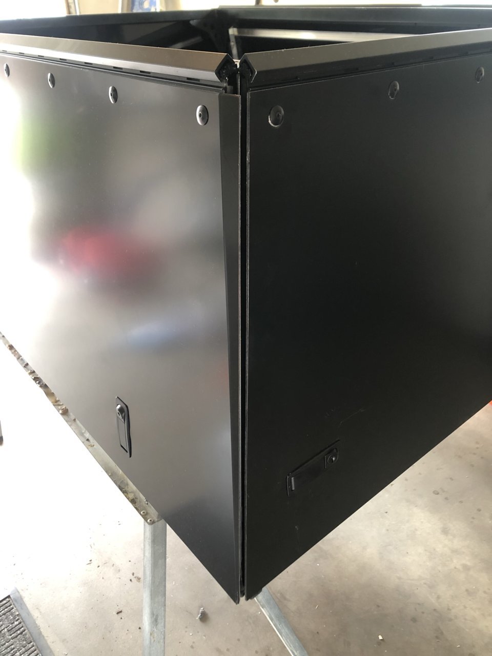

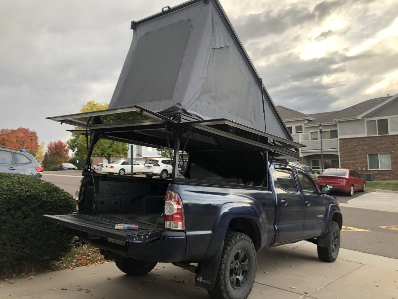

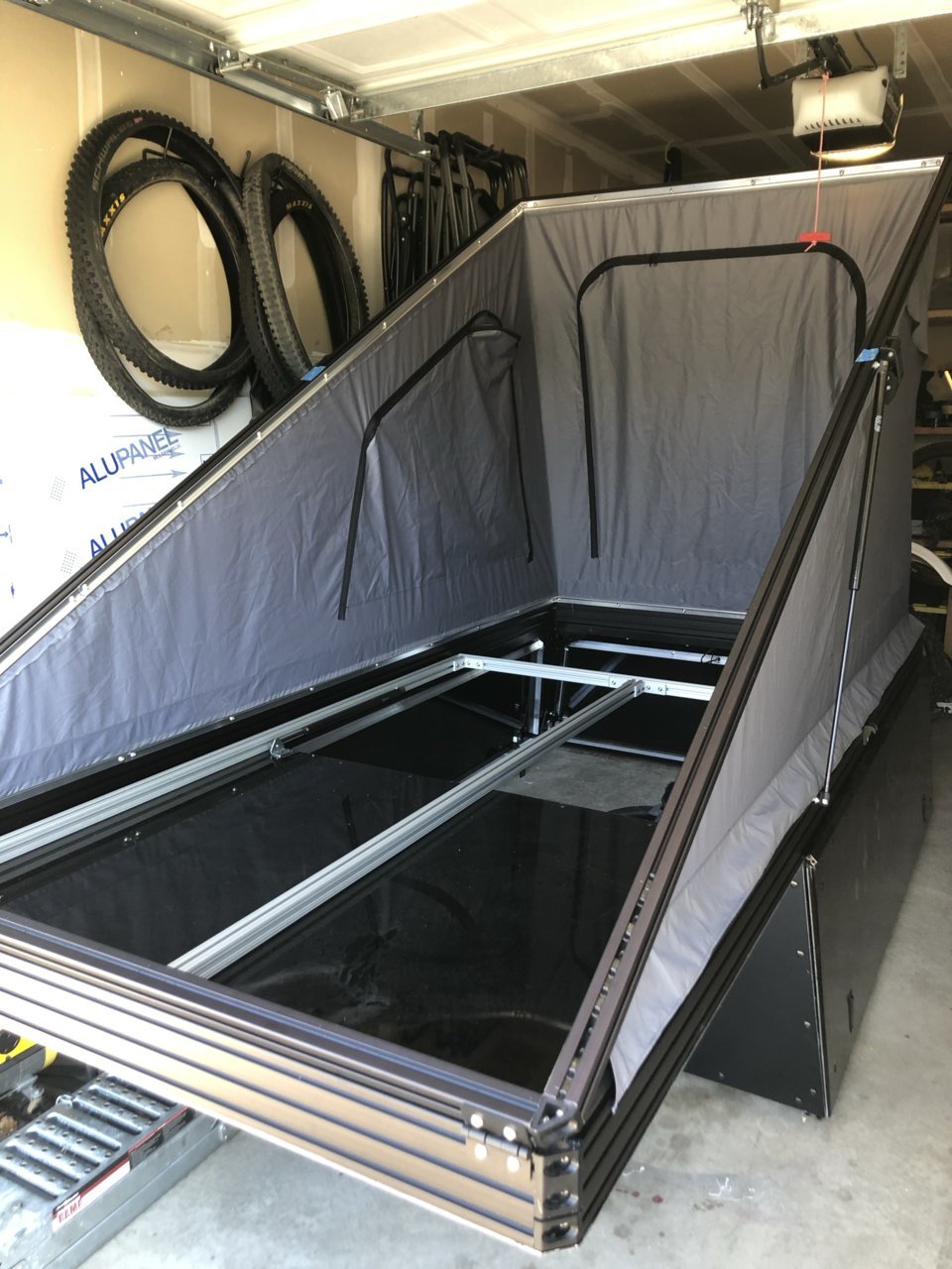

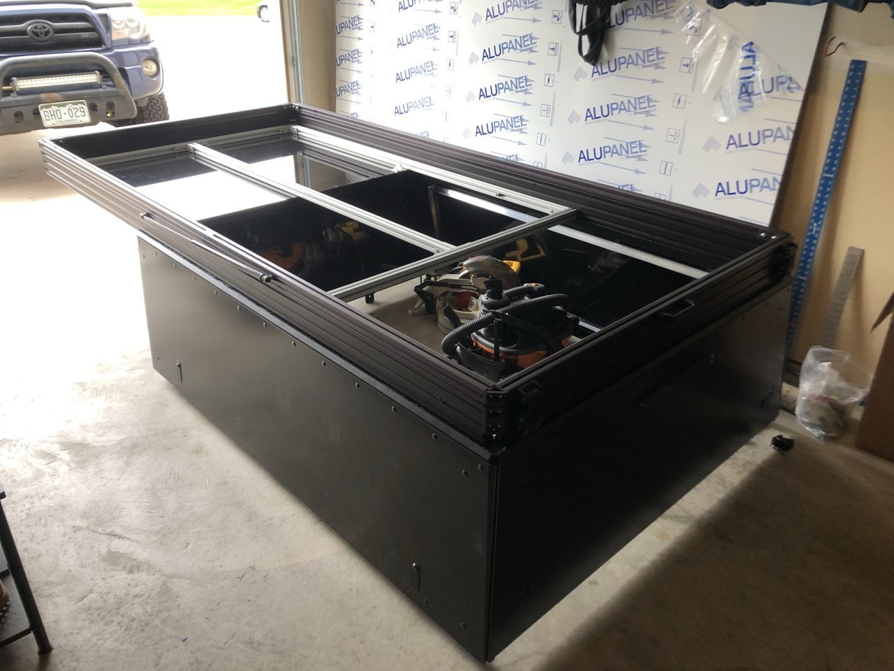

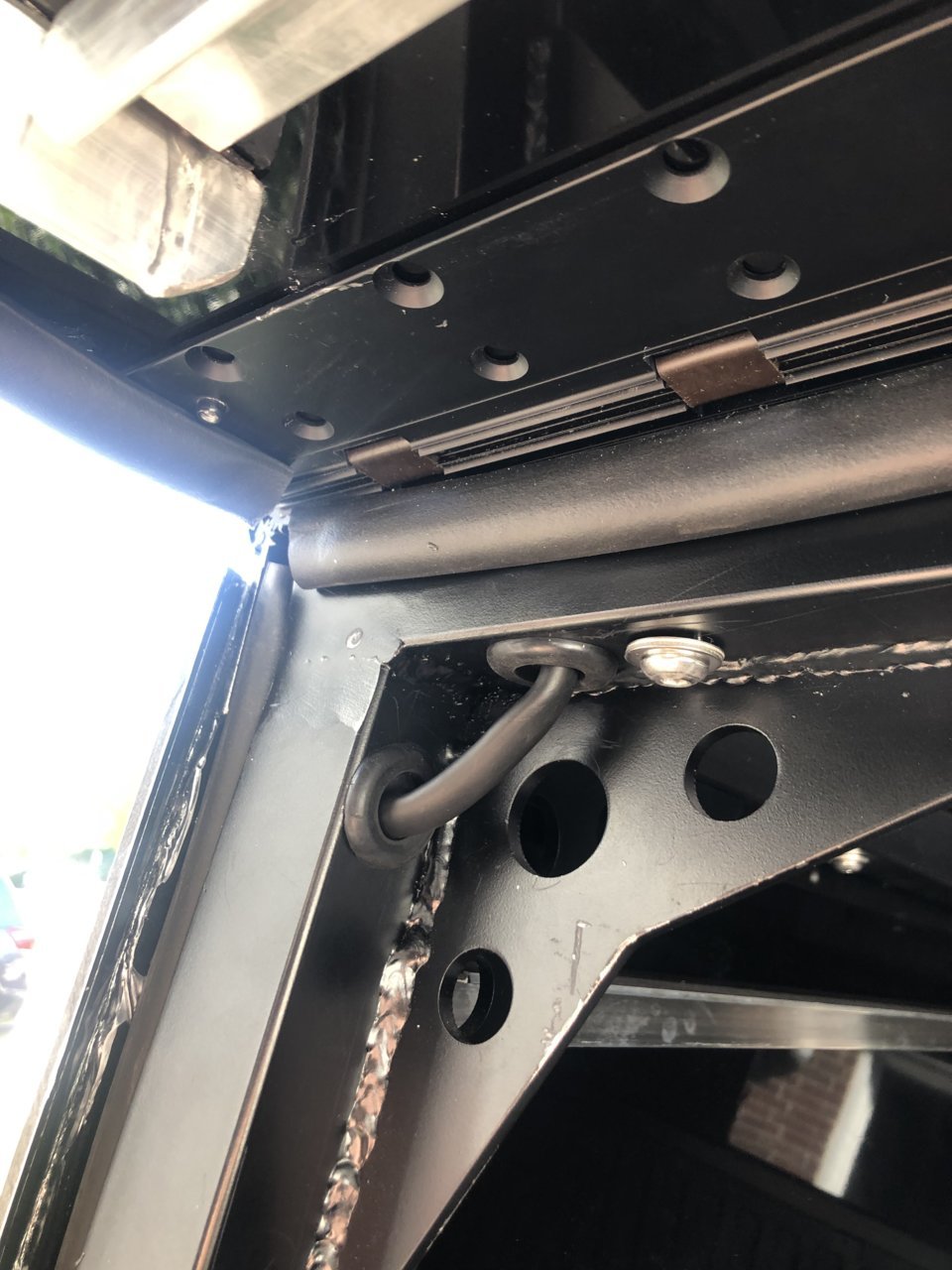

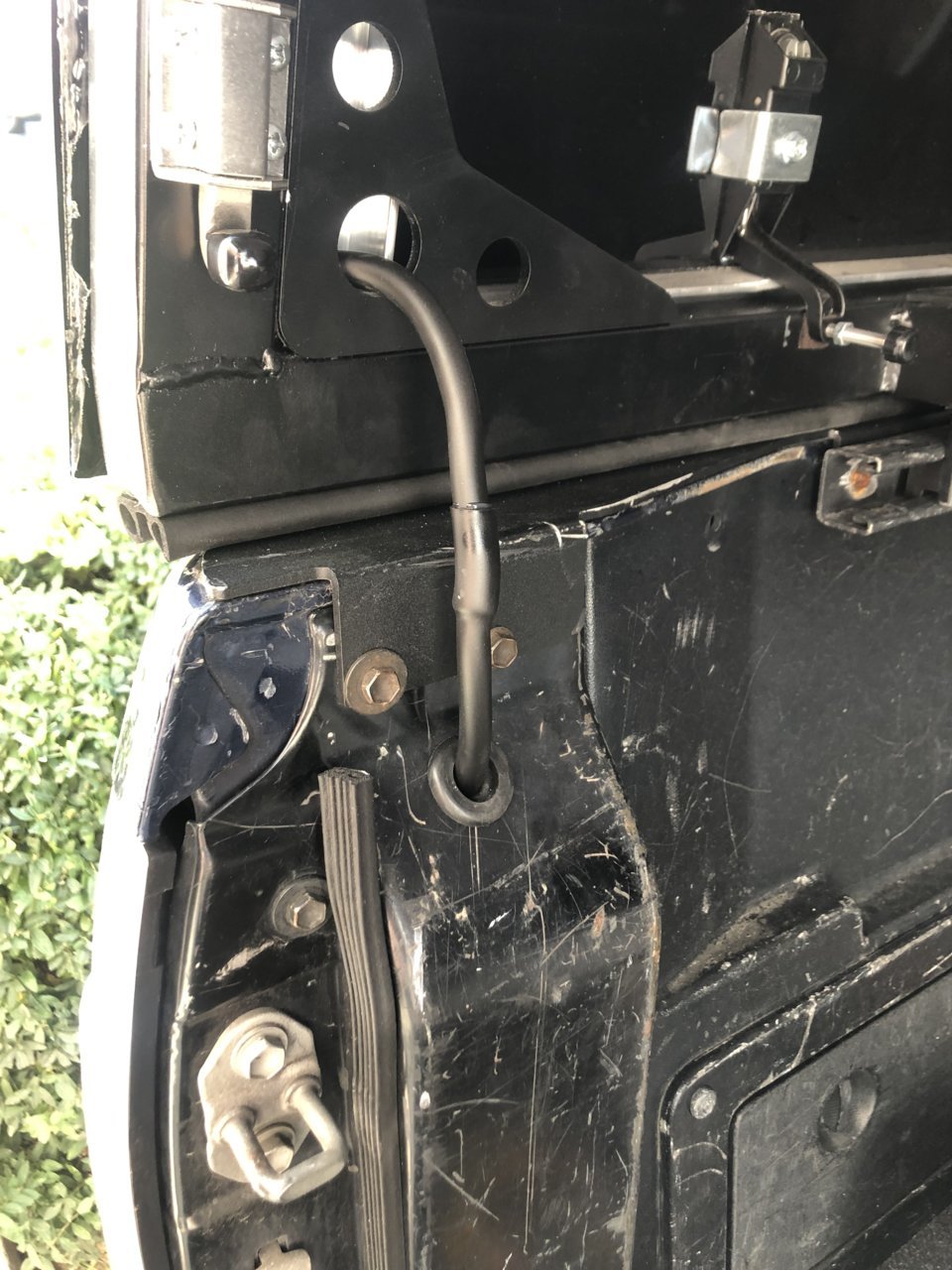

    So I started my build in May, and just completed this week and mounted it on my truck last night. I had the spaceframe portion and the tent canvas completed by early July, and was waiting on the 8020 extrusions which were delivered a couple weeks back. As soon as I saw this thread, I knew I could take it on, and I'm happy with how smoothly it went for me. So, thank you SO much @Ripcord for the detailed guide.
    I made several changes to the original design.
    • Because I have a double cab long bed, I made my wedge 120" long, and wanted a slightly wider sleeping area, so bumped it up to 57" (54" x 80" sleeping area, a true full XL). It has a 42" cabover cantilever - AT Summit is 51", so well under that.
    • The sides and rear taper about half the amount as the original. I was hoping it wouldn't look too boxy, and in the end I'm happy with how it looks. I do think the slacker taper looks better though, but I didn't want to sacrifice sleeping width.

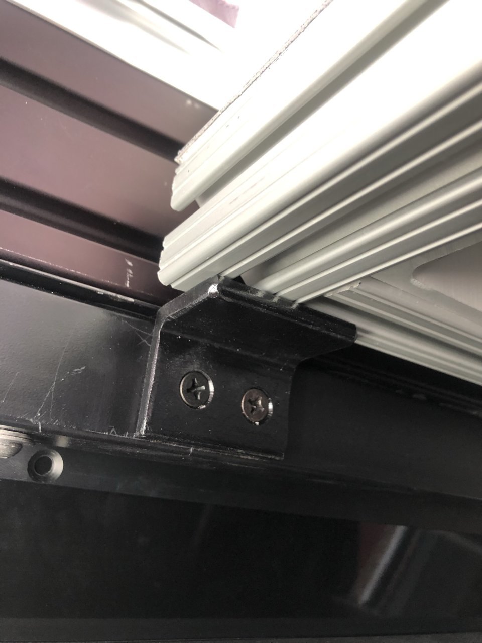

    • I made a completely separate sleeping platform, that pivots up and out of the way on gas struts exactly like the AT Summit
    • I substituted the hinges for some nice geared hinges, similar to GFC, however these are not watertight because of the bearing spaced every couple inches. I'm confident the bulb seal underneath will work well. The flanges of these hinges are almost exactly the same thickness as the 3mm ACM, so the gap between the wedge and spaceframe was perfect.
    • For my rear door, I used some spring loaded latches that the Southcos grab, for easy egress if locked.

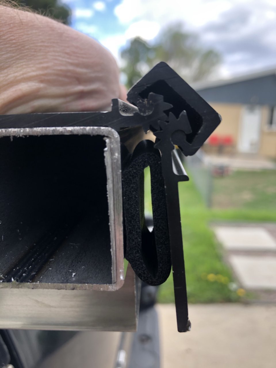

    • I didn't use any gasket - 100% silicone to me is the way to go. Not only is it waterproof, it'll fill any gap discrepancies, and it acts as an adhesive as well.
    • I used VHB tape for the stiffeners, and added a rivet at the top and bottom of the vertical stiffeners that the gas struts attach to. I didn't like the look of all the rivets. I think the VHB alone will suffice for the horizontal stiffeners, but the force of the gas struts was too much for the verticals, hence the rivets. Just one on each end is enough to hold against the shear of that.

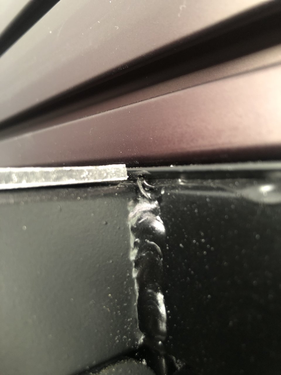

    • I bent the edges of my side panels in a bit to close the gap. I kerfed the backside and bent it, filling the kerf with epoxy.

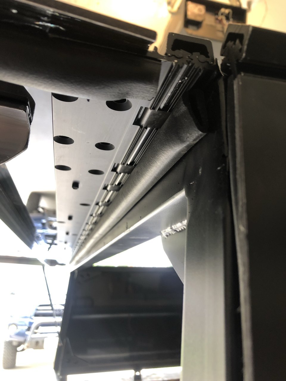

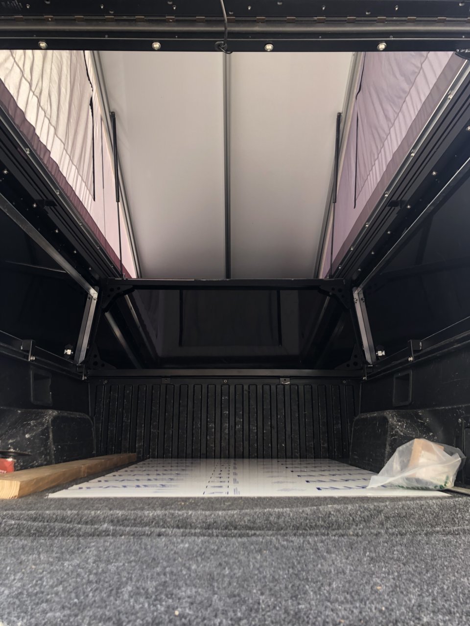

    Some tips:
    • I mounted the wedge to the spaceframe right-side-up. I used about 1/2" of shims in each corner to hold the wedge above the frame while I aligned the slot nuts with the holes, then slowly pulled the shims. Was able to get all of the bolts in pretty quickly.
    • I sewed the canvas based on the dimensions of the open wedge, rather than holding the fabric up and making marks. The measurements don't lie, and I'm happy with how taut the tent ended up. The radius of the windows was the worst part, and there is some shitty bunching on my fabric at those spots, but not a big deal.
    • Not sure if this is how most people are doing it, but I found that mounting the roof panel AFTER the keder rail made it WAYYY easier than I thought it'd be to install the canvas. I closed the wedge, attached the top of the tent, then opened the wedge and attached the bottom. That way I wasn't trying to hold any slot nuts in place on an incline.

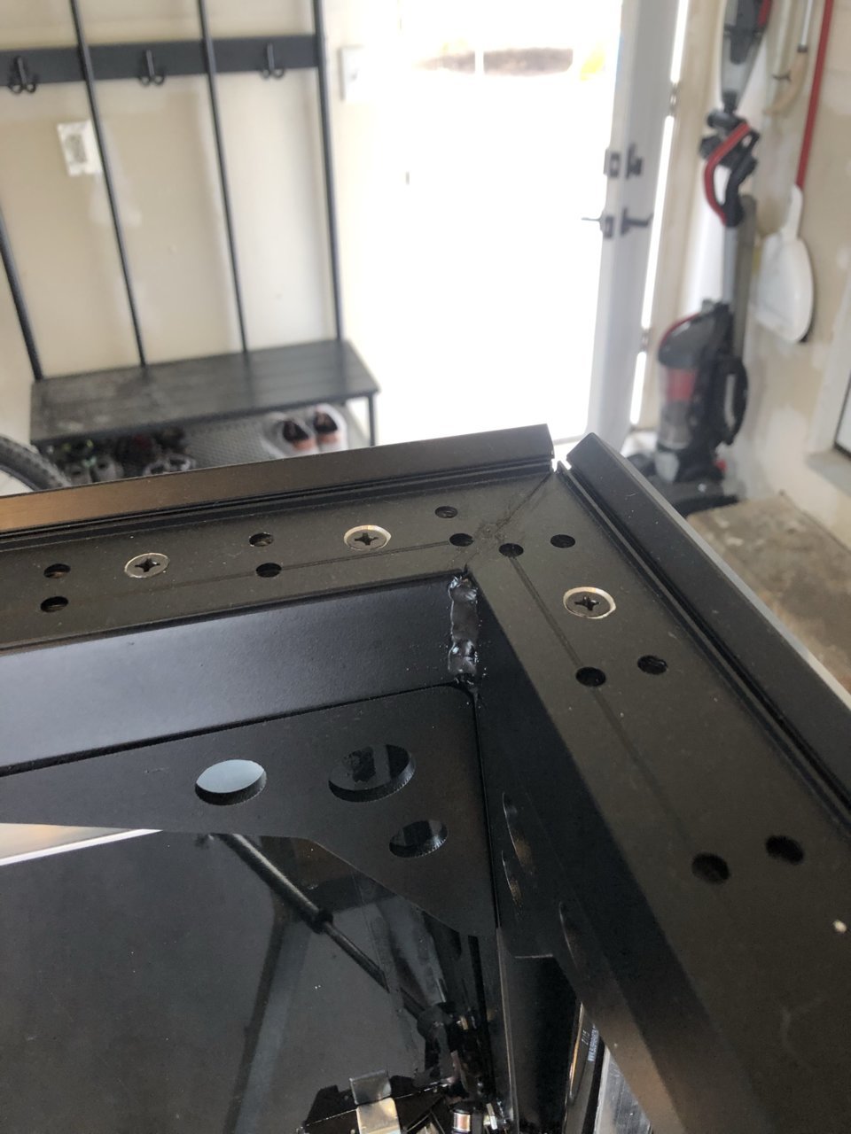

    • I didn't use the interior corner braces in the 1-1/2" extrusions. I mitered my keder rails tight to the corners. I found that using two beads of silicone between the extrusions and roof panel (one on either side of the T-slot, prevented any twist at the corners. I loosened the exterior corner gussets a little bit, tightened the roof bolts, then retightened the gusset bolts. Again, the silicone acts as an adhesive. Obviously not as stiff as the brackets, but no noticeable twist.

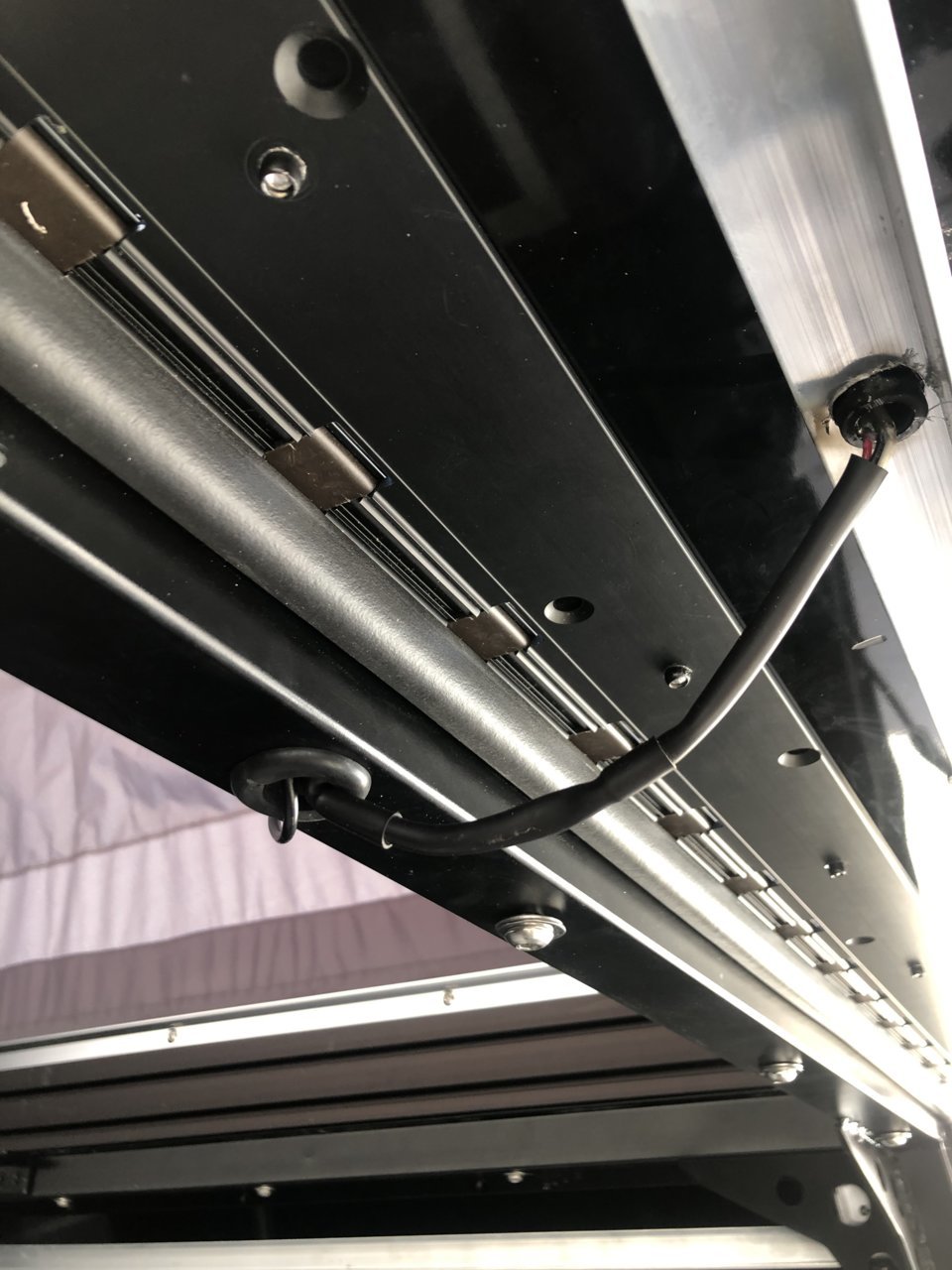

    • Internal wire routing for the brake light/rear camera can be done cleanly with some rubber grommets.
    • I'd recommend 1/8" thick aluminum angle for the stiffeners. It's noticeably stiffer than 1/16" which I used originally. I had about 1/2" of sag on the long panels, and now it's maybe 1/8"
    • Edge detail of one of the side panels. Kerfed and bent
    • The spring loaded latches that the Southcos hold on to. Just pull down and then can open the door from the inside
    • Close up of the thickness of the ACM and hinges
    • Some angle brackets to hold the cantilevered end of the sleeping platform
