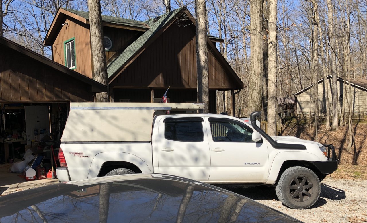

    D1CA94BF-5324-453A-BDD3-C87AE1196C8F.jpg I am in the middle of building mine. Since I work in the aviation world and everything has an expiration date! Things get thrown away that are still great to use in the real world. I was able to use aluminum core with fiberglass sheeting.

    Very nice! show us more pics
