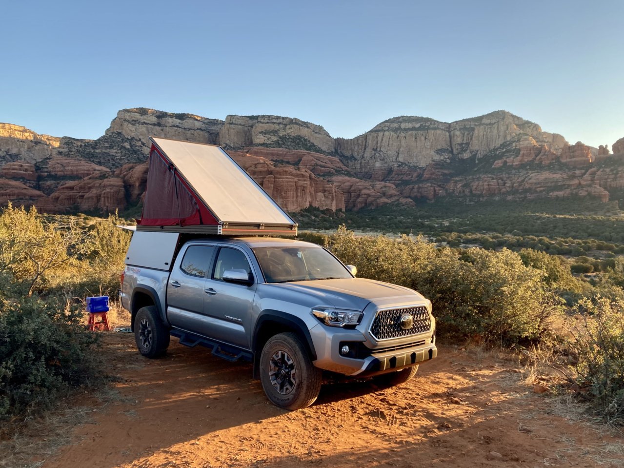

    Taco Camper
    Taco Camper Well-Known Member
    Aug 19, 2020
    #338162
    83

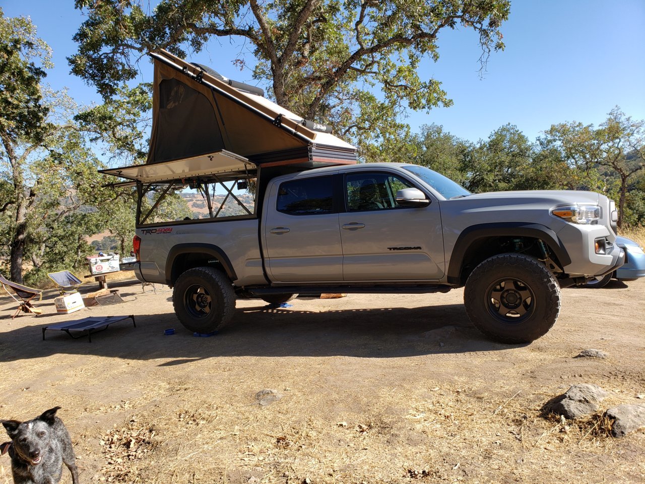

    Stay motivated builders!
    One of our favorite spots in Sedona AZ the other day after a very windy night coated the truck in red dust.

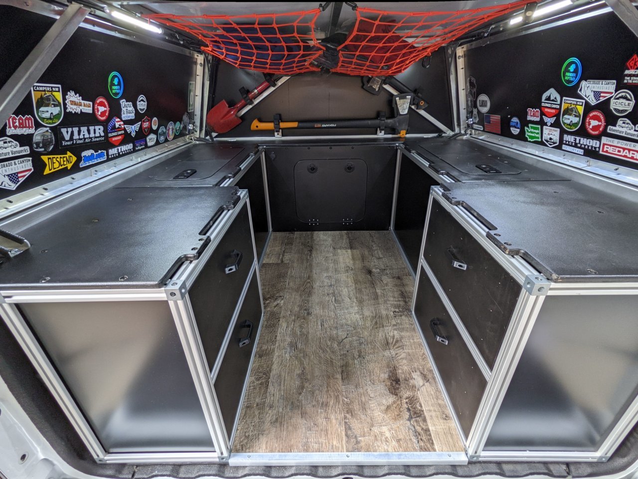

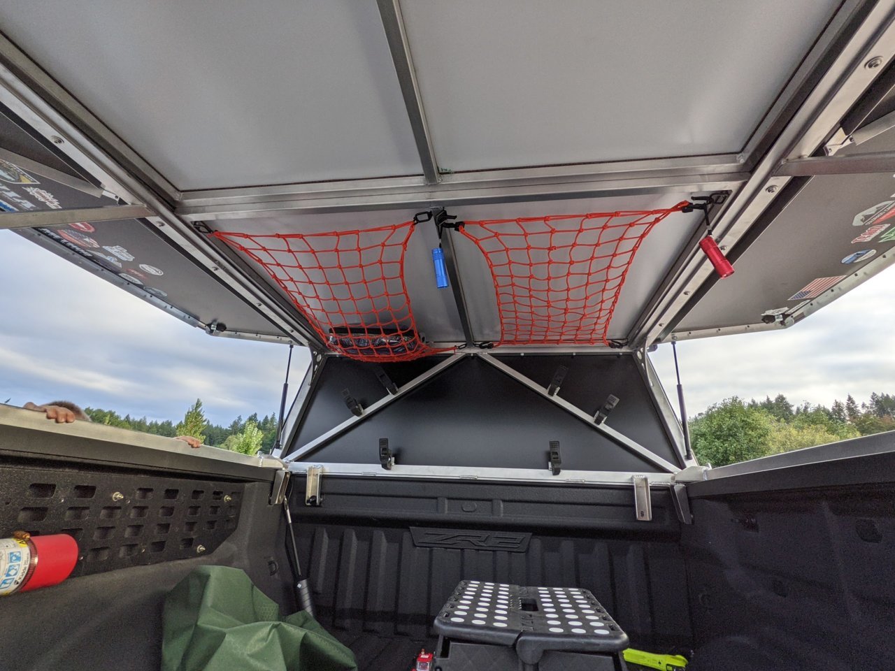

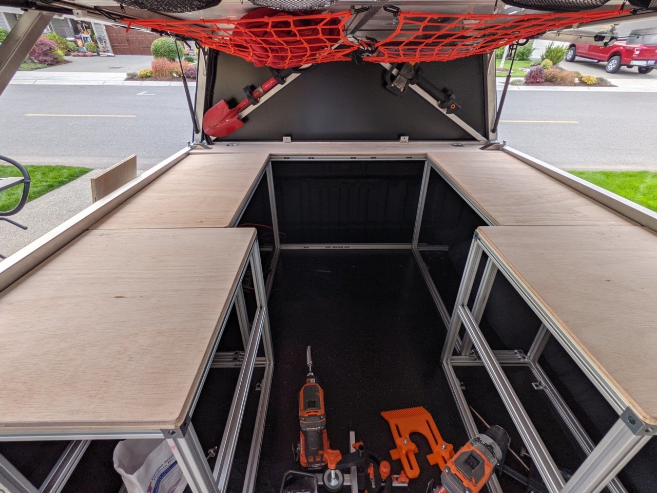

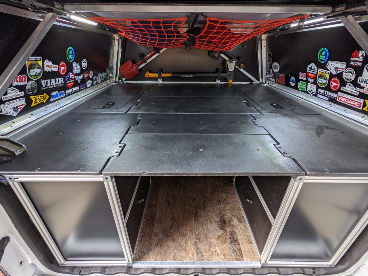

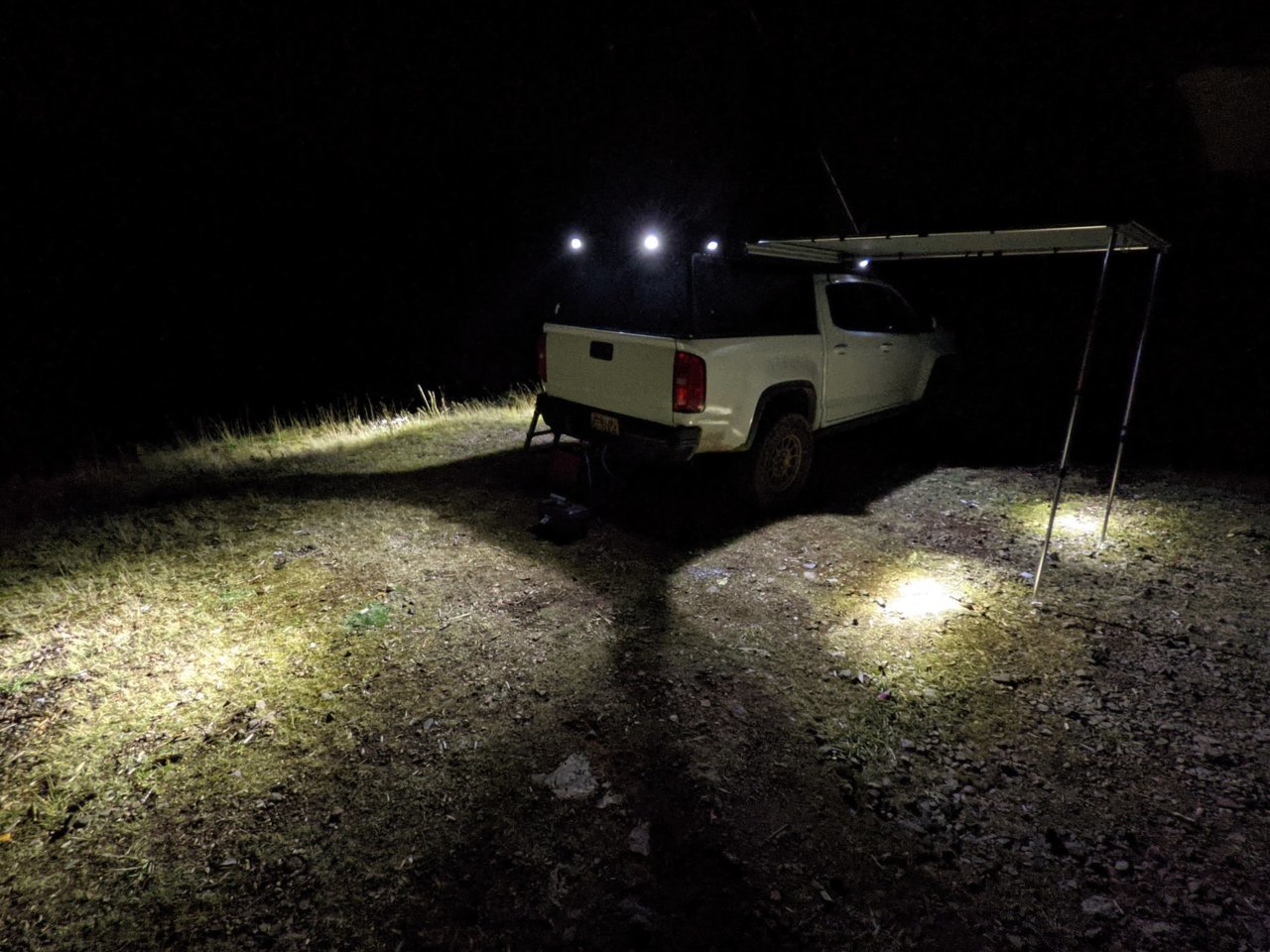

    Some photos from last two trips, and the finalized bed cabinets I made from more extrusion material.
    The juice is definitely worth the squeeze on these builds!

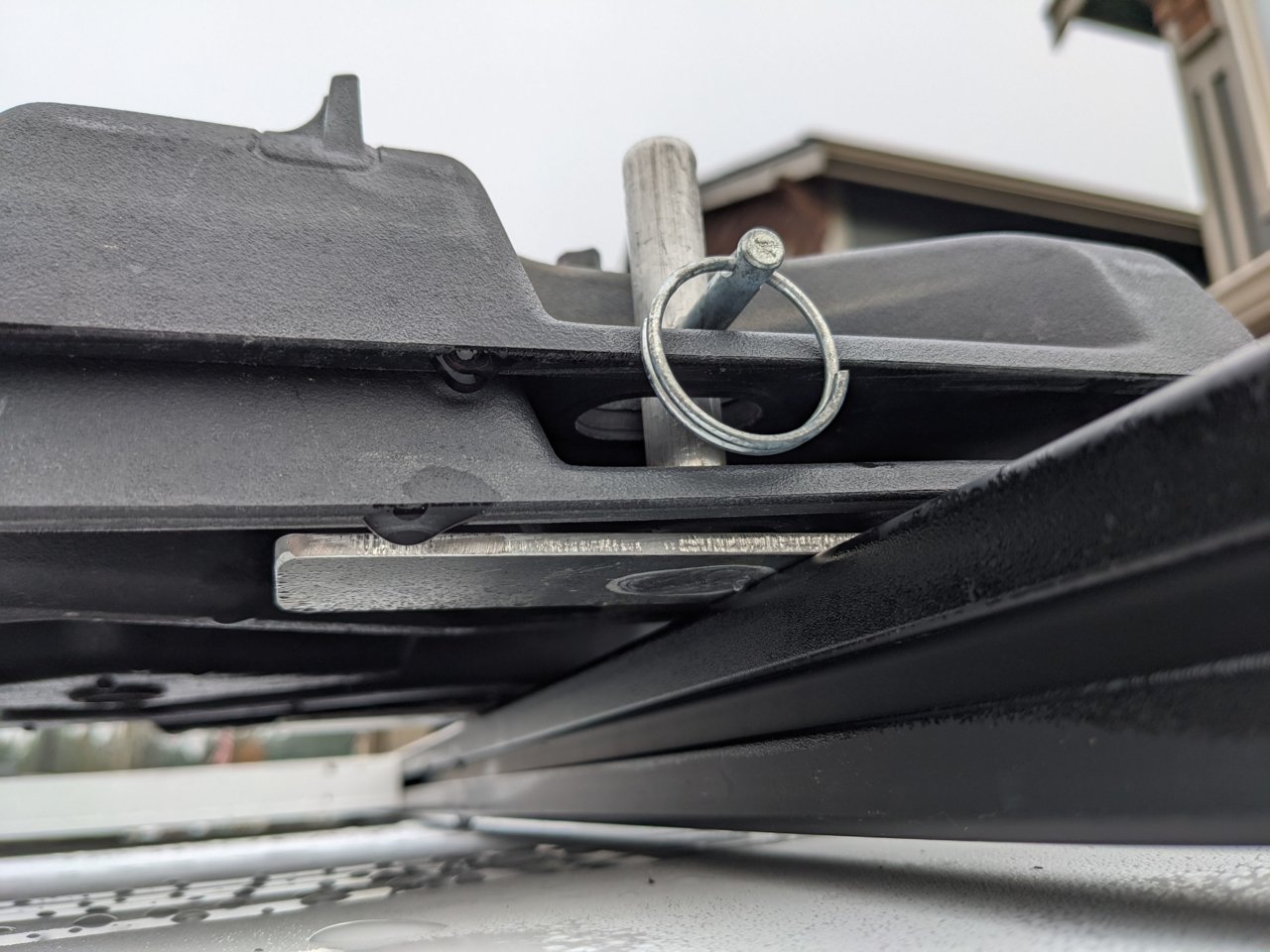

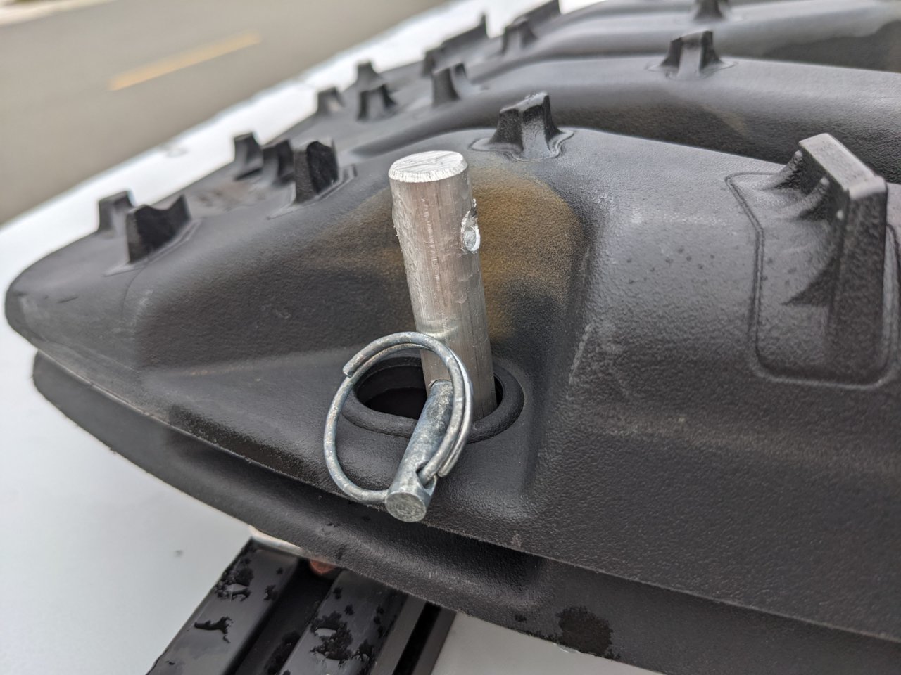

    Made some simple and effective mounts for putting recovery boards (ARB Tred Pro) on the roof rack cross bars.
    Mine are aluminum but steel would work just as well. Round tubing would also have worked. Top hole is for a small padlock.
    Pins are simple 1/4" ball pins from HD/bLowes.
