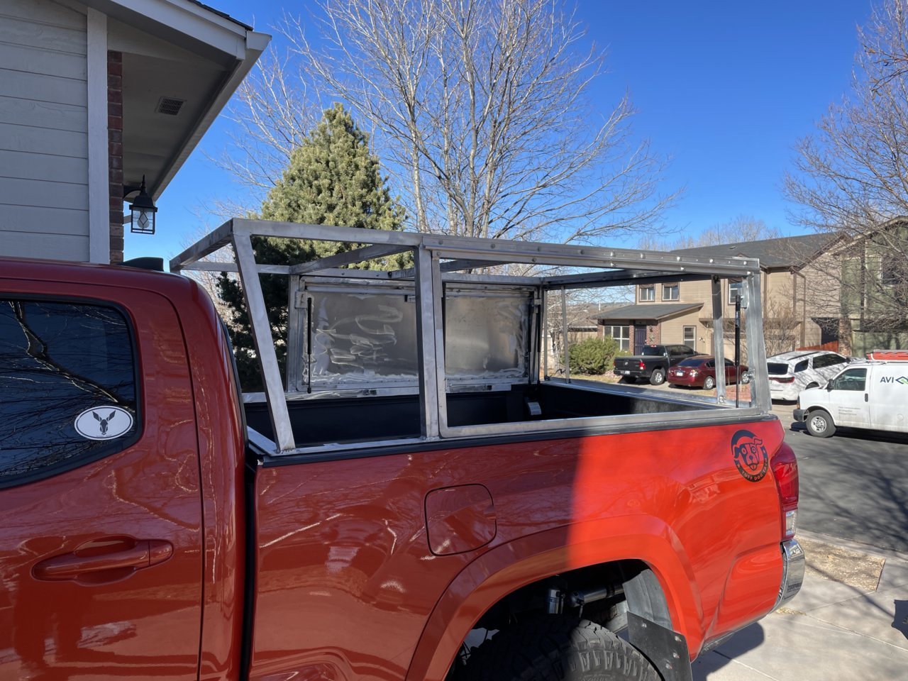

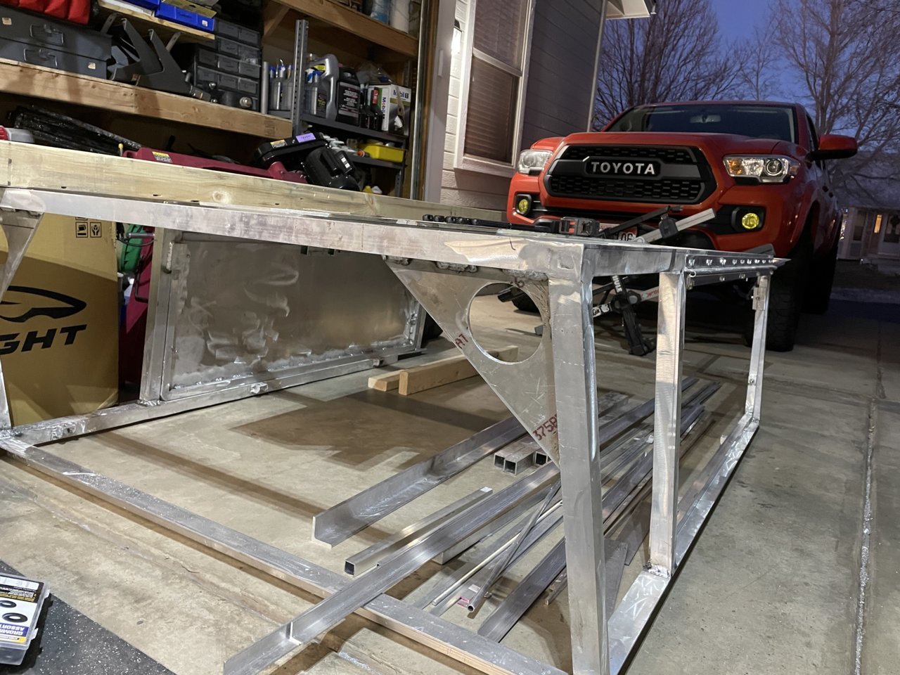

    Plugging away on my aluminum build
    NotTaco, Red October and nanserb like this.

    Awesome, I like the multiple door/panels on the sides. Nice use of the hurricane hinge as well!

    Thanks! I have some experience with building teardrop campers, so the hurricane hinge was a no brainer!

    Interesting design on the window frame, I like it

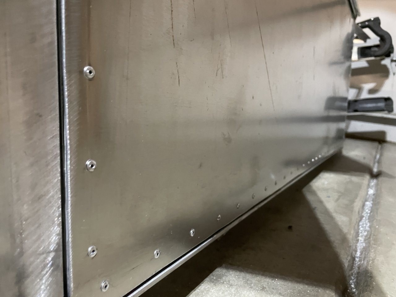

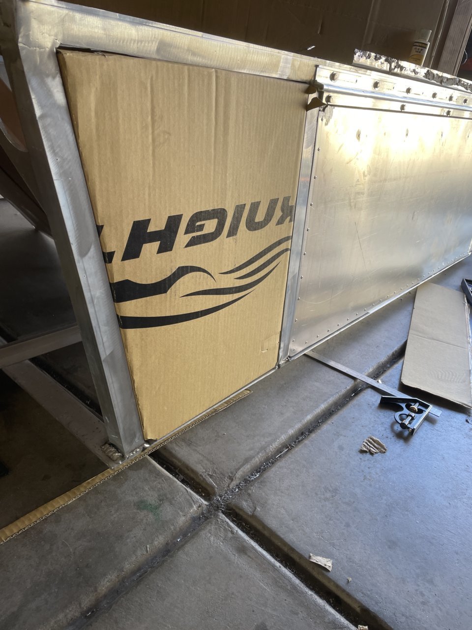

    Those gaps will be sheeted and some electrical components installed on the backside. The CAD template shown. There will be windows at the front and rear to allow use of the rear view mirror.

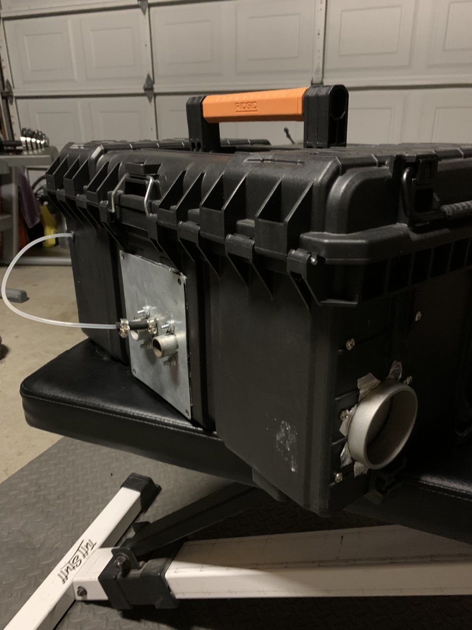

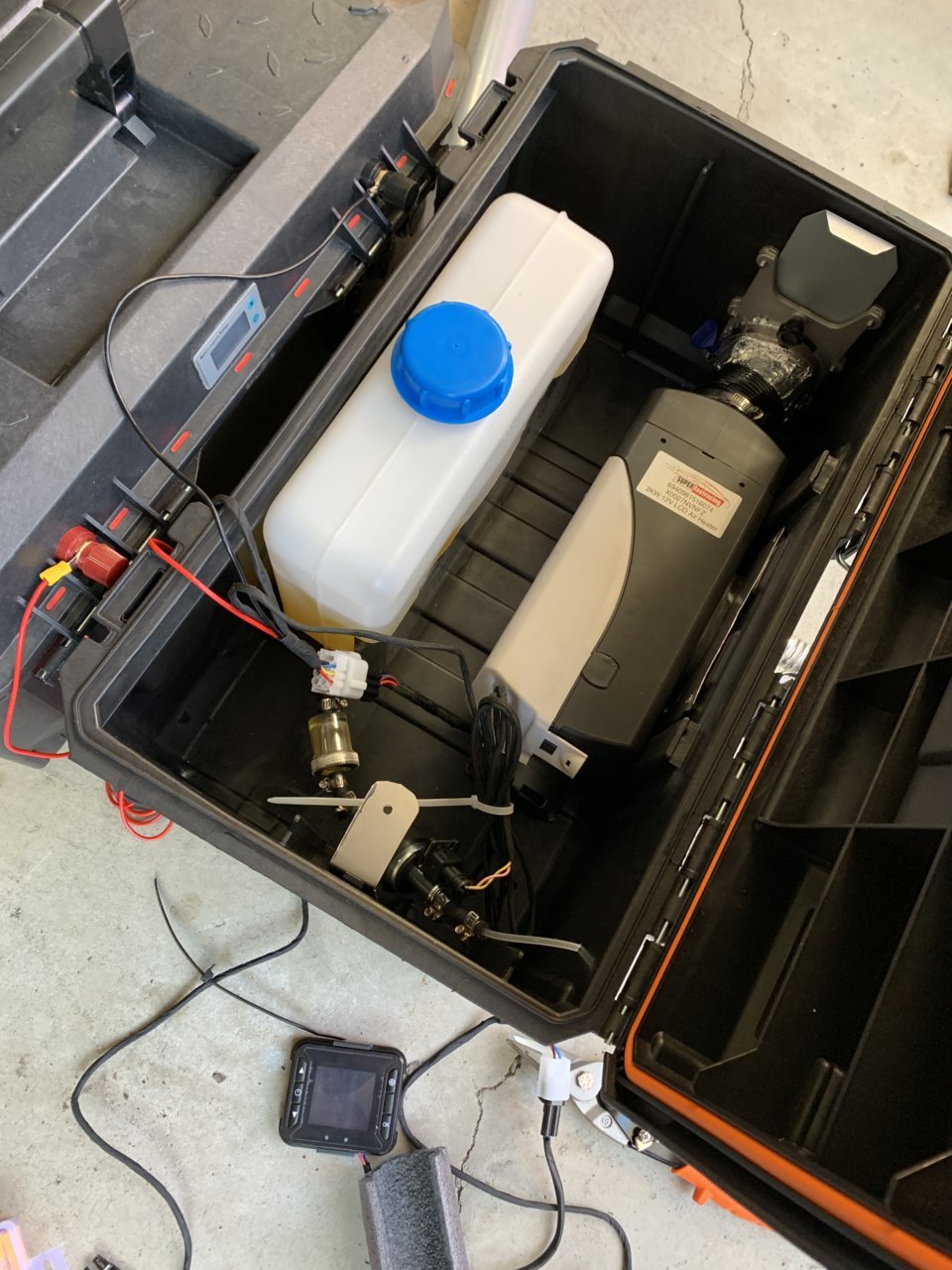

    Do you have some shots of the inside of the case? 2kw or 5kw? looks good!

    Nice. I put windows in mine as well.
    I am now debating rebuilding my side panels between the piano hinge/fabric way and the hurricane hinge

    I think the hurricane hinge is a far superior option based on a few reasons.
    1. Ability to cut to exact length with a drip overhang.
    2. Ease of removing doors.
    3. Won’t deteriorate when exposed to UV or weather elements.

    5kw, but 2kw would be good and use a smaller case

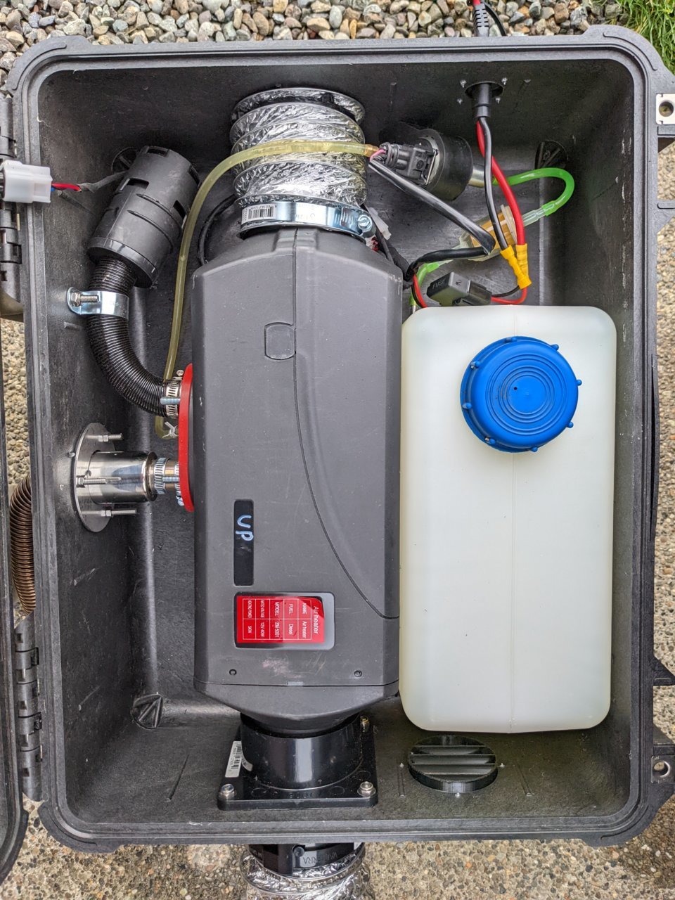

    I would probably avoid putting the exhaust in the case if possible. Just generally safer imo. I have mine in a 22” ridgid box. Works flawlessly
    I would also encourage you to join the “Chinese Diesel vehicle heaters” group on Facebook for lots of troubleshooting and pics/ideas on other peoples builds388392BE-682C-46DC-AF46-878740B2D72E.jpgACBFFAFD-A8EC-4A88-A691-7A823636CE93.jpg

    I agree with @Red150, keep the exhaust to a minimum. Mine only has 1" of exposed exhaust, some of the case installs have 12-18" which is asking for trouble. Even if you wrap the exhaust it's still VERY hot. I used a through-hull exhaust flange that worked very well.
