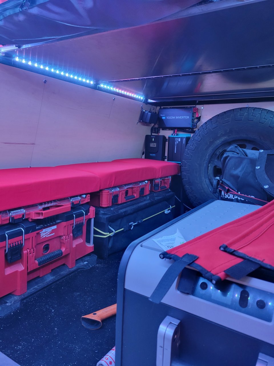

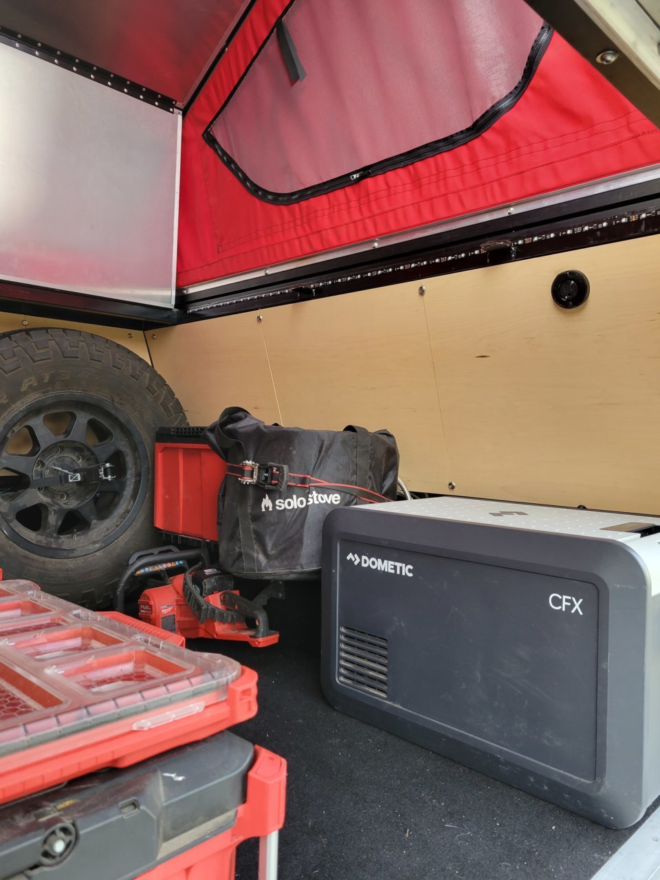

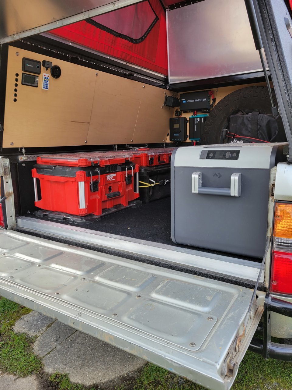

    Well i need to get better interior pics but these are what i have so far.
    I went with a 1/4 maple hand oiled interior paneling and routed all my wires behind the wall and insulated the walls all the way down to the floor. the floor is also raised 1.5 inches and insulated with havelock wool.
    As far as power goes. There are 3 100 watt renogy panels on the roof, 40amp solar charge controller,40amp dc to dc renogy charger, and a 1000w renogy inverter. The main battery is housed in the packout box behind the solo stove and is a 170 amp hour renogy lithium battery. I have 6 swithches all mated to a csutom fuse and relay box. They control,interior lighting that can be controlled via bluetooth in three zone(top wedge,bottom half of camper, and rear door) all dimmable and rgb as well. The second switch is for the dometic fridge.Third for the exterior rgb lux scene lighting.fourth for the espar b4l m2 gasoline heater plumbed to my fuel tank. the last two switches dont have anything attached currently but im sure ill find a use for them.
    Super happy with the outcome of the build so far! More to come as always. Thanks @Ripcord for the inspiration

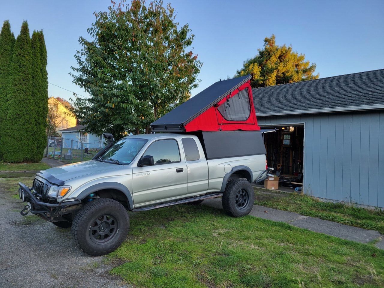

    Awesome build! Are your exterior wall panels ACM? What coating did you use on them?
  5. Jan 4, 2022 at 11:51 AM
    #2505
    Pj40
    Pj40 Well-Known Member
    Jan 17, 2020
    #316424
    108
    Washington

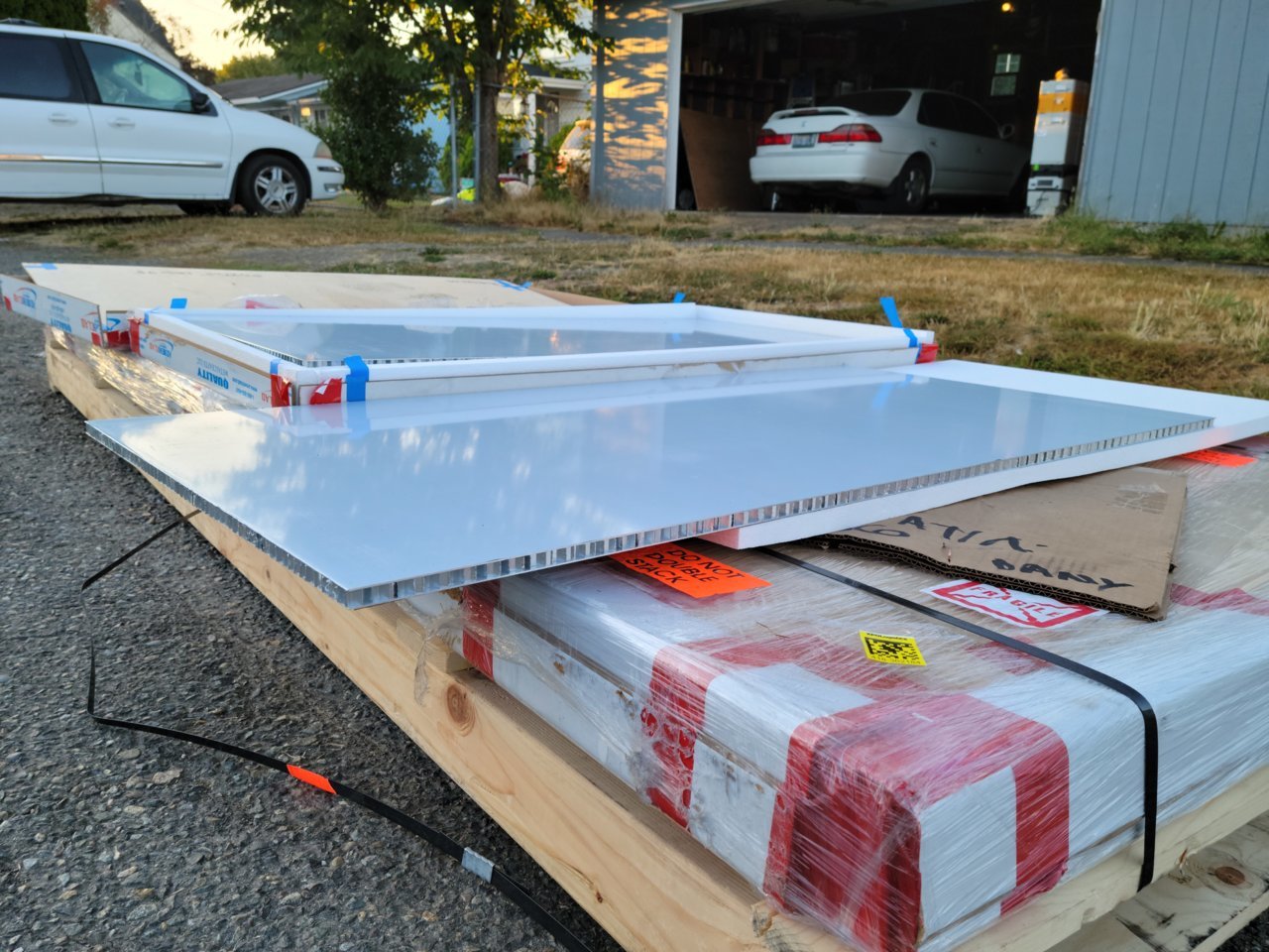

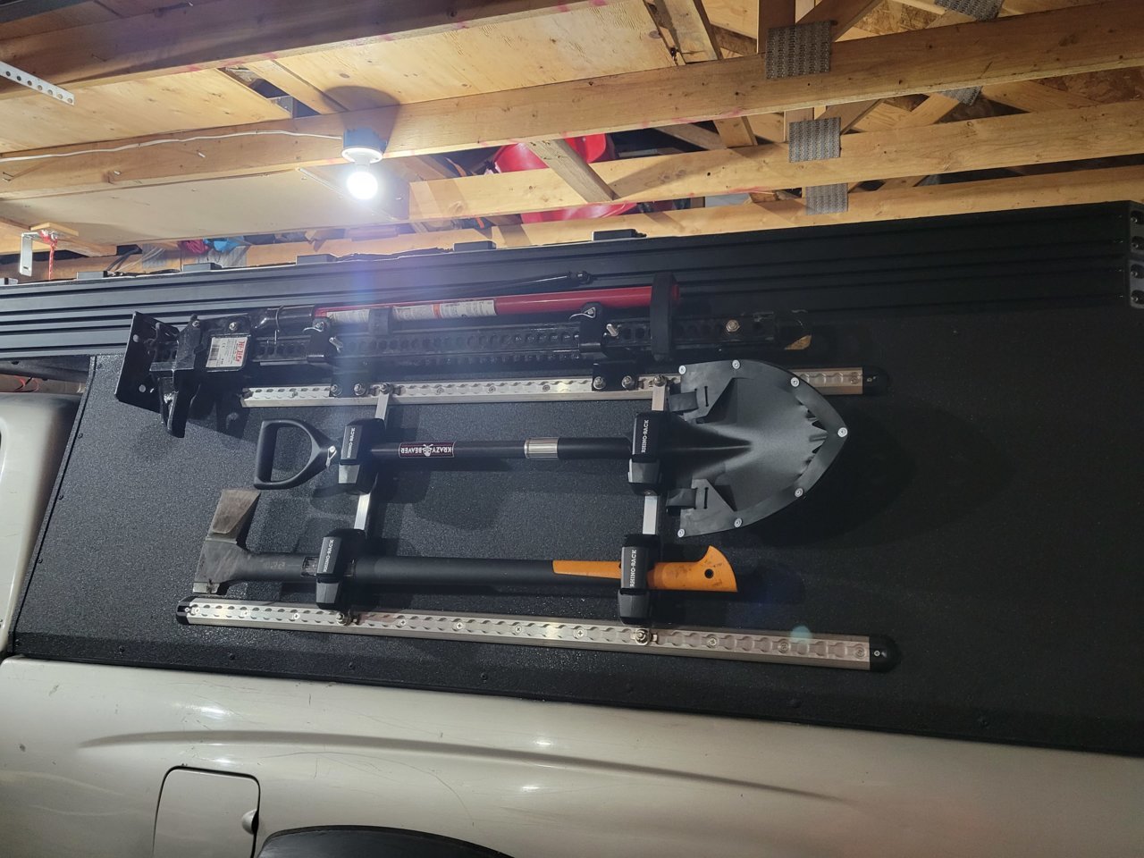

    Thanks man, I used a honeycomb aluminum paneling.
    It's from a company called "Flat Iron Panel Products" based in Colorado.
    I used their 1/8 panels a 4x8 sheet weighs 16lbs and is super ridgid. I will say it's pretty expensive, 4x8 sheet of 1/8th was roughly 500 bucks and to ship just one sheet is about the same being that I'm in Washington. To ship 30 sheets is the same price though since it takes the same crate. I ordered a few extra sheets just to be safe haha

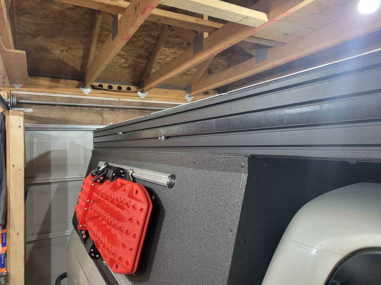

    I then decided since it will see plenty of abuse on trails that a bedliner of sorts would be the best way of protecting it.
    I've used rhino liner and raptor liner before but after lots of deep reaserch I opted to have line-x spray it for me. Their product is sprayed on at a pretty high temperature and has a more shell like feel rather than rubbery feel.

    I used 1/2 paneling from them for my folding floor as well.

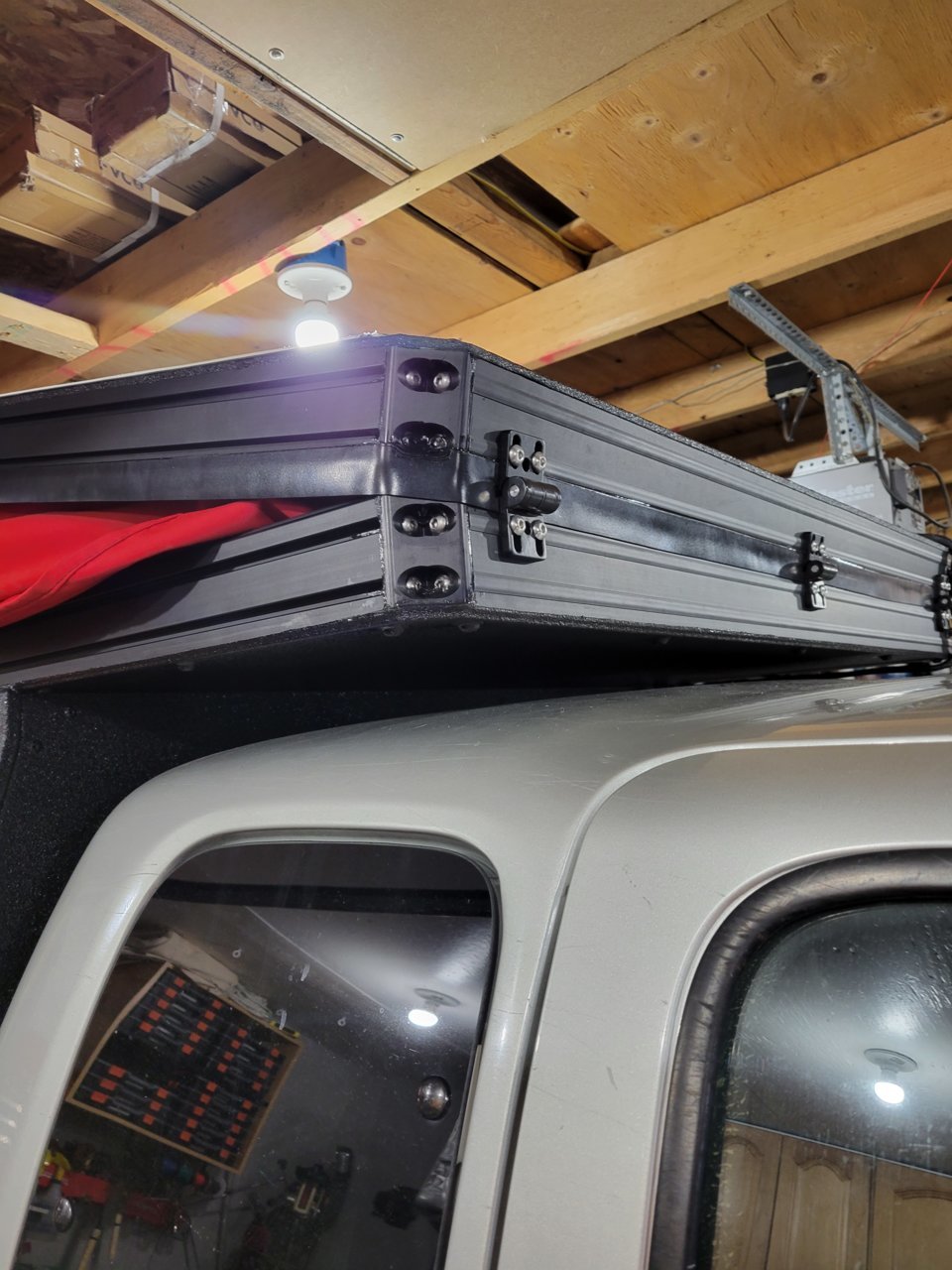

    Alright guys, I've done it. No it's not a super scientific breakthrough but no one talks about the biggest problem these wedge campers have....water.
    I live in Washington, home of some of the best rains and drive 100+miles sometimes in downpours and before this whatever i seemed to do I could not seal the wedge when it was closed.
    I did the rounded corner bulb gasket, made custom corner gaskets out of neoprene,did triple rubber gaskets in between the extruded aluminum profile, did triple layer plus the bulb gasket. Wind driven rain will find a way but that is a problem of the past!!!!
    I used 1/16 thick neoprene that I cut to 1.75 inches wide. Then used vhb tape and layer that on the entire perimeter of the wedge, used mineral spirits to super clean the neoprene rubber and extruded aluminum. Then as I pressed the rubber onto the wedge heated it up with a heat gun and applied pressure with a rubber roller to really bed the adhesive. After it was set, I then went on the top edge with a commercial grade silicone to ensure that water couldn't get behind the vhb tape or in-between the vhb and rubber.
    I have driven 100s of miles now purposely looking for the worst rain, going over stevens pass,Snoqualmie pass,white pass, and anywhere that said it was pouring out to test this.
    ITS BONE DRY ALL THE TIME!!!!!
    It adds no hassle to close the wedge, it looks clean, and when the front opens the neoprene is thin enough that it flexes and doesn't lose its memory.
    Also the neoprene I went with has a high uv protection so it shouldn't fade terribly and it won't become brittle with time.
