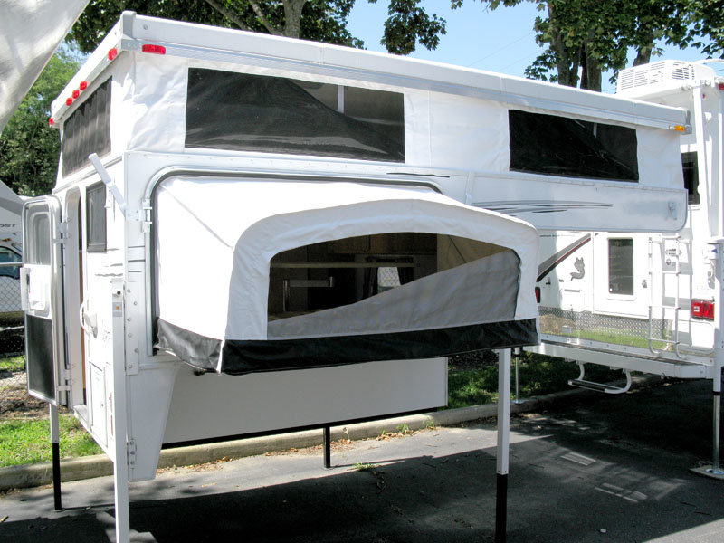

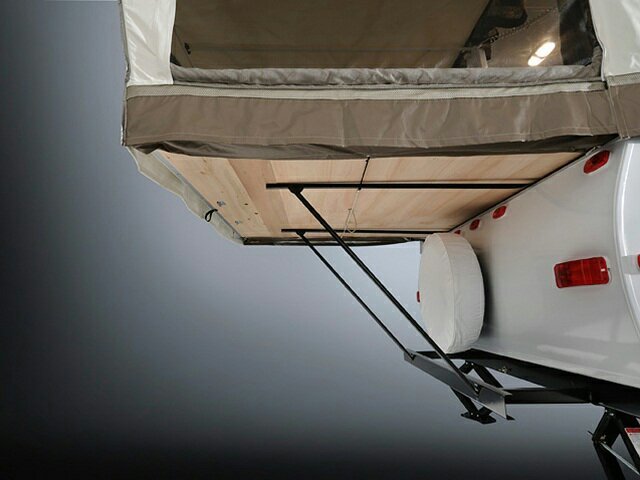

    I’m trying to come up with a concept for a slide out bed, like what the pop up campers use. Don’t think you could keep bedding or a mattress on with that as well, but it would make it easier to sleep more people up too.

    I’m not familiar with that concept.
