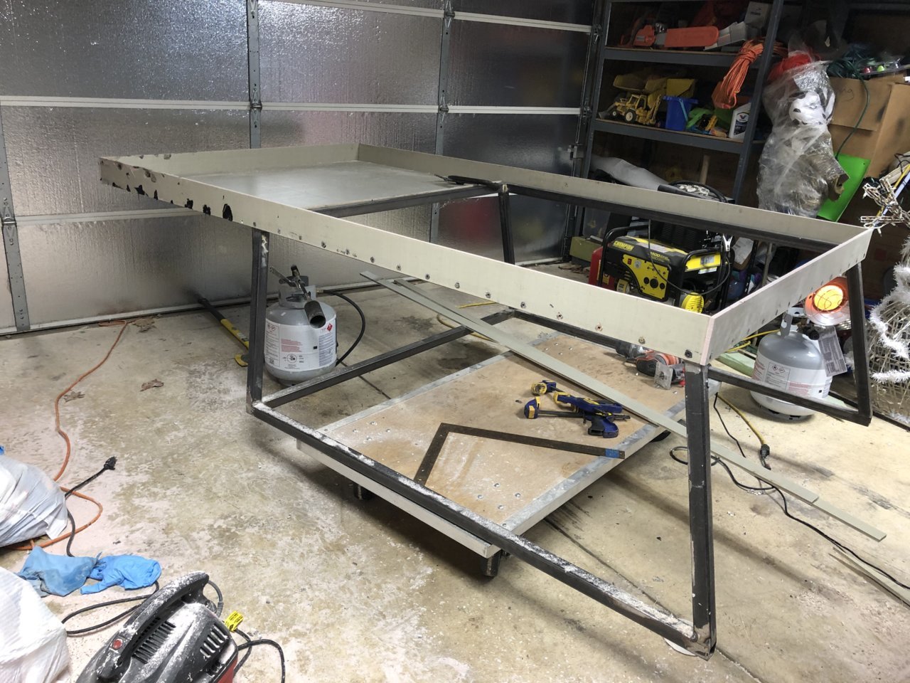

    14EF0C31-0D9D-4781-8CCD-8663F51A82AF.jpg I made my frame out of 2x2x.125” steel. I went with .125” wall so I can use thru inserts in the honey comb and tap the steel for the NAS screws To the frame.

    Very nice, making progress!

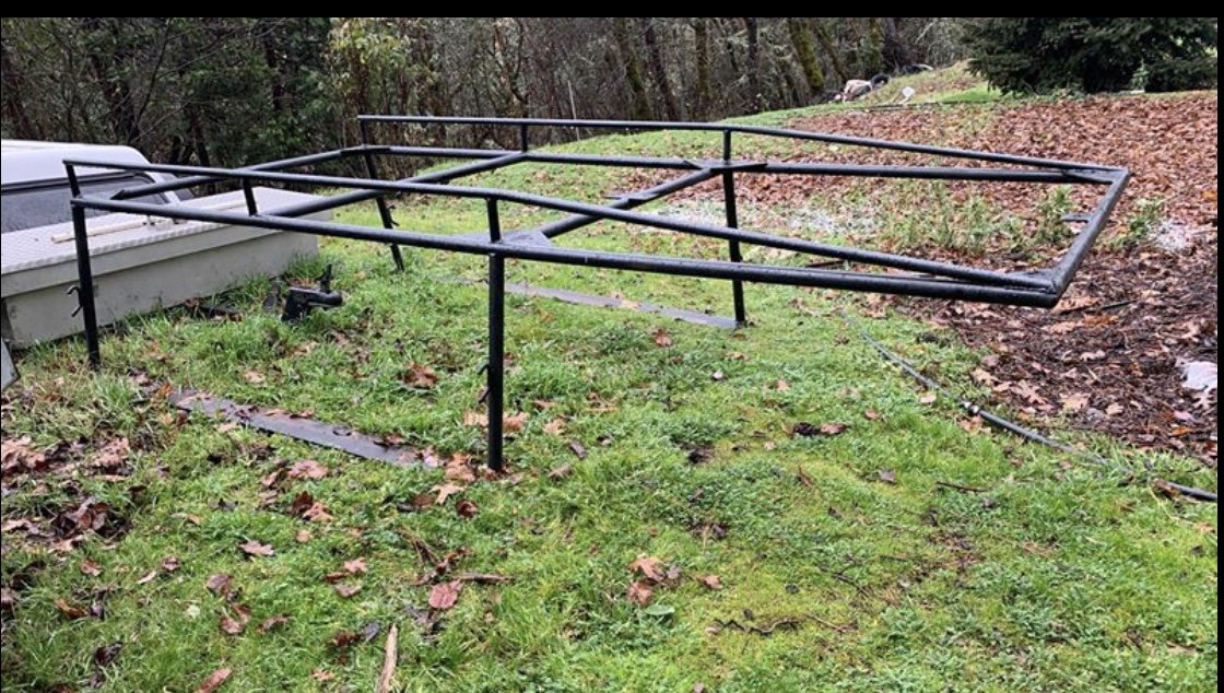

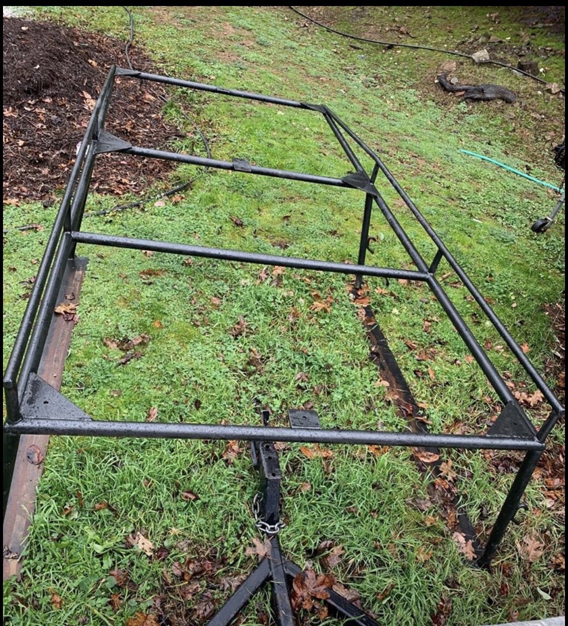

    Anyone else used a lumber rack for the frame of their wedge? Found one for $250 and figured it might save me some time welding.. thoughts?

    Those and the aluminium contractor caps would make pretty good bases to build off of, IF they can be found cheap like what you found!
    You will probably just have to adjust the dimensions of the wedge you build as that looks a tad wider. Which is no big deal!
    Volk93 likes this.

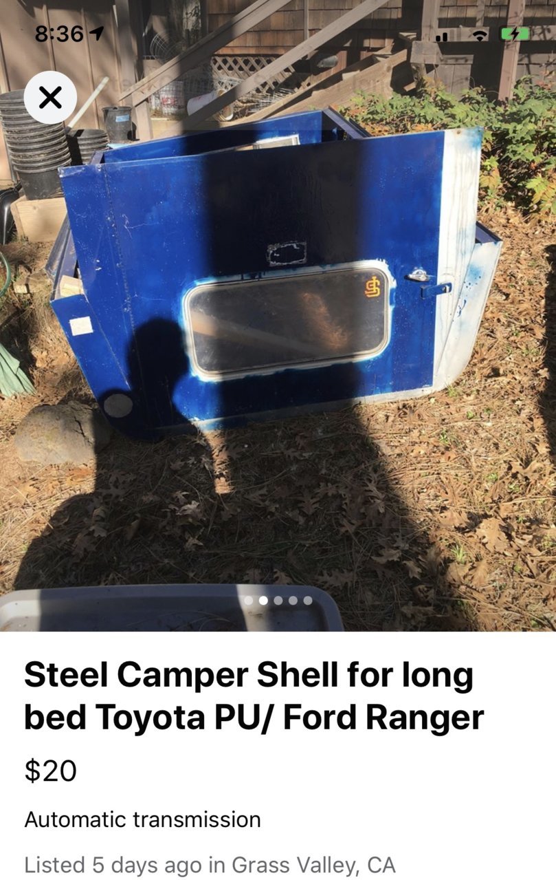

    Also, if someone in Northern California needs a shell to start from, found this contractor one for $20! I’d be all over this if it wasn’t a 10 hr round trip
