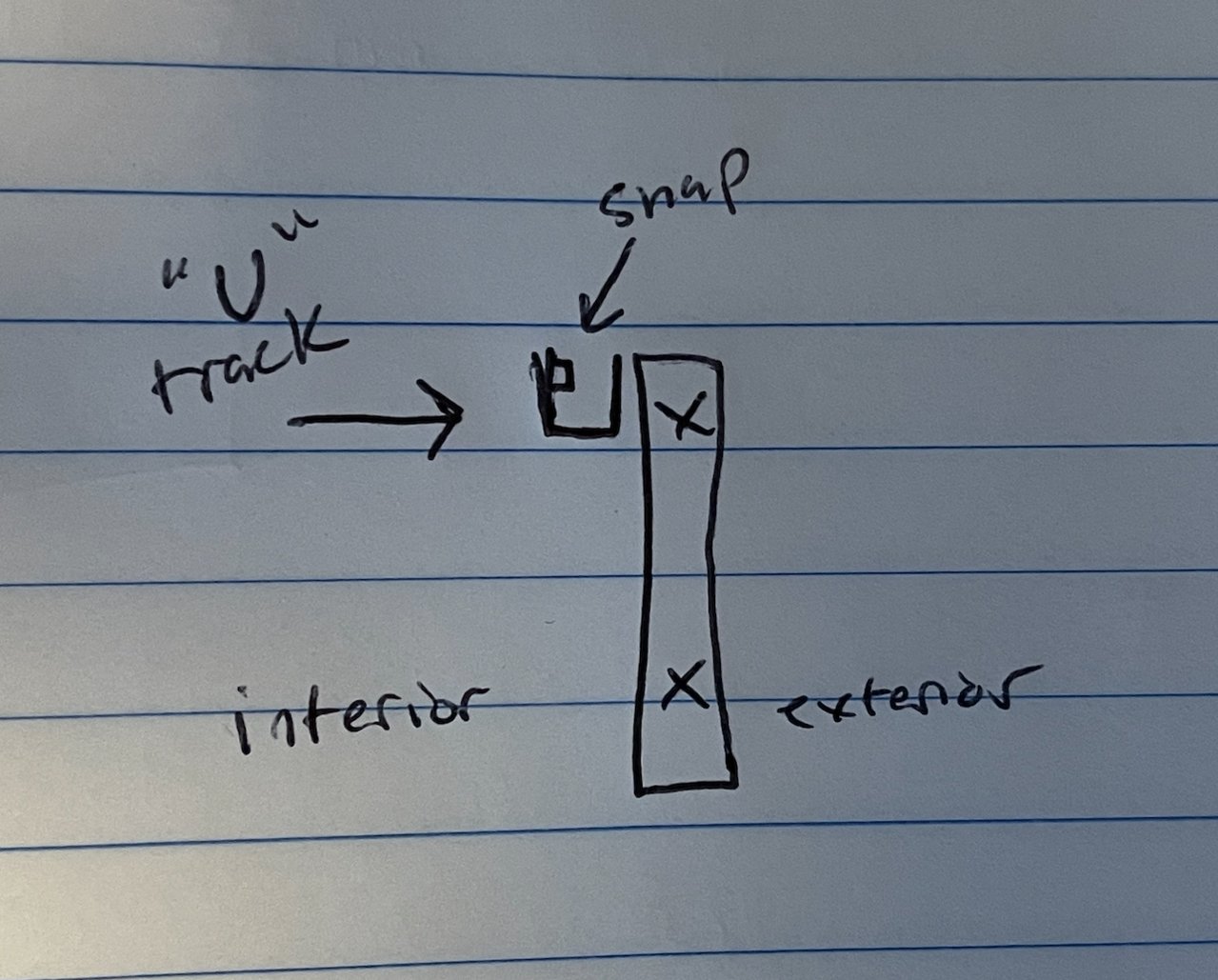

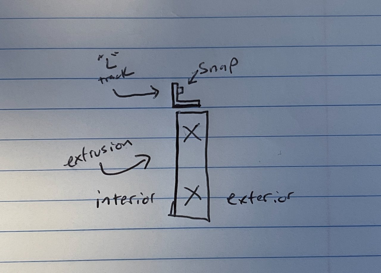

    So I came across a V1 GFC tent canvas for $250, it's got button snaps and Im trying to think of a way that I could attach some sort of "L" track or maybe a "U" track to the bottom so that I could attach snaps... anyone done something like this?

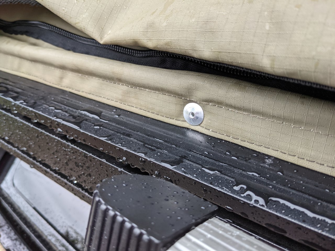

    Going to be tough because of the lid. You can't really put anything on the top of the extrusion, or it won't close. If you put it on the inside lip like in your first photo with the U channel you risk water sitting in the U and leaking inside. GFC and other companies use a custom made extrusion that's wider than the top extrusion, or has an offset.
    I'm attaching a photo from a bush co tent for reference.

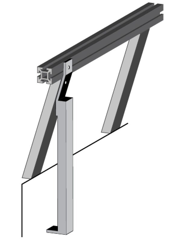

    was digging through some other threads today and stumbled upon this picture. Could be a good way to attached the tent to the shell- either directly or using a section of 8020 and then attaching the tent portion to that
    I think this was being used to add 8020 to a bed rack, but looking above with some care and planning with cutting could could be done

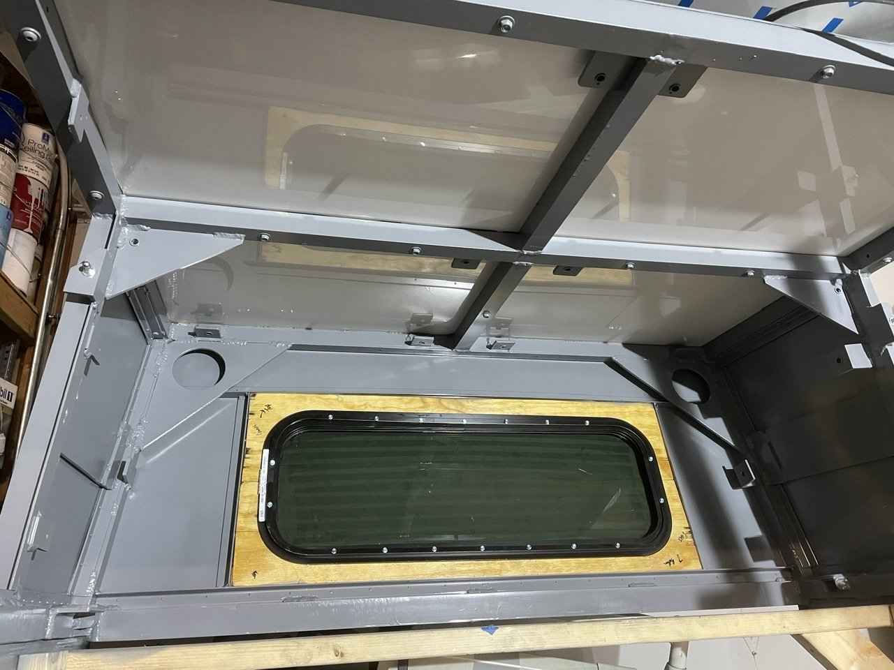

    Spent today huffing paint.
    Interior turned out nice for a rattle can paint and prime

    @demo243 this is what I am thinking for reinforcing the aluminum and not having to weld. Obviously mine wont have these custom extrusions, but the concept is the same.

    Looks like the Super Pacific wedge

    It is, and I believe GFC changed their manufacturing process to mimic SP as well.
