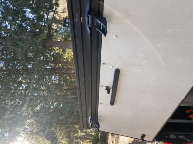

  18. Feb 12, 2022 at 4:09 PM
    #2678
    2ski4life7
    2ski4life7 Well-Known Member
    Apr 30, 2012
    #77911
    2,203
    Seattle WA
    17 DCLB 4x4 TRD Off Road Previously '12 DCLB 4x4 SR5
    cool I should have done that I put it on the locking handle. Hoping this solves all the condensation issues I’ve been having.
    pretty easy install. The only difficult thing is the springs and doing it by yourself haha
  19. Feb 12, 2022 at 7:47 PM
    #2679
    nanserb
    nanserb Well-Known Member
    Jan 25, 2016
    #176034
    231
    Elliott
    2019 ZR2 Colorado
    Awesome!
    It might help a little with condensation but where it really shines is the water coming in from the corners when it's raining.

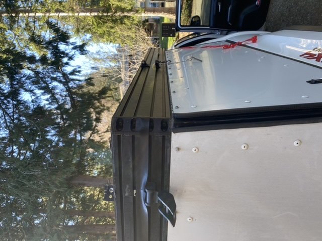

  20. Feb 13, 2022 at 12:46 PM
    #2680
    Taco Camper
    Taco Camper Well-Known Member
    Aug 19, 2020
    #338162
    83
    I quickly measured cab/camper movement today by rigging this up and spurting around the neighborhood bottoming out the rear a few times. I measured 0.4” max deflection left, right, and up and 0.2” down. A hard front end hit might bring the camper a little lower but this is what I measured.
