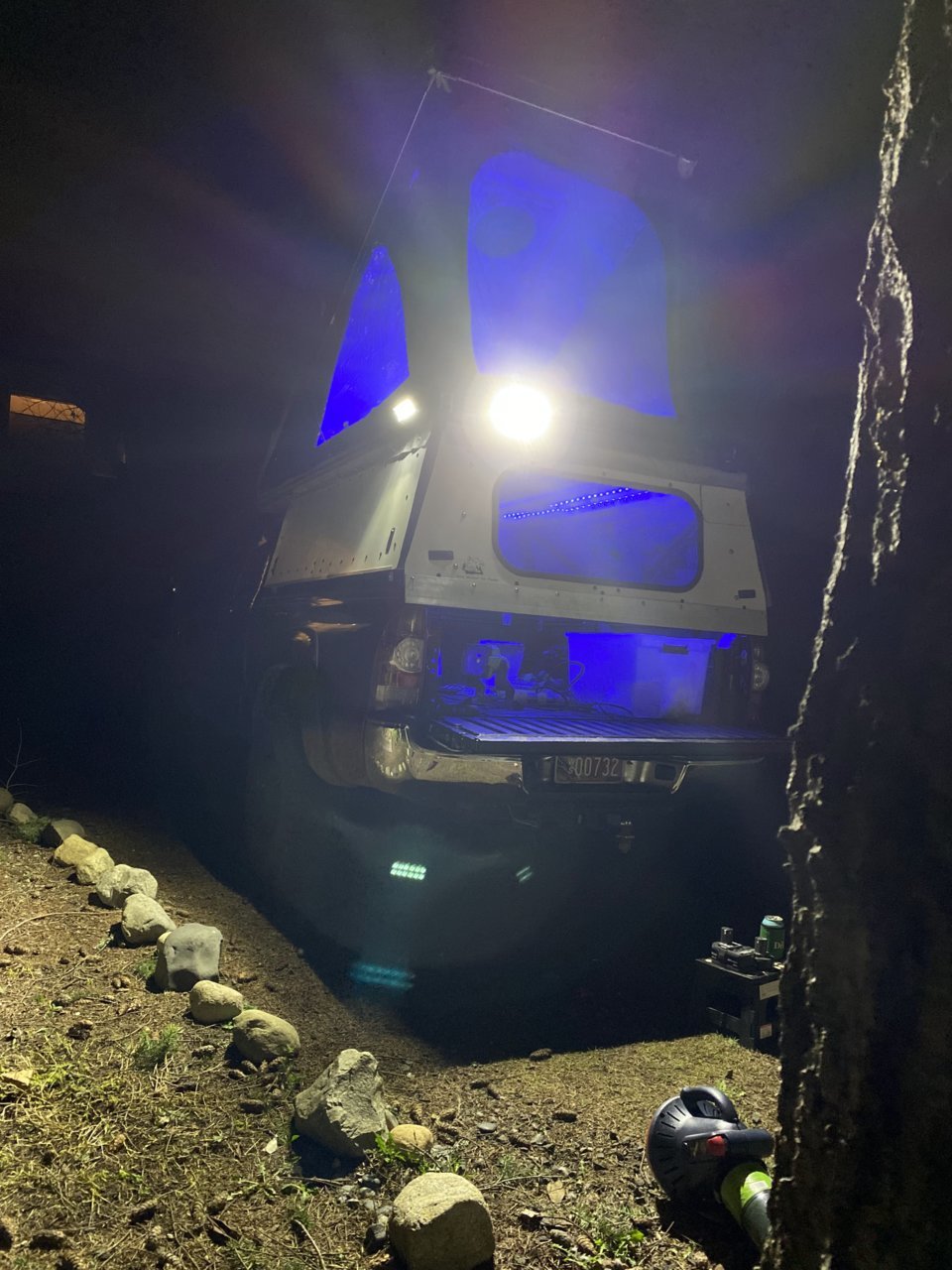

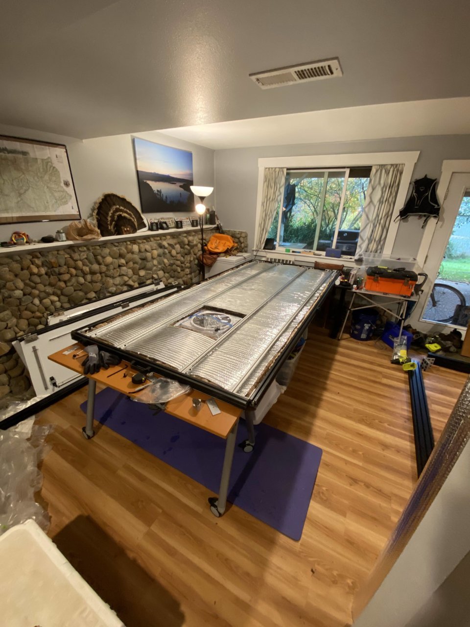

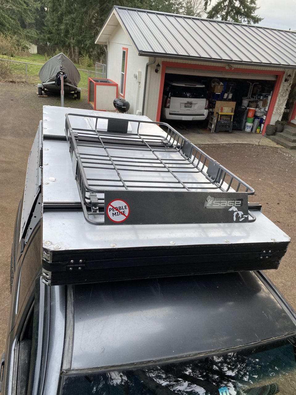

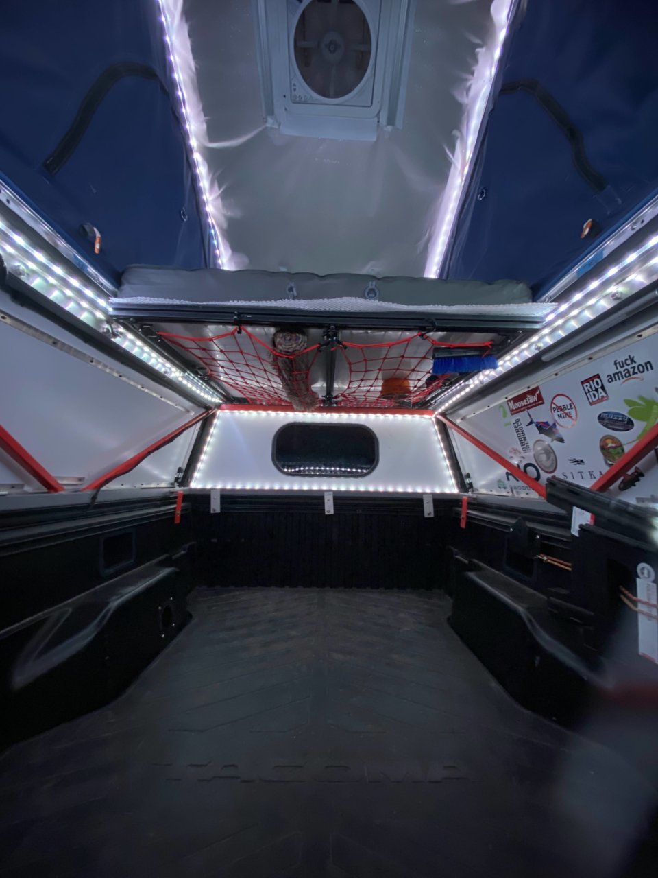

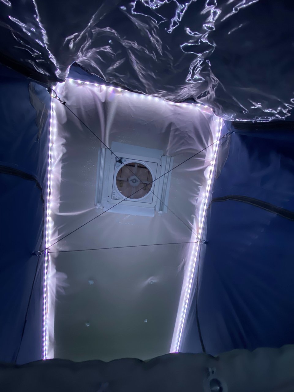

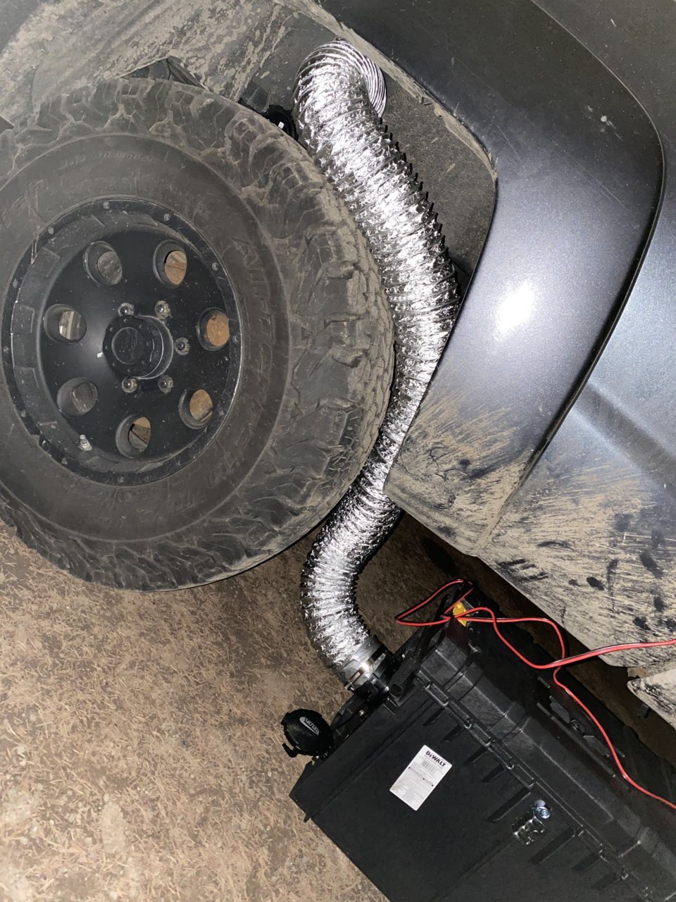

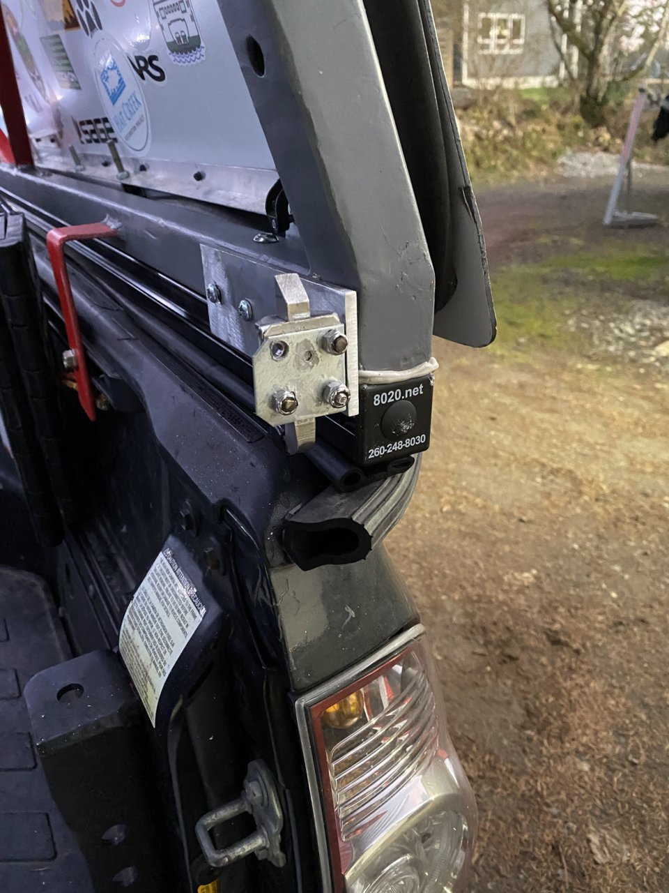

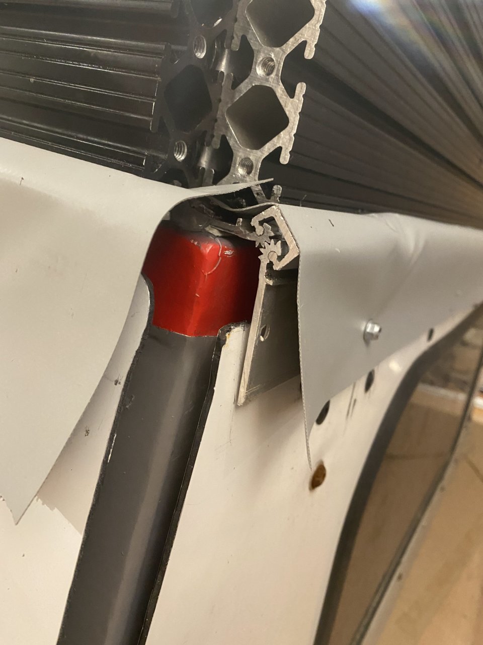

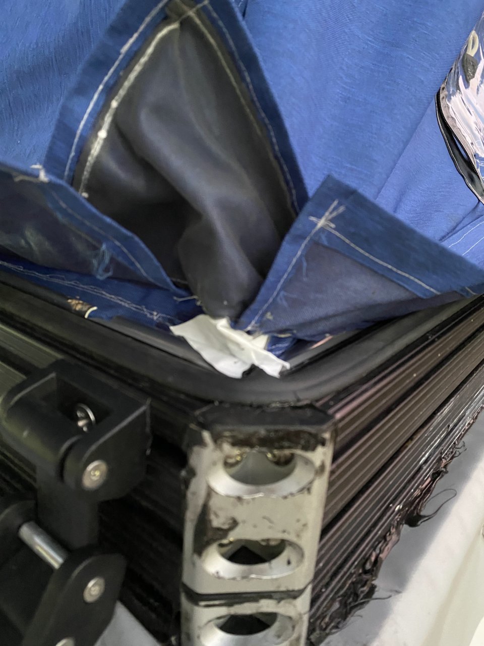

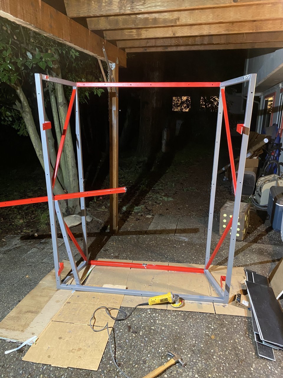

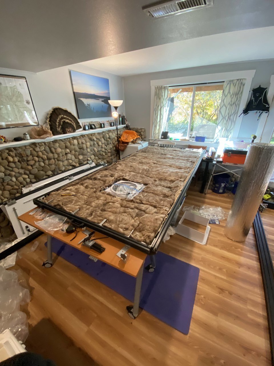

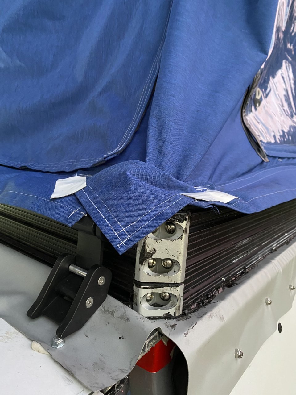

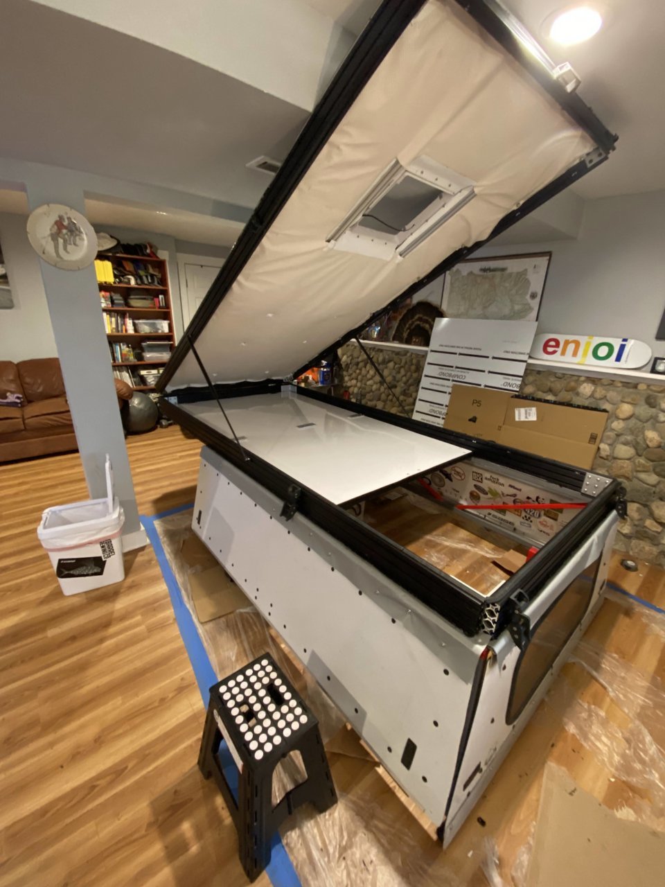

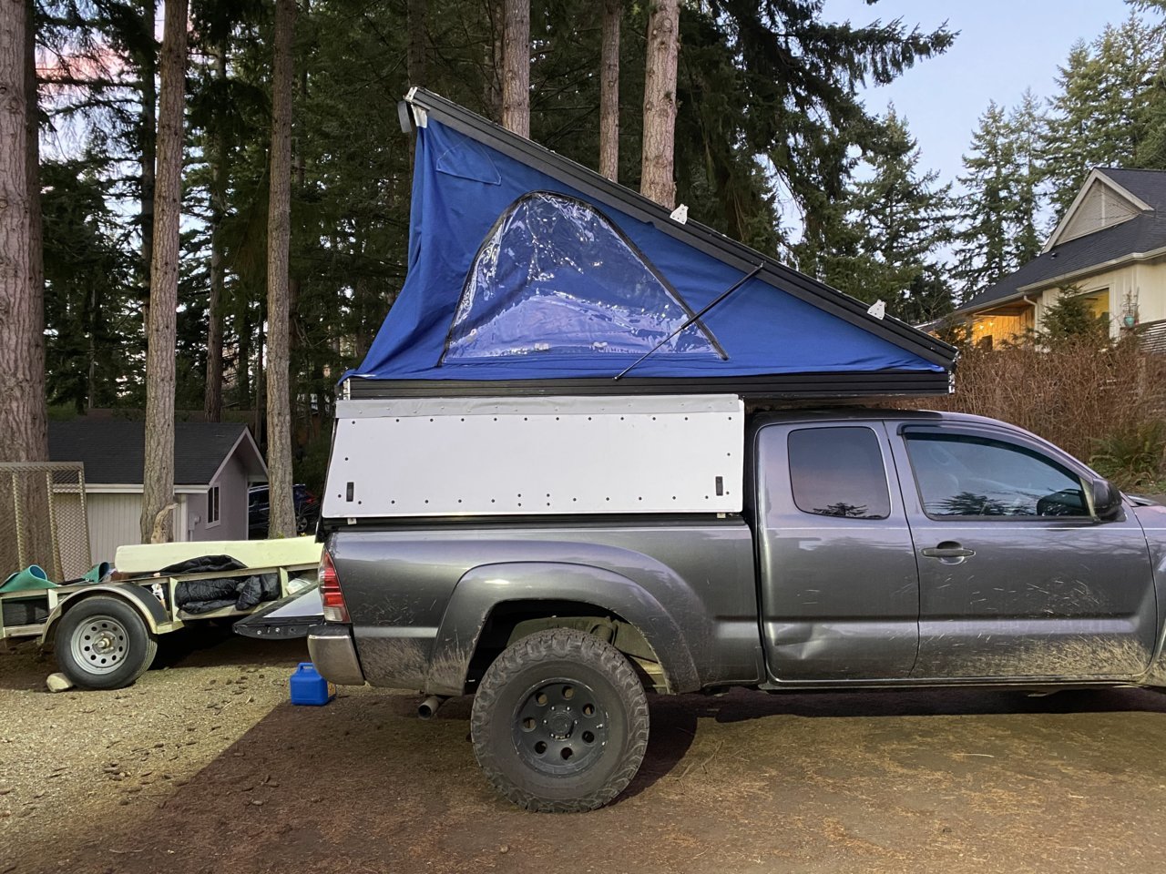

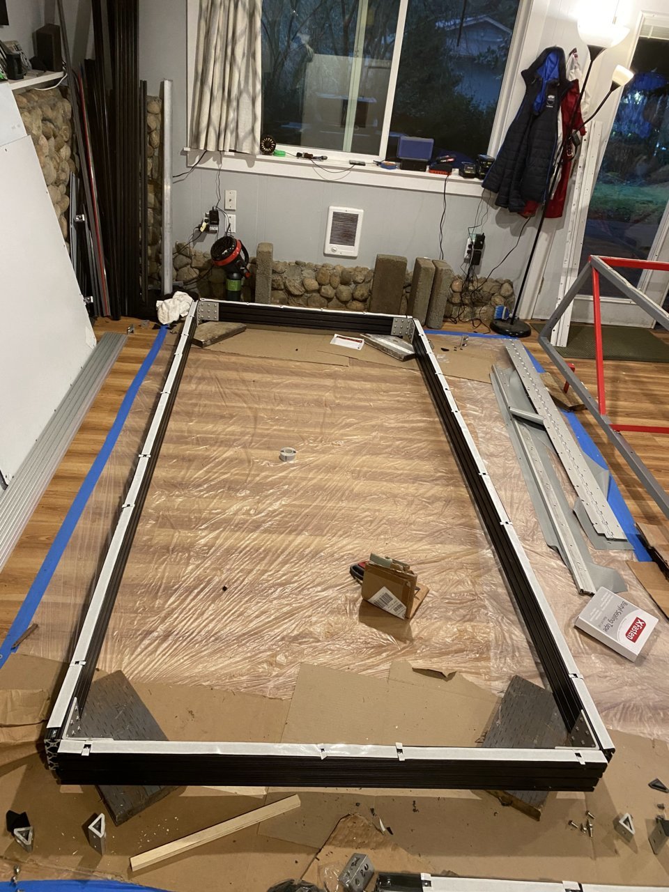

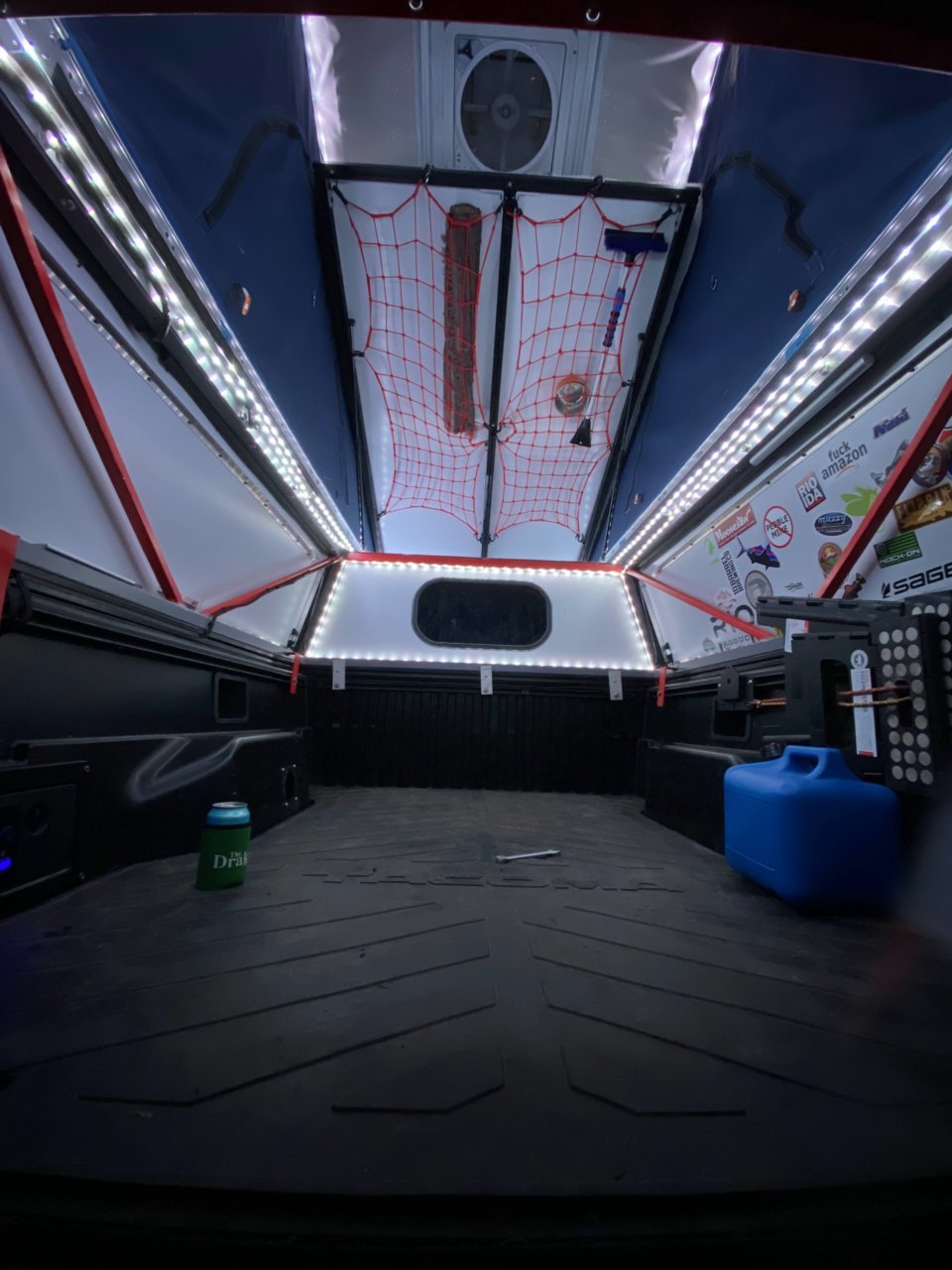

    Alright well this is now the second time I have rebuilt my camper, making a grand total of three builds and finally have arrived at a place I am happy to share on here since embarking on this journey about two years ago. I'll detail some of the changes I made and why, along with what I changed during each iteration. A big thanks goes to my friends who helped but are not on here, this project is really a great reason to buy some friends dinner for free labor along with giving you something to do while drinking a beer.
    Some background:
    My frame was not built for my truck, I met a guy in 2nd Rangers who was selling his frame and 80/20 (3" & 1.5") so I picked that up for a steal of a deal. Little did I know that bargain would cost me a lot of time and a case of shingles... But I tell you that to describe the first big change I made, the over cab was just too close for me, and I wanted more room if I ever added a molle rack or light bar, so the first substantial change I made was adding an 1.5" rail to the base of the frame. I also liked this idea for another mounting surface in the interior whether it be baskets for gear, tie downs, etc etc.
    A big aside, I don't see anyone on here using elastic and lobster clips to help the tent fold in so you're not trying to fold a wet map in the dark every time you close your wedge. Note, that I have them.
    Lastly, as @nanserb asked almost immediately, yes it's in my living room, my friend who's shop I borrowed for the first two versions had moved away :(
    v1:
    - Just needed to get this finished so I could use it and figure out what I wanted to change.
    - Biggest take away was that condensation is a huge issue that needs to be addressed.
    - Didn't like how hard it was to close with bedding so I wanted more room
    - Zero insulation was not fun

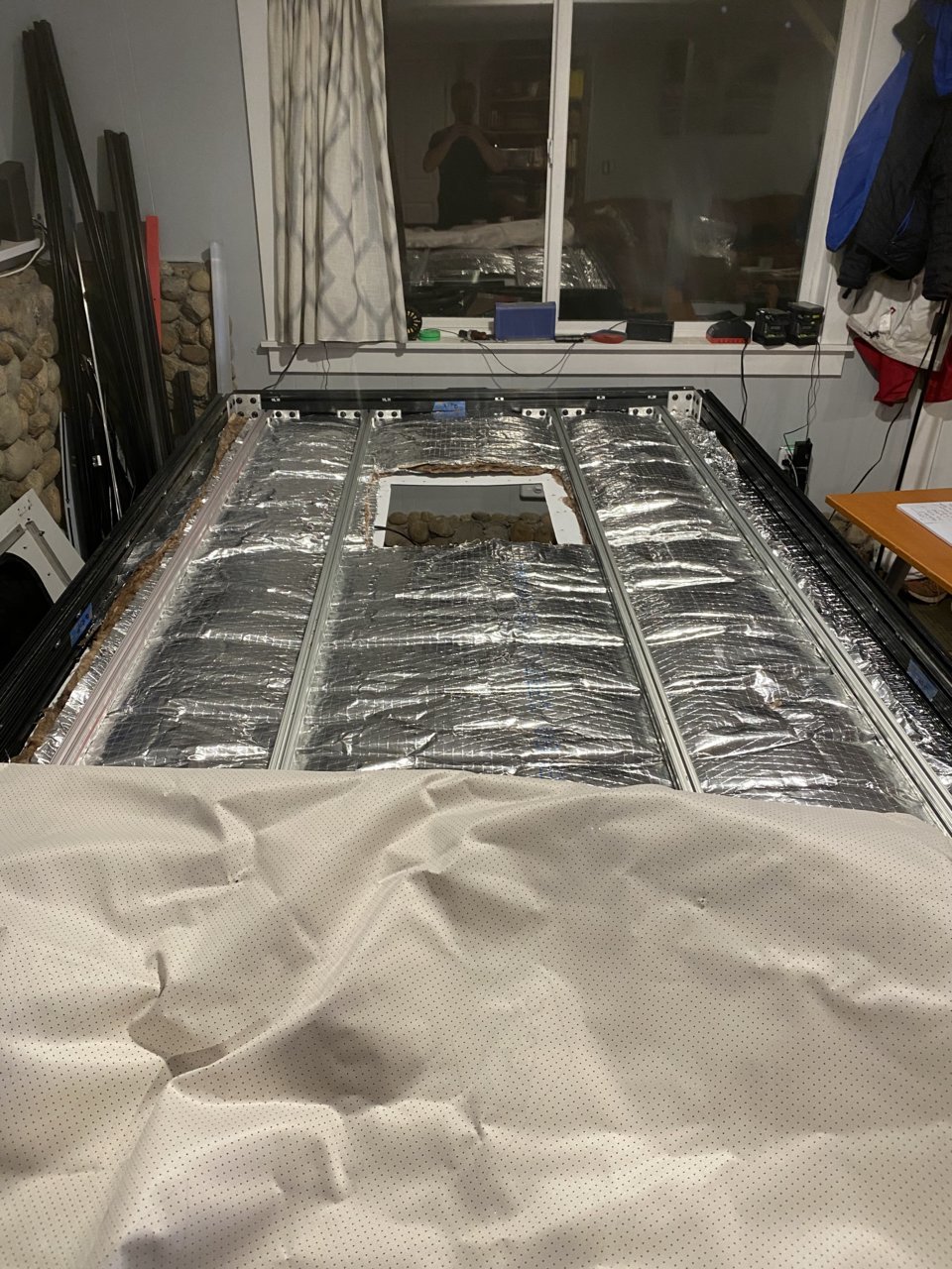

    v2: changes
    - Added maxxfan deluxe
    - Added a 4.5" rail and joined it to the 1.5" wedge roof
    - Insulated the roof's 1.5" rail
    - Did it in a rush and had horrible water leaking issues, but condensation was completely solved and closing was easy.
    - sewed a vinyl tent with a quilt liner

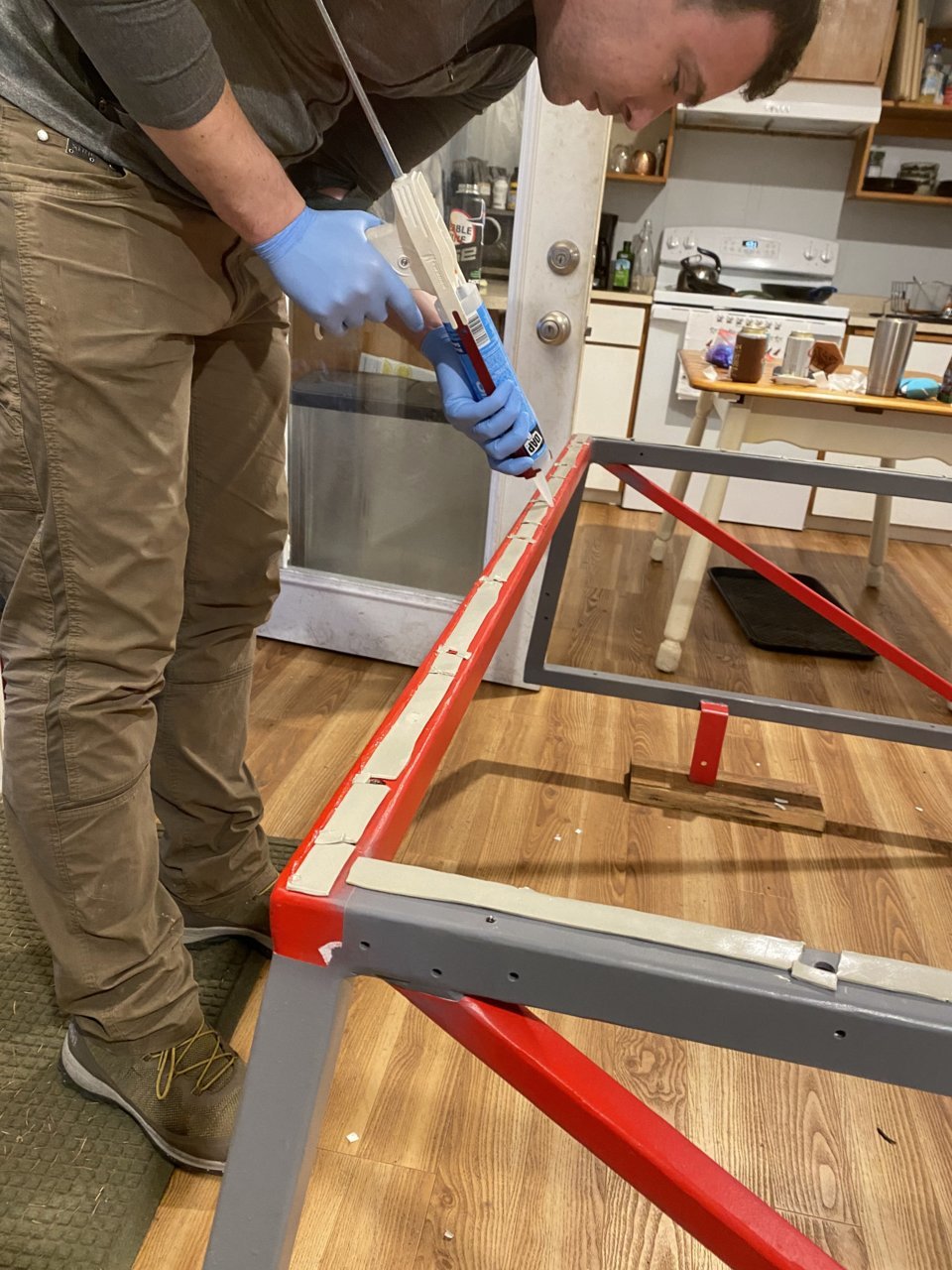

    v3: no water allowed
    - copied @Pj40 's EDPM to repel water
    - copied @davzx pop up bed (In fact I had just finished repainting and decided I had to have that)

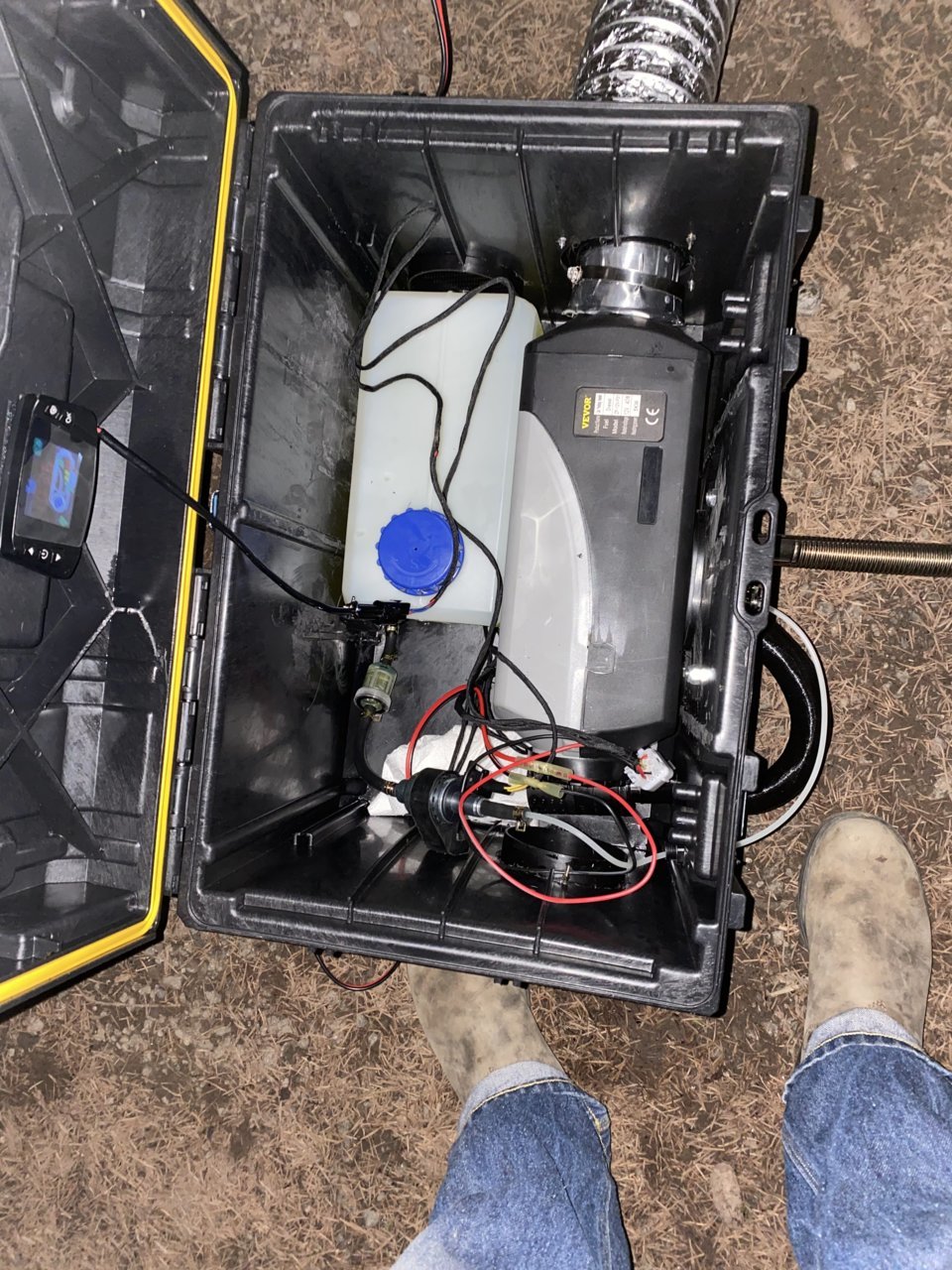

    - copied @nanserb's diesel heater and just generally bounced ideas off him, he even got a free t shirt out of the deal
    - I married @nanserb 's and @davzx 's hinges ideas, afterwards nanserb suggested I put the vinyl on the inside

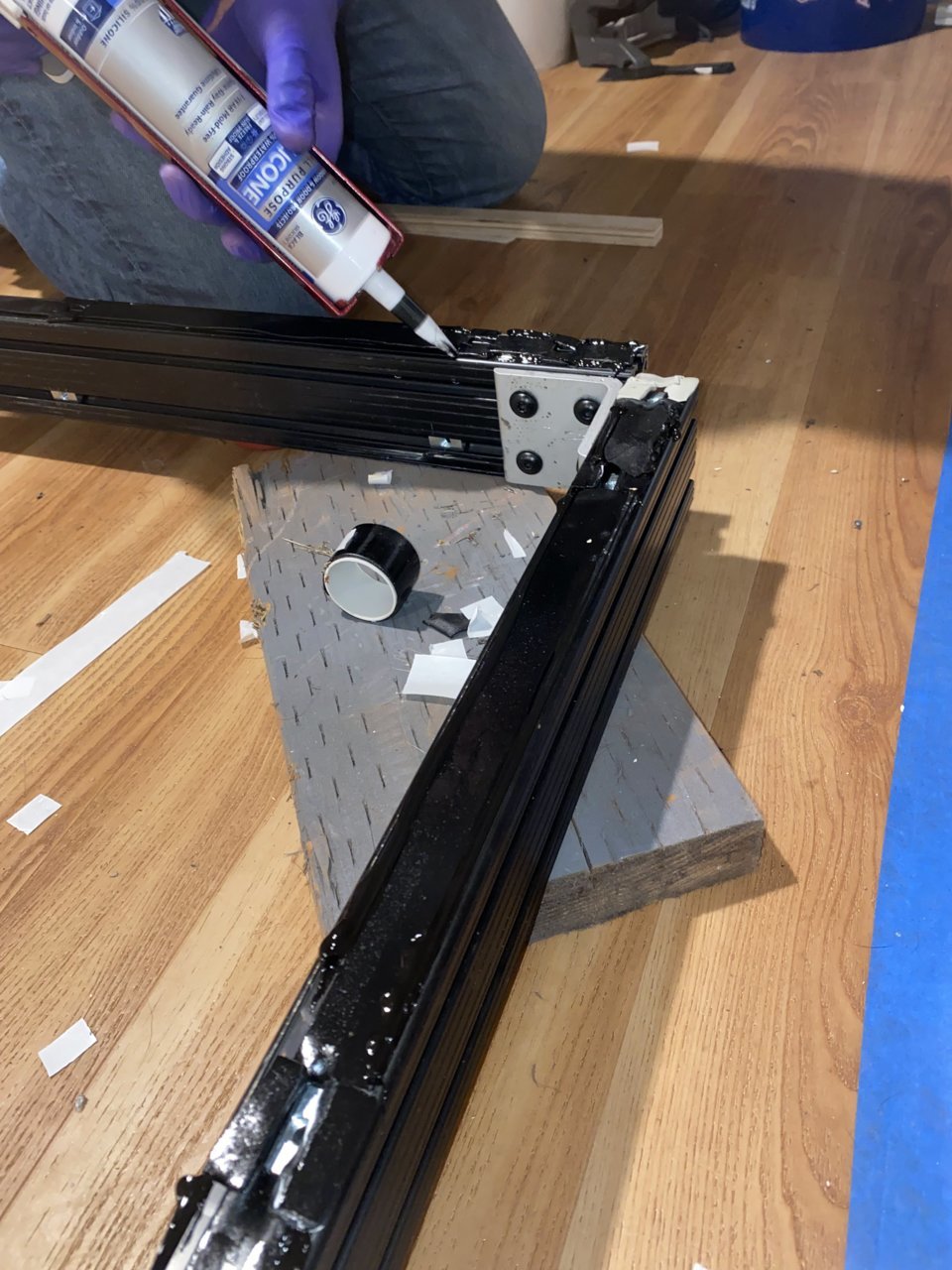

    - I went for function much more over form here, I butyl taped and silicone caulked every joint.
    - Sewed corners flaps for the tent

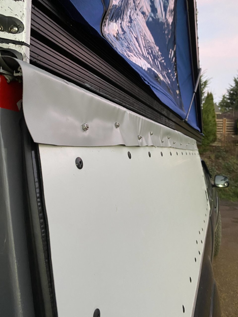

    - Still had some tiny dribbles coming in the corners while open, simply sealed it off and joined the corner pieces with Flex Tape (silicone tape), don't over think it :)
    - Since winter camping has pretty much passed, I mounted the original tent.

    Love it! The mood lighting is my fav
    I wore the free T-shirt yesterday too

    Popped the tent today after a few days of rain and where I was getting leaks before is now bone dry with the rubber surround.
    Now just need to fix some door seals and should be pretty good

    I as well went out this weekend, to the coast to steelhead fish, and now with Rubber Shield BONE DRY! stoked
