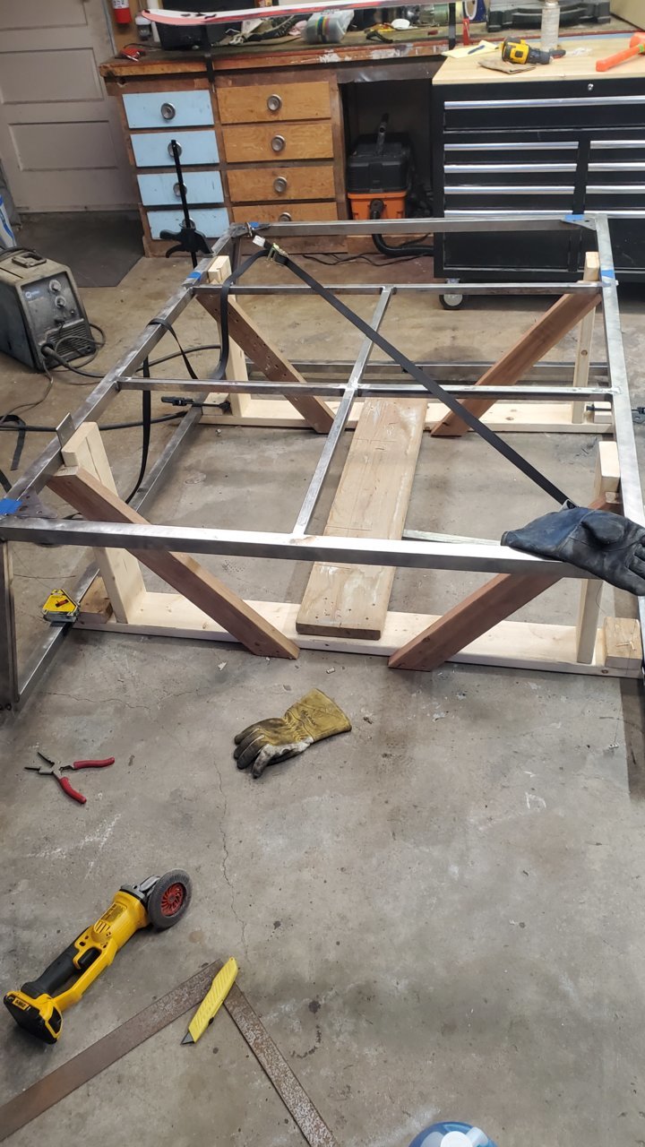

    Who can spot what I did wrong?

    06 Tacoma TRD Offroad
    Welded with two different gloves?

    2011 TRD Off Road
    Your opening the get into bed is on the wrong end?
    That was my second guess.

    #359431
    56
    Tom
    CO
    21 AC spORt
    Bingo. Lucky the top frame was only tacked on, but it still was enough to keep me from finishing the frame tonight.

    #169939
    4,074
    Steve
    Buffalo NY
    2011 TRD Off Road
    I was gonna say it looked like you could just switch the one cross bar to the rear and be all set. Couldn't tell if that bar ran all the way through or was two pieces.
