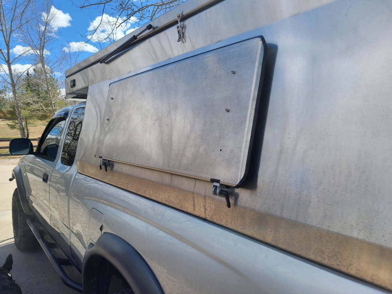

    Custom Aluminum Camper

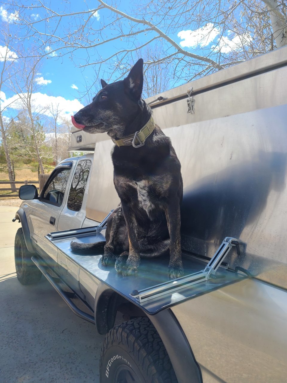

    I added a fold down side table to the camper.
    Sturdy enough for to hold one chunky heeler.

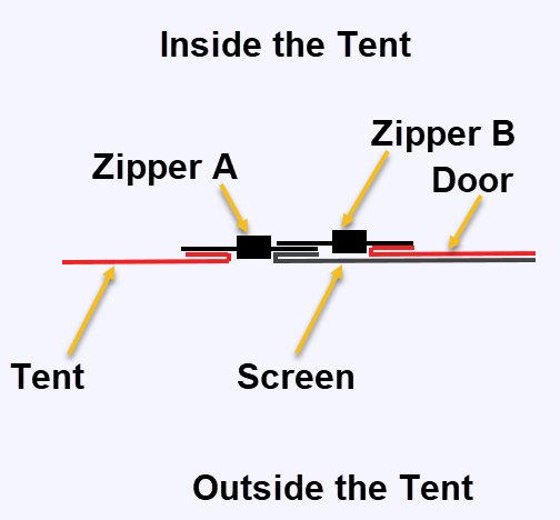

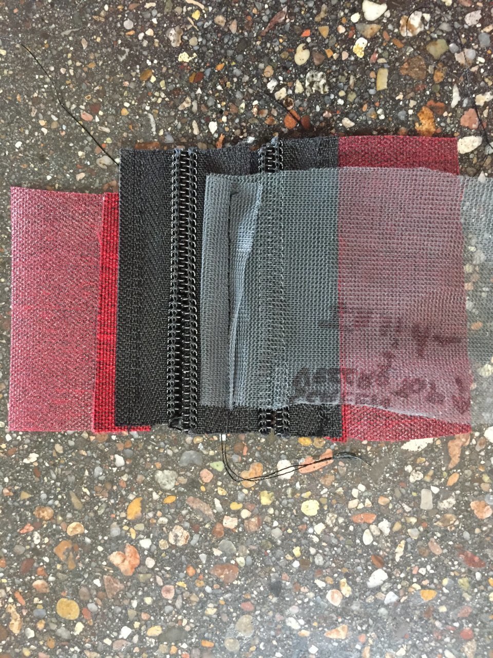

    So I’m working on ordering all the fabric and other items for the tent. I noticed that the same waterproof zipper is used for the screen. Seems unnecessary to spend the extra money on the waterproof zippers for the screen. Am I wrong? Anyone else forego the waterproof zippers on the mesh screen?
  4. Apr 6, 2022 at 9:01 PM
    #2784
    RubberDuck
    RubberDuck Well-Known Member
    Mar 15, 2021
    #359431
    56
    Tom
    CO
    21 AC spORt
    It depends on how you sew the mesh. I copied @Taco_Camper, so both the zippers do get exposed to the elements. 20220406_215811.jpg
    Zipper A on left, Zipper B on right behind the mesh.

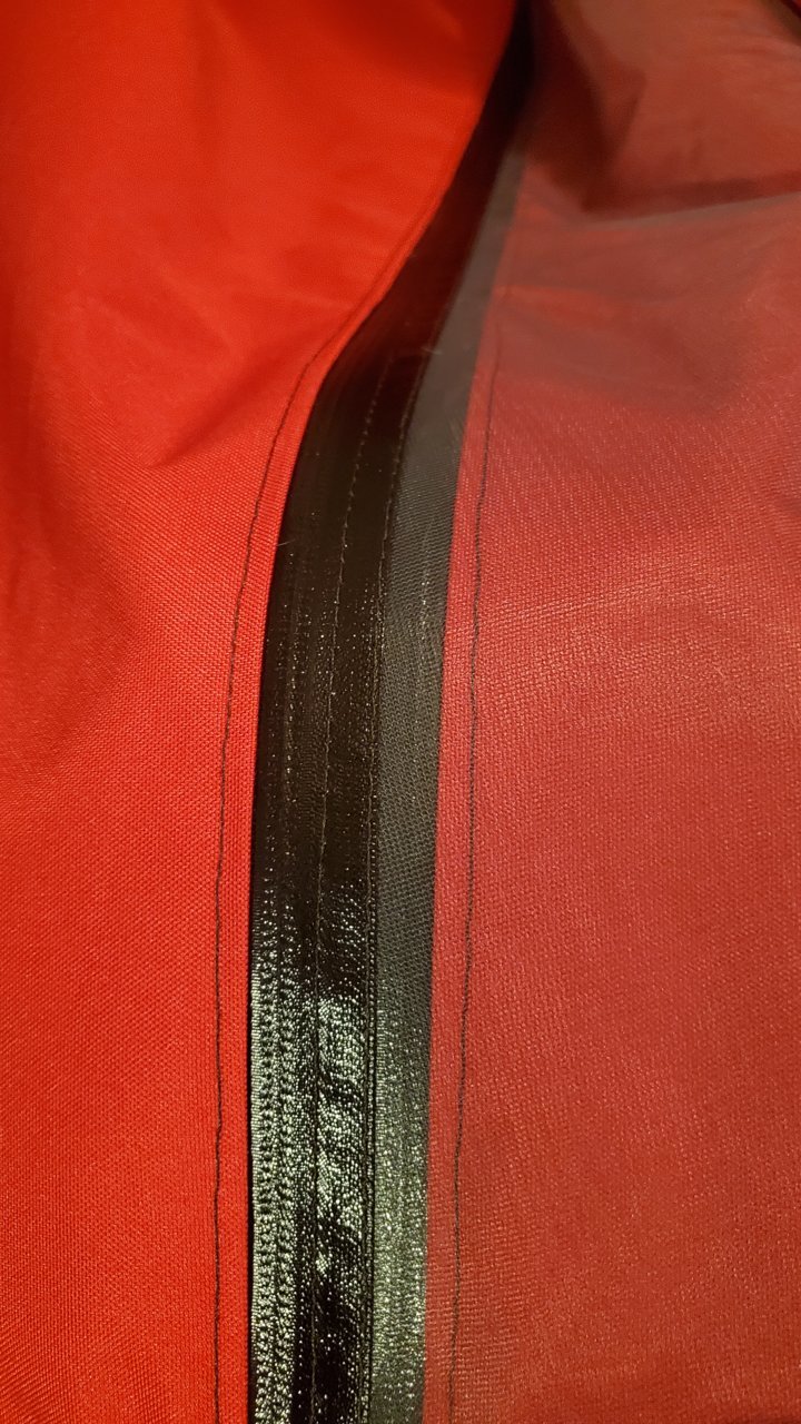

    Hard to tell what I'm looking at. Is this it?:
    Taco Camper and BaywatchDV like this.

    I put the screen in between Zipper A and Zipper B, and didn't bother hemming it before sewing the zipper on. I can try to take better pictures later.

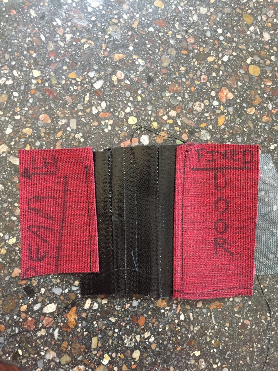

    These pics give you an idea and there are a bunch that I posted in that link. I have the screen on both the inside (rear) and outside (LH and RH). That is a good setup as I normally only crack the side top corners open (which folds into the tent or you can tuck it out next to the screen if you want) for ventilation or to look outside or zip the panel all the way open. Yea you sorta sew the zippers together and the screen is attached to the middle of the parts.
    These test pieces are of my rear door. I had to make these first because it was confusing. :thumbsup:

    You got it! That is the side doors.

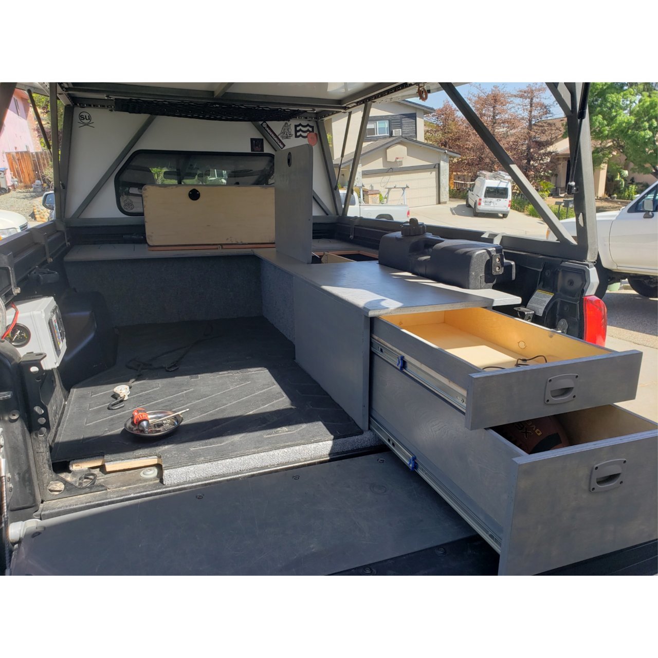

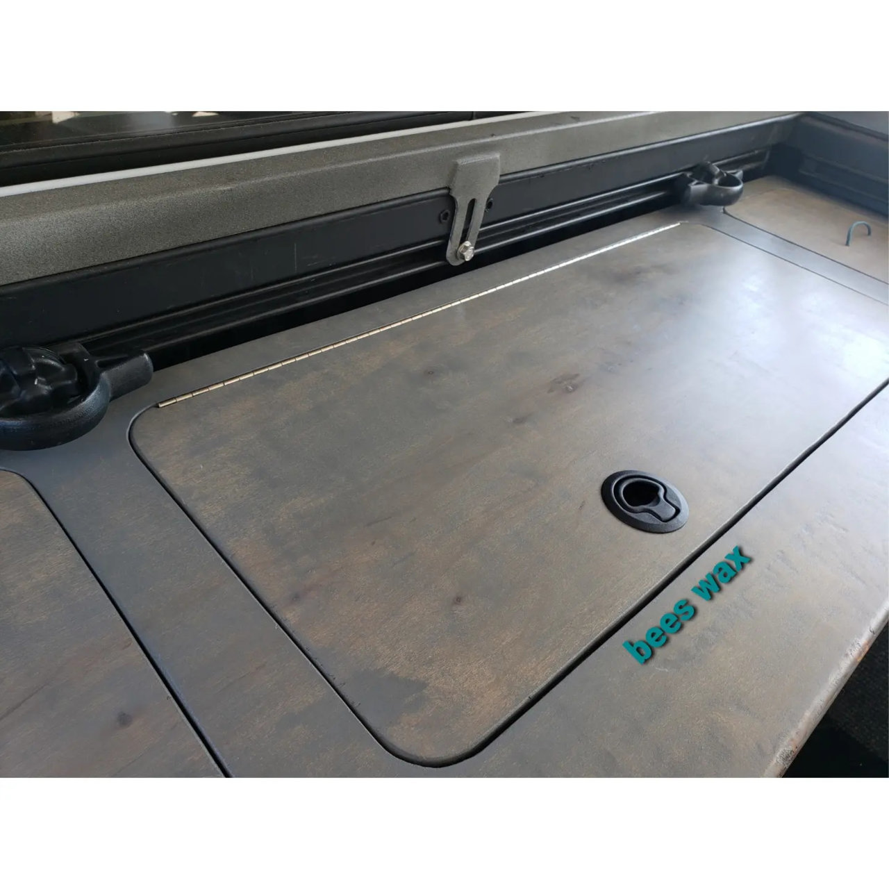

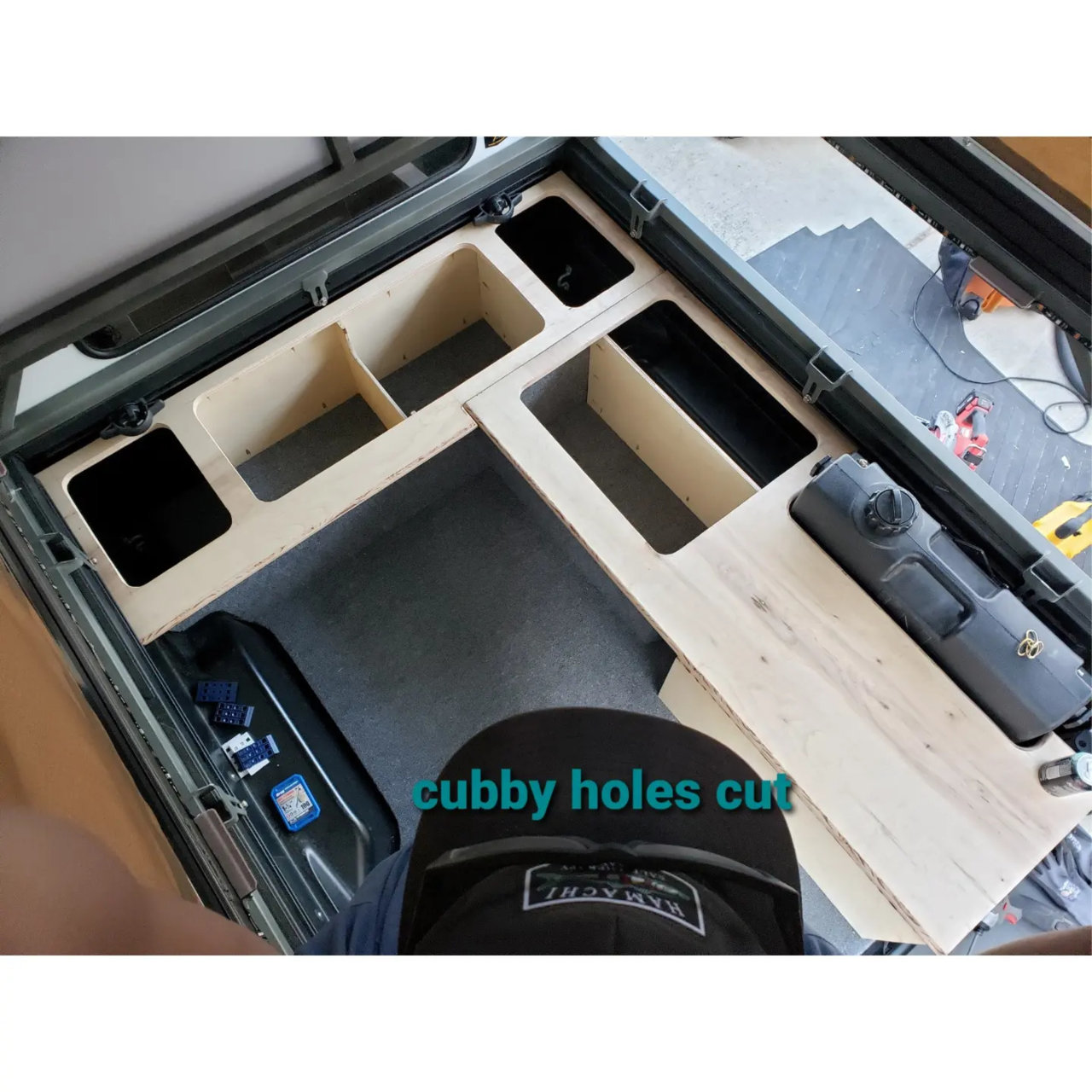

    Finished my storage system. 2 soft close 24in drawers, 2 lids with gas struts and boat latches. Thicker 3/4inch wood for the drawer box to support more weight because ill be using it as a step to get to the tent. Finished every thing with some carpet and a weathered grey stain. If you're interested in following my build, I've got most of it on my instagram. Jjnicolas_30 IMG_20220409_164242_097.jpg IMG_20220409_164242_153.jpg IMG_20220409_164242_140.jpg PhotoGrid_1649544713472.jpg

    Elliott
    2019 ZR2 Colorado
    Awesome drawer setup!

    Thanks! @nanserb. Gas struts you recommend worked great!
