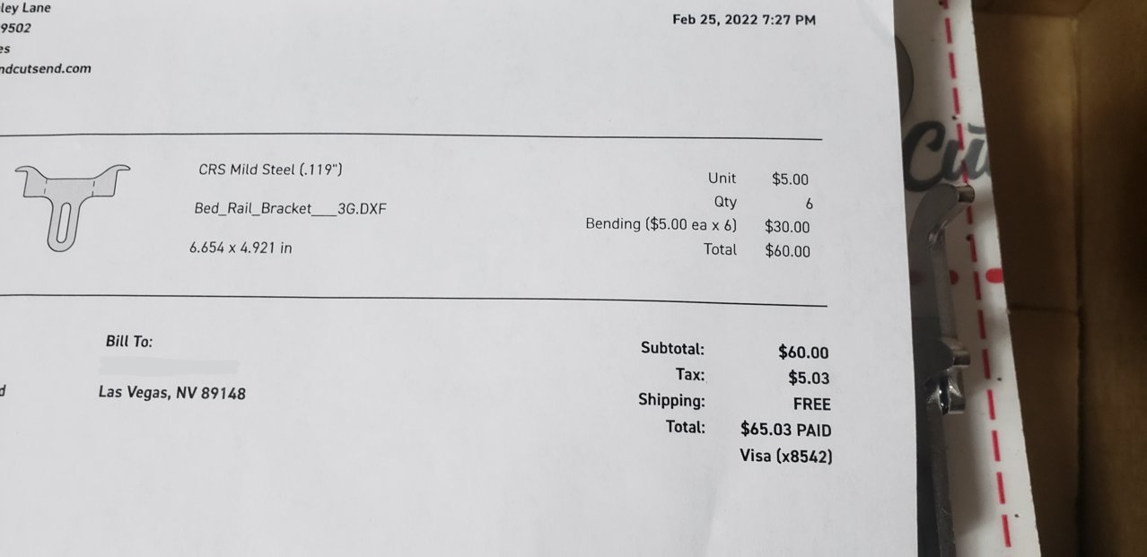

    Do you have drawings for this? I could use new brackets for mine.
