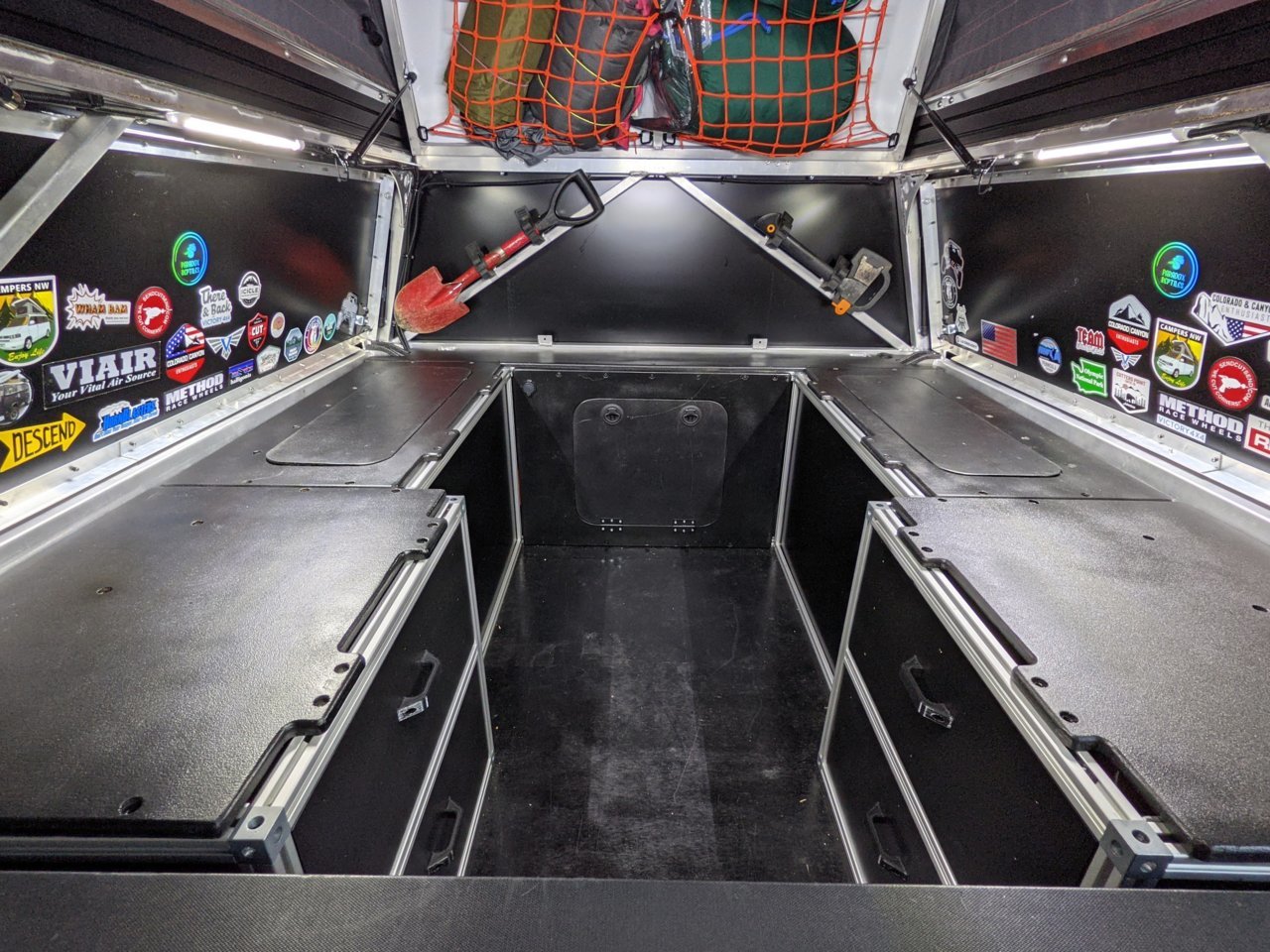

    That recessed lighting is sweet. Have any details on it?
  19. Jun 27, 2022 at 9:33 AM
    #2939
    jowybyo
    jowybyo Well-Known Member
    Nov 19, 2013
    #116863
    6,092
    Joe
    Baltimore, MD
    '14 MGM DCSB Postrunner 4wd Conversion, Debadged
    How much would you charge for something like that?
