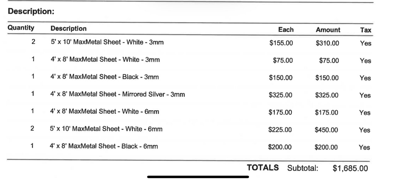

    Found a good deal on 3mm and 5mm Econolite Corrugated Aluminum 4x8 sheets. They’re white/brushed aluminum. Anyone have any experience/suggestions as to its effectiveness? They’re priced at $85. Attached are my Maxmetal quotes.
    I’m worried about the 4x8 sheets stitched together for the roof so I may bite the bullet on the 5x10 from a local supplier but I feel like these would be great for bulkhead, side panels and floor. TIA.

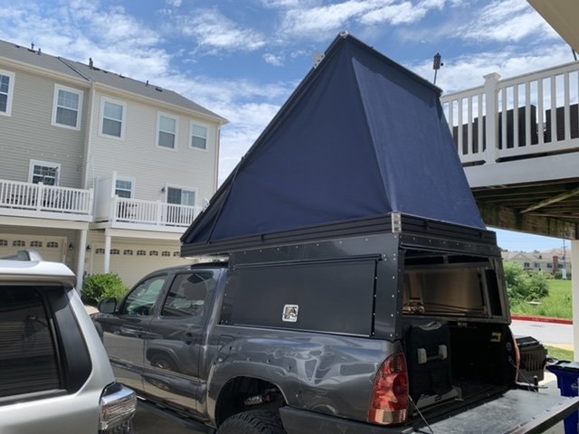

    A couple of quick questions. How is everyone dealing with the corners of the tent material? I’ve got a pretty sizable gap I’m trying to figure out how best to fill. Example in the pic.
    Also my frame seems to twist a fair amount when I open/close it. I haven’t got the top and bottom skins on it yet so I don’t know if that’s contributing or if it’s the hinges. Is there a hinge anyone is using that they feel is particularly strong? I need to move mine all the way to the corner because the struts are still pushing the side Fram rails slightly forward so my latches get very tight.

    Mine is like that and I didn’t have a problem when I camped at Olympic where it rained at least 4 nights. It wasn’t a storm but it stayed pretty dry

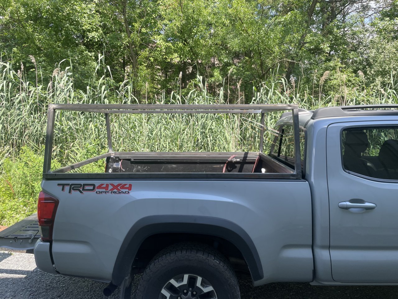

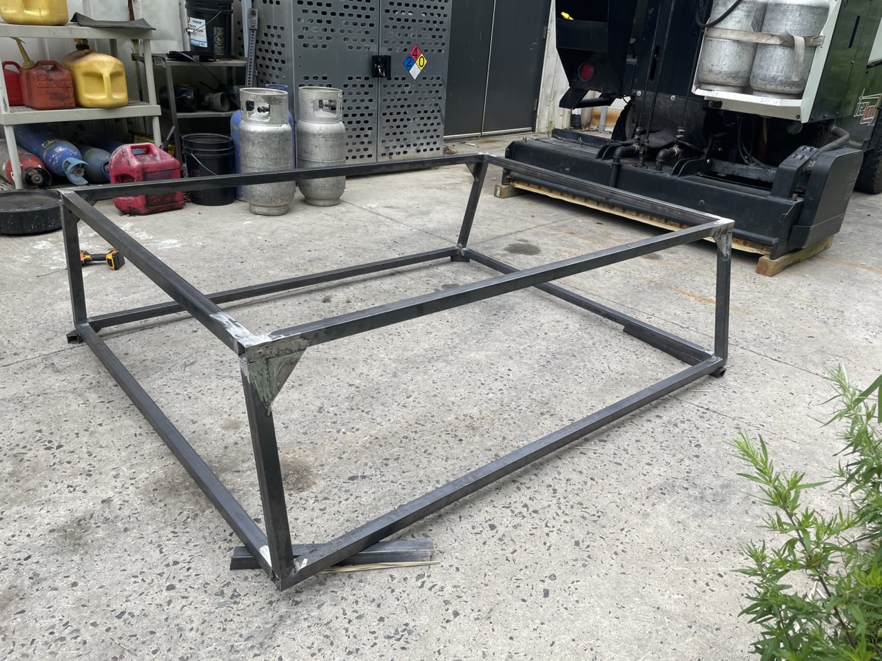

    Taking the plunge. End of day 2. Going for a straight space frame as opposed to having a slight tilt forward. When I set the frame on the truck I realized I cut and welded the bar over the tailgate ‍♂️ No wonder I didn’t have any tube left for for the sleeping area.
    Also ordering extrusion form TNUTZ here soon going with a 94” length over the max 96” they offer to save about $150 in shipping. Definitely open to comments on that! I don’t want a ton of overhang in order to still use the factory rack for skis and what not.
    And yes, that is a Zamboni in the background!
