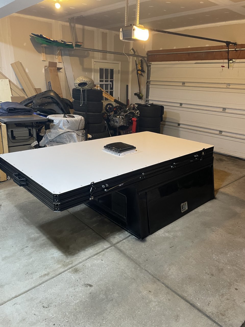

    Going on the truck tomorrow morning. Already recruited my brother and both brothers in law. Tent is still being completed by my mother in law, but luckily that can go on later. This took way too long since life gets in the way, but super excited to finally see it on the truck.

    Details on those windows? Those are sweet. Nice build.

    They look like the Tern Overland windows. Pricey but really nice.

    Thanks! yea, I enjoy having more light into the camper so I opted for the Tern Overland windows. I'll be honest, these things aren't cheap but they are a complete unit. Acrylic window with privacy blind, bug screen all built in.
    https://www.ternoverland.com/products
    The only thing I wish was that the windows came with gas struts instead and opened a bit wider but I might just modify that myself at a later time.

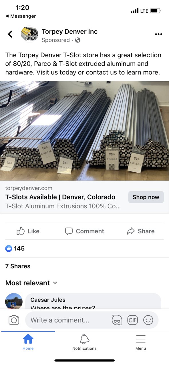

    18
    Is it just me or does it seem as if it’s no longer possible to get 100” 1545 extrusion… 8020 website says their maximum length was changed from 102” to 89” to keep shipping costs down and tnutz has non “light” 1545 but their max length option is 96”… any alternative solutions? I’m located in Denver
  11. Aug 31, 2022 at 7:14 PM
    #3031
    YamaDirtrider
    YamaDirtrider Custom bumpers @FORT-ifyRigs
    Mar 1, 2016
    #179877
    6,344
    Josh
    Elizabeth CO
    06 DCLB sport postrunner
    What hasn't been modified?
    Try these guys, just stared seeing Facebook ads from them recently. A7DFA428-6F2C-4F45-A77B-9017C09748D1.jpg

    I've heard this from a few people. Unfortunate! I'll see if I can track anything down.

    So I called 8020 and they said if I use one of their local distributors I can order up to 240” lengths but if you go direct they can only ship out 89” lengths
