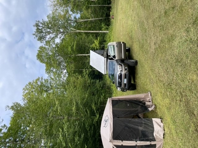

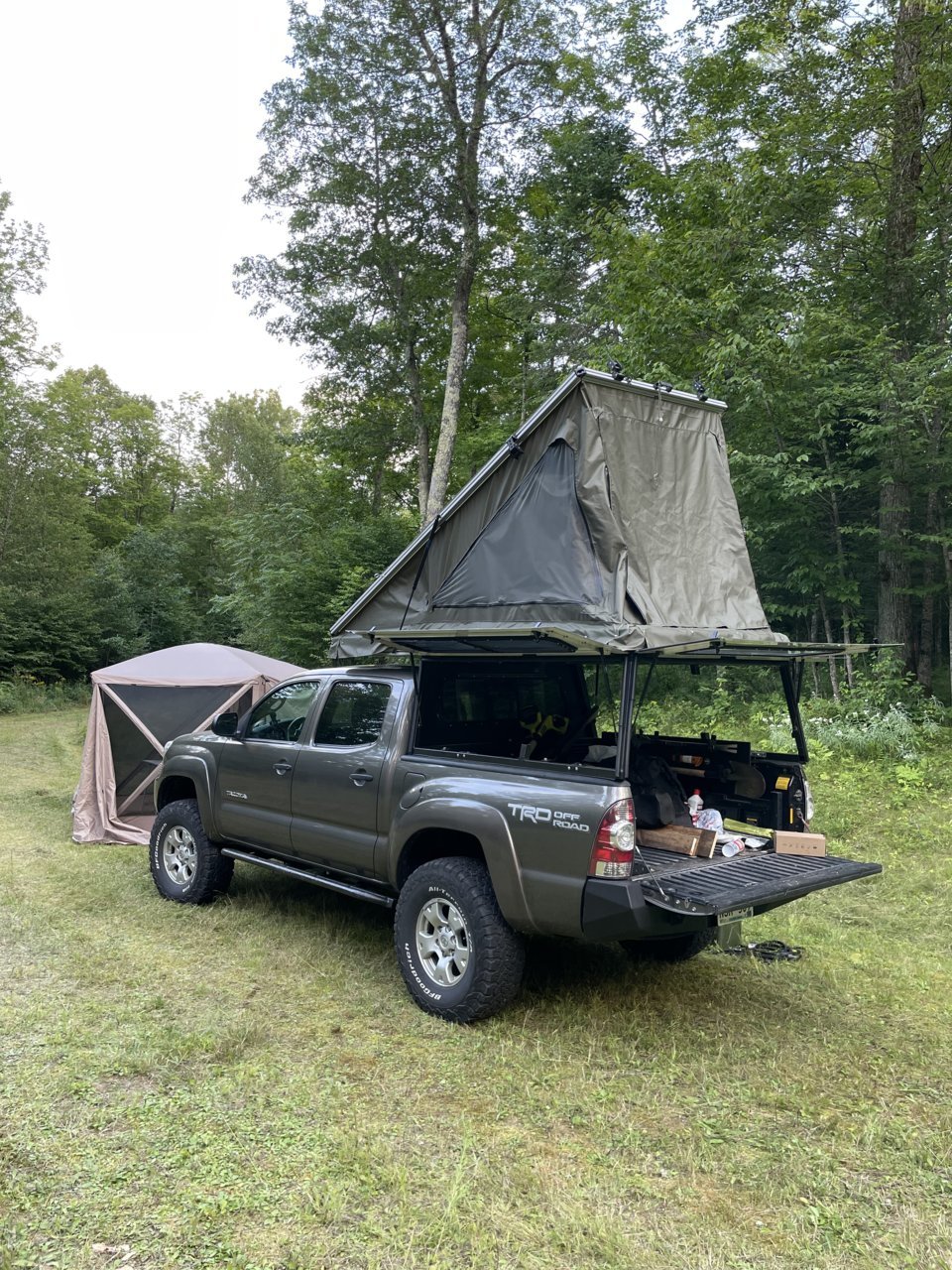

    Ok here is my build images
    Turned out decent
    I would redo the side panels a bit differently but that was the easy part and I prolly rushed through it
    Learning sewing wasn’t so bad and is solid but I would probably do better a second time
    totally doable by all
    About $3500 into it
    Afilao, KojiKP, Taco Camper and 2 others like this.

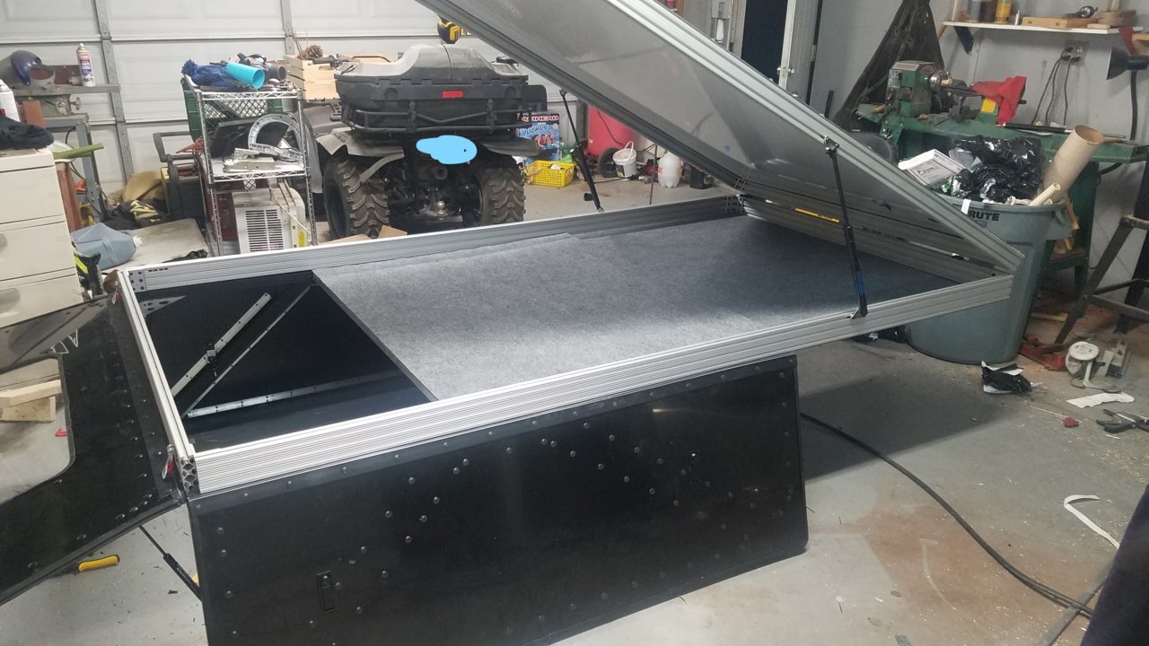

    Finally getting some use out of this thing
    Sub_Par likes this.
