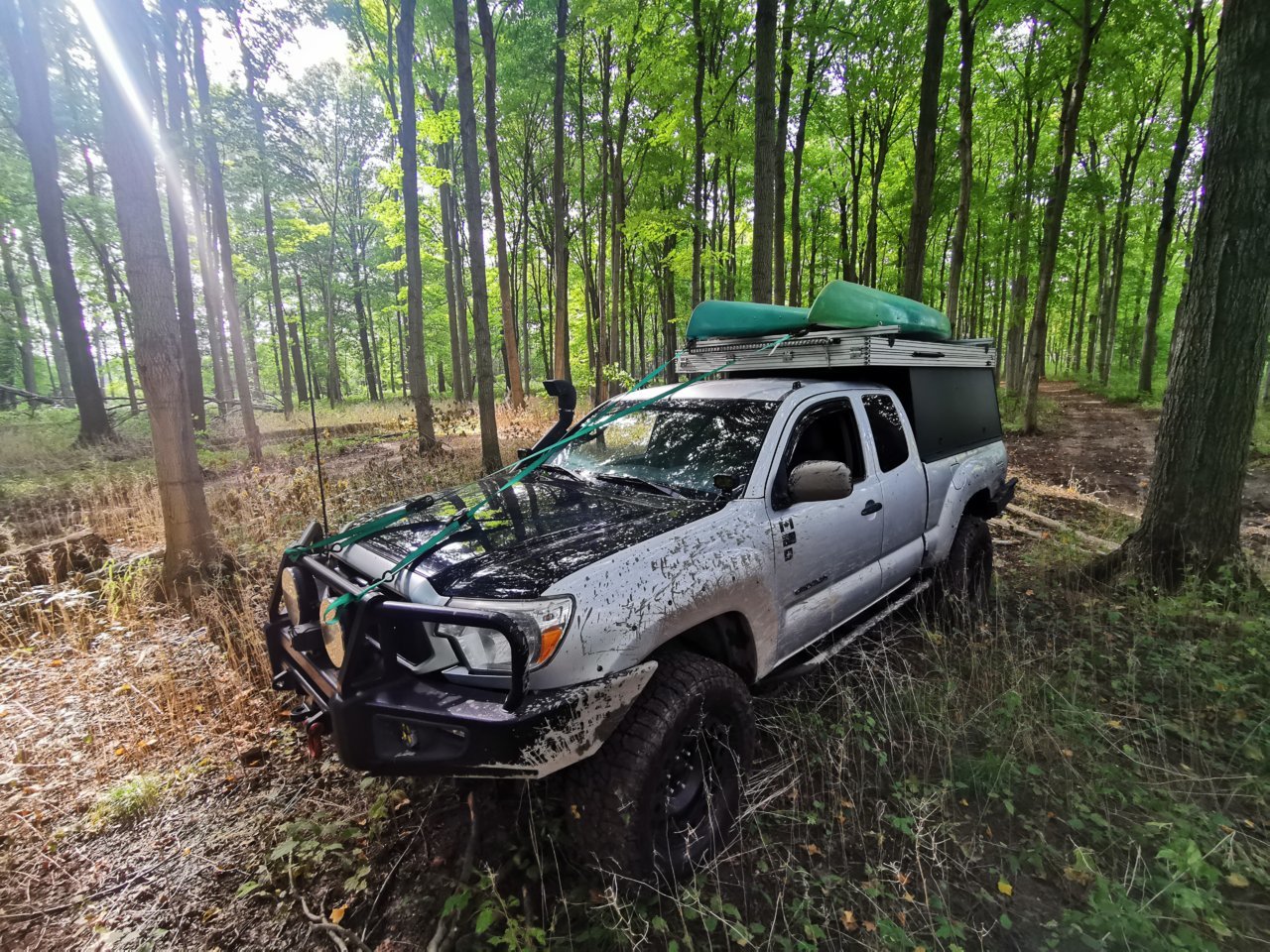

    Has anyone put kayaks ontop of this? Im thinking this needs to be my next setup.
  19. Sep 28, 2022 at 6:55 AM
    #3079
    Lumberjackcoma
    Lumberjackcoma Well-Known Member
    Mar 6, 2017
    #212540
    352
    Scott
    Ontario
    2008 AC TRD & 2007 X-Runner
    Yes, I made a simple rack so I can hold my kayaks
