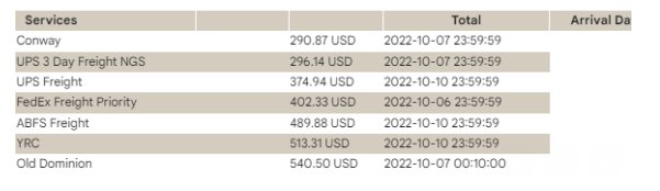

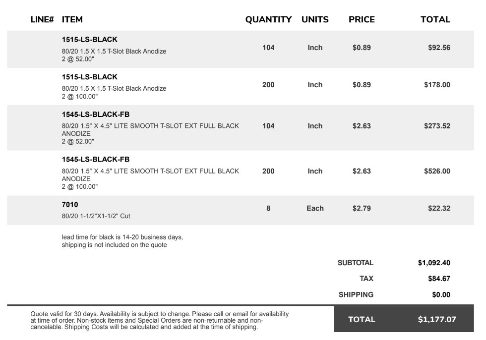

    I am getting ready to order some extrusion for my build and was wondering if anyone wants to split freight with me? We can tack your order onto mine. I am getting cut to length sections of 80/20 shipped to Sacramento, CA
    TECO Technologies quoted me $1,177 w/tax for all of my black anodized extrusion cut to length. The freight came in at approx. $300-400 depending which option is selected (UPS or FedEx).

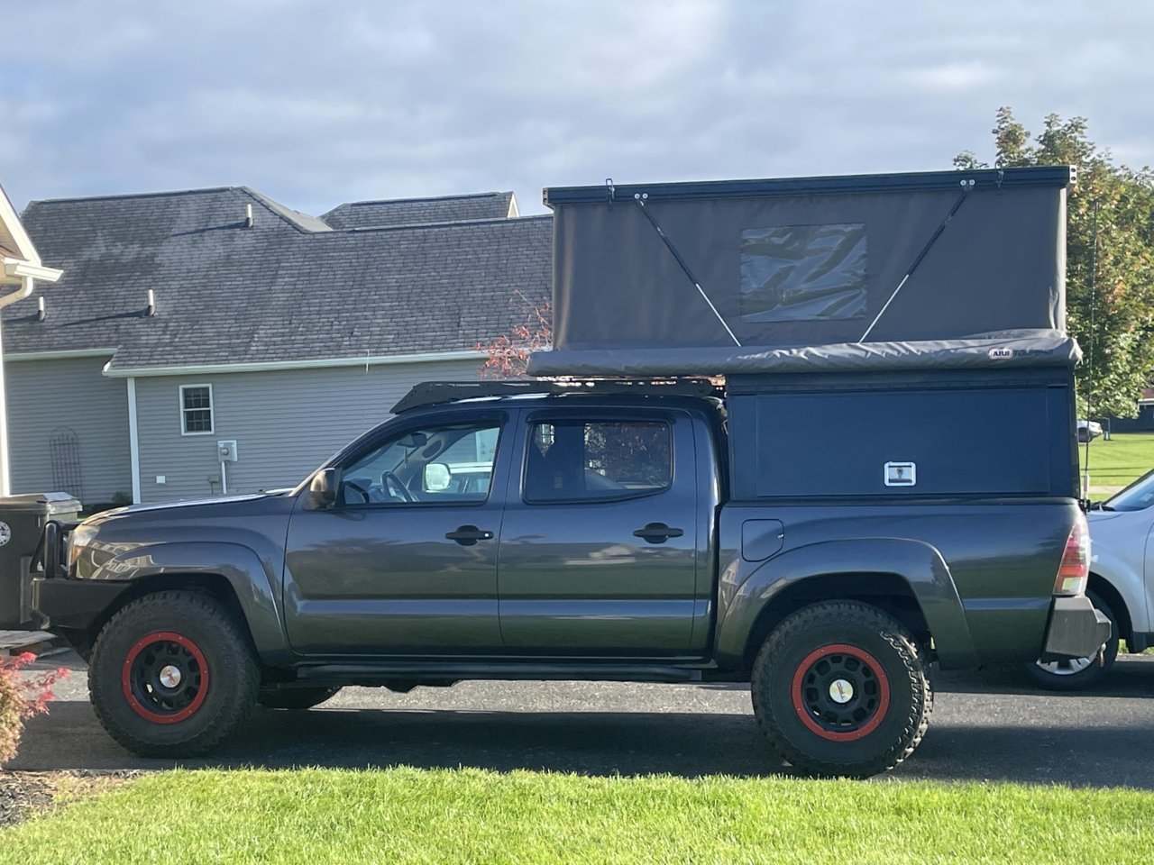

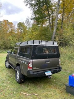

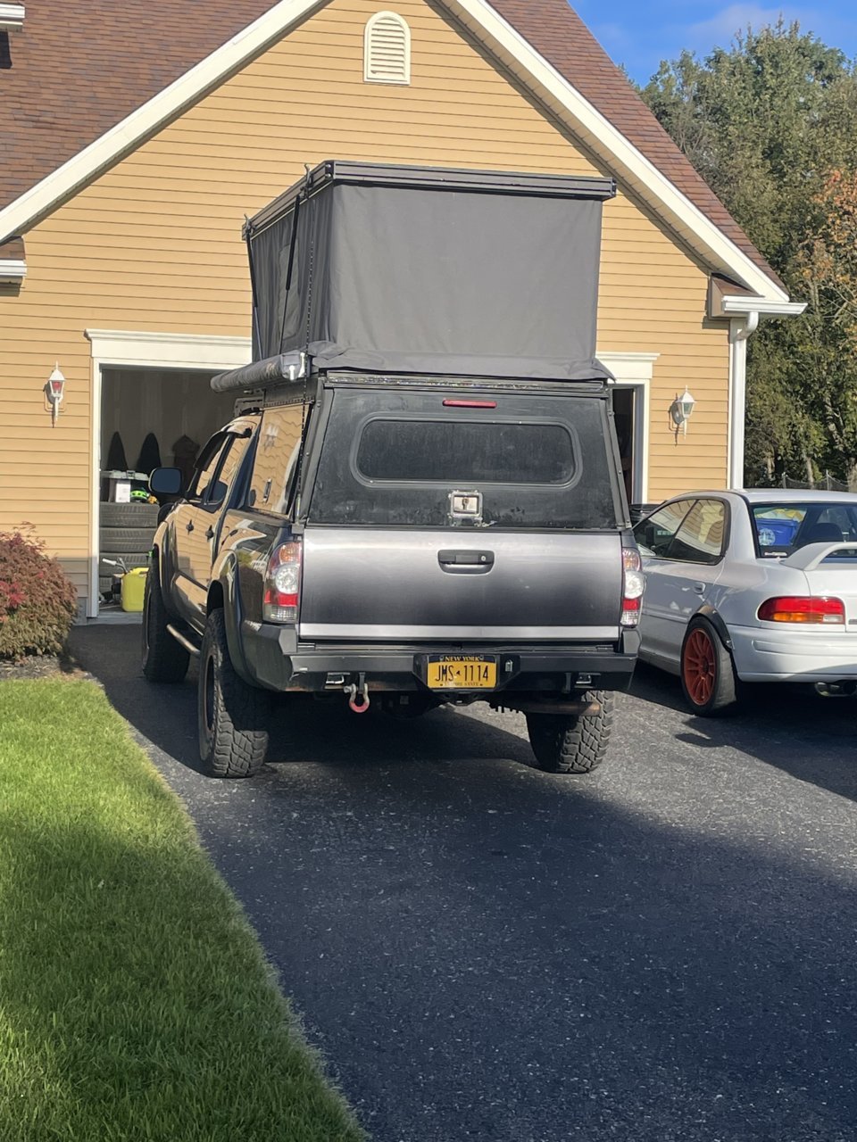

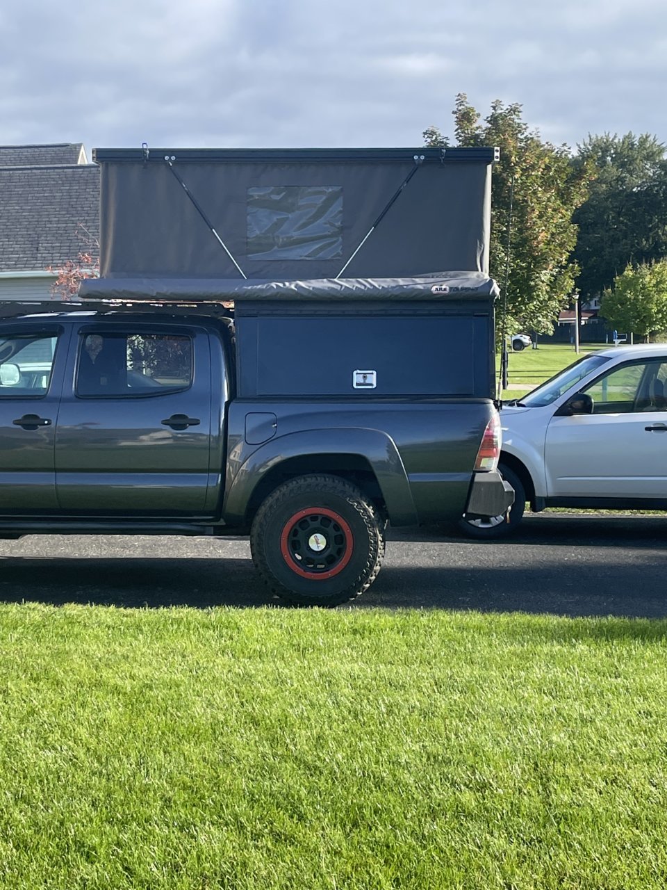

    These are never “done” but it’s ready to test and camp. DF898BA8-E7BF-4078-9483-56F9789D4C0F.jpgF43F5C28-2115-4D12-B993-90D499AB9D17.jpgB34FF9A4-FA6F-44B6-85D5-014D7B68B64F.jpg

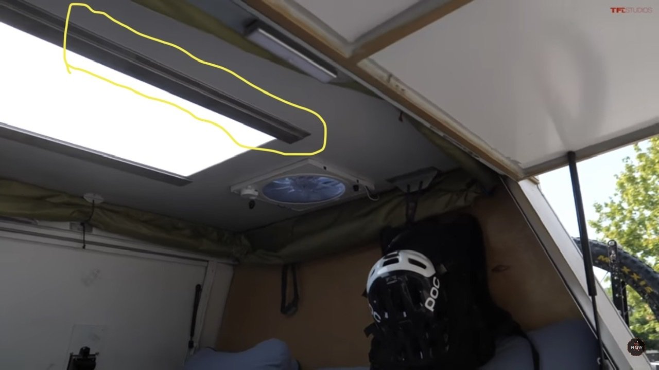

    I want to add something to my truck I recently saw in this video https://youtu.be/ERcsOjvAyg8
    it is this aluminum kind of slide rail which I marked in the picture.
    does anyone know how they are called or where to find them or are they maybe self made?

    I can’t tell for sure, but it looks like z bar or aluminum French cleat.
    https://www.amazon.com/Aluminum-Int...=&hvlocphy=9028707&hvtargid=pla-1244670220942

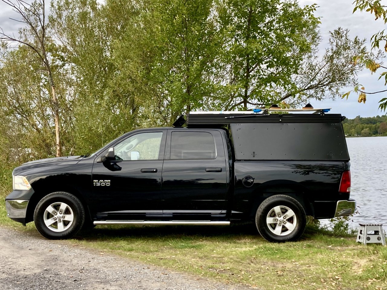

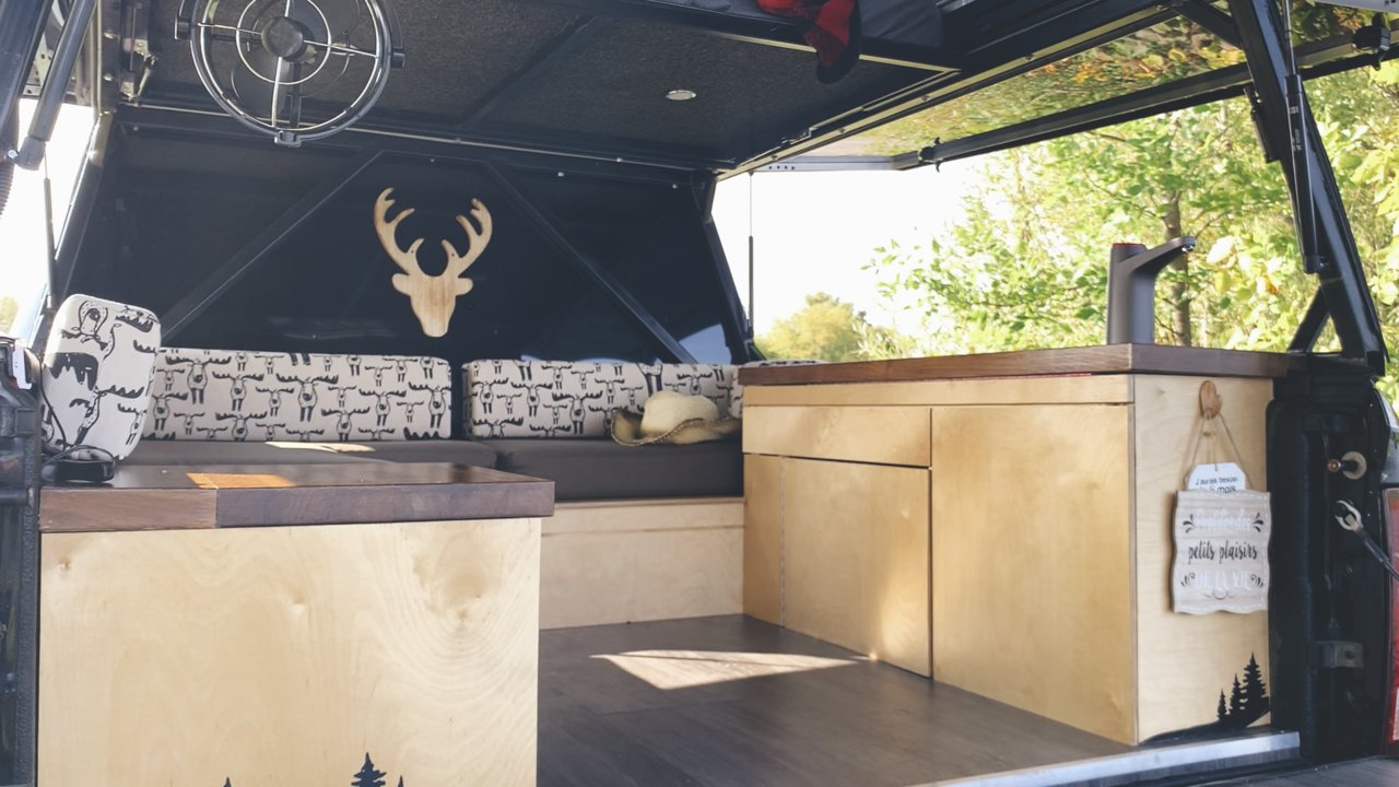

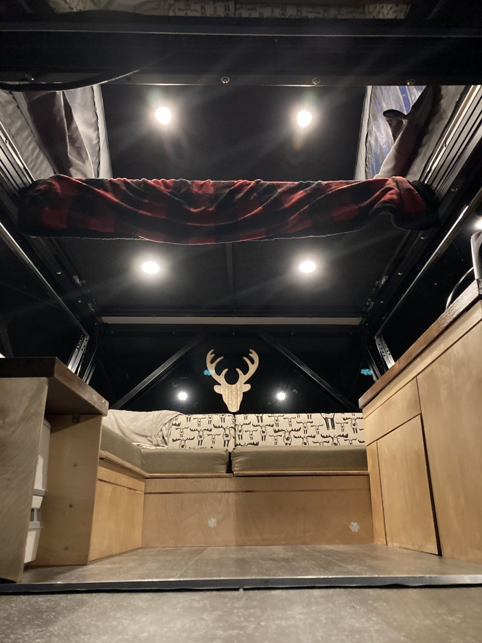

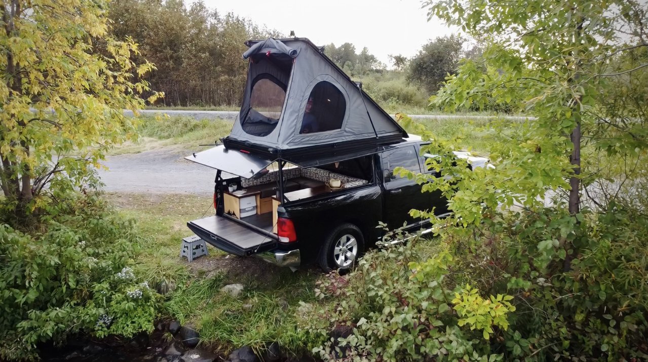

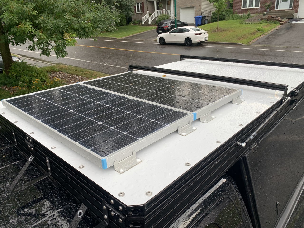

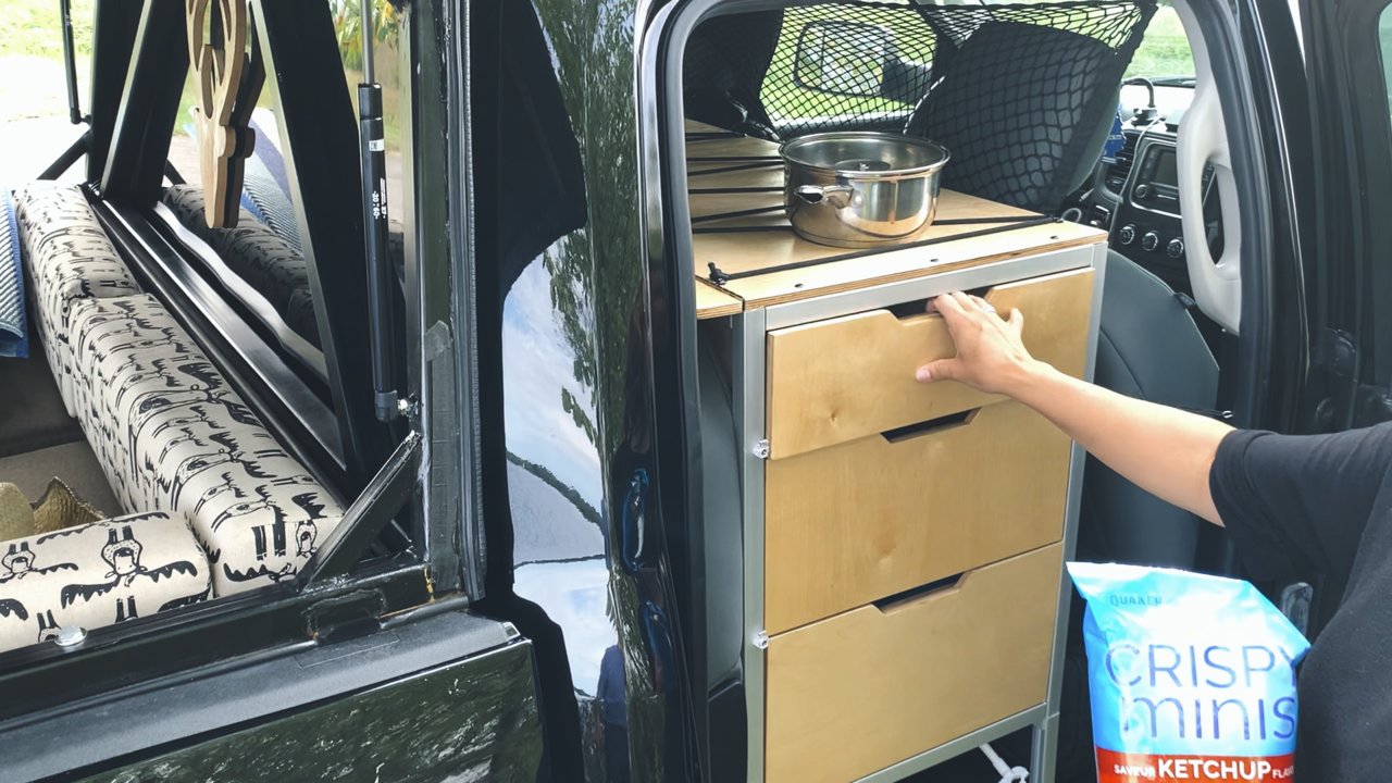

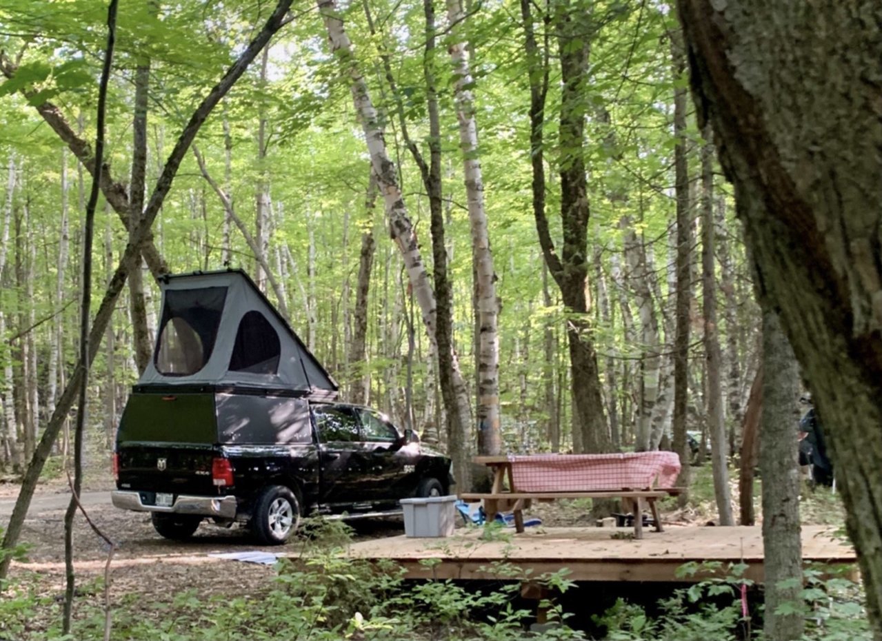

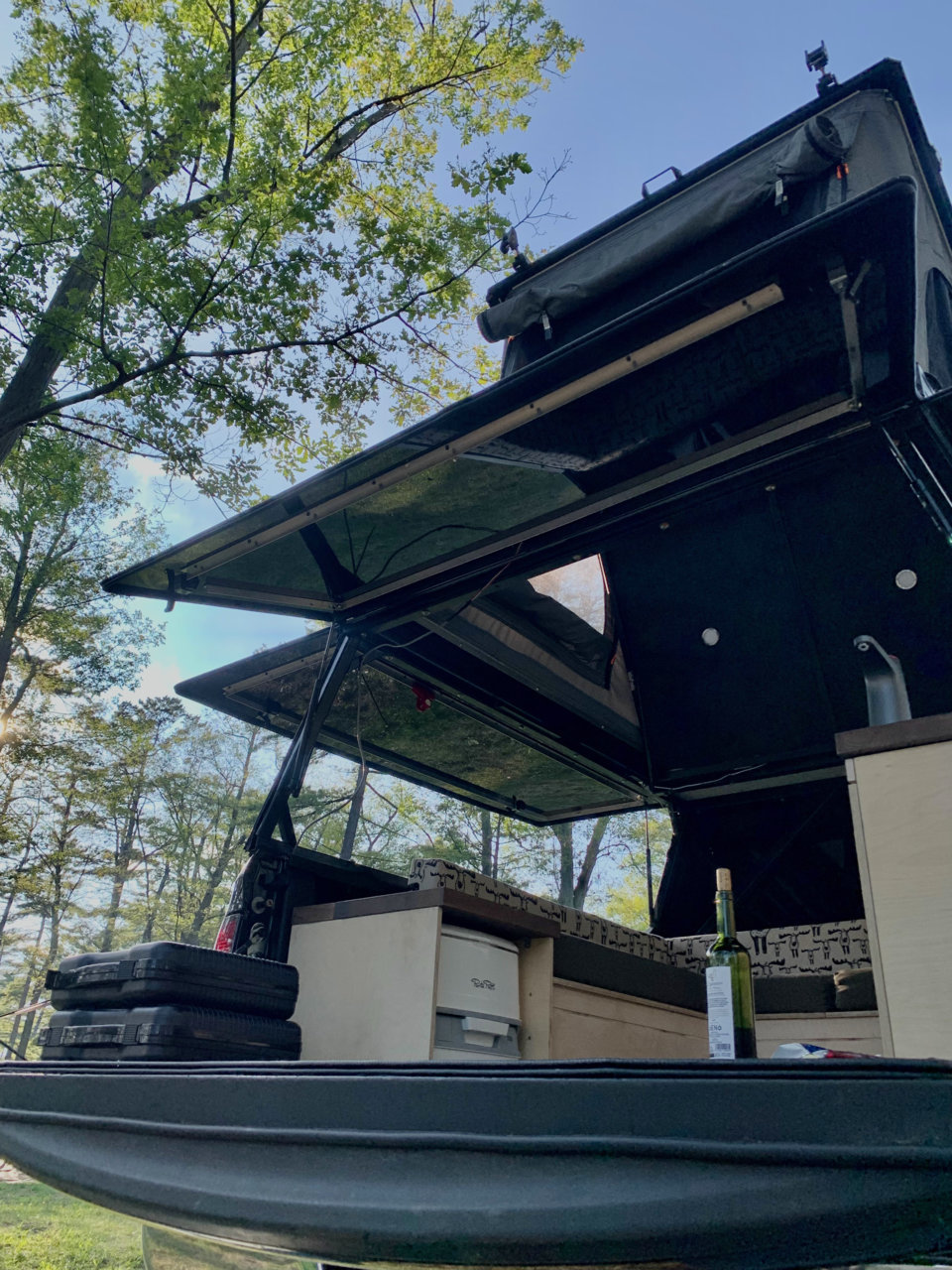

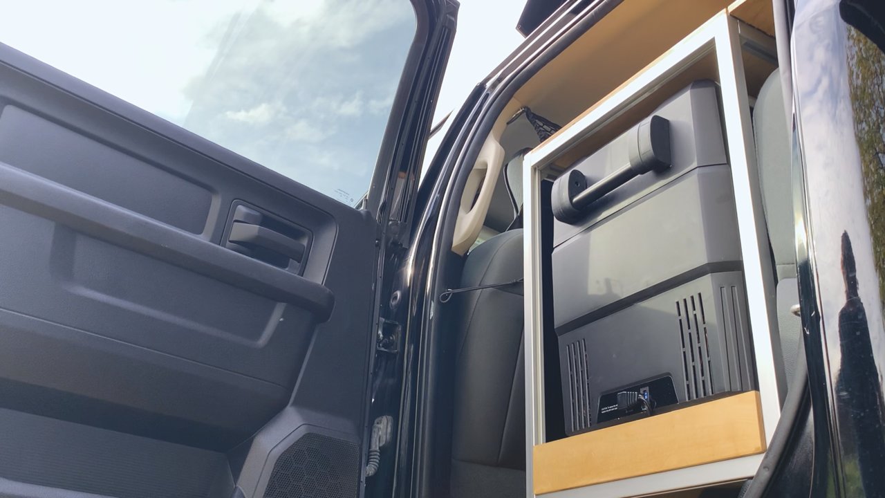

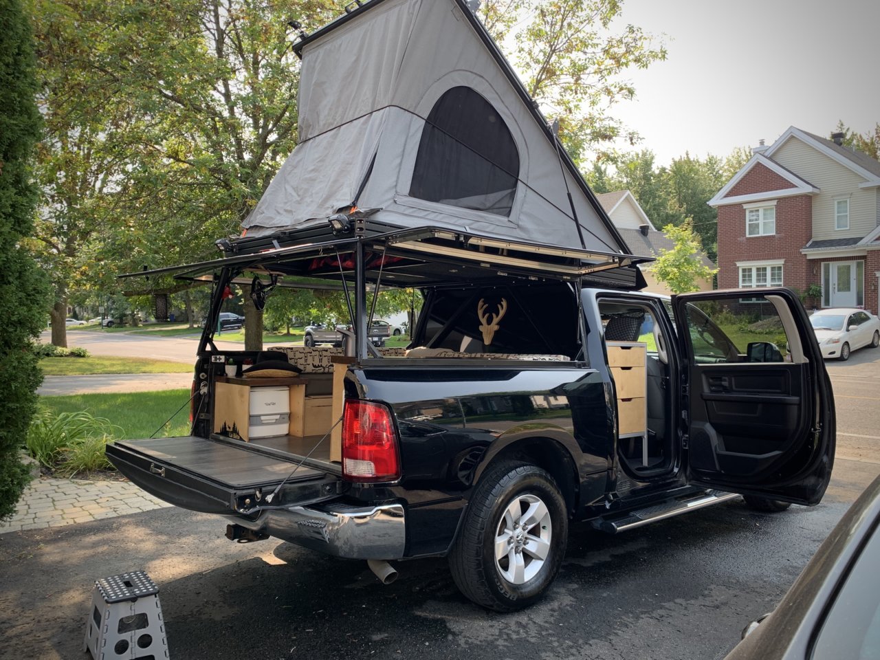

    I just want to say thanks to all of you who contributed to this awesome DIY thread and specially to @Ripcord who was so generous to share it's build all in detail. I've learned so many things while building my camper.
    I have now finished my version of my wedge camper for my Dodge Ram Pickup. I wanted to share pics and a full video tour to inspire others.

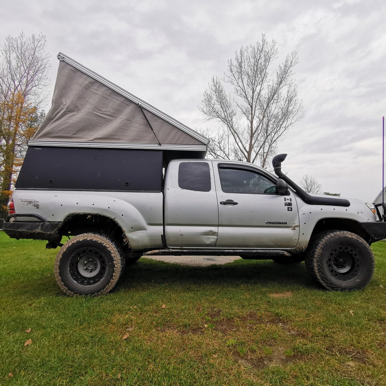

    Im selling my fully aluminum wedge, located in Ontario Canada, $1800 CAD.
