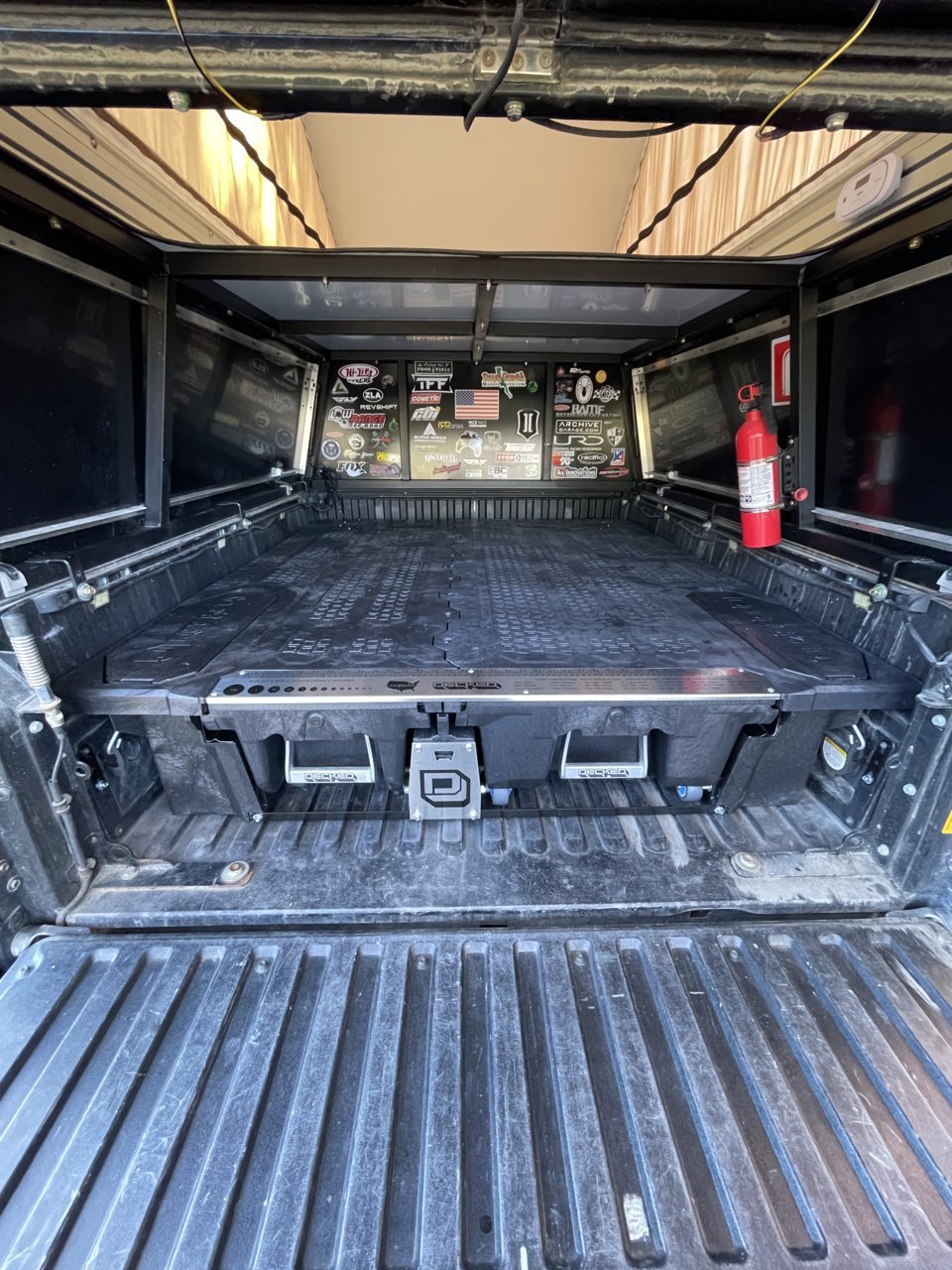

    Added Decked system to my bed today. Anyone here has made some molle panels that mount to the space frame?
