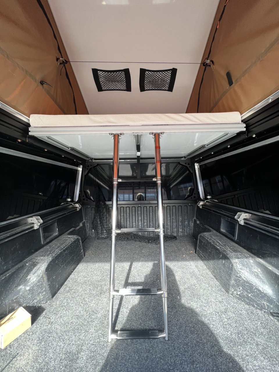

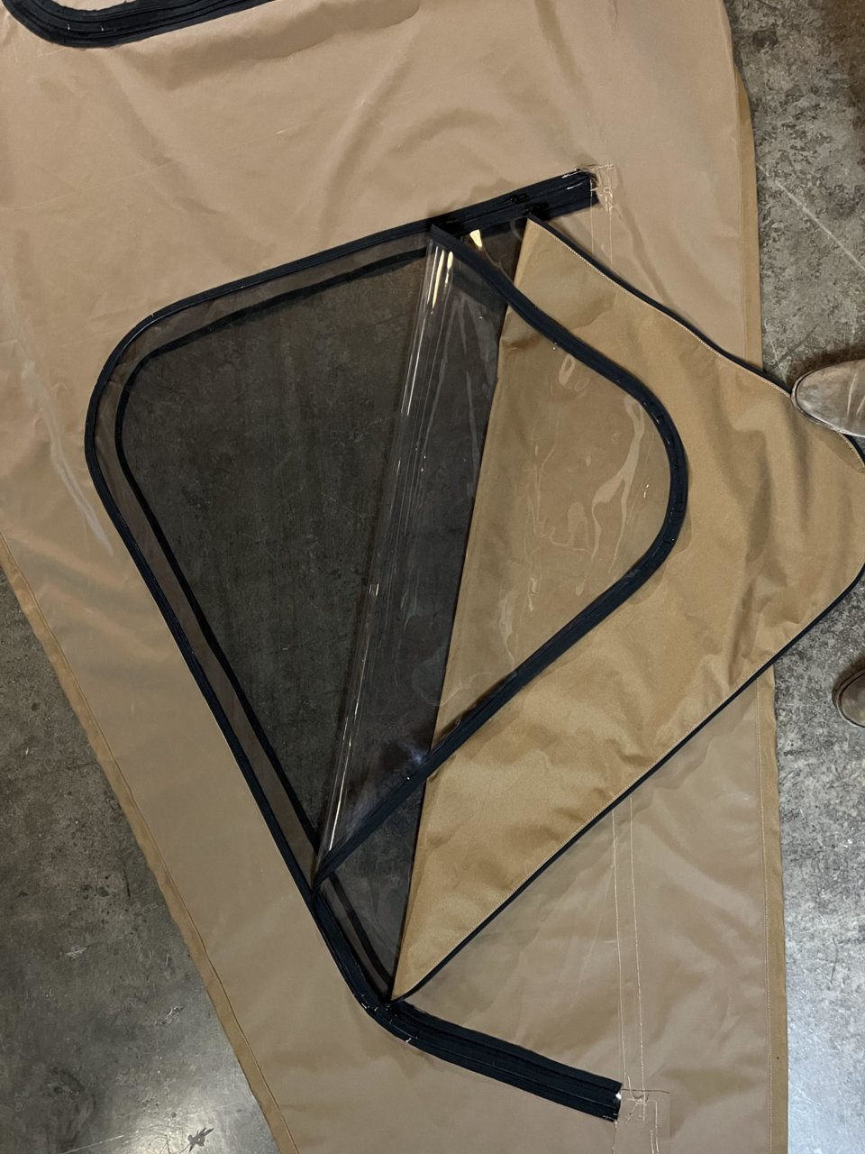

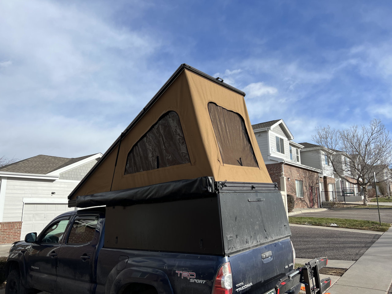

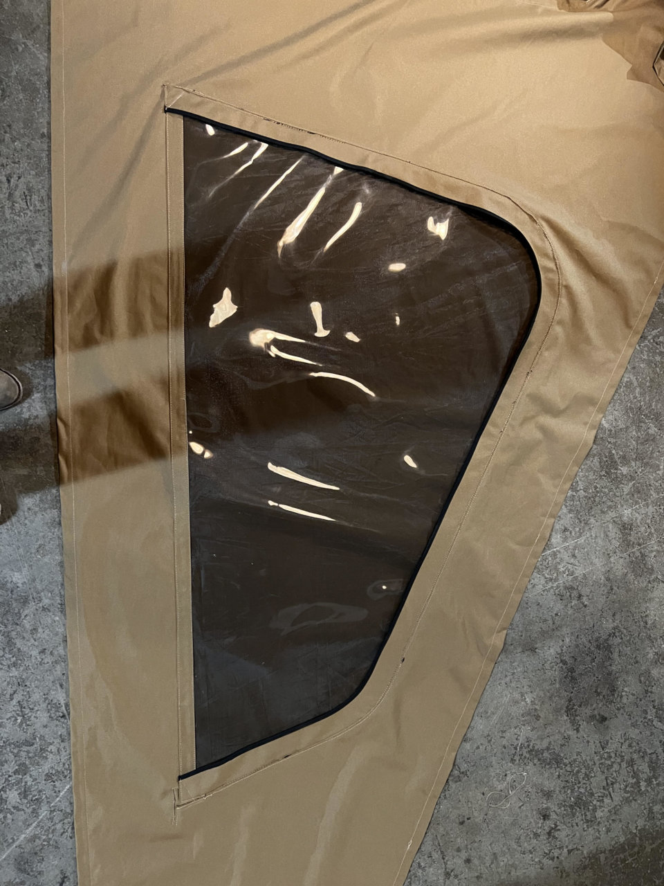

    I just finished v2 of my canvas. There were a handful I things I really didn't like about the first one I made, and some things I wanted to add.
    • I originally used a 200D Ottertex PU coated fabric but I decided I wanted something heavier, so went with 600D Ottertex waterproof canvas. This isn't quite blackout, but is much darker than the PU. The 600D doesn't flap in the wind quite as much as the 200D as well.
    • I wanted to go with a different color. I like the tan tents a lot, and the gray I used on v1 cast a weird purple shade over everything inside - messed with me.
    • The biggest issue I had with v1 was the way I did the zippers and doors. I was impatient the first time around and skipped a few steps, so my cut edges weren't finished well, and the zippers would get caught in the fabric ALL the time, along with the bug mesh - so often, that I couldn't even really use them. On v2 I took my time, used a ton of basting tape, and properly hemmed every edge. I also copied the windows of the Vagabond Drifter on this one. Side windows are tent material, clear window, then a fixed bug mesh. The rear window is just the tent and bug mesh, which both zip down. I opted to skip the waterproof zippers and make a zipper flap instead. In my opinion this looks much cleaner - hides the zippers - and is much cheaper, as I used standard coil zippers.
    • I changed to a stiffer polyester no-see-um mesh instead of the nylon type that ripcord lists. The nylon is stretchy and as stated above, would get caught in my zippers all the time, and ended up tearing a couple holes in it.

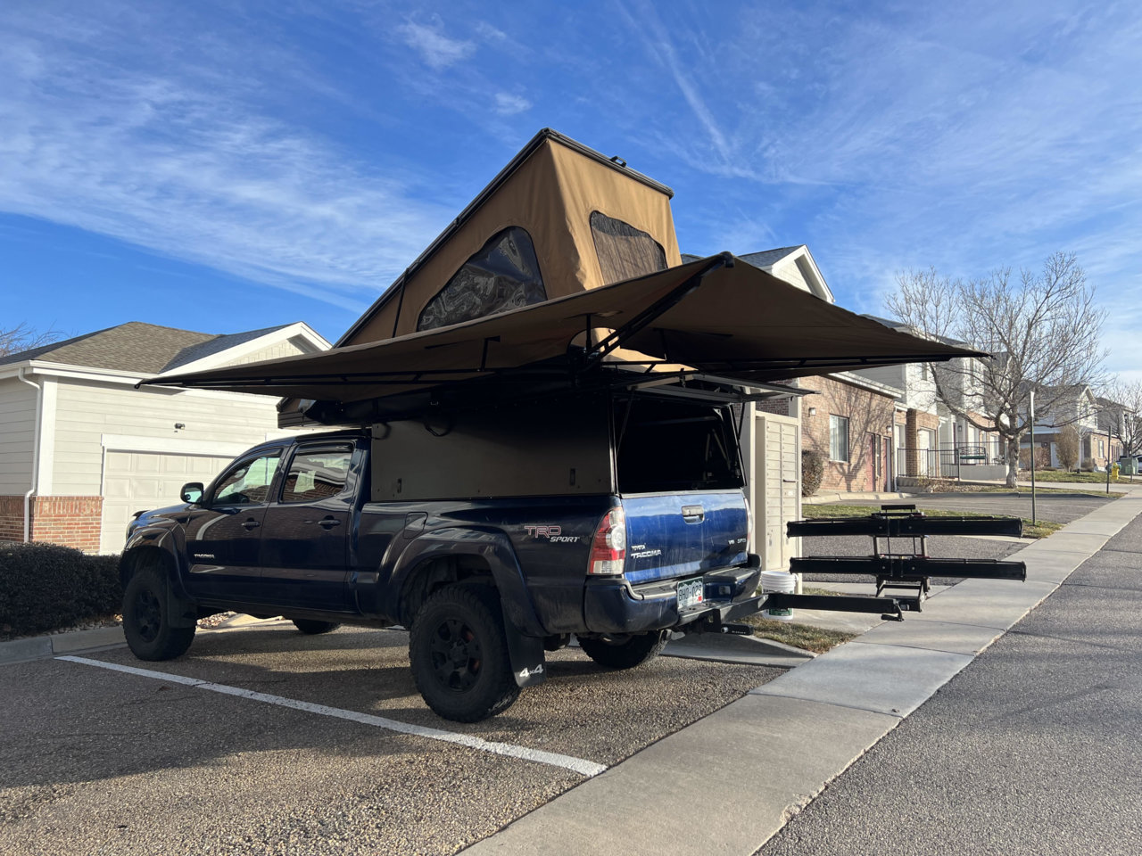

    Used the same fabric on my DIY 270 awning

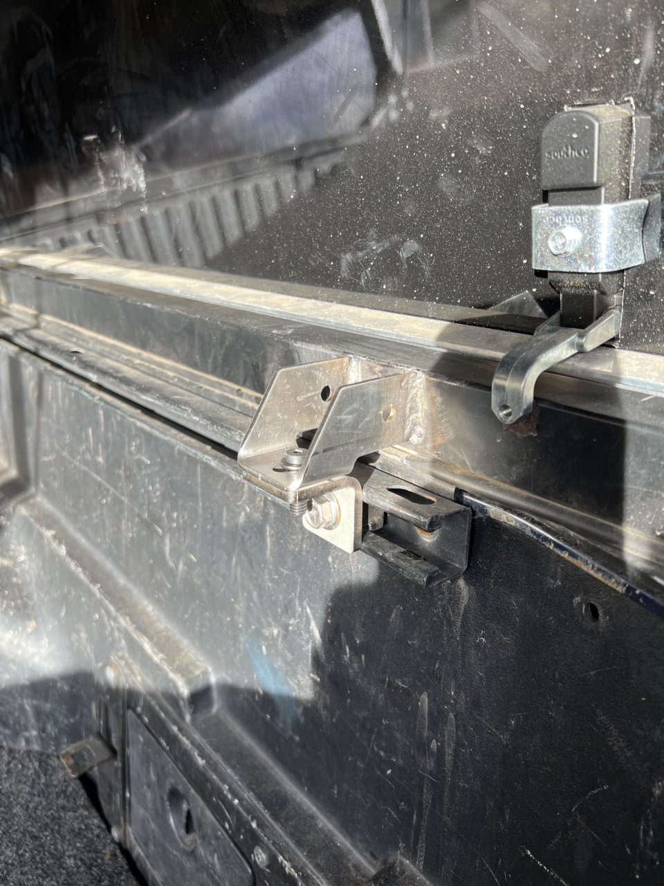

    One other thing I did recently was add a flip-down telescoping ladder to get up into the bed rather than a stool. Mostly for my son, but also nicer than having to pack a separate stool - it's always there. Got the idea from the Lone Peak camper - I used a 4-step marine ladder from amazon that I made some brackets for. My bed design is a little different, but seems like it would work on the original ripcord design as well, attaching to the fixed crossbar
    Designed a two-piece bed mount as well - these are much more adjustable. Had them made at SendCutSend - happy to share the dxf if anyone is interested.

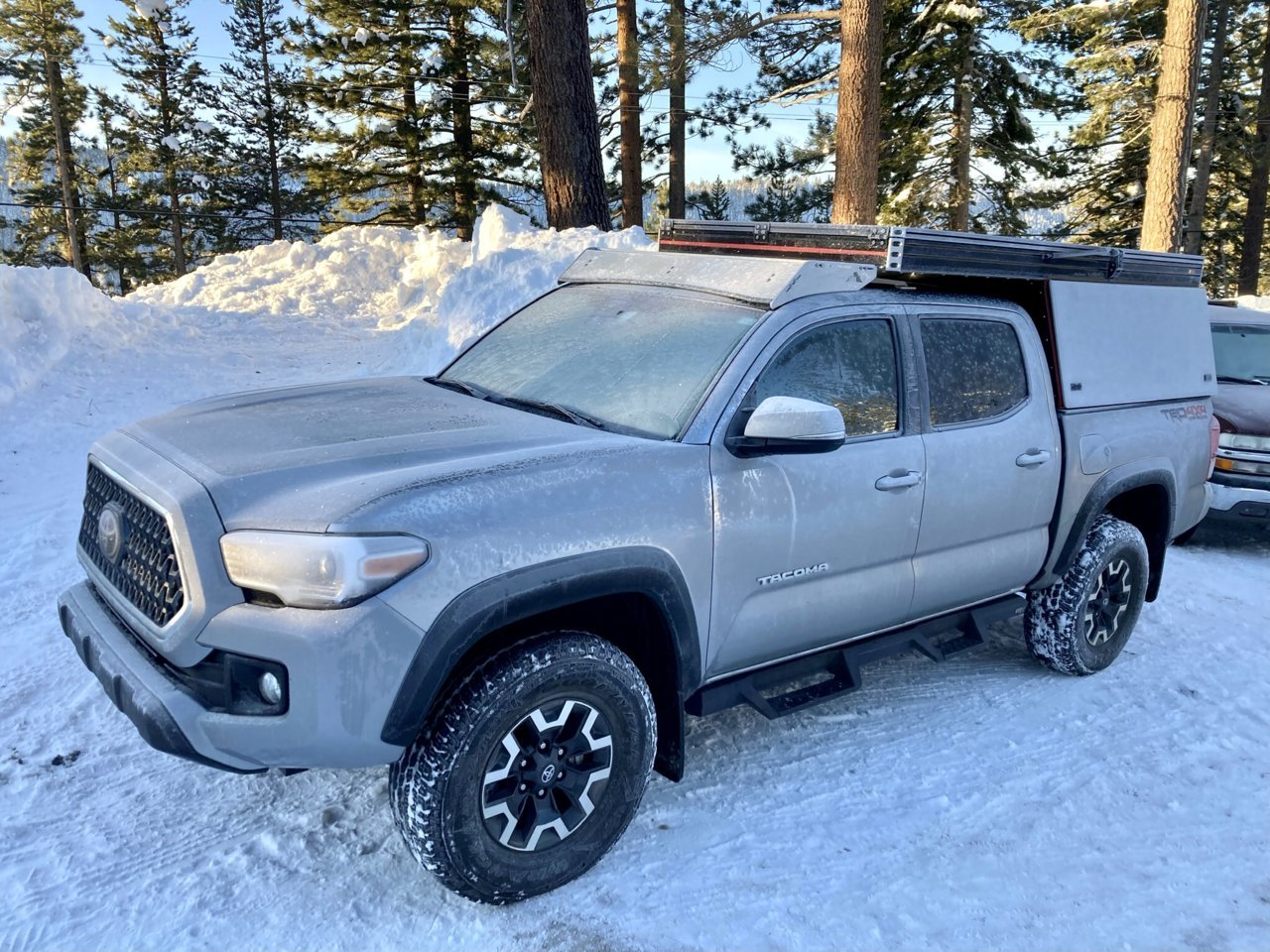

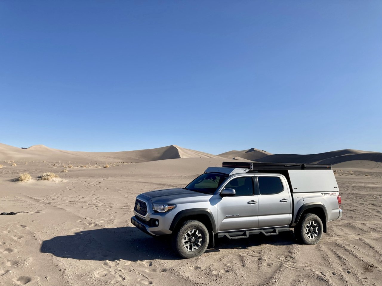

    Added a Sherpa rack, mostly for a wind deflector for a long trip to explore Big Dune NV and ended up in the CA Sierras. Not really sure it made a MPG difference but plan on modifying and painting it soon. Still going strong!E8A546C7-1867-4D5D-90BF-0E3DF69A5C61.jpg620912D7-8647-4924-B3C8-A968B20EF35D.jpg

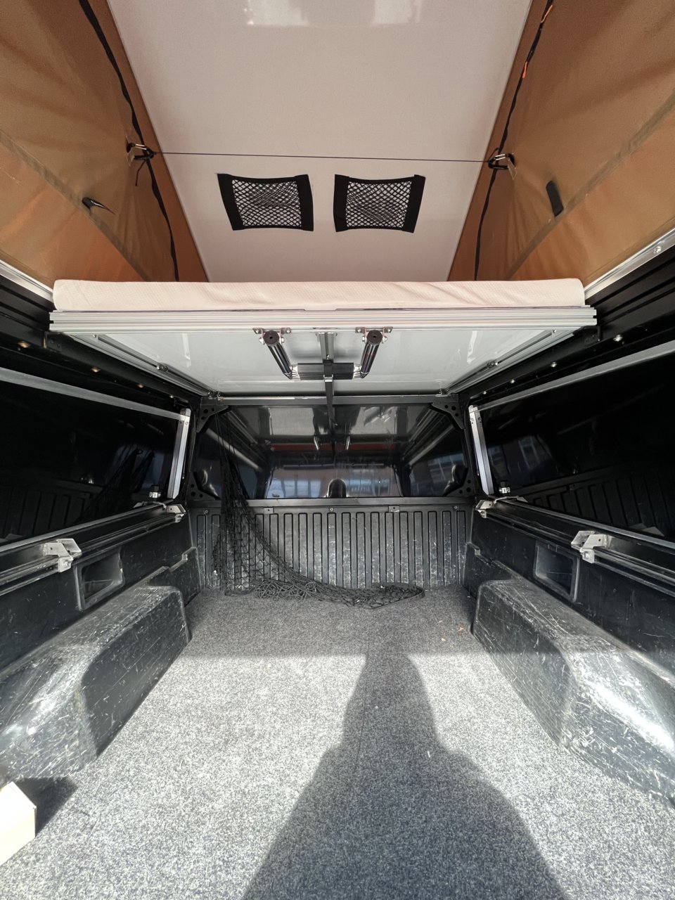

    Coming close to complete. First test fit on the bed.

    Ooo shiny
