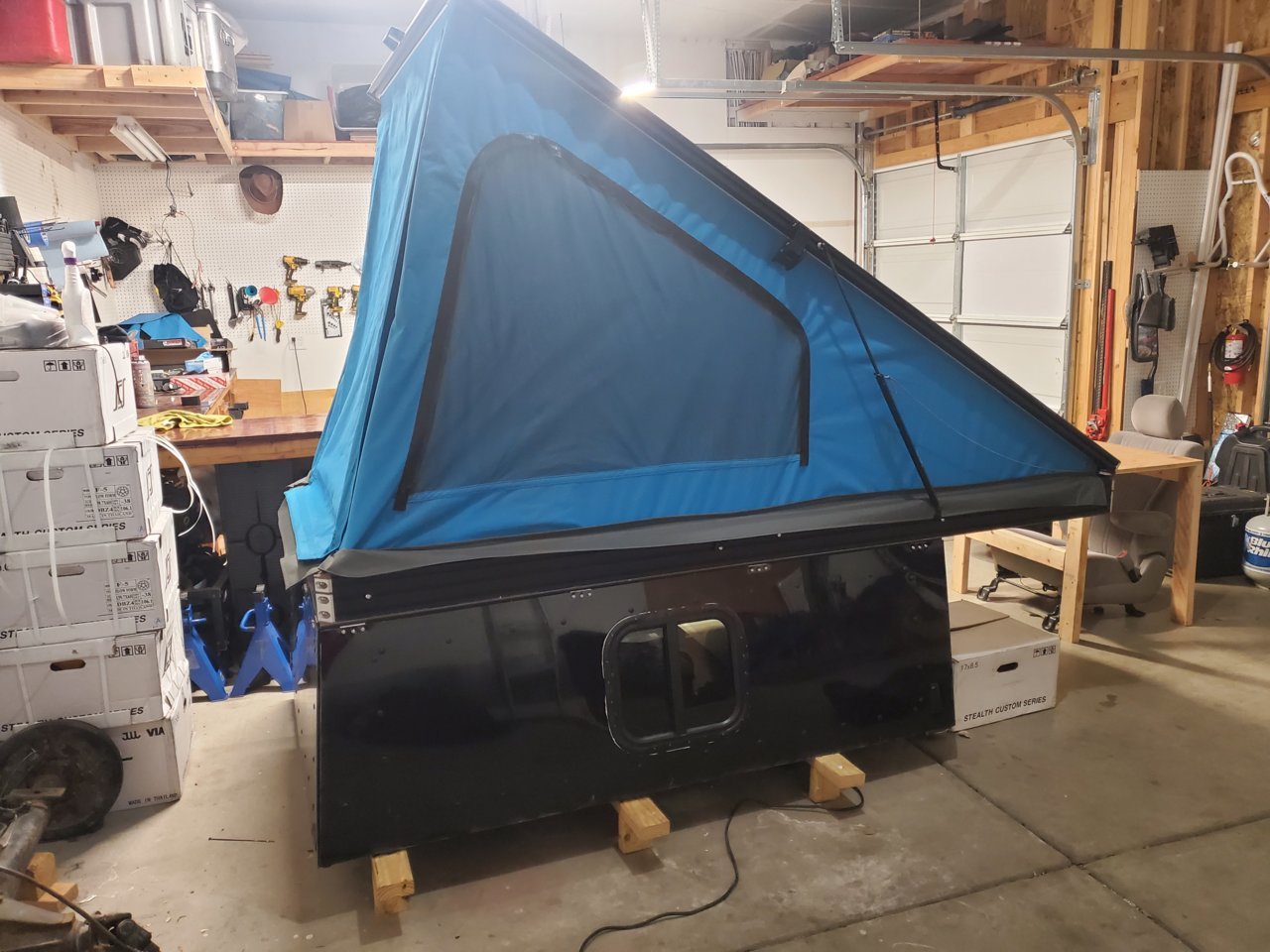

    Sewing was my favorite nightmare. Definitely went with that same stuff you used. So grateful for you meeting up with me dude! gave me the motivation seeing your rig.
    It needs a solution on the corners because the kedar rail wont go end to end on the top. It isnt the prettiest job but its whole.
    I tagged it below here.
    https://www.fabricwholesaledirect.c...6dJ4PMW7CfYJ63cpvySuUjv-ZU1TfnrRoCaFIQAvD_BwE
    I haven't decided on a final mounting method. So I've got to weld tabs to the frame and drill the bed or something. After that id be willing to open the tent on the truck.

    Ahh I see what you mean with the corners. What does the inside kedar rail look like? Maybe others have some solutions for that. My build didnt use the kedar rails but even for me those corners were tough to get closed up. occasionally I can see some light coming though but if it rains the water runs down the metal sides.

    I didn't use the inside corner braces on the top, so I mitered the keder rail to fit tight into the corners on both top and bottom. Seemingly hasn't affected it at all, although I DID have them installed temporarily while I fit the roof on. I used two beads of silicone between the roof and 8020, bolted the top panel in, and then removed the interior braces. The silicone acts as an adhesive and holds the 8020 square.

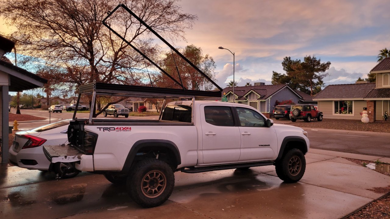

    Got a good test fit the other evening. Last set of welding is for the mounts that go to the bed rails. Then drill my holes for floor and roof, then paint!

    Do you find the upper panel to be rigid enough without the inner brace? Interesting.
    I've read some stuff about guys 3d printing kedar rail to mount over the that bracket to keep things lined up.
    I think I've got another idea about fixing it but just need a little time to sew it up. A second piece of fabric is my idea.
    @Rucas did you use clamps to mount or did you weld brackets?
    I'm thinking I'll be welding L (type) brackets. Out of 3/16ths at 6 different points on the bed at this point in time.
