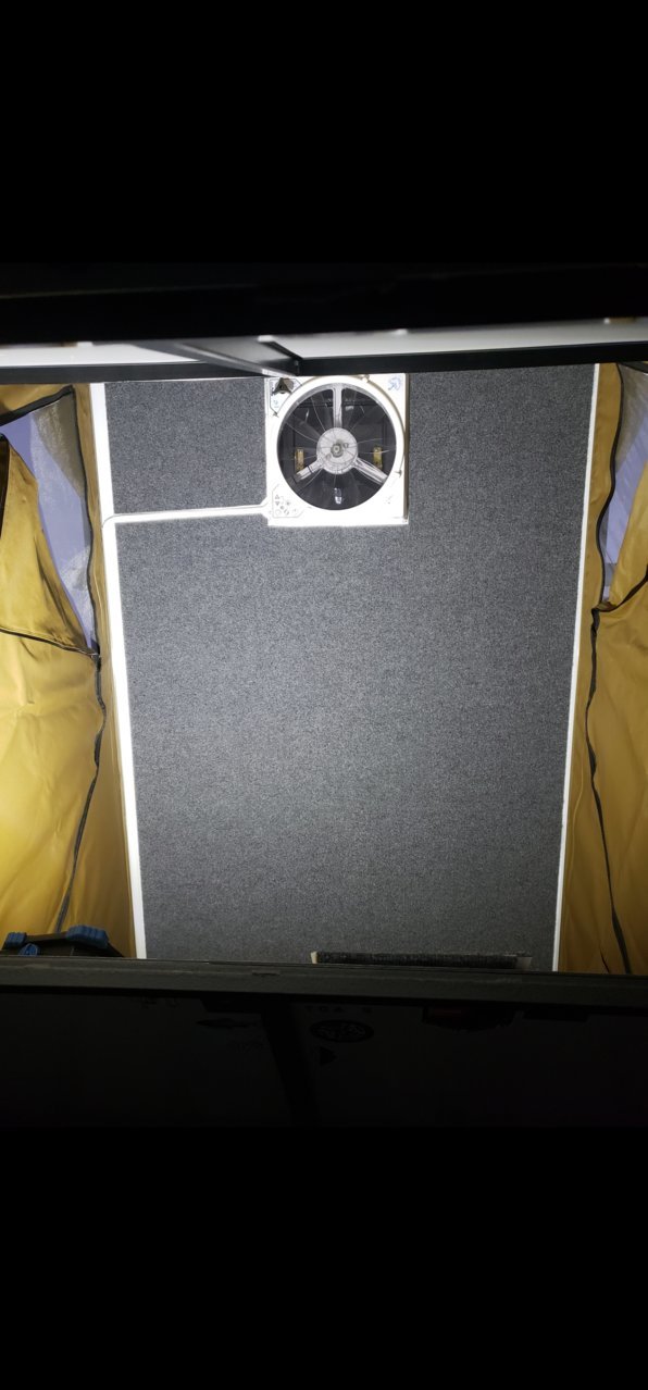

    I used to get tons of condensation on the top. I carpeted it and it works great. Screenshot_20230207_190048_Gallery.jpg

    Nice maybe I’ll do that as well once I fix my leaks

    @jowybyo the carpet stays dry. I tested it with tissue paper after a cold night camping where I would normally get dripping condensation. I don't know the exact science behind it, but typically, condensation happens when warm air hits cold flat surfaces. kinda like how windows get fogged in a car and the headliner stays dry. what ever it is, its working and I'm happy hahah. I do get condensation on the exposed keder rails. ill probably cover those up to.

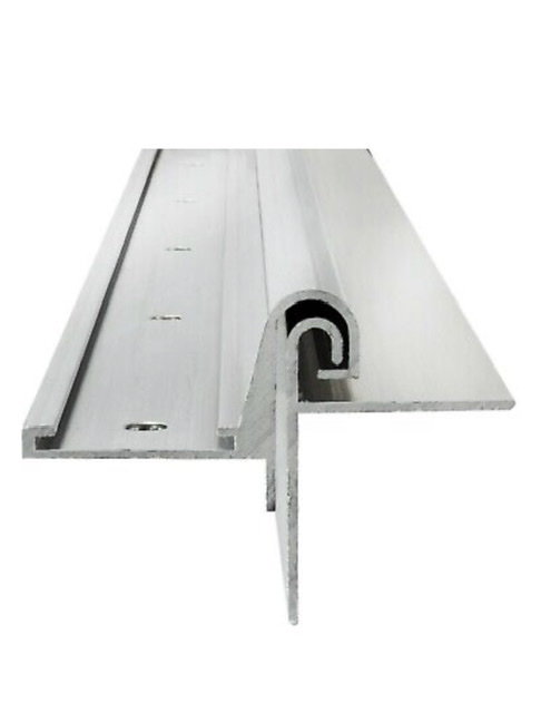

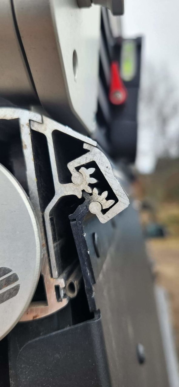

    Don't know if it has been confirmed here or not, but GFC is using continuous geared hinge for side panels.
    But if I were to redo my build I would probably still try to use the hurricane hinges that are on most commercial toppers.
  17. Feb 22, 2023 at 4:34 AM
    #3237
    jowybyo
    jowybyo Well-Known Member
    Nov 19, 2013
    #116863
    6,092
    Joe
    Baltimore, MD
    '14 MGM DCSB Postrunner 4wd Conversion, Debadged
    I have some hurricane hinges for sale of anyone is interested.
  18. Feb 22, 2023 at 7:20 AM
    #3238
    davzx
    davzx Well-Known Member
    Feb 1, 2021
    #354725
    125
    CO
    2007 Tacoma TRD Sport DCLB
    Yeah, but theirs are custom extrusions that don't use the bearings that a typical geared hinge does. I used geared hinges on mine, and while they're bomber, they're not at all waterproof - there is a bearing about every 4 inches, so lots of little gaps. I got mine sealed well, but it's all reactive, rather than integrated. Also, they're expensive as shit.
