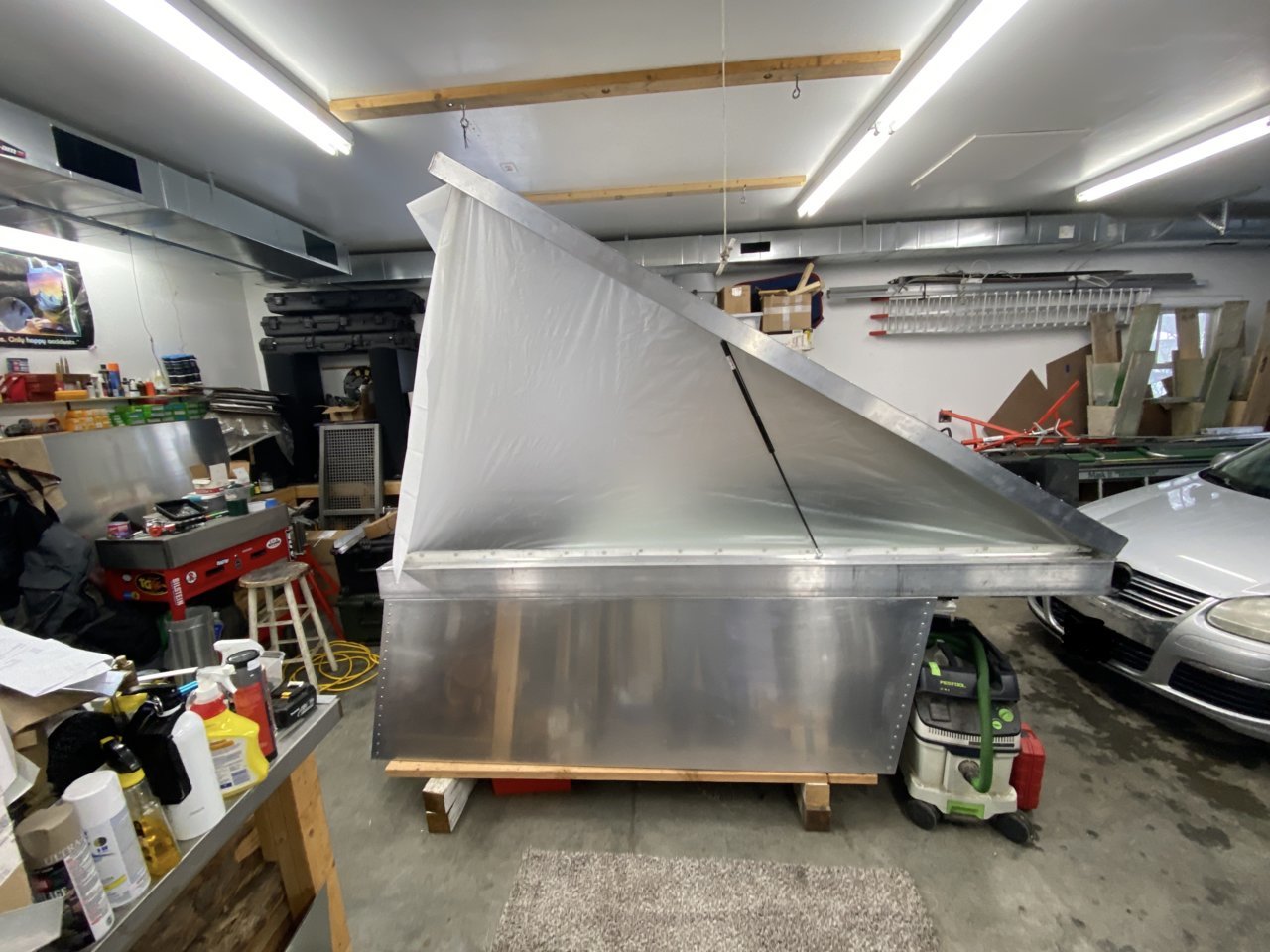

    Also, my Tundra wedge camper build, progress pic.
    Tent fabric mock-up.
    Tacoma got sold a few weeks ago.:(

    These were from earlier, waiting on my tent material at the moment.
    Roof view - .090” aluminum
    still going to cut in a roof vent, need to confirm she’ll still fit thru the door when I add 37” tires on the tundra. It’s gonna be close…
    Rear window installed, this was before I mocked up the tent fabric, I just used an old shower curtain to get a pattern.
