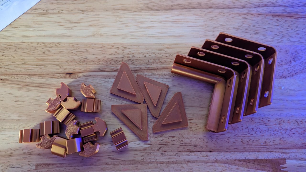

    Where did the files for those 3d printed parts come from

    Post #3253 on page 163

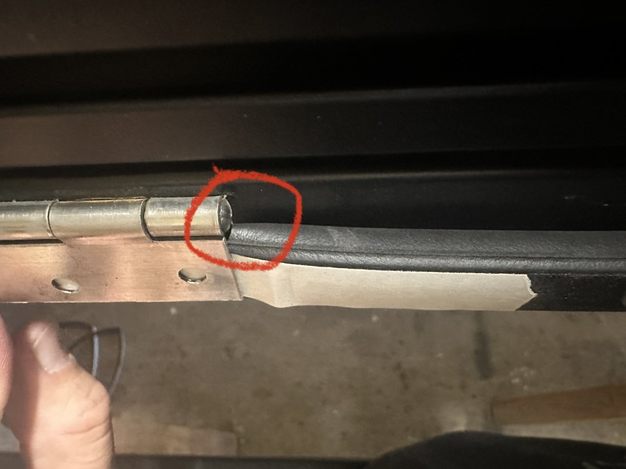

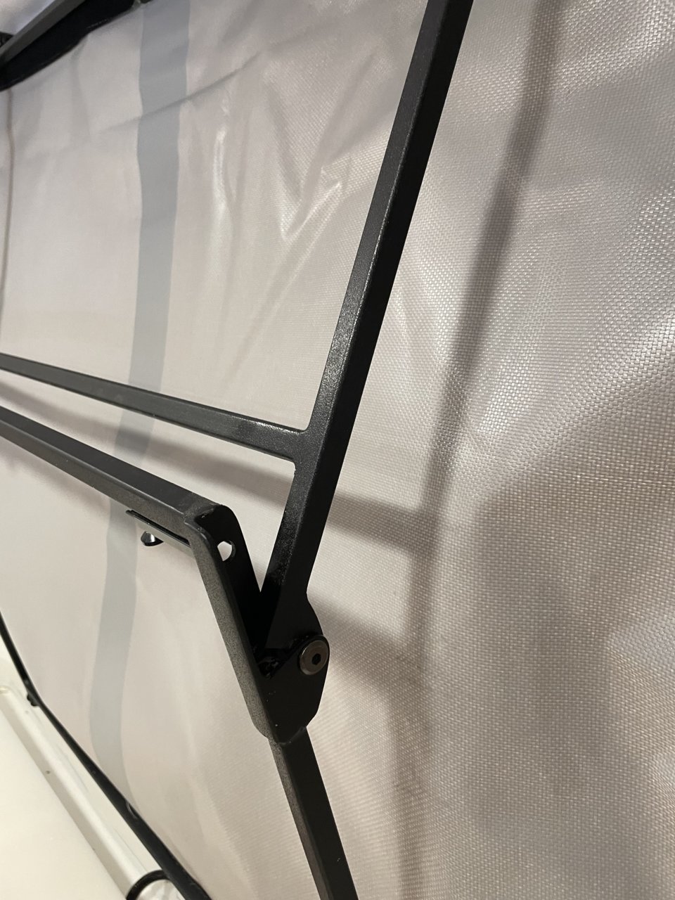

    How is everyone managing this little area circled in the picture? When closed it still leaves a small gap on either side of the hinge and I am getting water inside from that area on every hinge. Just curious if everyone is getting that or maybe I'm missing something.

    I silicone sealed behind the hinge. Those bulb seals are meant to go on static side, not the door side imo. So i have a continuous bulb running along the top side of spaceframe.

    Agreed static side on the bulb seal.
    I also have minor leakage on those hinges. I'm going to have to shoot it up good with silicone.

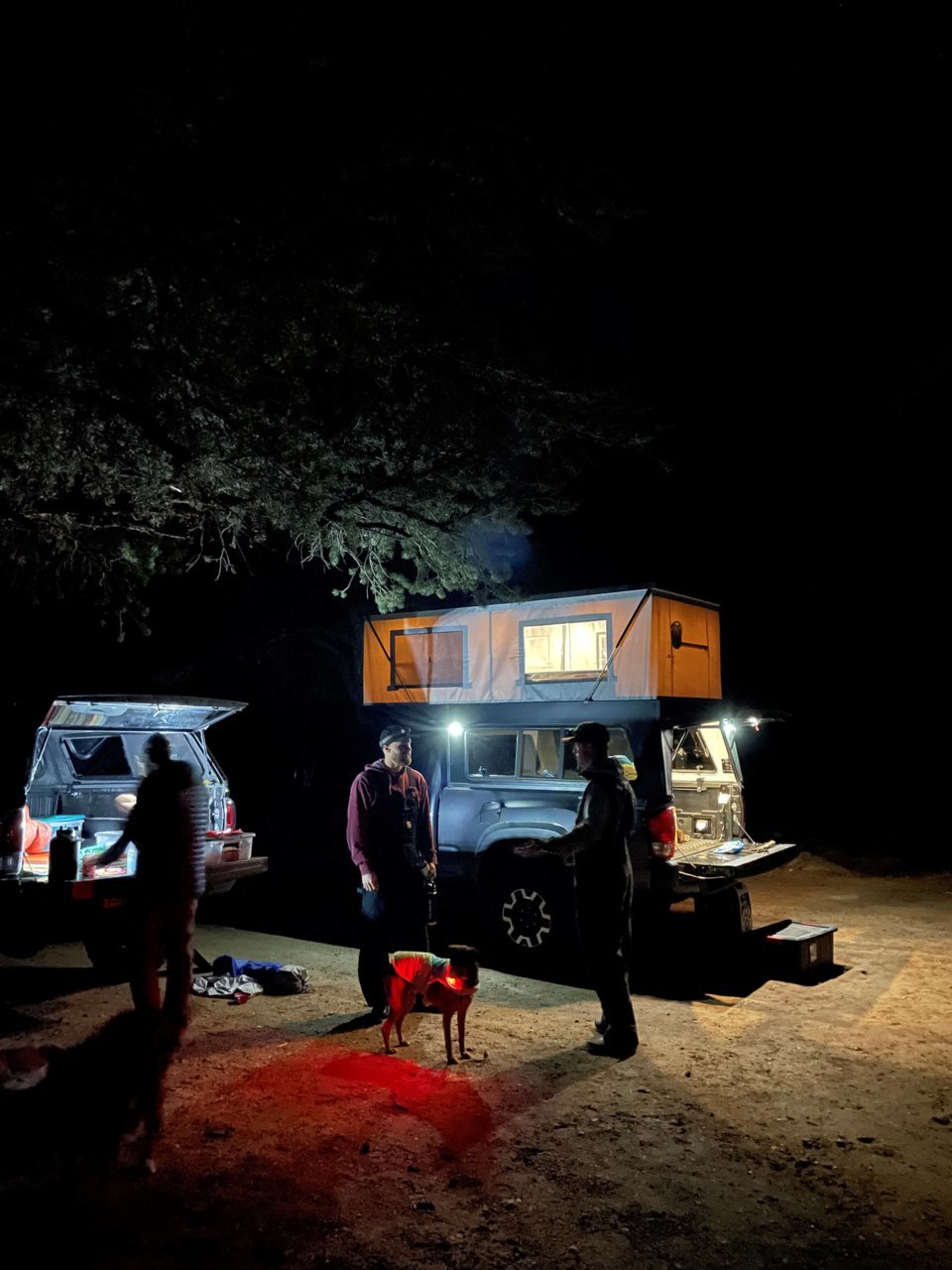

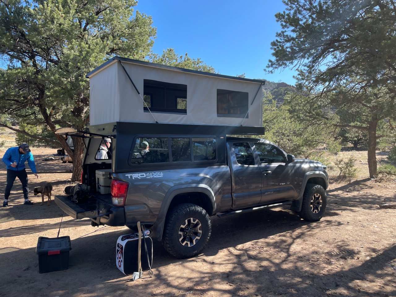

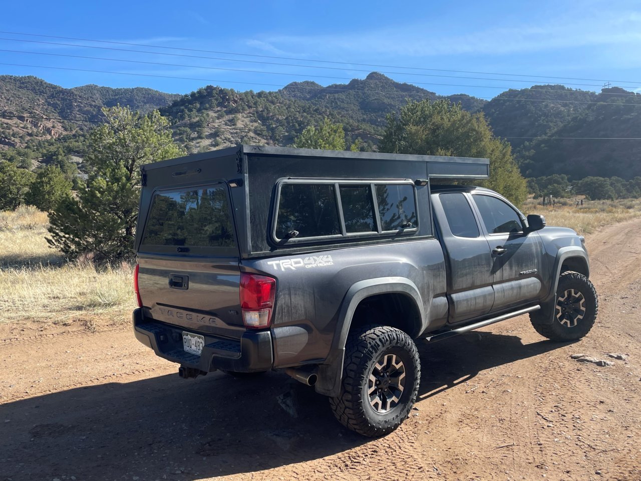

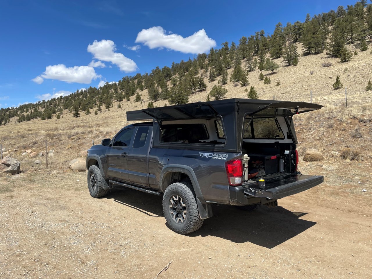

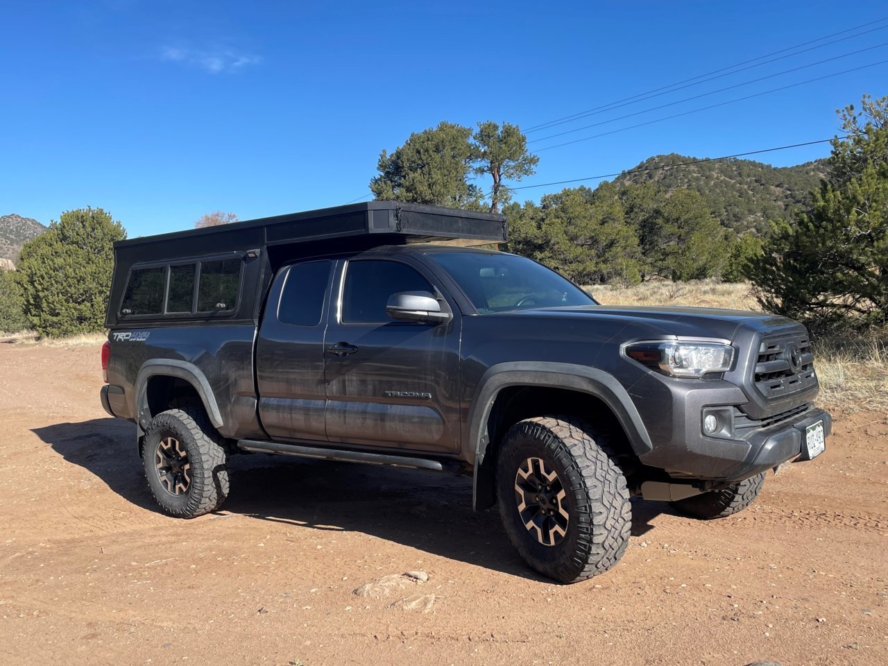

    Couple glamor shots. Finally slept in the damn thing last night for the first time.
    Twas a great success. Needs fine tuning. But good enough for use.

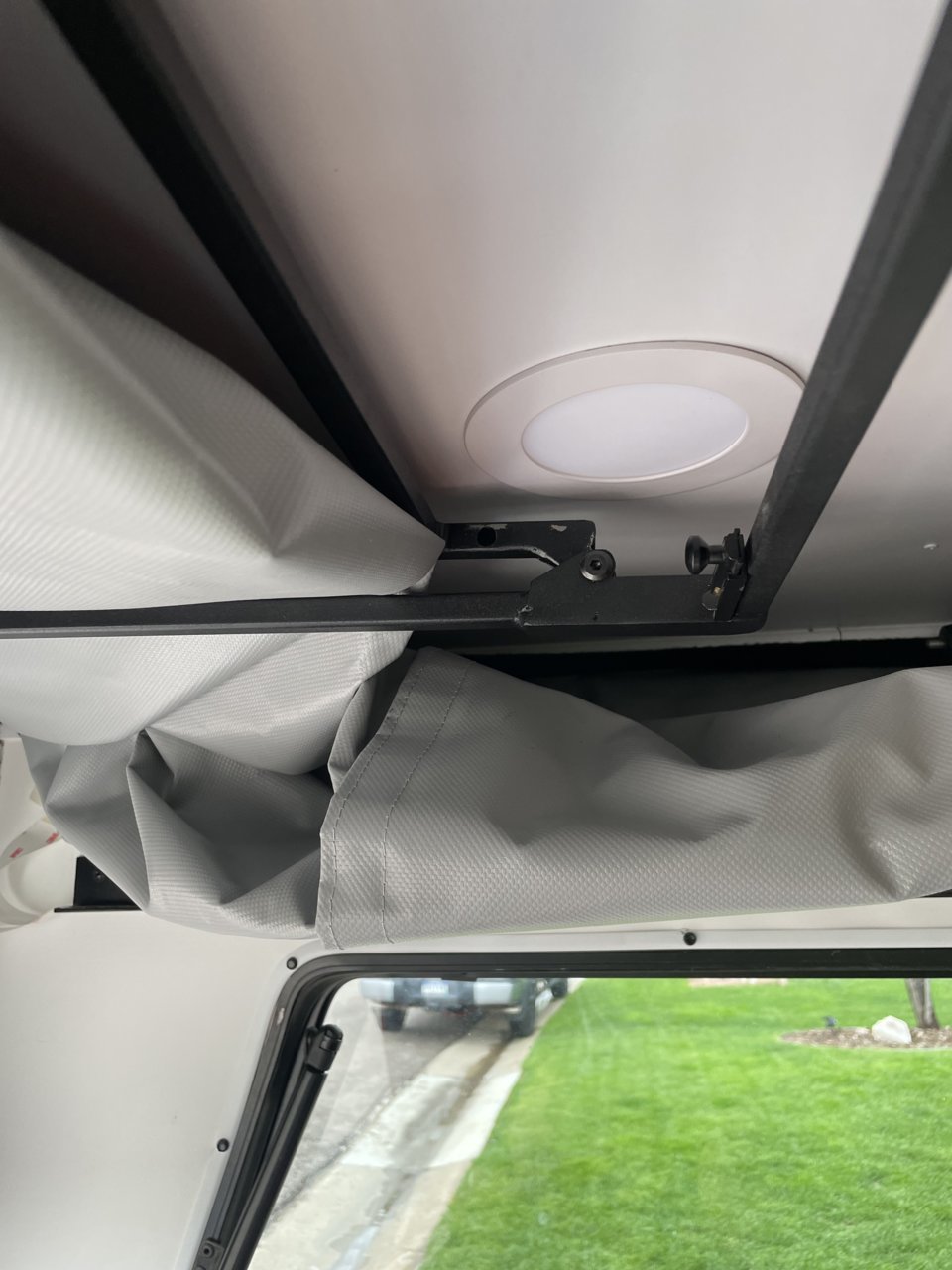

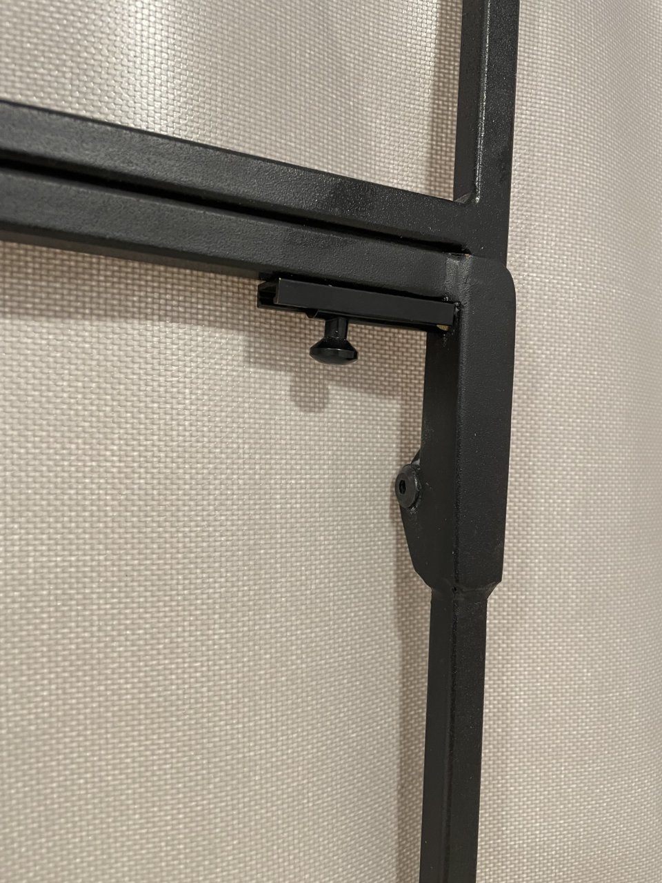

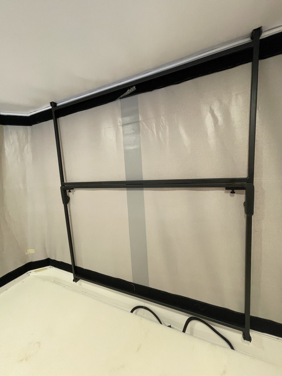

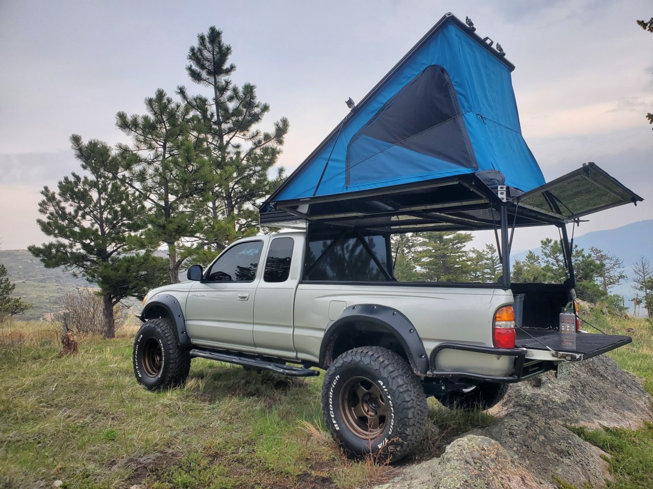

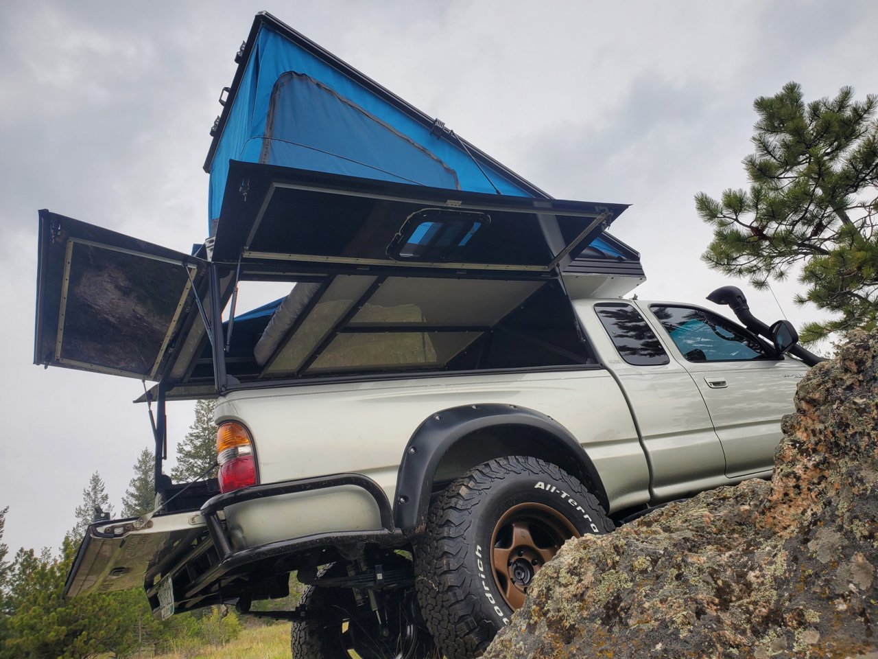

    Here are a few pictures of the pop mechanism. It’s made of 16 ga. 1/2” square tube and some 3/4” angle. It has (2) slide bolts that lock the panel when up. Challenging part was designing it so there was room for the canvas when closed as shown in the last picture.

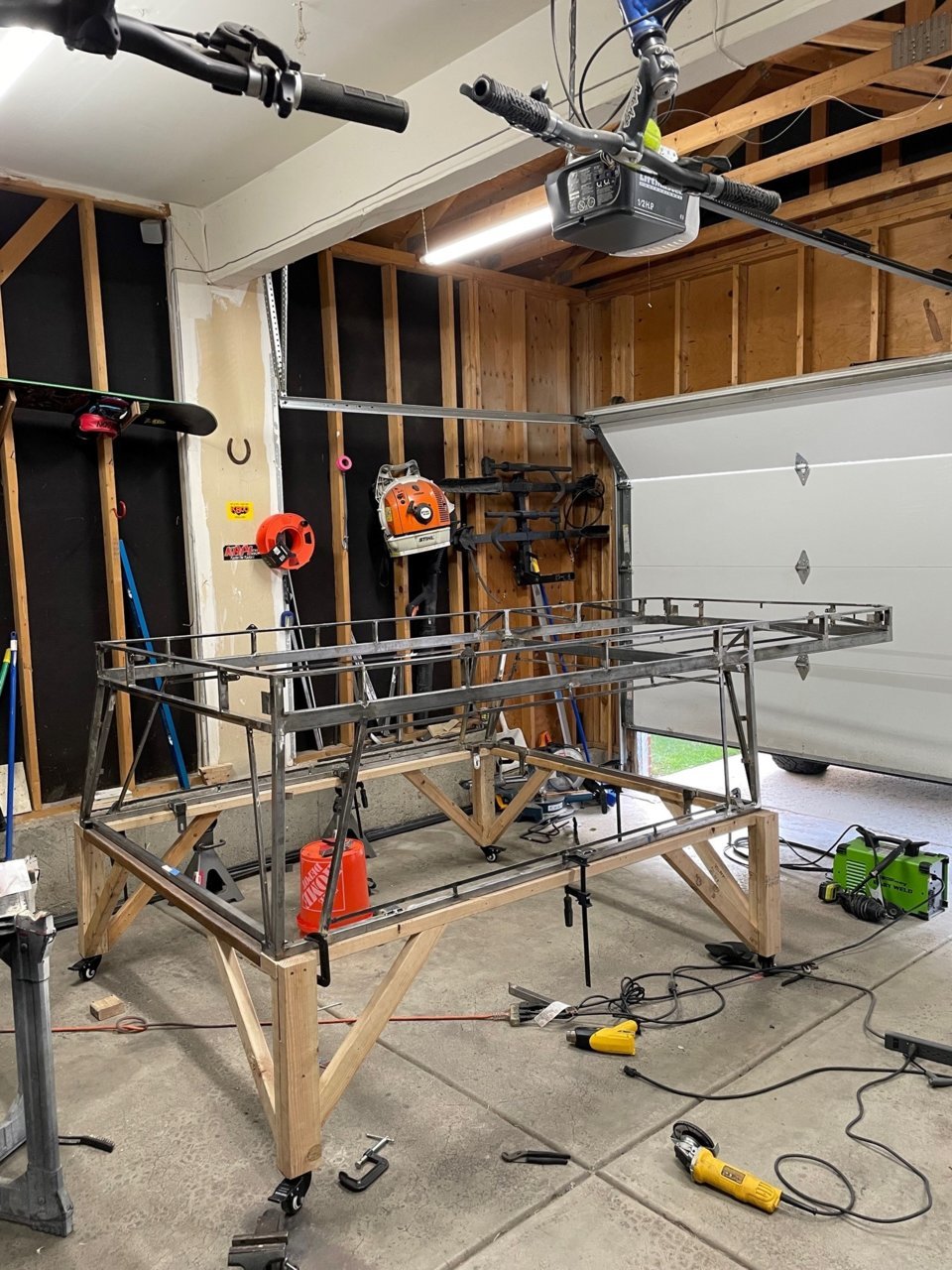

    For the most part I used 16ga. Here is a picture of the frame. The lower portion and verticals are 1" square 16ga. The portion that goes over the cab is 1"x2"x14ga. The window opening verticals are 3/4"x1/8" angle, and the window horizontals are 1/2"x1/8" flat stock (this way the windows could clamp the frame not just the ACM). I used some 1"x1/2" 16ga. for the top frame to save weight but honestly wish I would have just done 1" square there as the weight savings was minimal and it created more work for me in the long run.

    Thank you so much for the instruction and pics, good to know the wooden platform, t-slot in my area(nb canada) gets insane, 15 serious ,1.5x1.5x 10 ft, cad$300 a piece plus tax, and just saw your configuration, if applied all 1" 16g, would be around 120lbs for the frame only but including the topper, will following yours, but bit hard to find 1x1x16g in my area
