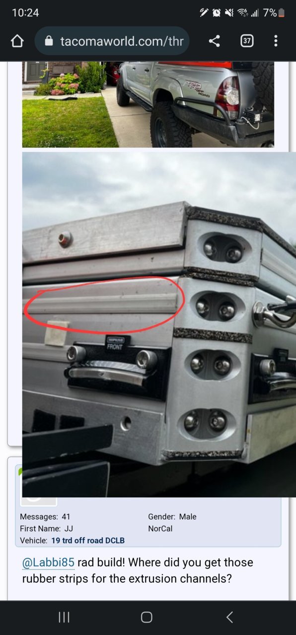

    Hey thanks.
    Would you mind pointing out which rubber strip exactly you mean? Would like to answer you, but I am not sure which one of the many you mean.

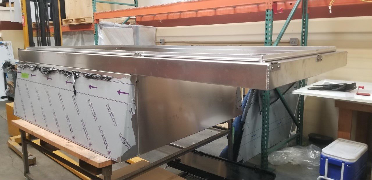

    I'm not sure if this is a good place to post this or not but figured I would try in an effort to help my buddy out.
    I'm sure a few of you are aware of the Vegabond Drifter wedge campers and their infamous waitlist. Well a very very long story short, my good friend has been waiting on his Drifter for 3 years and has had a lot of money tied up with them for the camper. Well he recently was notified that the company is going belly up and the only thing he is entitled to is the half completed camper that they were making for him. My friend does not have the means or time to finish out the camper himself since he recently had a baby girl so he is left with the only option to sell the uncompleted camper to help recoup a portion of what he paid Vagabond. I know this is a great group of DIYers so I figured there might be someone in here looking for a great start to a wedge camper. I have a bunch more pictures and more information if anyone is interested. The camper is for a 3rd Gen long bed. The aluminum shell and roof of the camper is complete and there are a bunch of misc. parts that come with it. Please message me directly if you would like more information. Ideally he is looking for someone in the San Francisco area.
