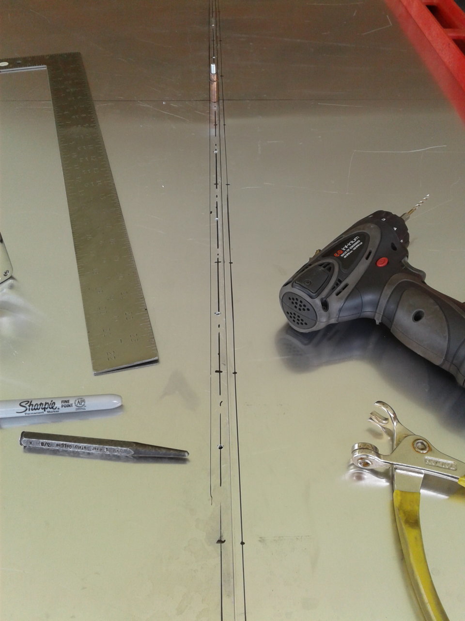

    The roof, sides are .060" and plenty stiff. The doors are eighth inch thick. Really heavy..lol. I have no idea what ga .060 is. ....16 gauge. Just looked it up..ahahahaha. Thanks for the kind words.
    Edit. No on the weld. I'm not TIG AC/DC capable. They are butted with factory cut so it's tight as crabs ass...lol

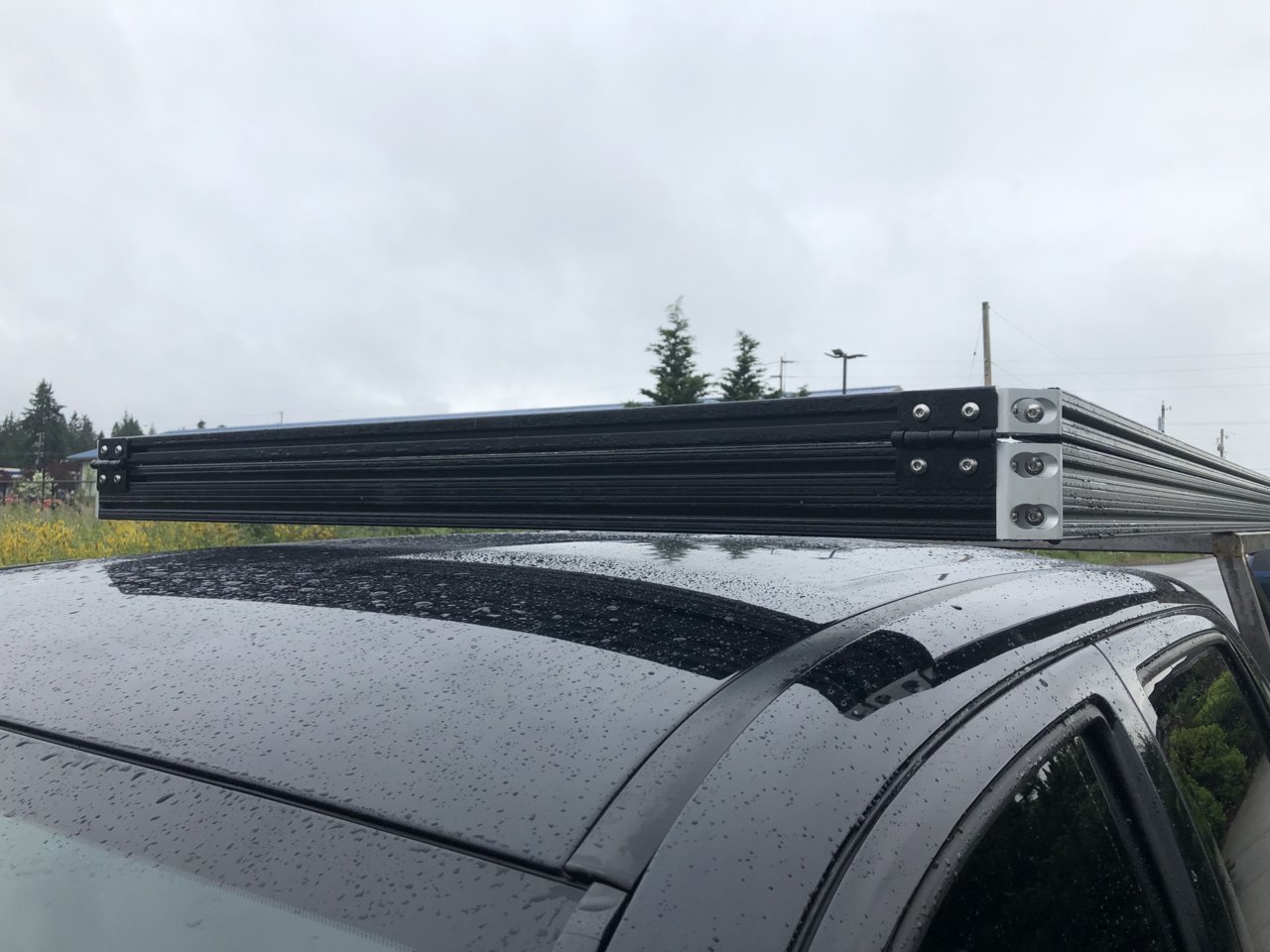

    I had to outsource to a shop for fabrication of frame. They flipped the 1” square tubing supports upside down! There’s little structural support to them, but whatever...the price got knocked down. Tapped all aluminum extrusions and test fit them to get holes on frame in the right spots to prep for paint.
    I opted for 10’ long wedge. The deflection is minimal with simulated weight of legs on it in laying down position. Long bed plus double cab paid off for once...lol
    Tacman19, SR-71A, caleebra and 3 others like this.
