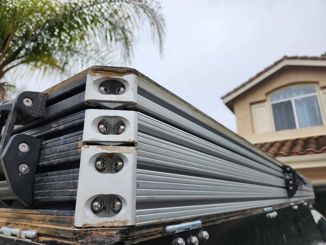

    @92se-r Its probably leaking from the seal between the top extrusion panel and bottom. People ran a rubber strip along the whole circumference. It's several pages back in this thread.

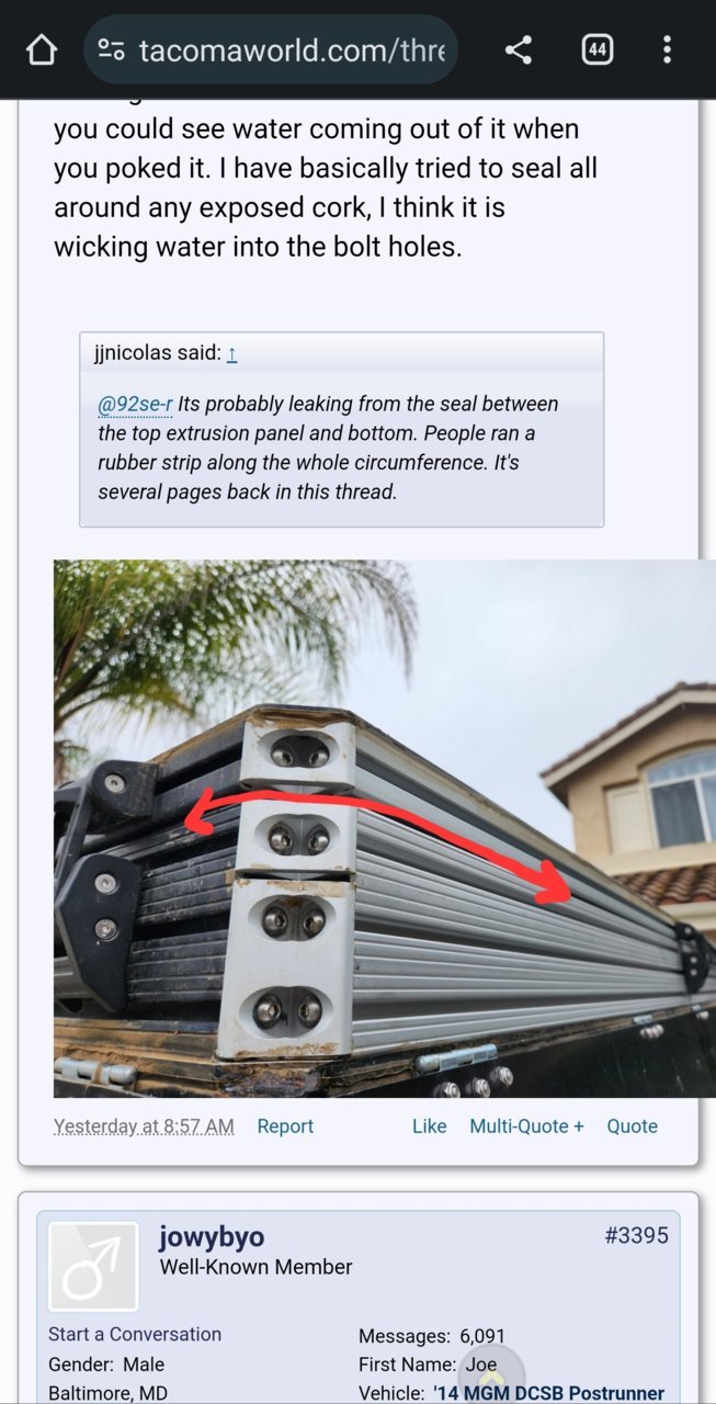

    Can you point to where exactly you are talking about?
    I think what I am finding is cork is terrible at sealing. Mine was saturated with water and you could see water coming out of it when you poked it. I have basically tried to seal all around any exposed cork, I think it is wicking water into the bolt holes.

    Along this edge. People put a rubber seal around the whole thing. I havent done mine yet, but I suspect water is getting in from there.

    I have a bulb seal all around extrusion except the corner brackets. I will be cutting a bulb seal up and gluing it to the corner bracket.

    @92se-r on page 126 is another example of the seal. Or you can add another bulb seal to double it up

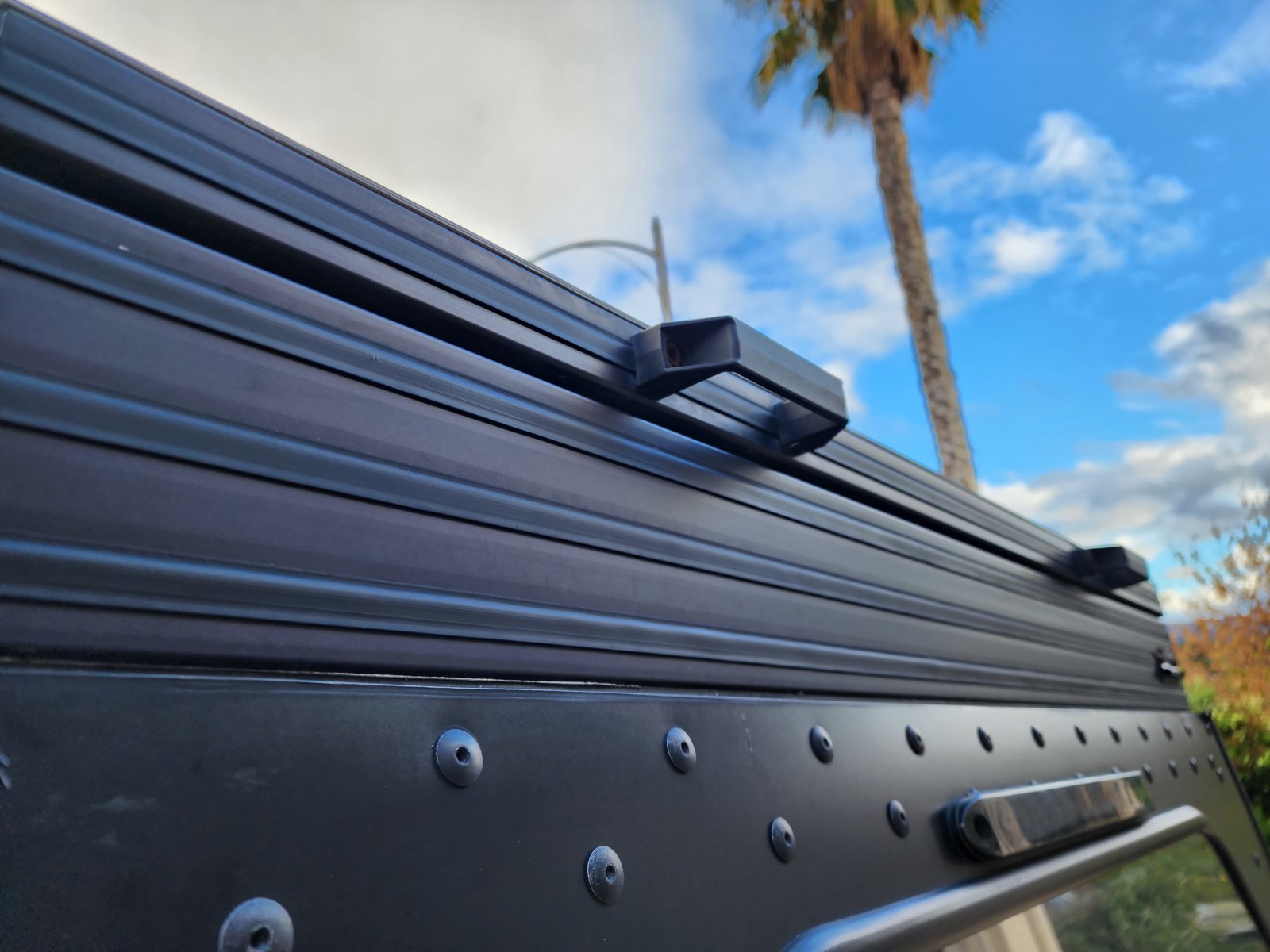

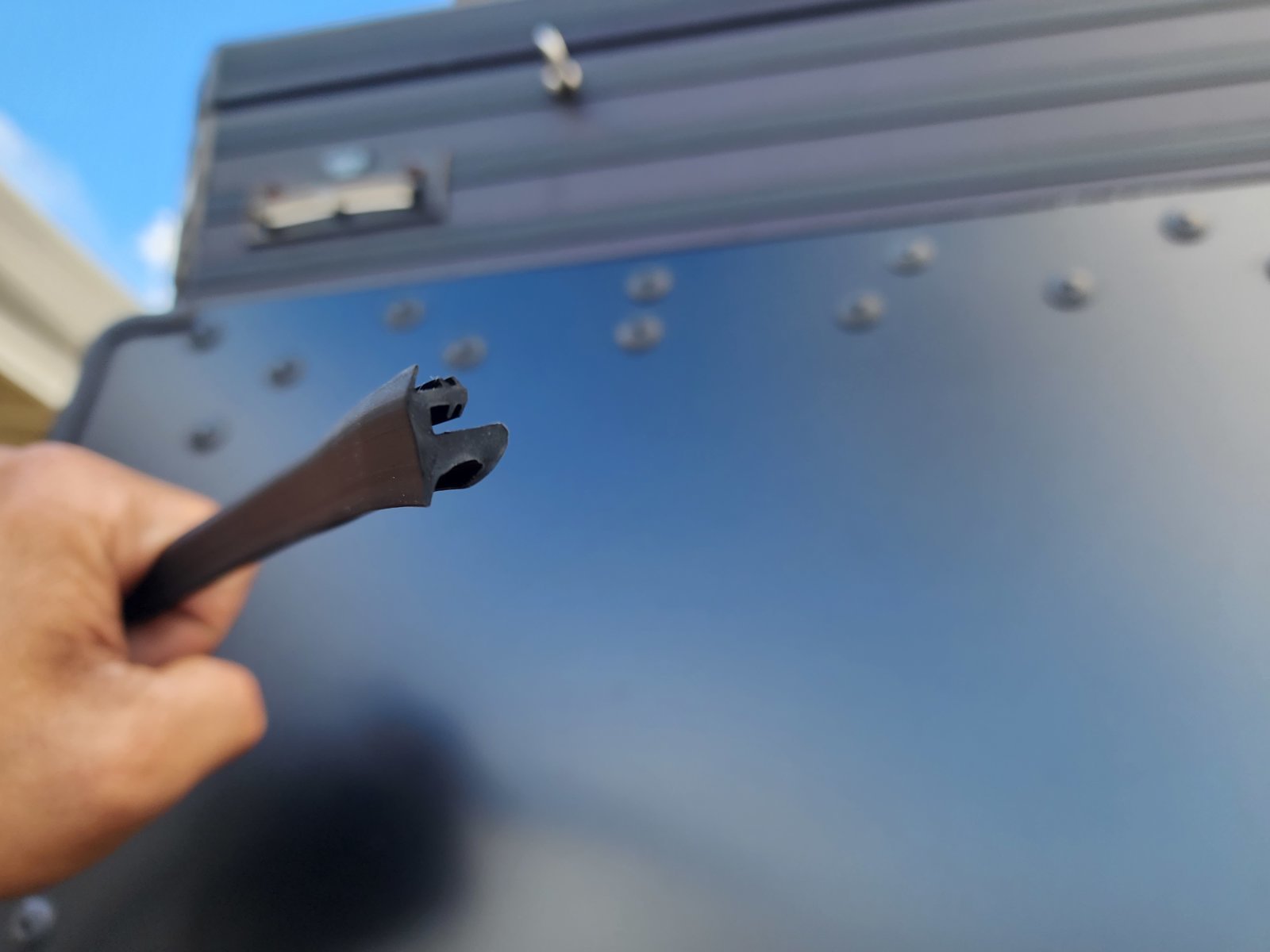

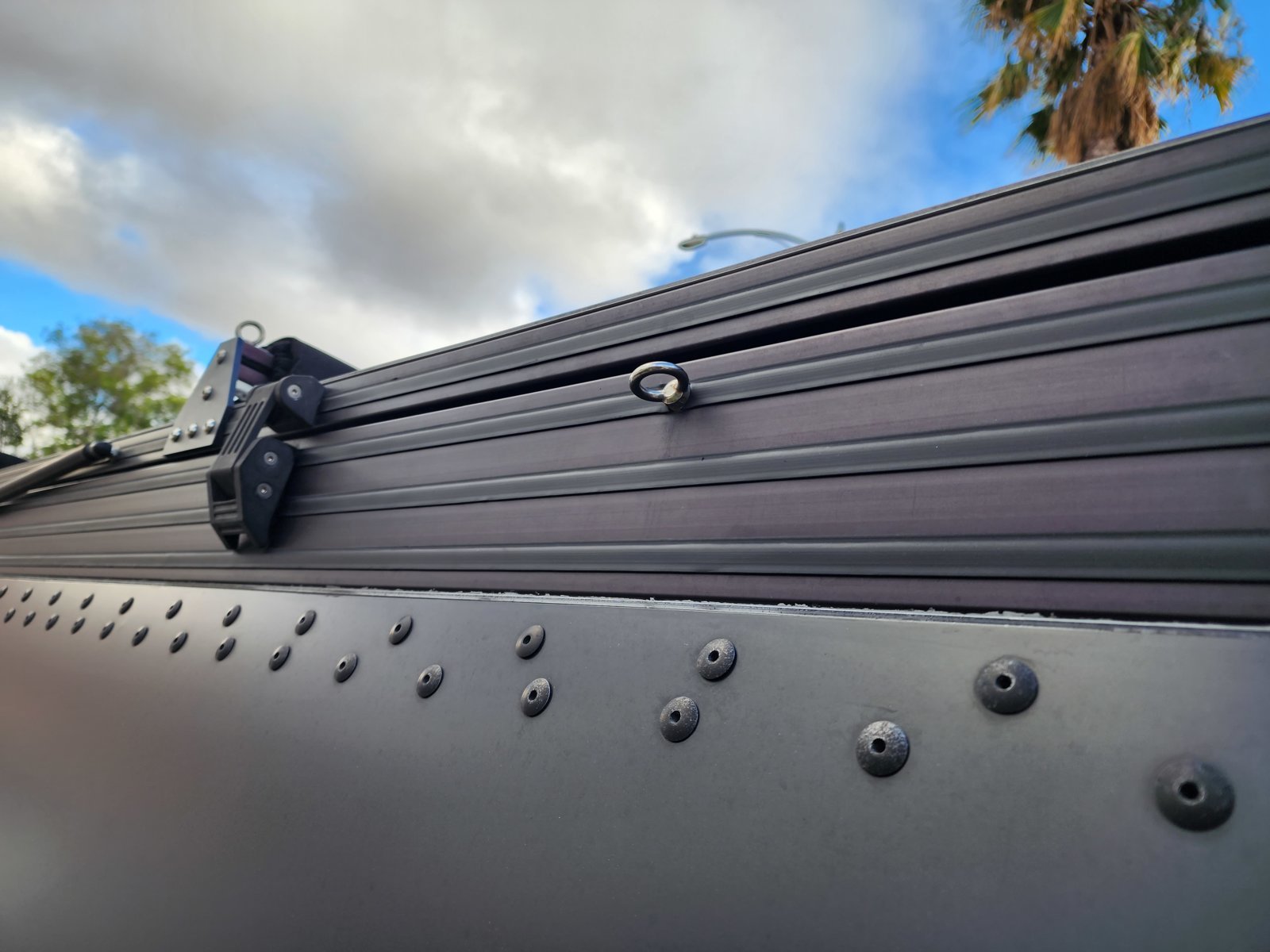

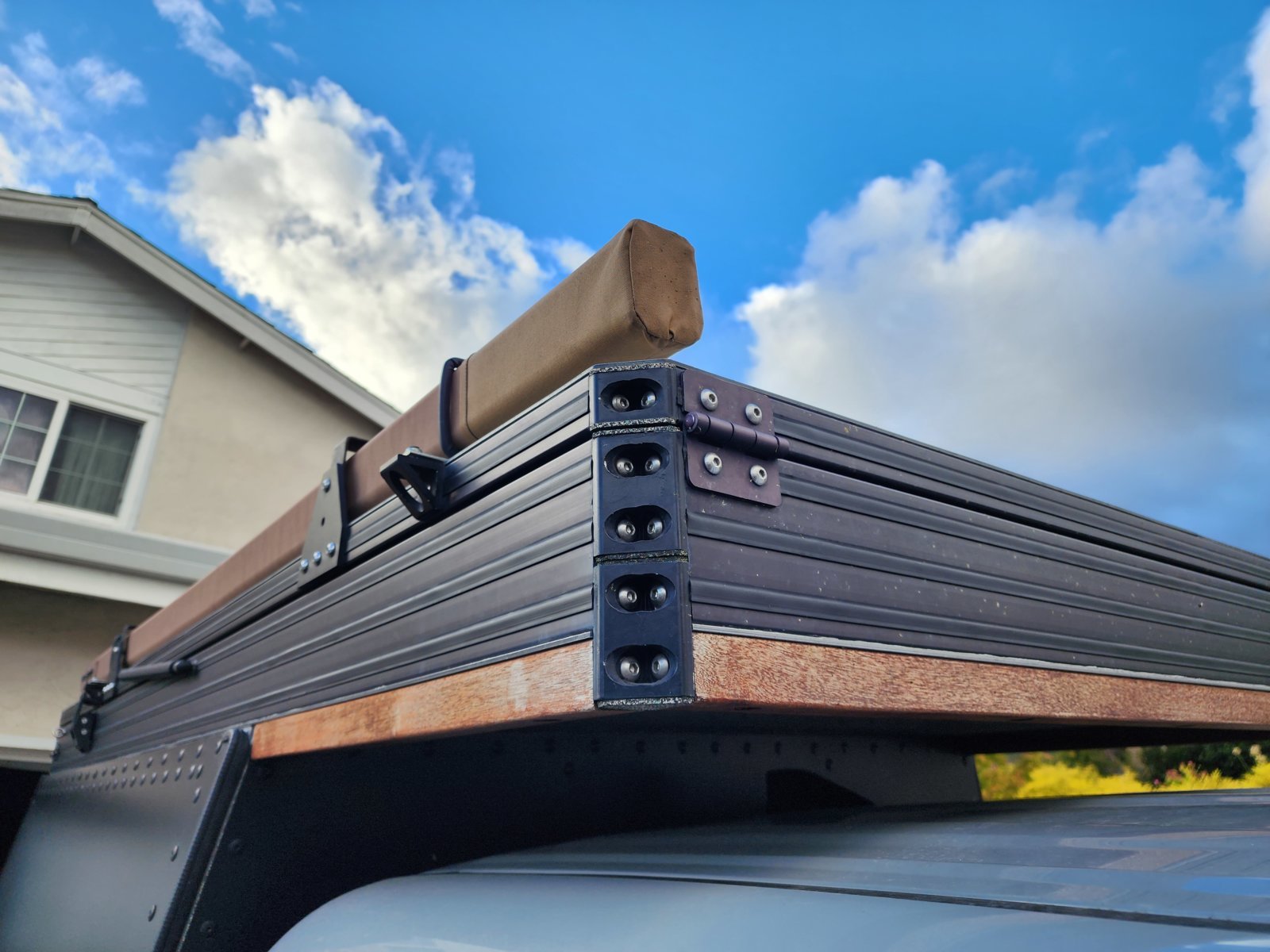

  20. Oct 22, 2023 at 5:10 PM
    #3400
    jjnicolas
    jjnicolas Well-Known Member
    Mar 21, 2019
    #287484
    86
    JJ
    NorCal
    19 trd off road DCLB
    Rainy season is upon us. I decided to cover the extrusion channels because I hated how they collect water. If anyone is interested in them, I got a roll from Amazon part number 2877, 15 Series, Rubber T-Slot Cover, 150 Foot Long Roll. Its from 8020 but sold through amazon. I just pressed them in. Hopefully they will stay in without glue.
    20231022_165209.jpg 20231022_165159.jpg 20231022_165258.jpg 20231022_165327.jpg
