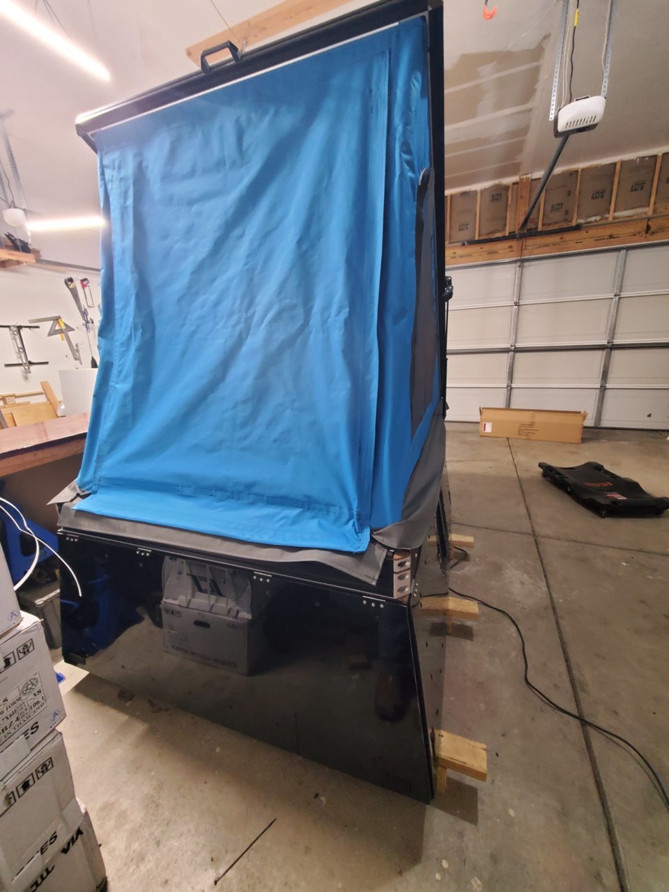

    Really like that fabric, where did you purchase yours from?

    Nice! How tall is your opening?

    Gotta be like 12ft from the ground to the handle

    8ft maybe? Close to 9? I'd have to measure not sure. Super mega head room for my 5'9" ass

    Gotcha, I only ask because the canvas is 61/60" tall. The material I used on my camper was 71" tall. But took me forever to find and not the best.

    Not sure I understand what you want to see?

    I got it now. I didn't realize you posted more pictures on the next page.
