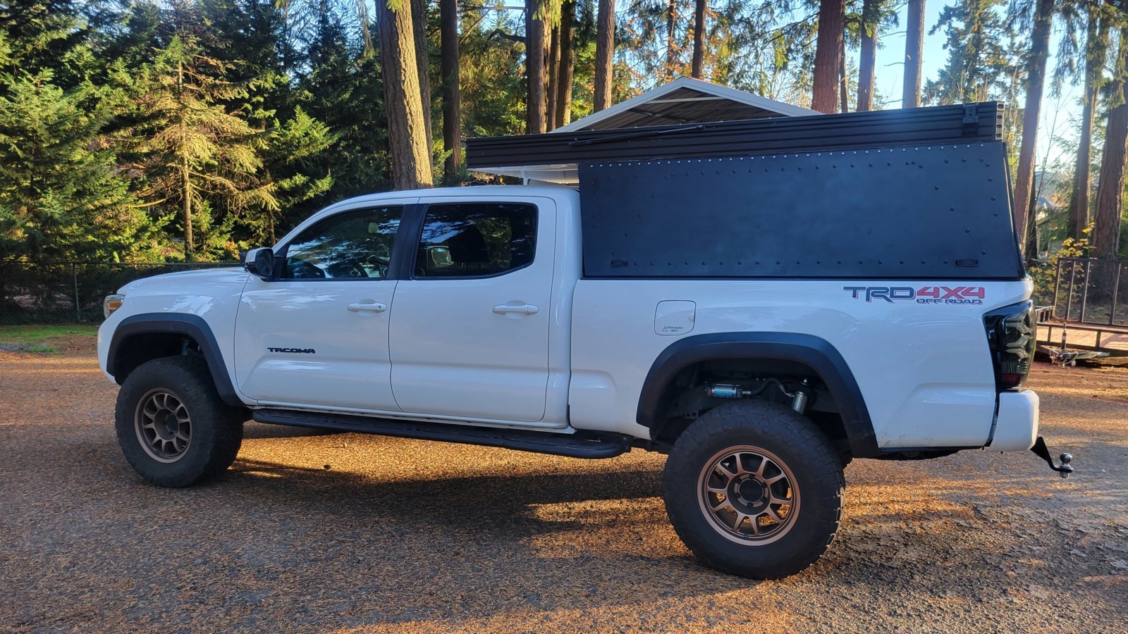

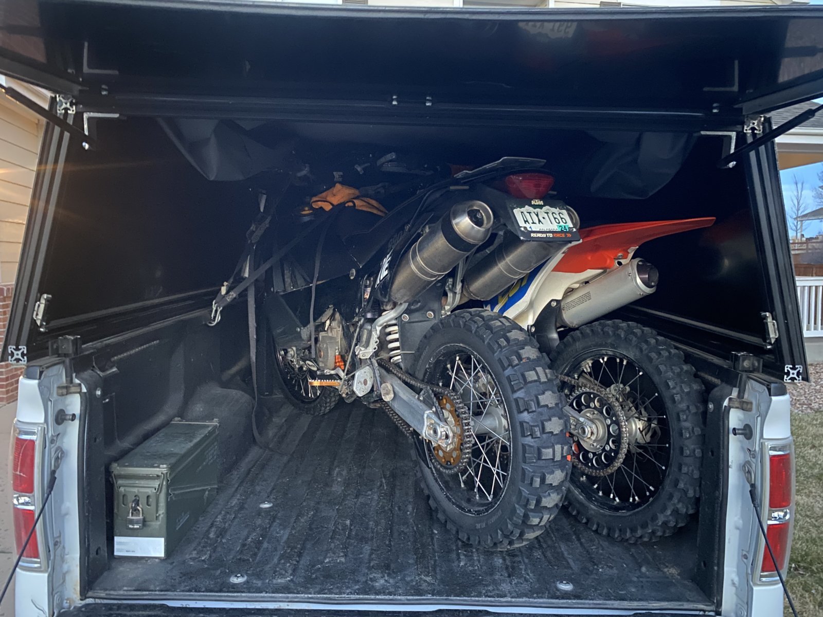

    Hello all,
    I don’t have a Taco but this forum was very helpful when I was designing and building my camper last winter. I’ve got a full season on mine now and thought I would share.
    First off, my design requirements: I love the GFC design but after many years of sleeping in the bed of F-150 (6.5’ bed) under a softopper, I had a list of must-haves for my new camper.
    • Ability to haul at least two dirt bikes inside the camper.
    • A full sized real bed, no foam cushions to move around.
    • Enough space that one person can stay in bed while the other is up cooking or hanging out.
    • Enough room in the bed area to leave all bedding in place, ie no moving bedding to the cab when it’s time to pack up like I did with my softopper.
    • Straight pop up, no wedge. I’m tall and I like head/leg room.
    • No welding required. I didn’t have access to a welder when I was building it.
    Here’s the result. I’ll admit the extra long cab overhang throws the look off a little but the trade off is massive interior space and functionality.
    For the lower frame I used all black 8020.
    The top opens in two layers using 8 latches, 2 hinges, and 4 gas struts. First, as a wedge to allow loading bikes or other cargo without having to duck under the door.
    Second as a straight pop up with glue welded canvas seams and 8 windows with screens.
    The bed space overhangs the cab 5’ and the back portion slides out giving 7’ of sleeping area and 5’ of standing area.
    When closed the 6” thick bed area allows a 4” Stoic air/foam mattress, a 20 degree two person sleeping bag, sleeping bag liner, and 12v heated blanket to stay in place.
    So far I have almost 20k miles on it, not much real off-road but plenty of washboard dirt road miles and no issues with the 8020 lower frame.

    Love the design! Can you share more how you made the hinge system for the top?

    The way the rear opens for easy bike loading is pure genius! I love it!
    How long is the overall length? I ask because I have an F250 with the 6'9" bed and was planning on using 10' 8020... but yours looks longer than 10'
    Any problem with it sagging over the cab while people are in bed? 5' seems like a long span up-supported?

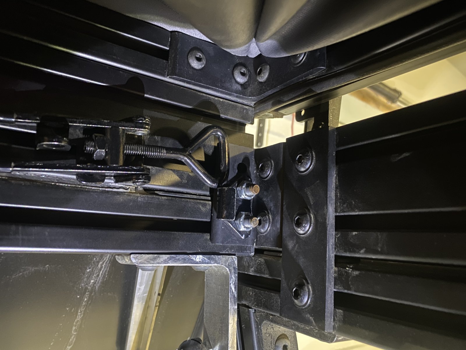

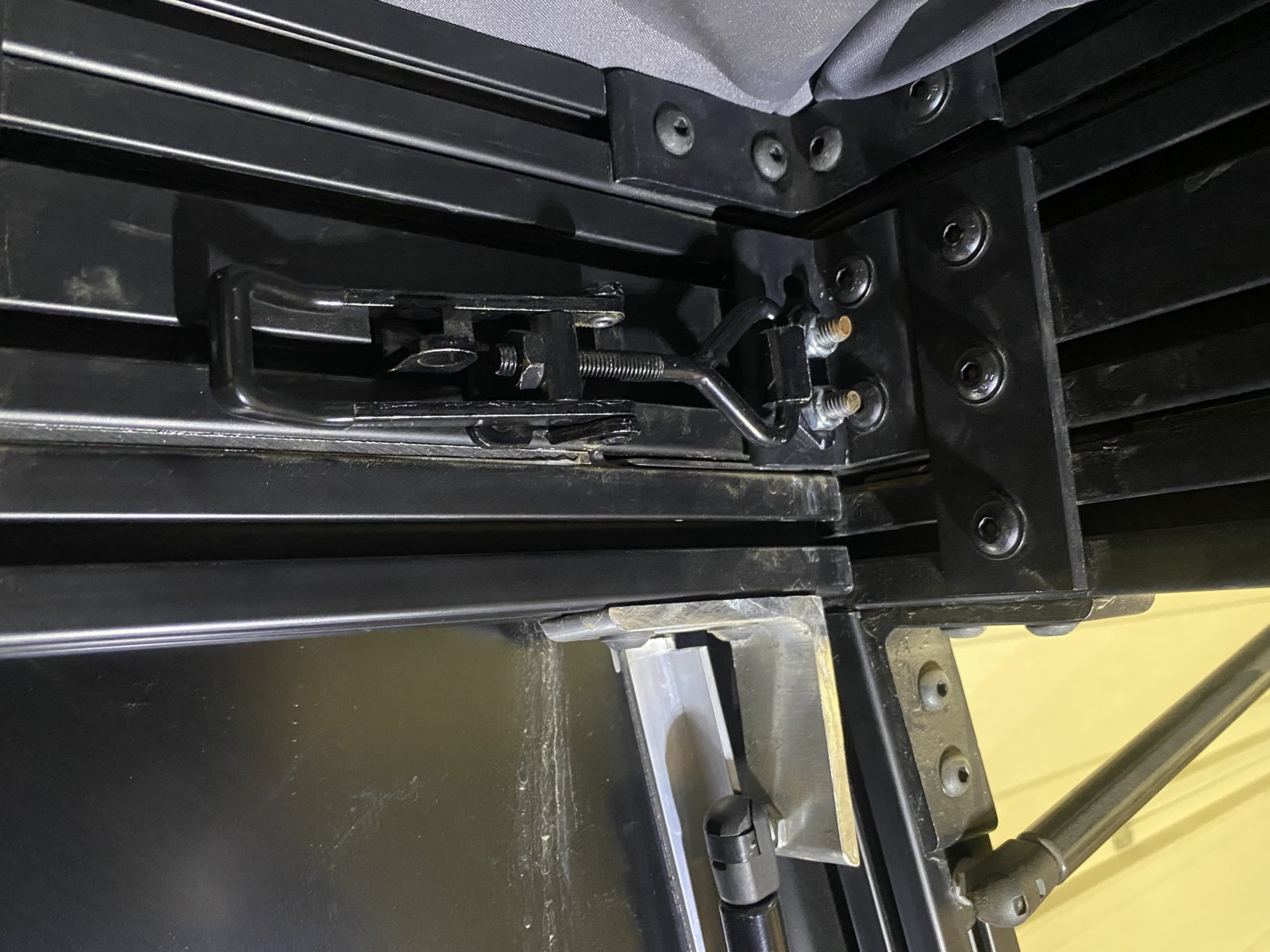

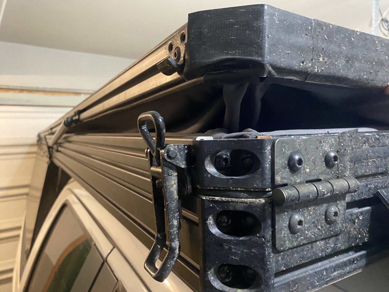

    Thanks! It’s as simple as having three layers instead of two like others. The bottom is 1530 (1.5” x 3”) and the other two are 1515 (1.5” x 1.5”)
    Here’s the front with the tent partially popped up:
    All of the back lowest layer along with an additional 1515 to match up with the bed sides, the door, and gas strut mounting points go up with middle hinged layer and latches to the sides (inside) when closed:
    Hopefully that clarifies my wacky design.

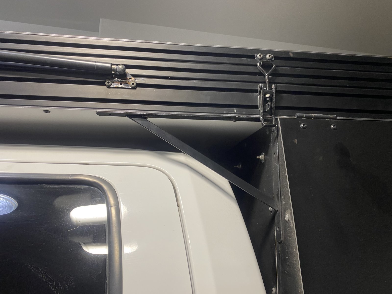

    The overall length is 12’. The only reason I went this long was to allow my big adventure bike with a rally fairing to fit in the bed of the truck with the mattress still in place. If you don’t need that I would go with 10’. I think it would look better plus the Alupanel I made the roof out of only comes in 10’ x 5’ pieces so I have a seam in my roof. It’s worked out fine but took a lot of extra effort to get it sealed.
    I initially had a little sag with that much overhang until I added these braces (they are shelf brackets from Home Depot):
    Nicklovin and EricGinTX[QUOTED] like this.

    Oh gotcha! How complex was the supports to make the top raise vertically?
