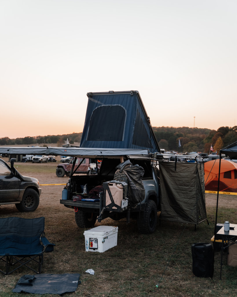

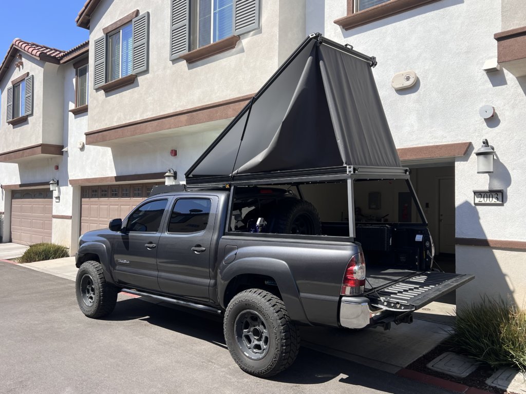

    Got the basic outline of the canvas done. Mounted up some of the keder rail already, just have to finish up the rest and then I can roughly add the canvas to pull it taught and start sewing!

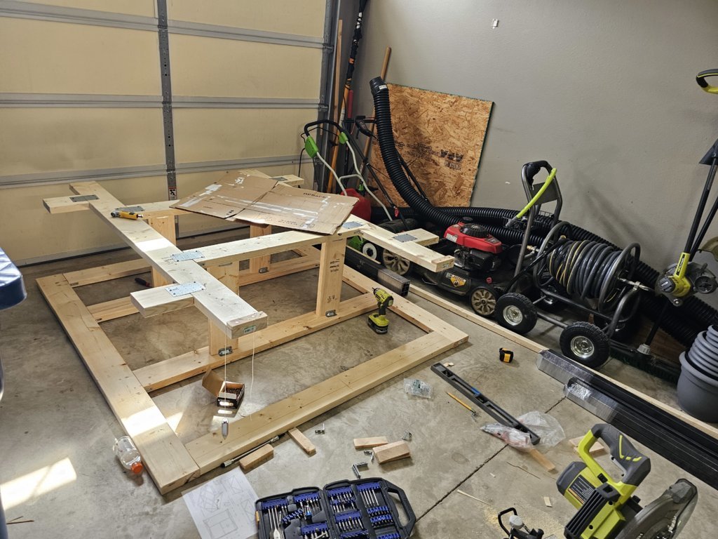

    Welding jig built! Steel is cut. Waiting on sendcutsend and need to find a mobile welder.

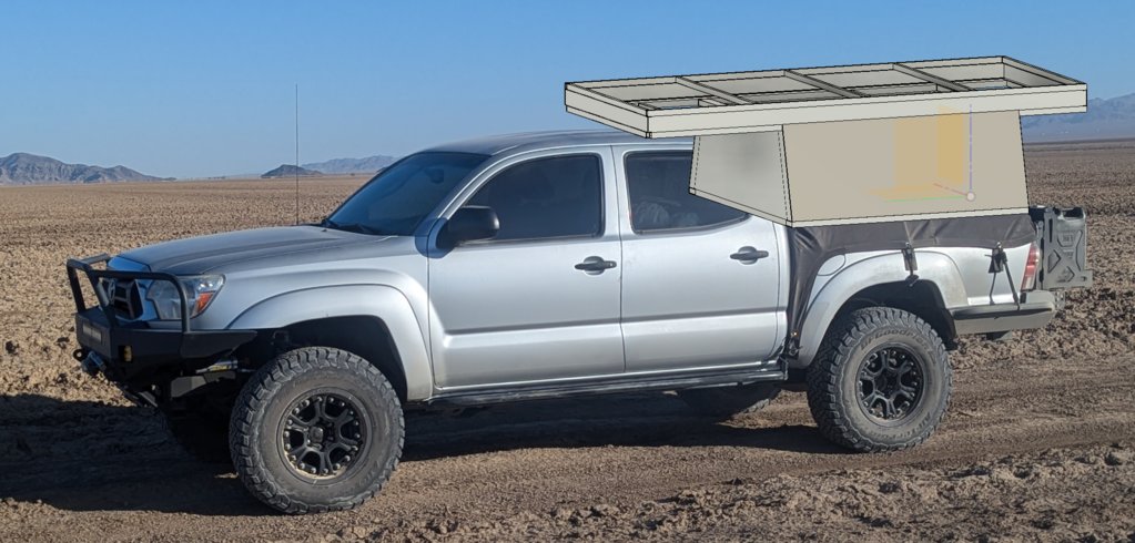

  6. Oct 5, 2024 at 11:24 AM
    #3566
    scleaf
    scleaf Well-Known Member
    Jan 6, 2014
    #120062
    1,019
    Torrance, California. USA
    2013 Silver Tacoma TRD 4x4
    SaBellCo's Tailgate Lock :), Cable mod

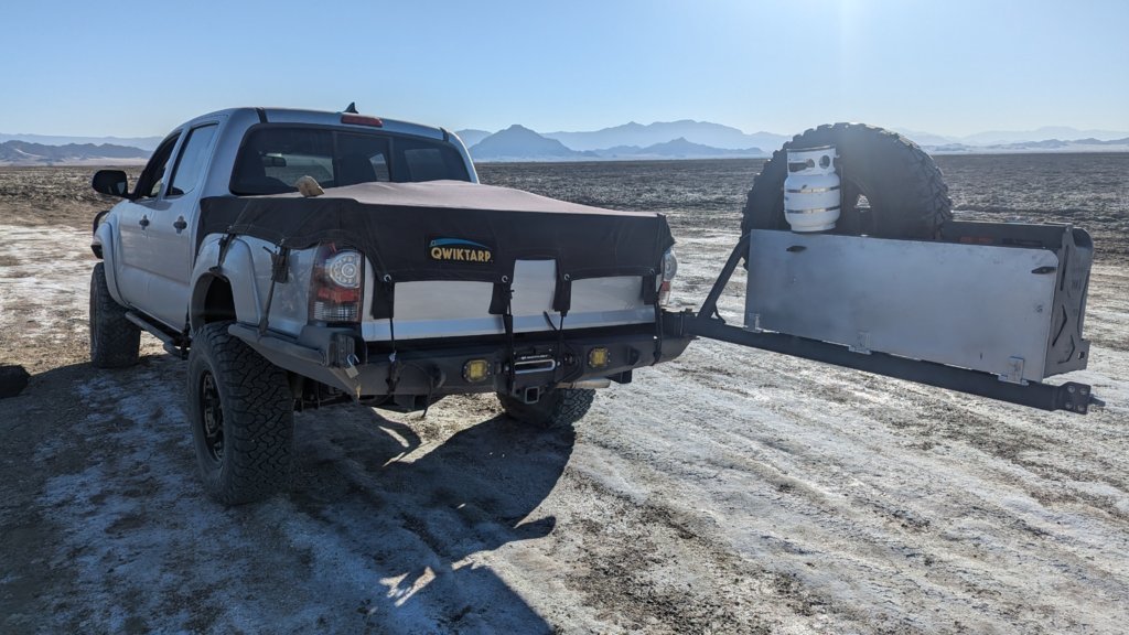

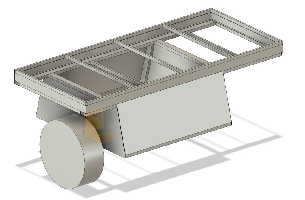

    I am looking to make this as i have a rear tire carrier on swing out wanted to see if extending this out would be beneficial, also I may make this a pop up vs wedge. Thoughts Pros and Cons. I calculate all the structure seen her to be <200 lbs from Aluminum extrusions, does anyone have a weight on the 80 series extrusions for roughly the same structure?
  7. Oct 5, 2024 at 11:28 AM
    #3567
    scleaf
    Jan 6, 2014
    #120062
    1,019
    Want to utilize this area as best i can
  8. Oct 5, 2024 at 3:10 PM
    #3568
    Raceface35
    Raceface35 Well-Known Member
    Aug 17, 2019
    #302466
    178
    Tim
    Murrieta, CA
    2011 Tacoma TRD OR
    King 2.5 Ext Travel Front & Rear, Icon Delta Joint UCA, OME Dakar "Heavy" Leaf Springs, 33x12.5R17 Ridge Grapplers, CaliRaised Sliders, RCI Bed Rack, Viair On-Board Air
    Tnutz.com has weights per foot in the description of their extrusion, depending on what size extrusion you go with. Might be able to use that as an estimate for the total weight
  9. Oct 6, 2024 at 9:38 AM
    #3569
    scleaf
    Jan 6, 2014
    #120062
    1,019
    I have the weight for each aluminum extrusion I was looking to see what the 80-20 version is, based on my spreadsheet the design I have is about 188 lbs without fittings and top/lower panels as i am not sure what I will use the sign board or something else.
    Raceface35[QUOTED] likes this.

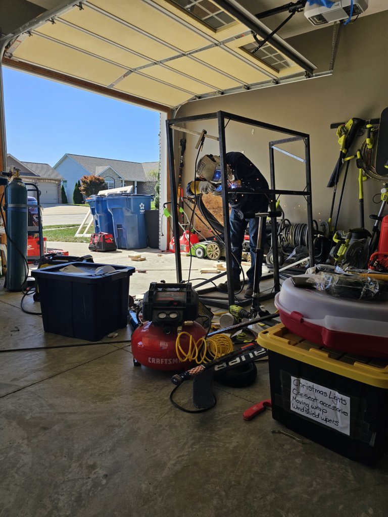

    Frame all welded up

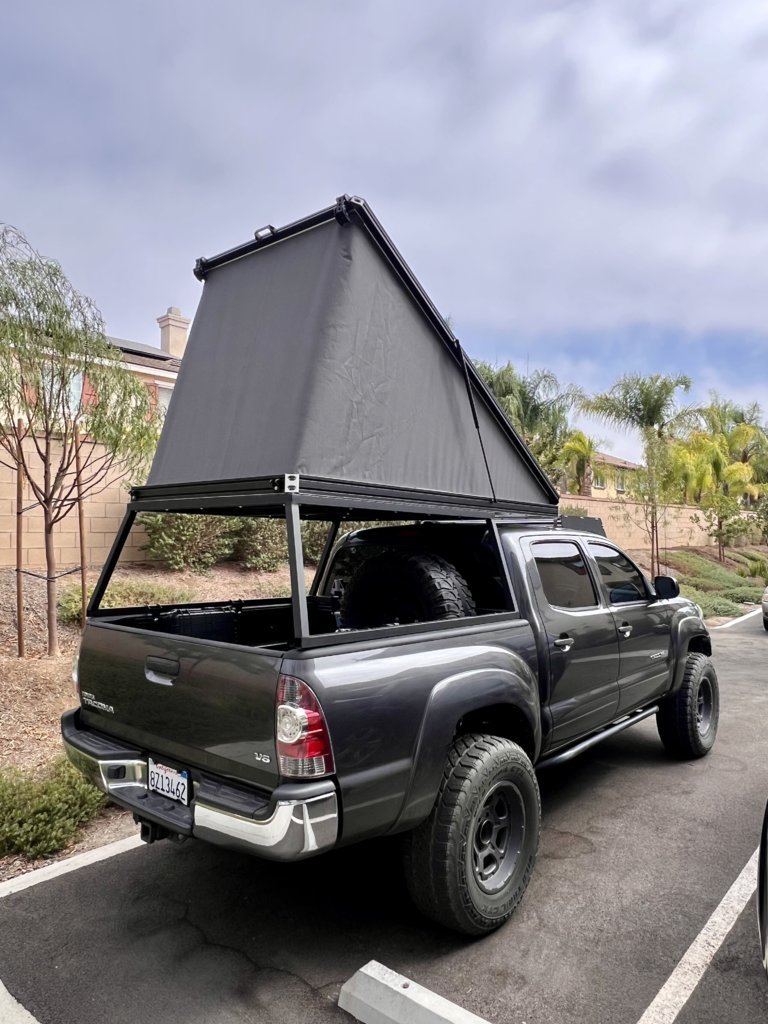

  12. Oct 14, 2024 at 6:59 AM
    #3572
    QueenCity_Offroad
    QueenCity_Offroad Member
    May 16, 2023
    #424745
    19
    2021 Cement Tacoma TRD-OR
    Backwoods Adventure Mods Front Bumper Backwoods Adventure Mods Rear Bumper w/ DIY Swingout Backwoods Adventure Mods Aluminum Skid Plates Kenda Klever RT 35x10.5r17 RRW RR6-H w/ protection rings Dobinson 3" w/ UCA's

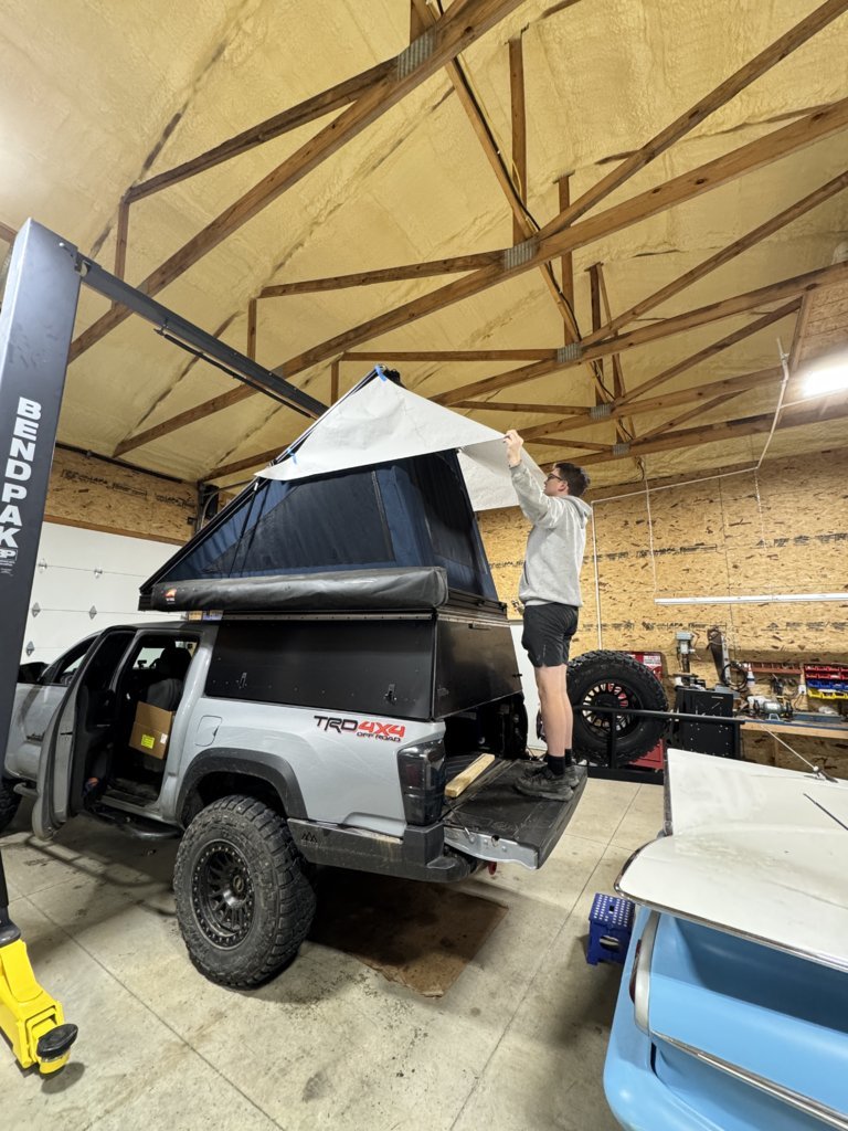

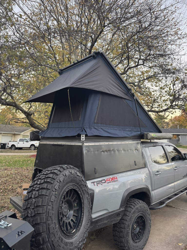

    First trip in the camper with the tent on was a success! All I could’ve asked for, been a long process but it’s nice to see the fruits of my labor. Pulling the canvas back off soon to finish some of the extras but love it! My only real issue has been the corners where the tent fabric meets. How’d you connect the 2 at the end of the keder?
  13. Oct 16, 2024 at 12:40 PM
    #3573
    Raceface35
    Aug 17, 2019
    #302466
    178
    Tim
    Murrieta, CA
    2011 Tacoma TRD OR

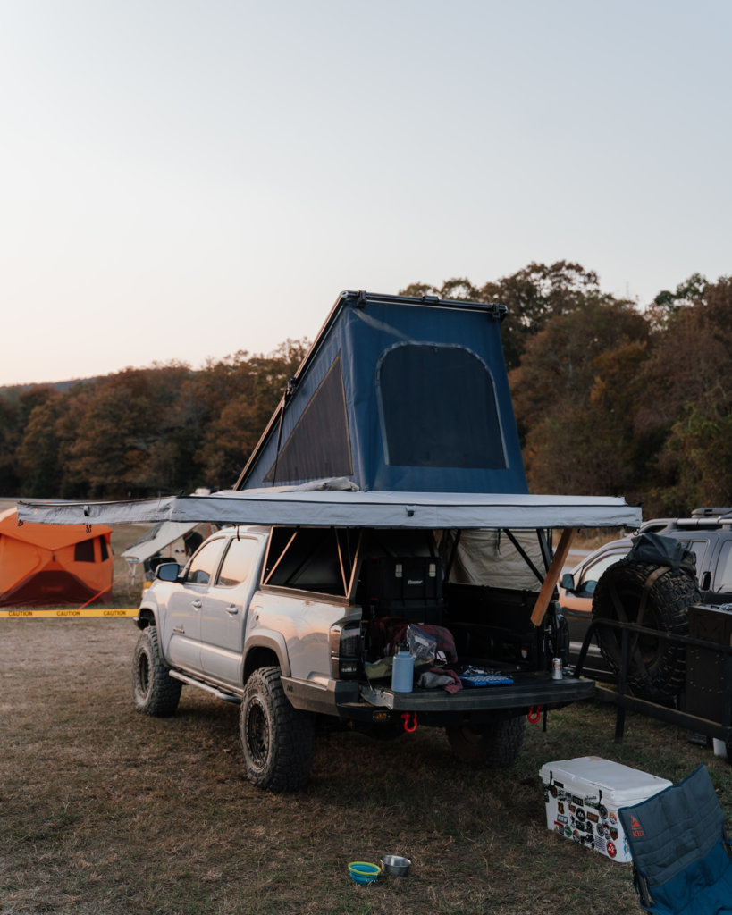

    She’s alive!!

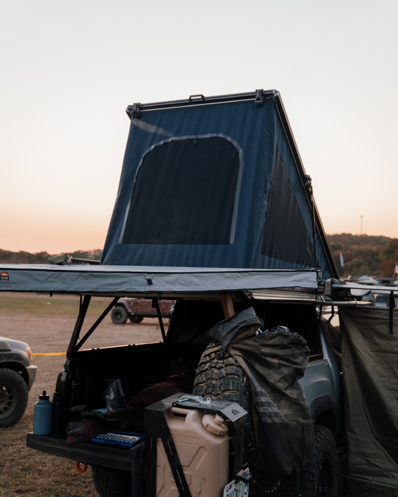

  15. Nov 11, 2024 at 8:00 PM
    #3575
    QueenCity_Offroad
    May 16, 2023
    #424745
    19

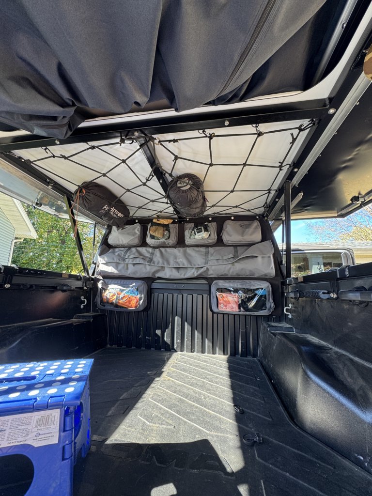

    Getting this organization thing figured out
    Duluth seat back organizer, riv nuts in the frame, grommets, and a bolt through.
    Elastic net held in with riveted d rings and carabiners. Will probably go to a tighter net in the future, but we’ll see how this rolls
  16. Nov 14, 2024 at 5:28 PM
    #3576
    QueenCity_Offroad
    May 16, 2023
    #424745
    19

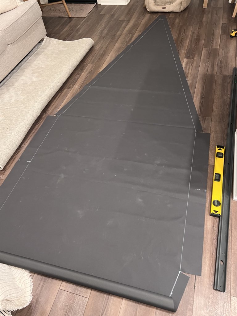

    Tons of camper projects going on lately . Took the canvas back down to add an awning and rain skirt. Should be the LAST time the canvas is off. Gonna play with longer awning rods to pull the sides more taught. Instead of matching the heavy tent material I went with a nylon ripstop.

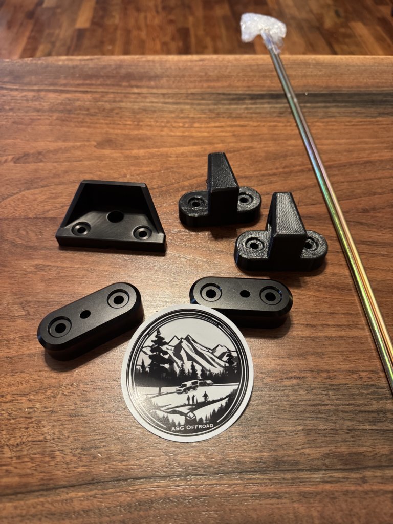

    To save some headache, I found a company @AsgOffroad that makes awning rod holders, rear camera brackets, and utility hooks that fit perfect with the 15 series extrusion. They are meant to fit GFC’s/Super Pacific’s, but adapted easy with different slot nuts.
    Paper templates made it much easier to size the awning and get the angles right.
    Raceface35, guaco.supreme and 92se-r like this.
  17. Nov 14, 2024 at 5:56 PM
    #3577
    92se-r
    92se-r Well-Known Member
    Jan 5, 2017
    #206708
    264
    I love this, whered you get the rods
  18. Nov 14, 2024 at 6:10 PM
    #3578
    ZColorado
    ZColorado Well-Known Member
    Nov 6, 2020
    #345998
    1,201
    Near Boulder Colorado
    13 DCSB OR 6MT
    35's,Kings, NWF, 488, Harrop, SPC, Archive, Method, RCI, C4
    I got mine from 4WP. ARB awning rods. Super cheap.
    92se-r[QUOTED] likes this.
  19. Nov 14, 2024 at 7:15 PM
    #3579
    QueenCity_Offroad
    May 16, 2023
    #424745
    19
    Mine came with the kit from from ASGOffroad, but they measure identical to the ARB ones. 31.5”, and 5(ish)mm diameter. They are super cheap, but expect to pay a quadruple the price in shipping lol.
