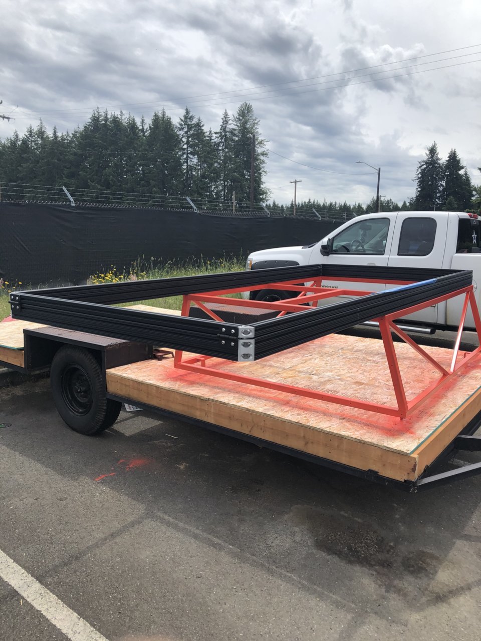

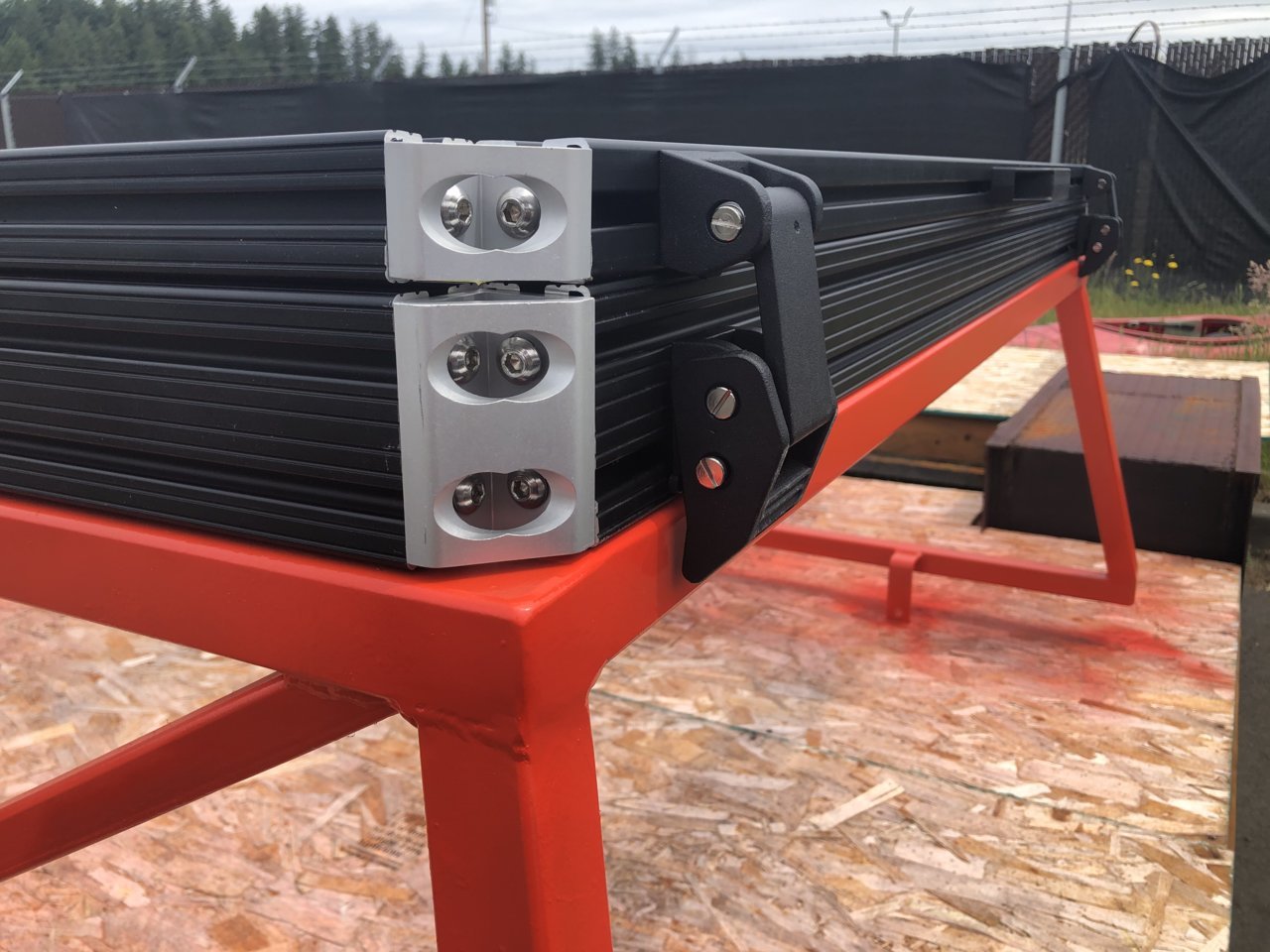

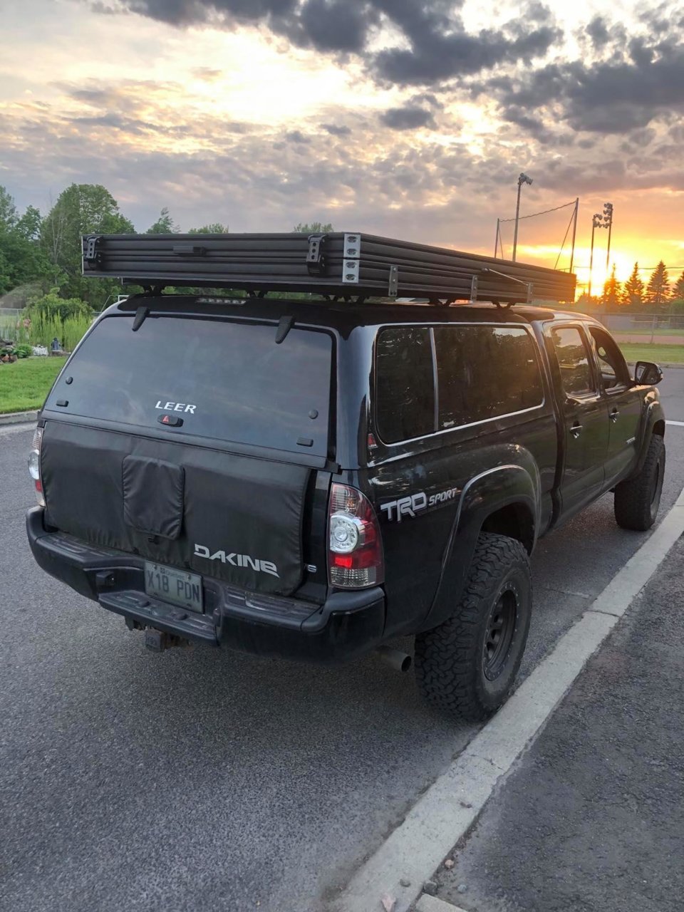

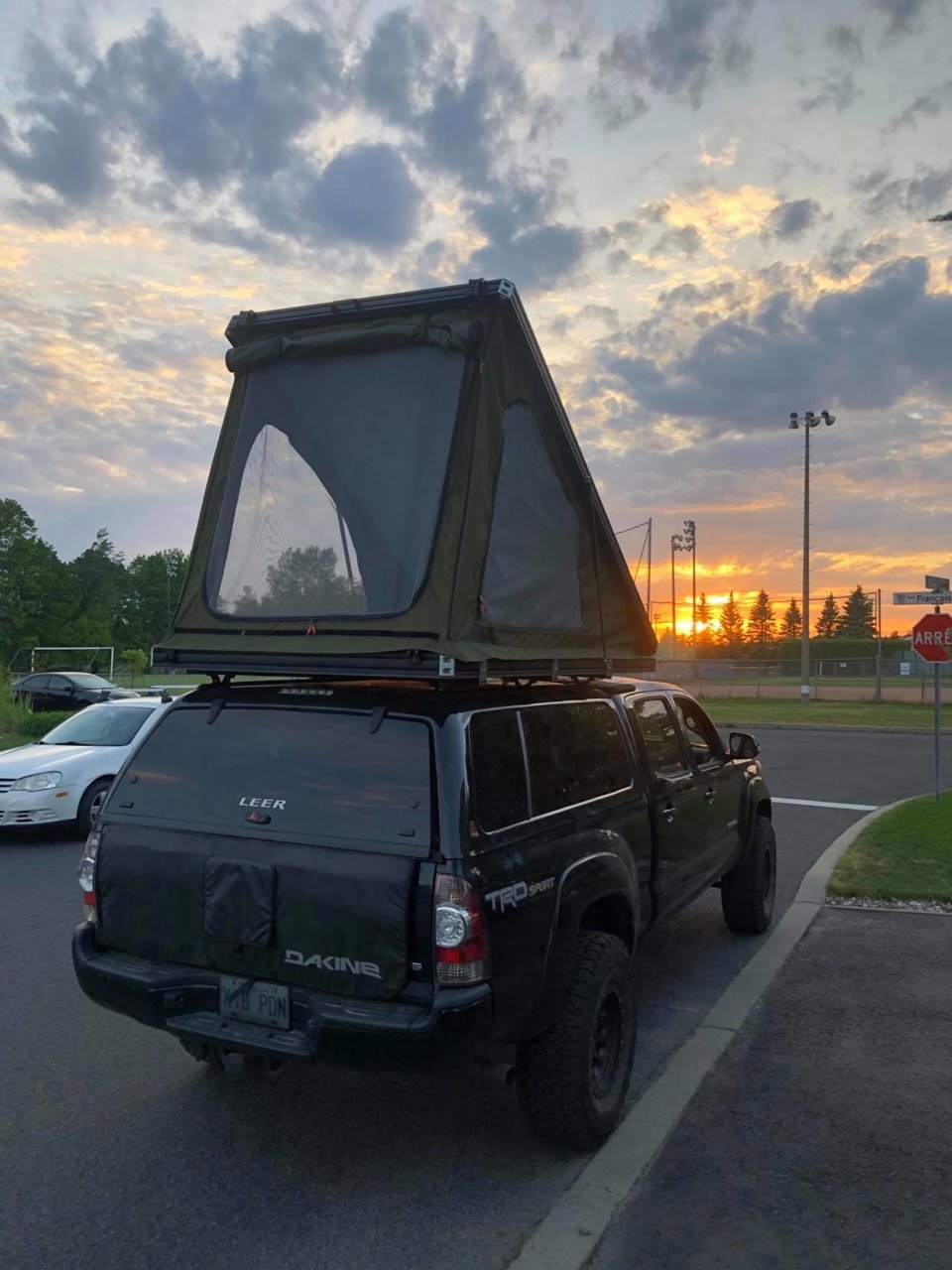

    Finished my tent over the weekend. Going to build the space frame slowly over the summer, but free time needs to be spent outdoors now.
    For those wondering I used 6mm (1/4") Alupanel for the floor. It only added about 30lbs. compared to the 3mm and is much more solid and doesn't flex. Supports two bodies no problem with the added support of the rack underneath.

    that looks killer, what did you use for the tent material, can we see more pictures?

    More pics coming...
    As for the material I used the same as @Ripcord, 600D Polyester with PU coating on the inside. Got it at a local fabric supplier for 1/2 the price online.

    Great work on the tent, looks superb.
    What size zipper did you use for the mesh? Finished my side doors yesterday, just need to do the mesh and hem the tent edges for the keder rail. Any lessons you learned from your experience?

    I used all the same #8 zipper everywhere. As for lessons, measure twice cut once. Take your time with the zippers, it took me about 3-4 tries to get the zipper right. I would finish it, then have to rip it out and start over because it wasn't fitting perfect. If i were to do it over again I would have the screens cut to a shape with a square door inside with two straight zippers (like GFC does their side vents). Curved zippers are much harder than straight. I would also remove the doors on the side and just do windows, but I wanted to be able to access from all sides because I wont have my spaceframe done for a while.

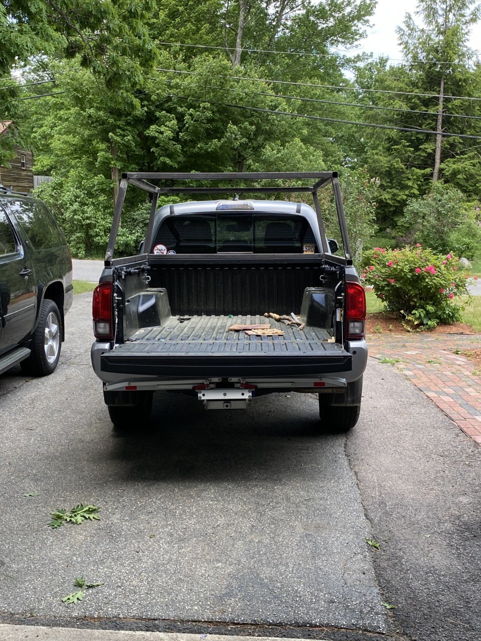

    Started ordering all the parts about a month ago. Have the wedge all put together and most of the tent sewn. Put some work in on the space frame over the weekend. Learning a bunch during the process. Also I got my latches from Bisco Industries. Genuine southco and seem very well made but more expensive obviously. Same P/N

    Did a 200km test run the other day and no deflection noise or wind noise at all. I was really surprised at how quiet the setup was on the highway.
