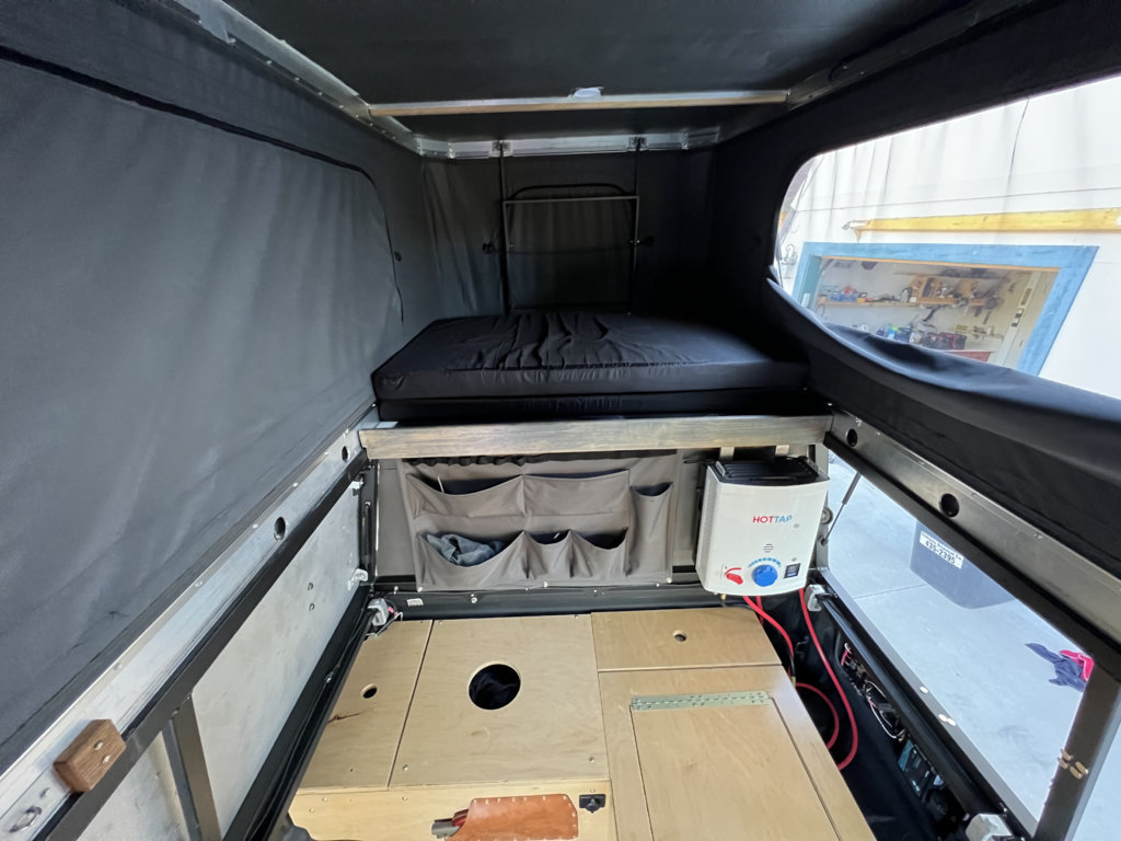

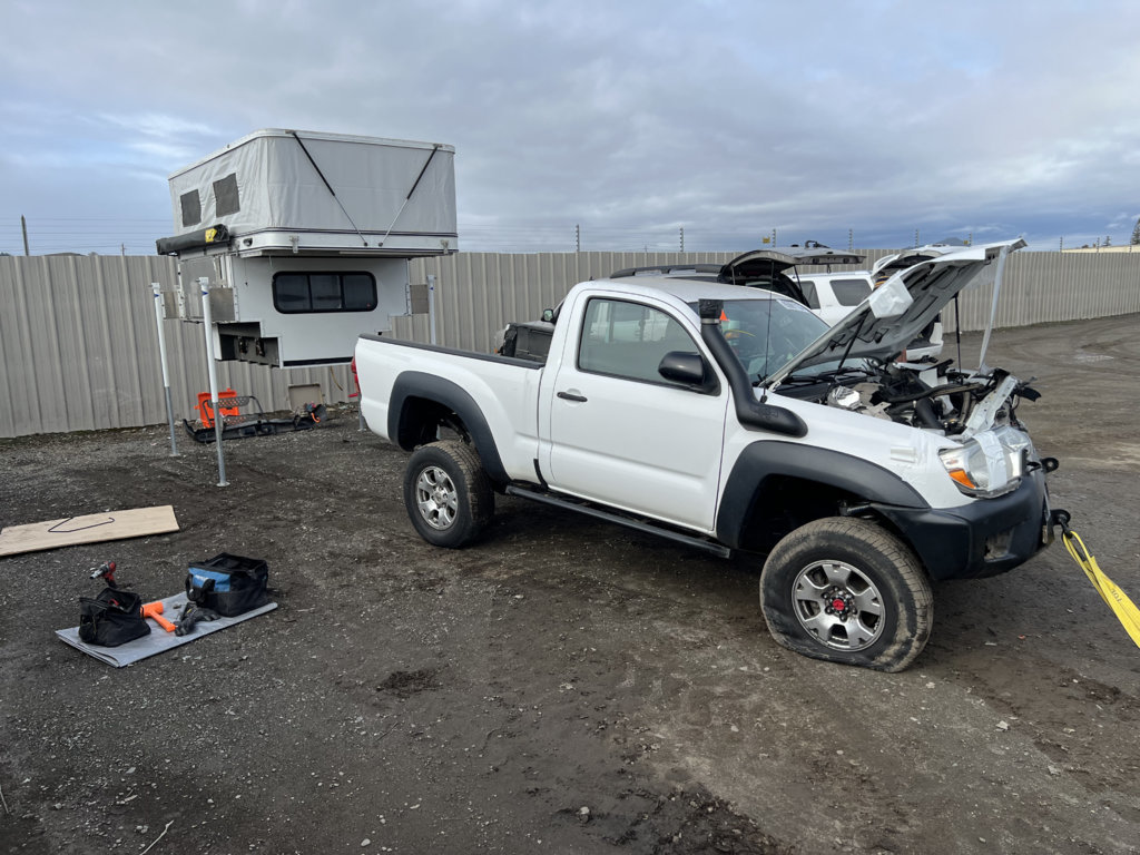

    looks like a nice camper thou! whats the insides look like? ive been off and on looking at one of those for my f150

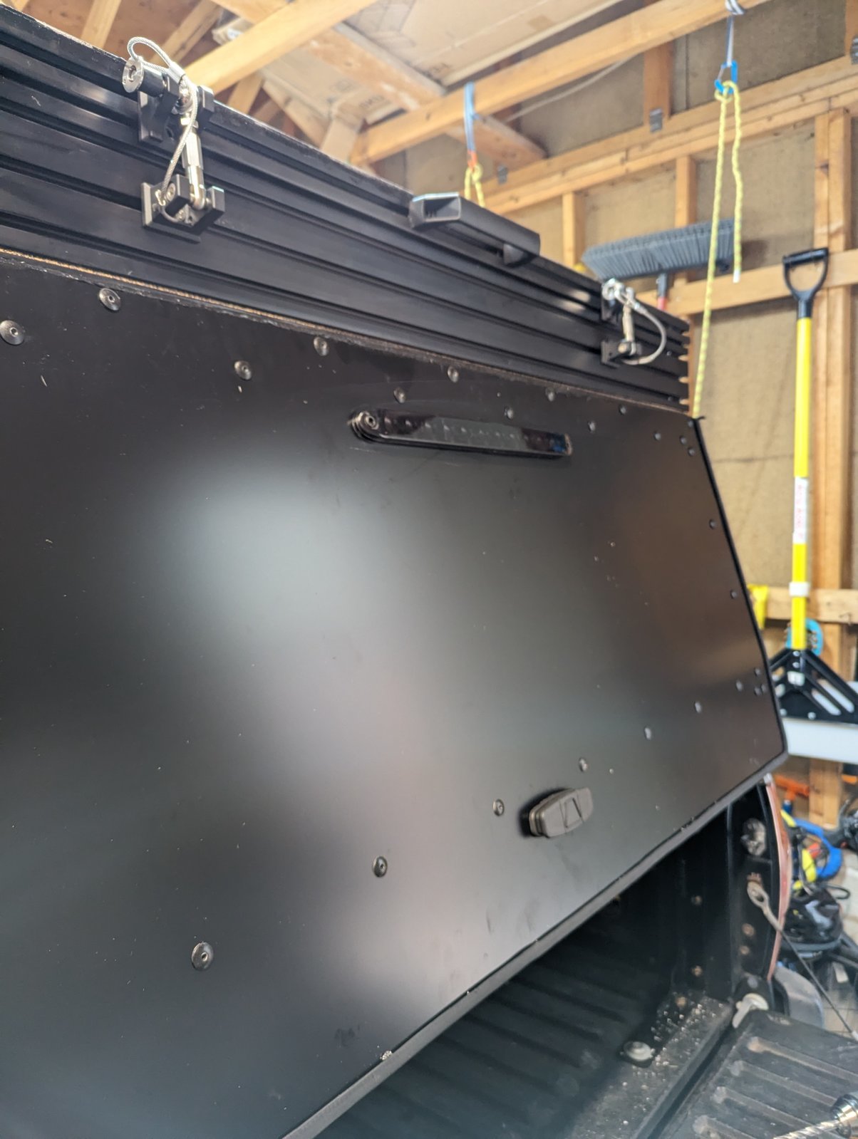

    Can you provide a better picture of how the sliding bed works? It look like 1x4 aluminum tubing resting on the steel frame ledge?

    thats acutally a peice of hard wood, with a alluminum angle on the back attched to the thicker chunk of alluminum compsite, And i made it to where the wood was notched and slid on the camper rails just like a 4wc camper setup...

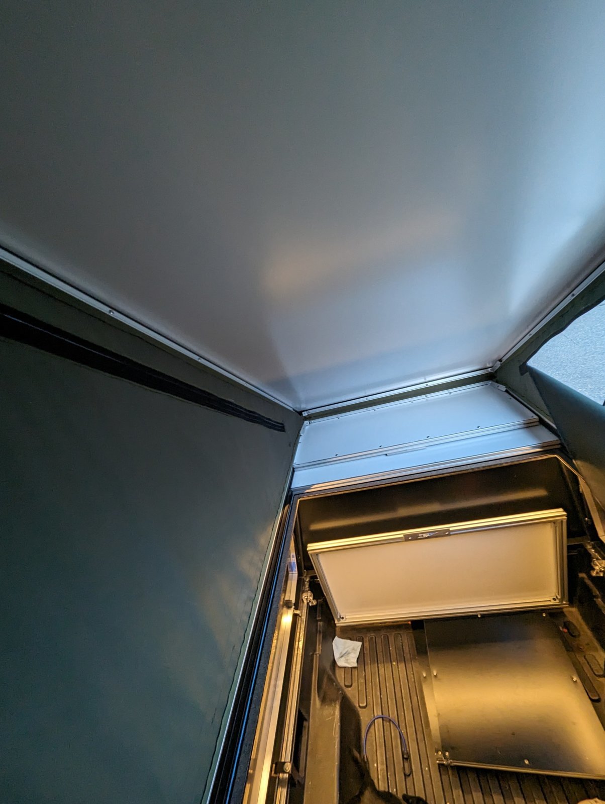

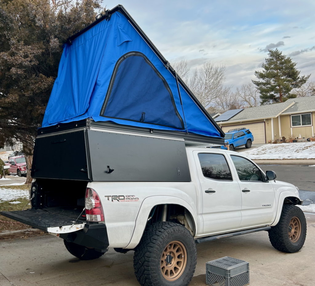

    Got a good test fitting of the canvas. Still some adjustments and final touches left, but nearly there.
    My build is a v3, which was just released below.

    The long overdue Version 3 featuring an all-aluminum construction. The lower frame is now made entirely of 8020 Extrusion and the lower panel doors are all aluminum sheet. This camper is vastly improved from V2 and much easier to build.
    • FREE How-To Guide
    • FREE Bill of Materials
    • Available design files (still exploring options to offer physical parts)

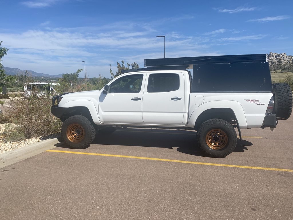

    Your pic with the bronze wheels threw me off for a quick second!

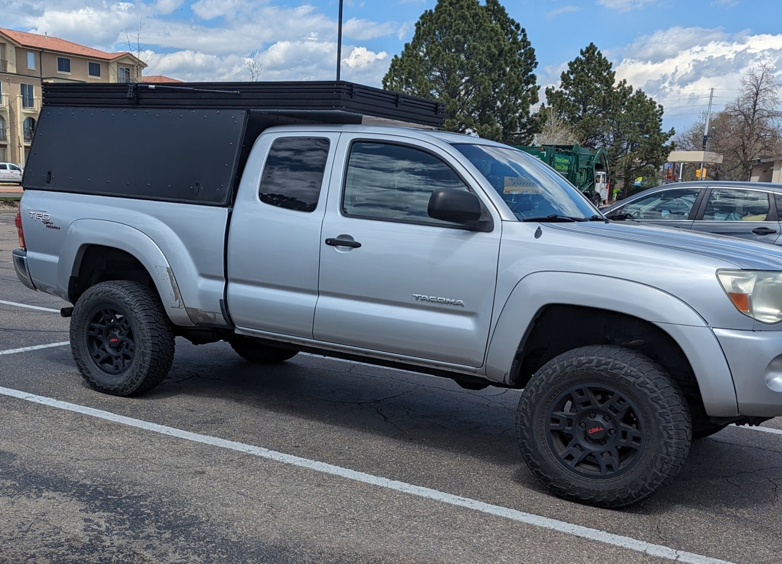

    DIY Wedge Camper
    Quick update on this build - just posted a video tour on YouTube going over the build details. You can check it out here:

    those are neat wheels are they steelies?
    remind me of the newer chevy wheels

    Yes, I think they are Pro Comp 51’s or something.

    I've followed your build for a long time, since V1, and just finished reading through your V3 revision. You have really perfected this build. It looks like a factory build now with the lower frame extrusion and CNC'd components. I would love for you to do an updated walk-around video.
    I'm interested in building this camper for my 2.5 gen Tundra. Obviously my measurements will be fairly different. Do you have any estimated cost for the CNC'd components like the lower frame mounts and angle brackets? I'm not sure if you used a turn-key supplier like ProtoLabs or Xometry. I wanted to know an estimate before i bit the bullet with the plans from your site.
    I've also considered just making the lower frame uprights 90 degrees instead of tapered for more room, similar to an OVRLND camper. But that changes the dimensions of the wedge frame and i'm assuming would make it much more difficult to build the roof as you used one 5x10' sheet vs having to use multiple panels and seal the seams.
    Would love anyone else's input too. Thanks for all the info on here, its a tremendous help.

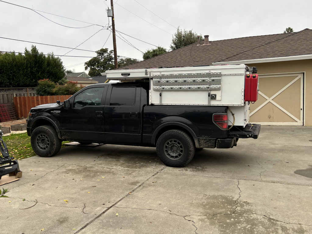

    I'm taking these plans and spinning them off for an F150 build; what is the minimum clearance people are putting between roof of cab and bottom of the camper?
    I was aiming for 2" but getting worried that might be too little.

    My 2nd gen is very close. However that gap depends more on your fords frame then a tacoma frame. It's all about rigidity. Some frames are made to flex more.
