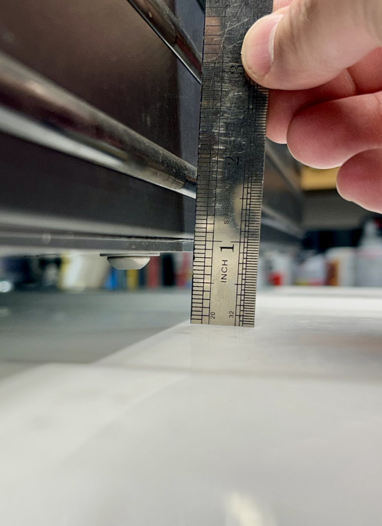

    So is the recommended gap for Tacomas 2" between camper and cab roof? Or are you adjusting for a larger gap?

    Measured mine. It's about 5/8" of an inch from the bolt to the metal. The sign material is 7/8" from the metal roof.

    Wow that is close. I was budgeting about 2” gap from the lowest rail to the metal. I suspect that would be 1.5” after alupanel and bolt heads.

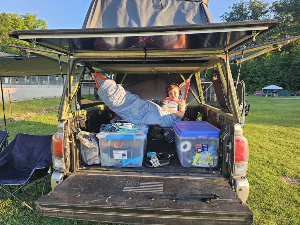

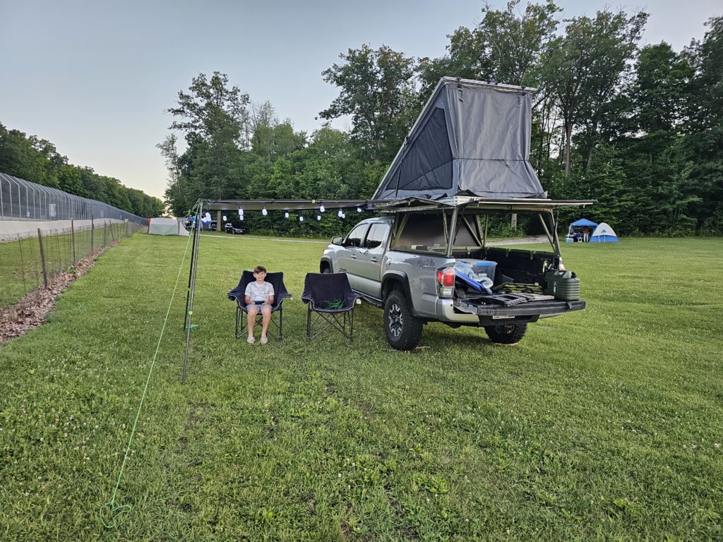

    Loving the wedge camper! 1st test and trip was 17hrs from home at big bend NP. How are yall getting the filler panel to stay up top?

    64
    2022 Tacoma TRD OR DCSB
    Turn 5, road america

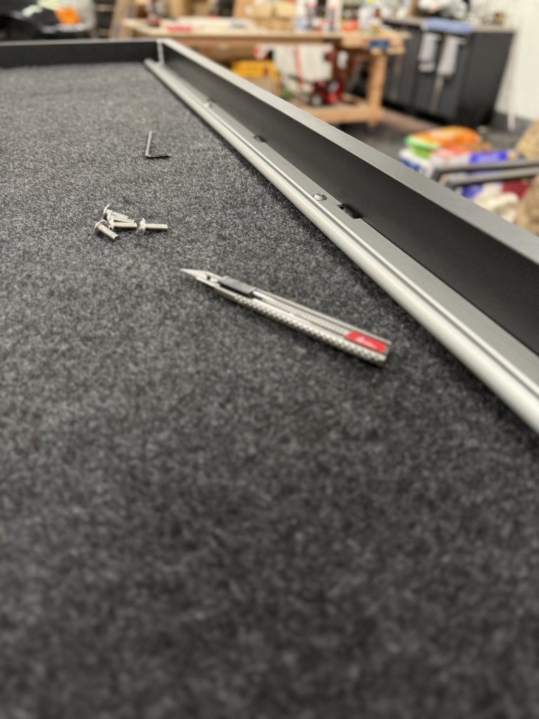

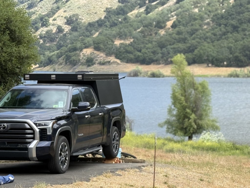

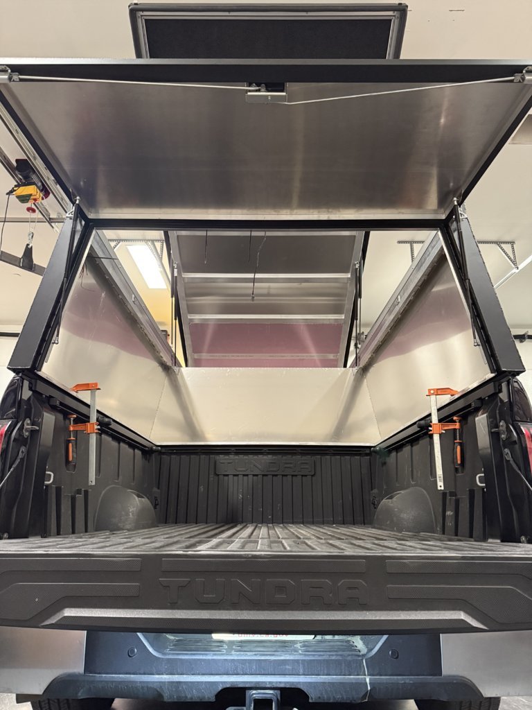

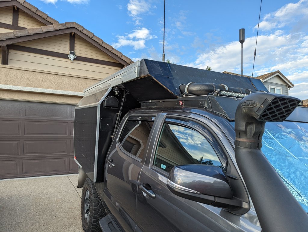

    Again, not a ripcord and not quite done, need to finish the tent but was glad after so many hours to get this thing out anyways. Gonna be great when complete.
    Vinyl wrapping the roof:
    finishing the roof, carpeting over insulation and installing the keder rail:
    Test fit to mock up clamps:
    first trip out:
    Question: any clever ways to be able to adjust tent fabric tension? My shock mounts are not adjustable so I’m guessing just gotta get it right?

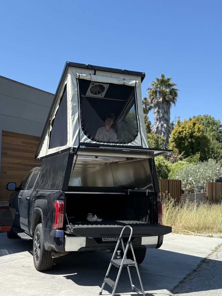

    Finally done with the tent, boy howdy I underestimated how much work and faff that would be.
    stoked to head out for a 10 day trip in the sierras with it!
    Lights as well, on dimmers. only one not shown is on the inside of the rear door which shines down on the tailgate and surrounding area.

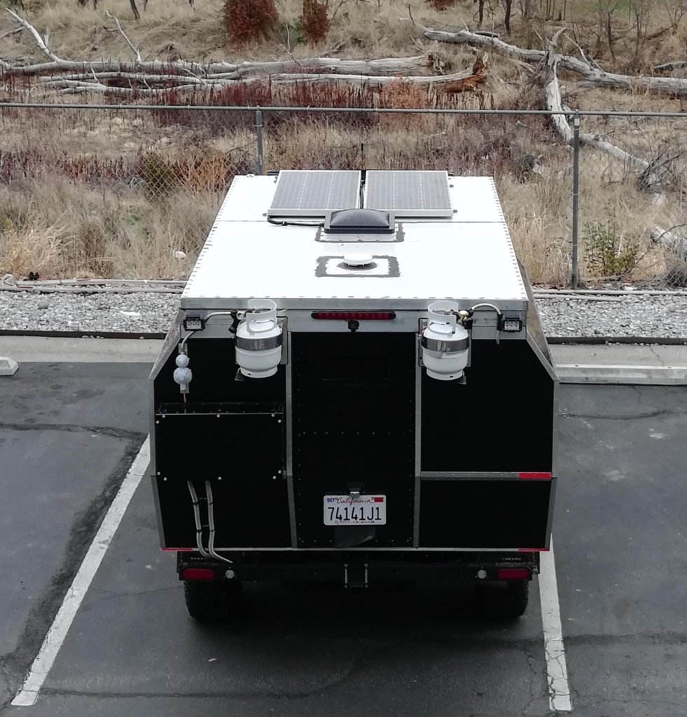

    For those of you running basically permanently mounted solar on your roof, how are you bringing the wires into the box where you would have your batteries, fridge etc? Specifically I'm wondering how you deal with multiple panels and their wiring.
    How do you secure the run of wires to the roof? It's a power coated aluminium on mine.
    Where do you make your connections, inside or out?
    What are you using for waterproof entrance into the camper? Entrance glands seem to be the way, but if there's a better method I'd like to know
    I'm trying the adhesive ones from Bouge Rv that HoboTech beat the hell out of
    https://youtu.be/sjTsq9M-66A?si=f4j3EsBQAtPRTINL
    Thanks
  17. Jul 7, 2025 at 9:28 PM
    #3657
    realsystem
    realsystem Well-Known Member
    Nov 7, 2017
    #235356
    544
    Stanislav
    SF Bay Area, CA
    2017 MGM Tacoma TRD OR DCSB | 2021 Cement Tundra SR5
    LT,37s,5.29,Kings,Camper,Deavers,snorkel,winch,CVCtune
    Running standard solar cables on the roof securing it by zip ties to panel brackets. It's running all the way to the front and going under on the outside. It's running inside the split wire conduit wrapped by electric tape for waterproofing. I combined multiple wires(for solar and offroad lights, but antennas are separate). It's connected to the walls by cable clamps with rubber cushion which are riveted like everything else in/on my camper. I have only standard solar connections on the roof because I use Y-split for two panels. It's wrapped by tape and covered by piece of salvaged treadmill rubber. All other connections are inside, I use Blue Sea stuff. For the entrance I use roof sealant that's used for chimney and in some places standard silicone sealant.

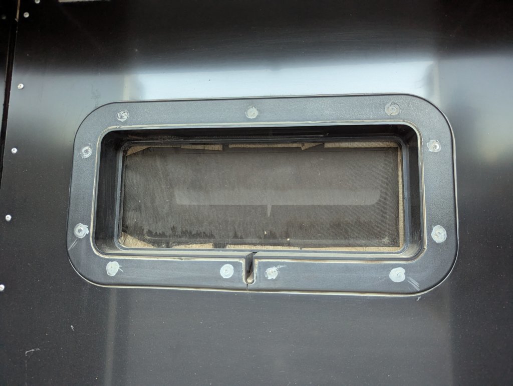

    Hey guys,any ideas for a back window?I'm trying to find a super light window to install on the back panel.I though about plexiglass but sounds difficult to find the exact seals.
  20. Jul 21, 2025 at 8:07 PM
    #3660
    realsystem
    Nov 7, 2017
    #235356
    544
    Stanislav
    SF Bay Area, CA
    I use porthole
