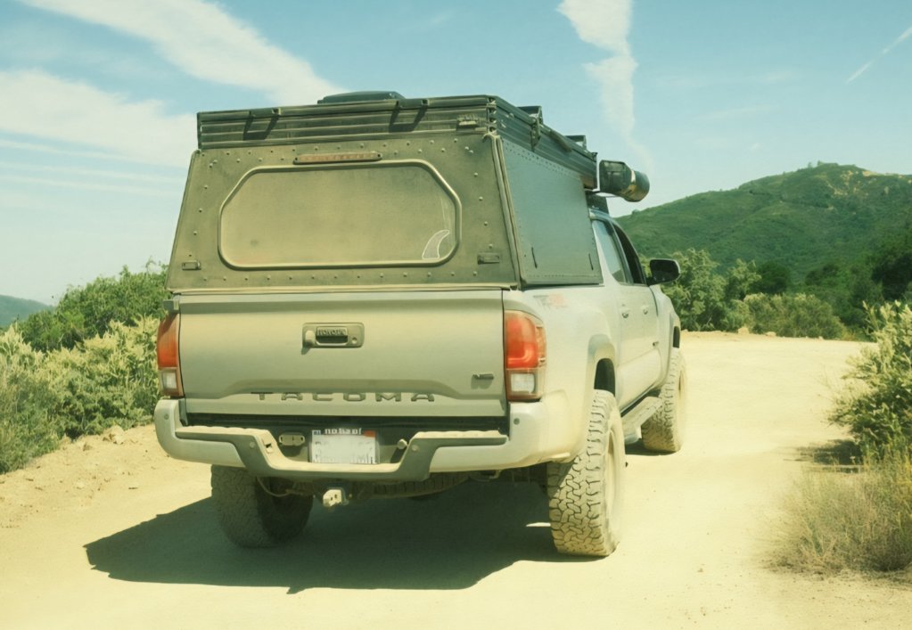

    I used a push-seal from mcmaster with a 5mm polycarbonate anti abrasion sheet. Part number 3275T22 if you're interested. Light enough to use the recommended struts that ripcord recommends. You do need a push seal tool to install. It looks like a screwdriver with a small ball tip and lube.
