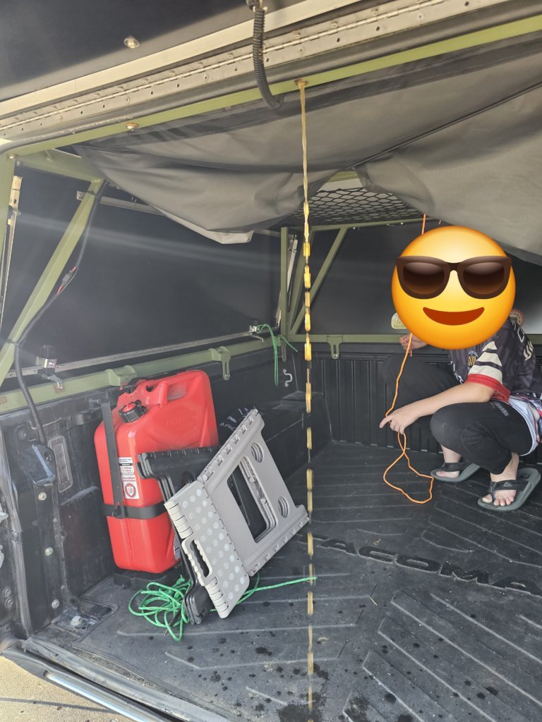

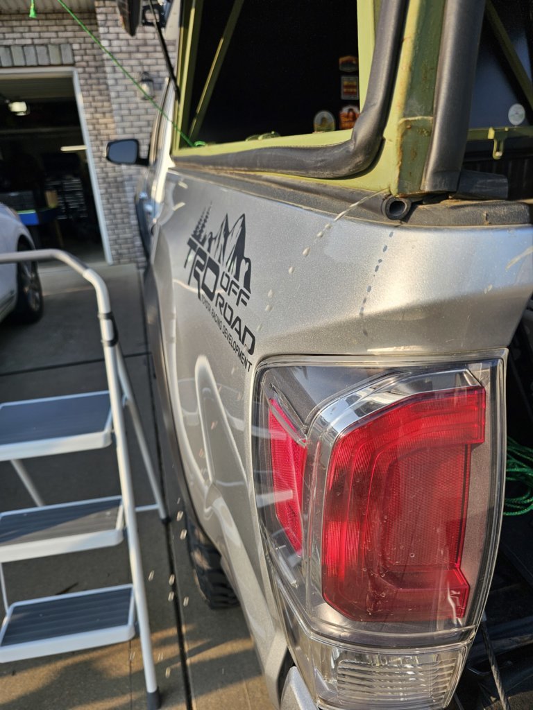

    Well I saw some rust water spots in the bed, pulled a bolt and the frame was full of water. I drained all the water, drilled some holes in the frame and recaulked the seams.
