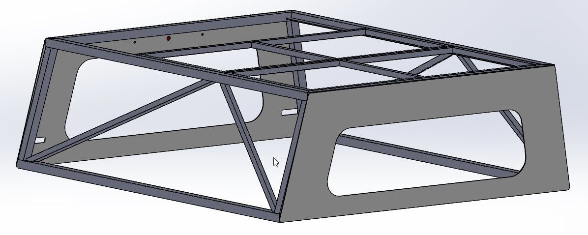

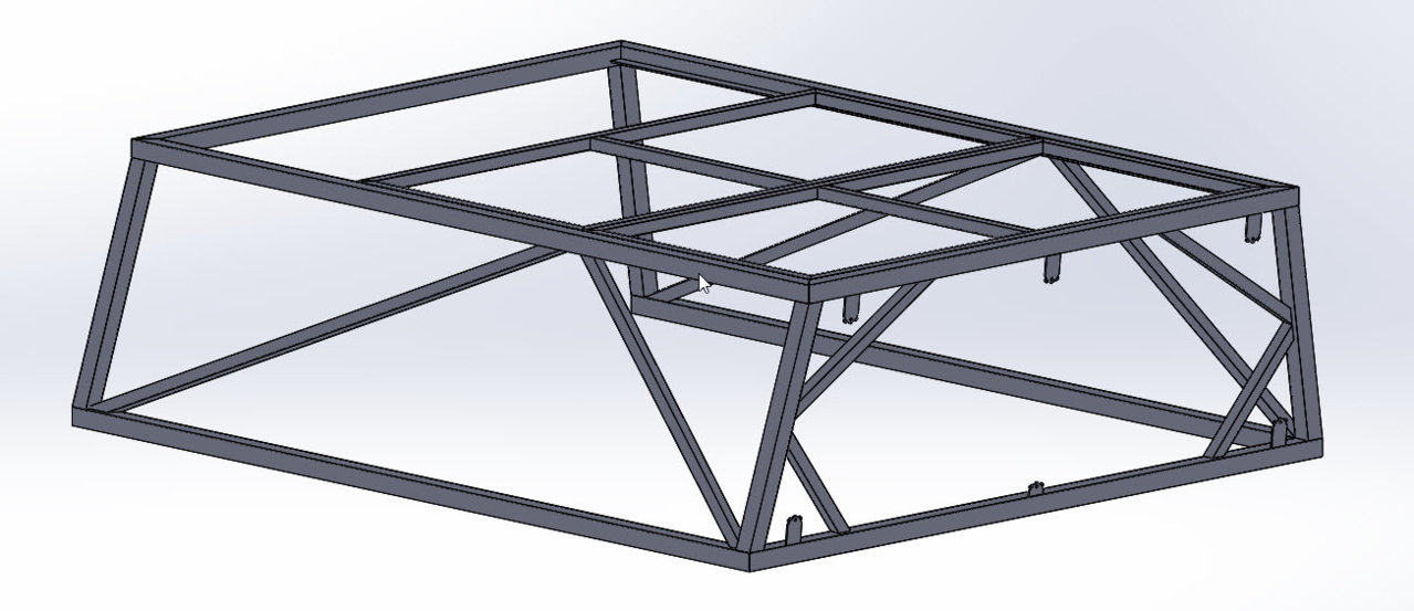

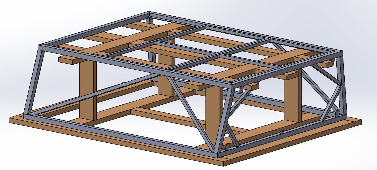

    Finally stopped being lazy and got my CAD models finished up... It's been a really productive day at work. Making a few changes compared to ripcords: flipped the side gussets so that the big opening is near the cab for easy access since I'm a longbed, made the floor panels removable for extra space sitting out bad weather, and figured out my window sizes so I can get those ordered since they're my longest lead time parts at ~6 weeks.
    Gonna pick up lumber and try to get my welding fixture built up this weekend so I can start burning this thing together.

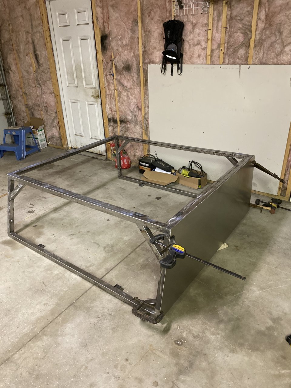

    Starting to cut out all my sides and get the fitted and drilled before paint. I’m using .080 aluminum as it was cheaper than any alupanel I could find locally. 5ADF2083-CAB3-4BE7-A8F8-B011B261370F.jpg
