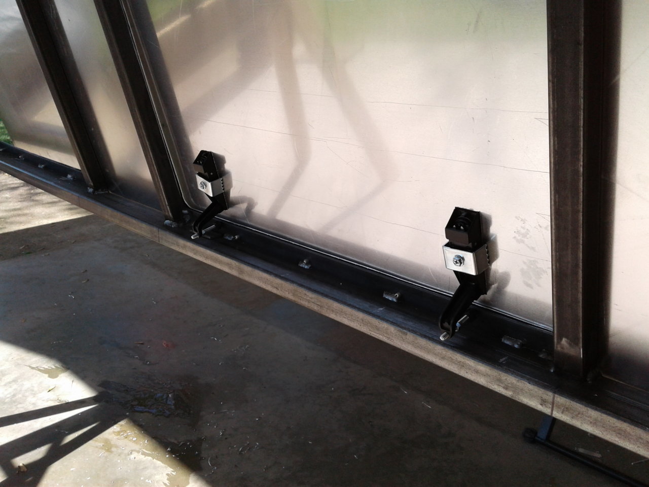

    Have you installed the latches on your camper yet? Did they fit on the 1.5" tubing? I was about to order those latches but the description says the grip range is 1-24mm (0.1-0.94inches) and the ones spec'd in ripcord's spreadsheet are 23-46mm (.91 - 1.81). I held off on buying since it didn't sound like they had enough grip range based on the specs.
    Based on the Amazon description it looks like those are the C2-32-25 latches.

    So I added a eight inch flat bar for the lock. I have 2" wide base and it won't lock that far out.

    Ah gotcha. Makes perfect sense in your setup. I'm trying to latch mine to the tubing so glad I caught it before buying them.

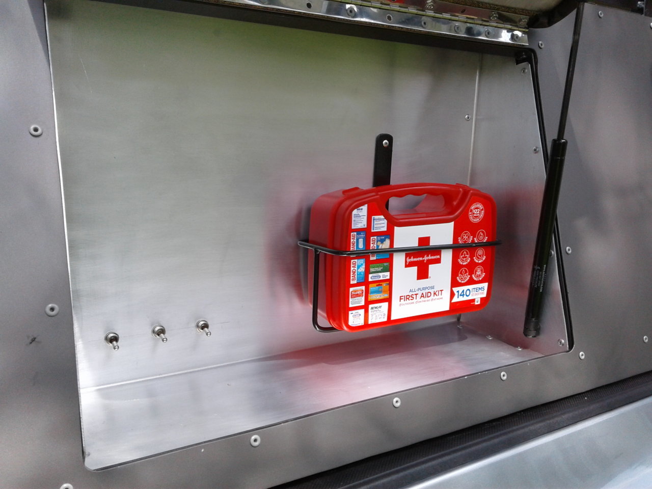

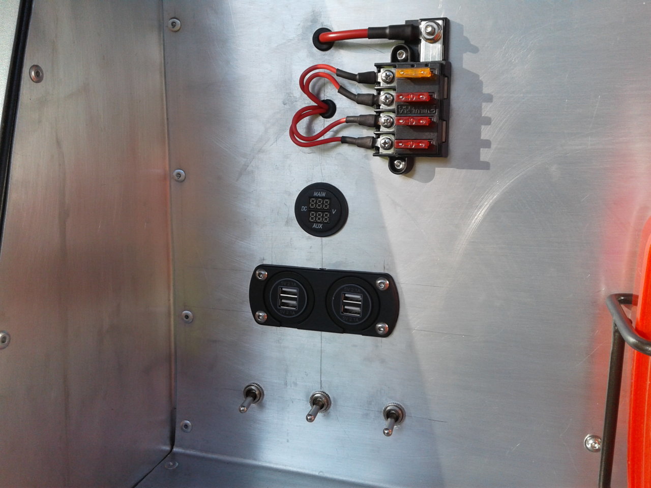

    My latest was this command center..ahahahahahaha....or power center, battery and charging panel....whatever. The idea was when arriving to camp, I could get out on the drivers side, walk back and open the first camper door, turn on the lights to see the camp site. I have left/right/interior and will have rear lights as well.
    Zim
    dskakie, SR-71A and lightnfast like this.

    Here is one from the first page. I'll take a few more tomorrow. I'm adding a master power switch.
    Zim
    rotus likes this.

    Ahhh I see what you did, very cool. Yes to more pics! Im adding a small switch panel with outlets running from my under-hood second battery, but just bending a bracket and attaching it to by bed rail.

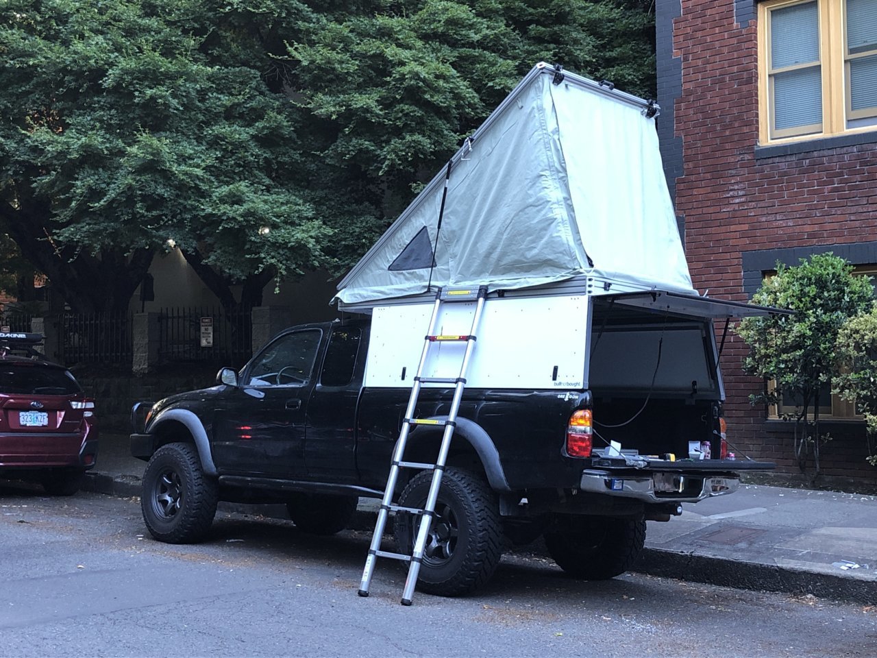

    Wow. Finally. Tent came out pretty well. Little vent windows up front, side doors and front door with inner mesh doors. Stuck with the #10 Vislon zippers. Gotta mess with the skirt a little bit other than that it’s swell.
    Have to trim the width of my rectangular 8020 sleeping panels since they don’t quite fit now with the tent mounted and Keder rail taking up a teensy space. Thanks for everyone’s help and advice and @Ripcord again for sharing.
    Next pic will be in its natural environment.
