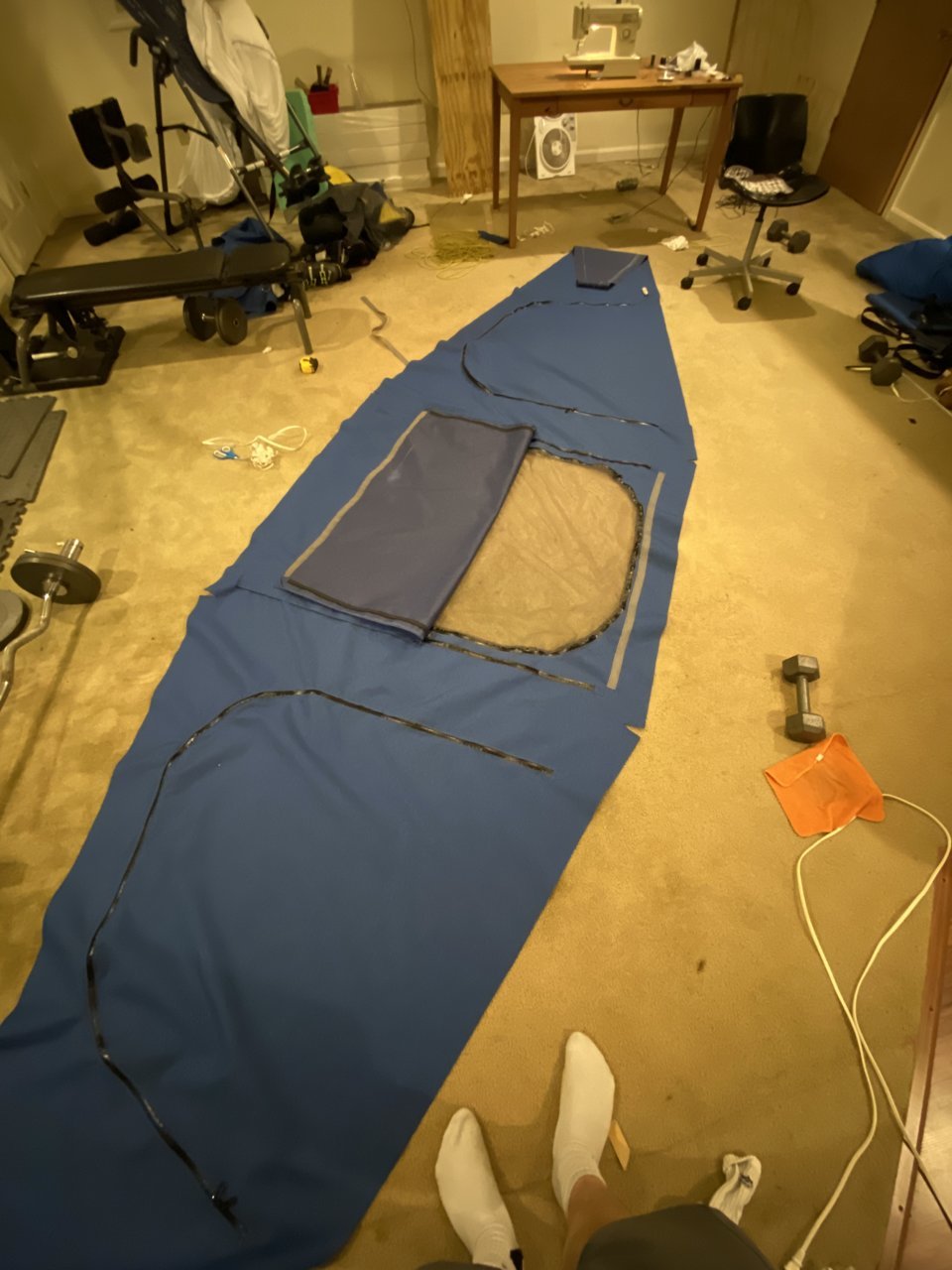

    Finally starting to come together, need to finish up the doors and the sewing.A829CA64-7590-4C7D-B235-5618802D10EB.jpg

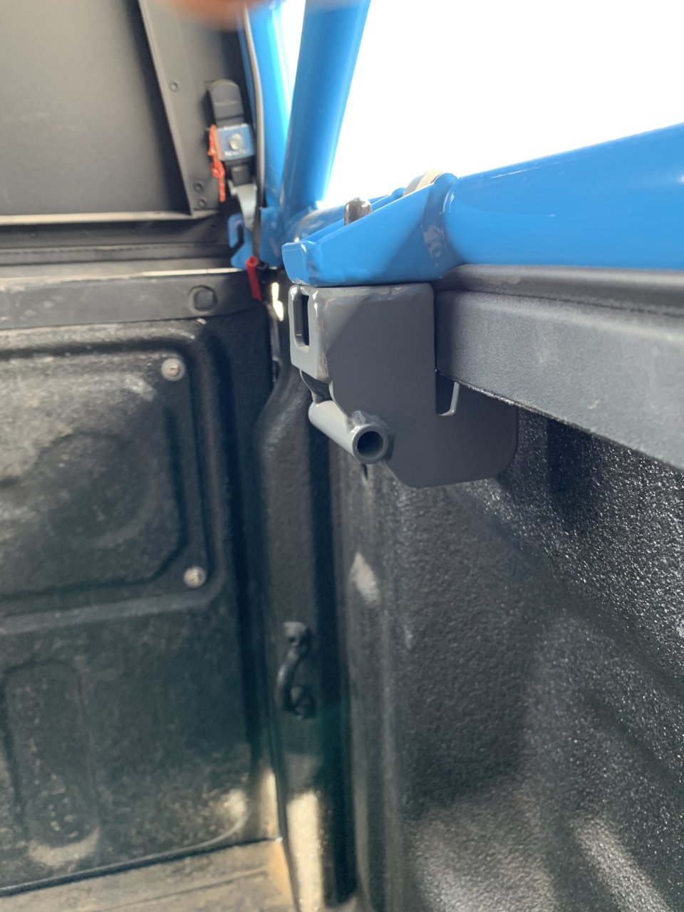

    Create something like this for 1st gen's.

    This tent will be the death of me. By far the hardest part so far but getting there. 2 more bug screens and the Keder hem then it’s done. Don’t mind the messy sewing/workout room lol.2B795582-2C52-46FE-A9CA-3DC459090B55.jpg

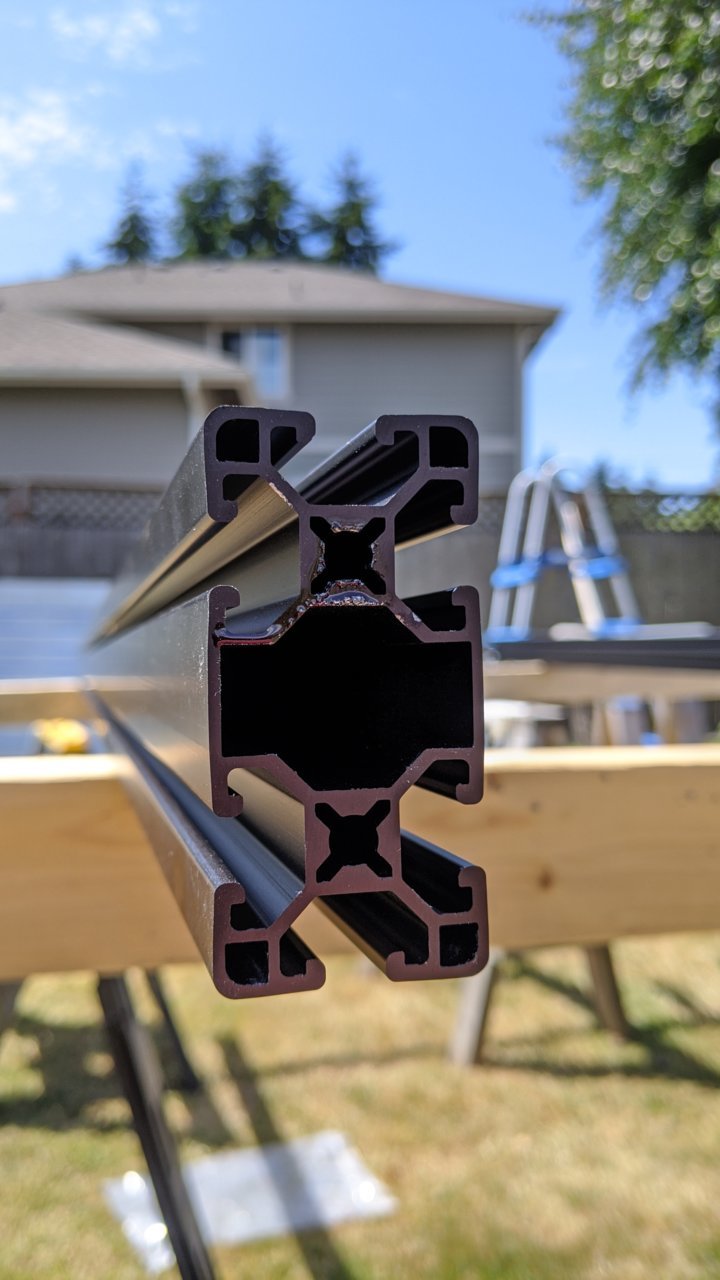

    I'm trying to tap the ends of my t slot extrusions but an running into a problem. Because it has an x cut around the hole my tap wants to walk into the x and wedge there. How did you guys keep the tap centered on this?

    Are you using a straight flute tap? If so, might try a spiral flute
